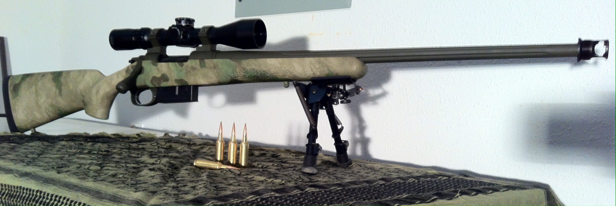

Extreme Hunter #1755 arrives in Alaska
Received last night. #4 contour for suppressor use (TBA 30BA). March 2.5X24 MML. ATACS FG W/ Mil OD on metal. Loaded up some 140gr Berger's this morning. Now please excuse me while I go send em!
D
Looks beautiful , my wait is killing me but it's nice to see someone's wait is over , how long did it take?
Ken quoted me 10 months and I had it in THREE!!!
I sent 30 rounds today and am VERY IMPRESSED! very low recoil and the action is smooth as silk. Barrel is broken in and showed no copper after 4 rounds and 8 patches. Just need to play with seating depth and I'll be golden and ready to take it out to distance! It shot about 3/4 MOA today but I'm sure with some bullet depth play and now fire formed brass, groups will tighten up.
I hope your wait is short!
