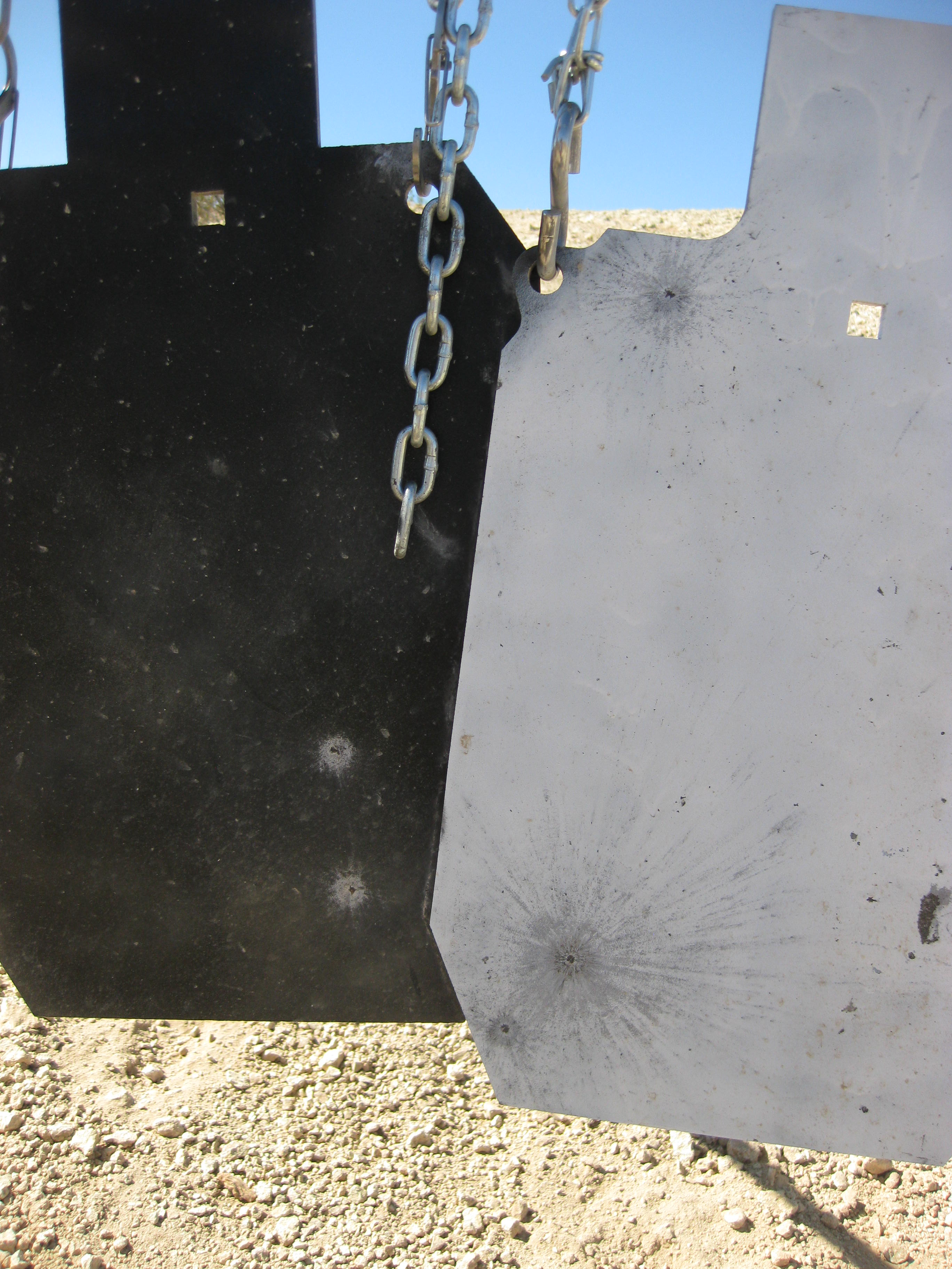

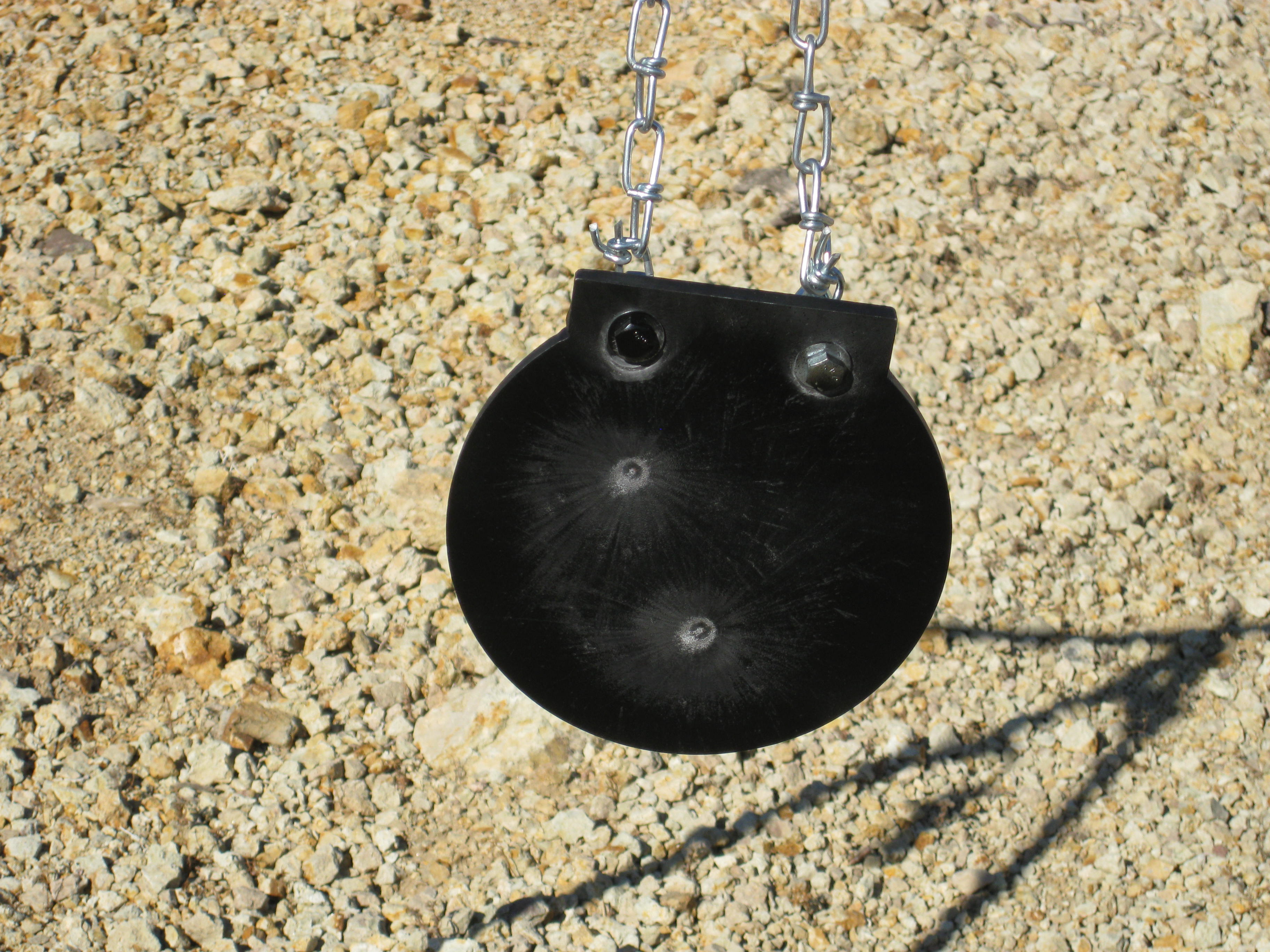

I finally took my DTA 6.5 SAUM out to some distance. I got some DOPE at 900, cold bore hits on an 8" target were nothing for this load! After two shots there I said lets go out to a mile. 4 shots and 4 hits! I am so impressed with this round, it's my new favorite round. The big splatter mark is the .338 Norma Magnum hitting steel as well out of the DTA.
Nice shooting!
Always heard it was the other way around i.e. the Hunting VLDs have a thinner jacket, for better expansion.
I've shot them side by side and could not tell a poi difference. BUT it was only at 100 yards.
You could be right. It's on the Berger website. I will double check now and report back
Yes I stand corrected. Thicker jackets on match bullets to help reduce the lead from melting and the thinner jacket is on the hunting VLD line. The original of the two.

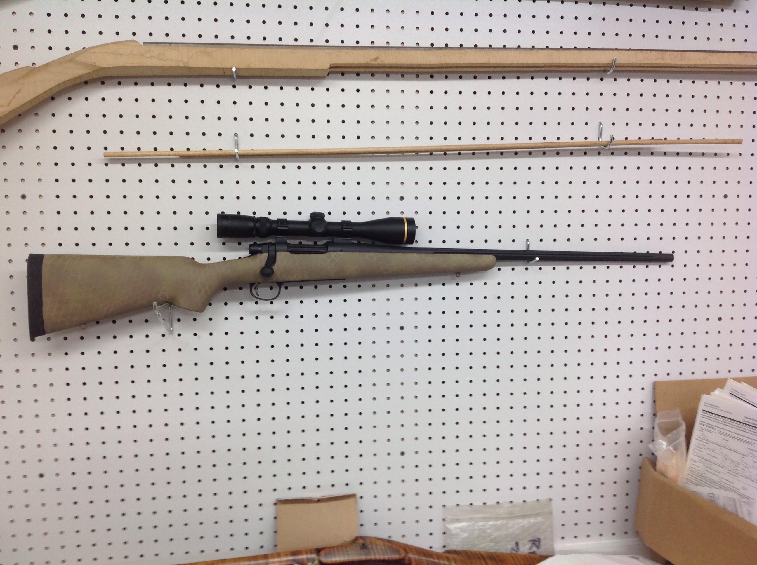

My second 6.5 saum
Got this today
T3 action
24" bartlein no 3 fluted
Bedded into mcmillan hunter stock, edge tech
Dan hardy gen 4 suppressor
.298 reamer
Atlasworx tac bolt handle
Sako optilock low rings
Leupold vx6 3-18x44 illuminated Boone and crocket
