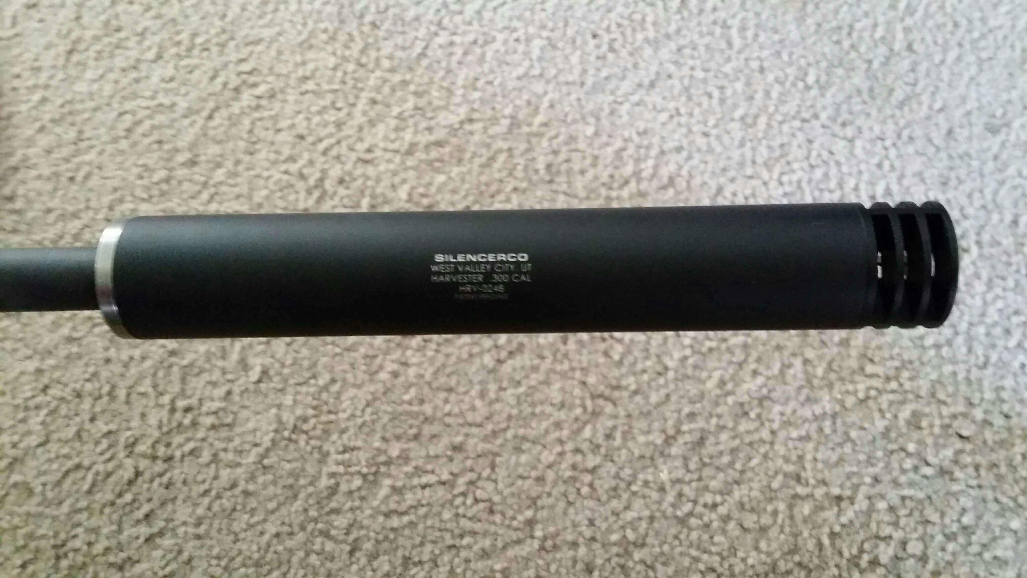

Suppressor Question
Harvestor Suppressors Arrived last week, Form 3's are done and pending for those that bought them for their Xtreme Hunters.
George I am assuming at these pressures I can shoot a rated 62k psi advance armament .308 can on an extreme hunter SAUM? I will probably end up with a tactical rig...around 26inch barrel and will likely shoot for 139scenars at north of 3100fps. Would appreciate anything you can share so I can plan accordingly for the build and will be calling your folks shortly to get my order going.

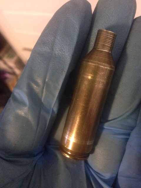

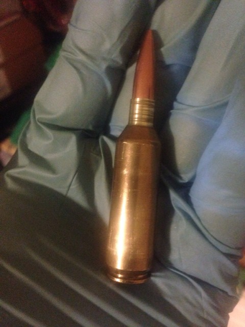

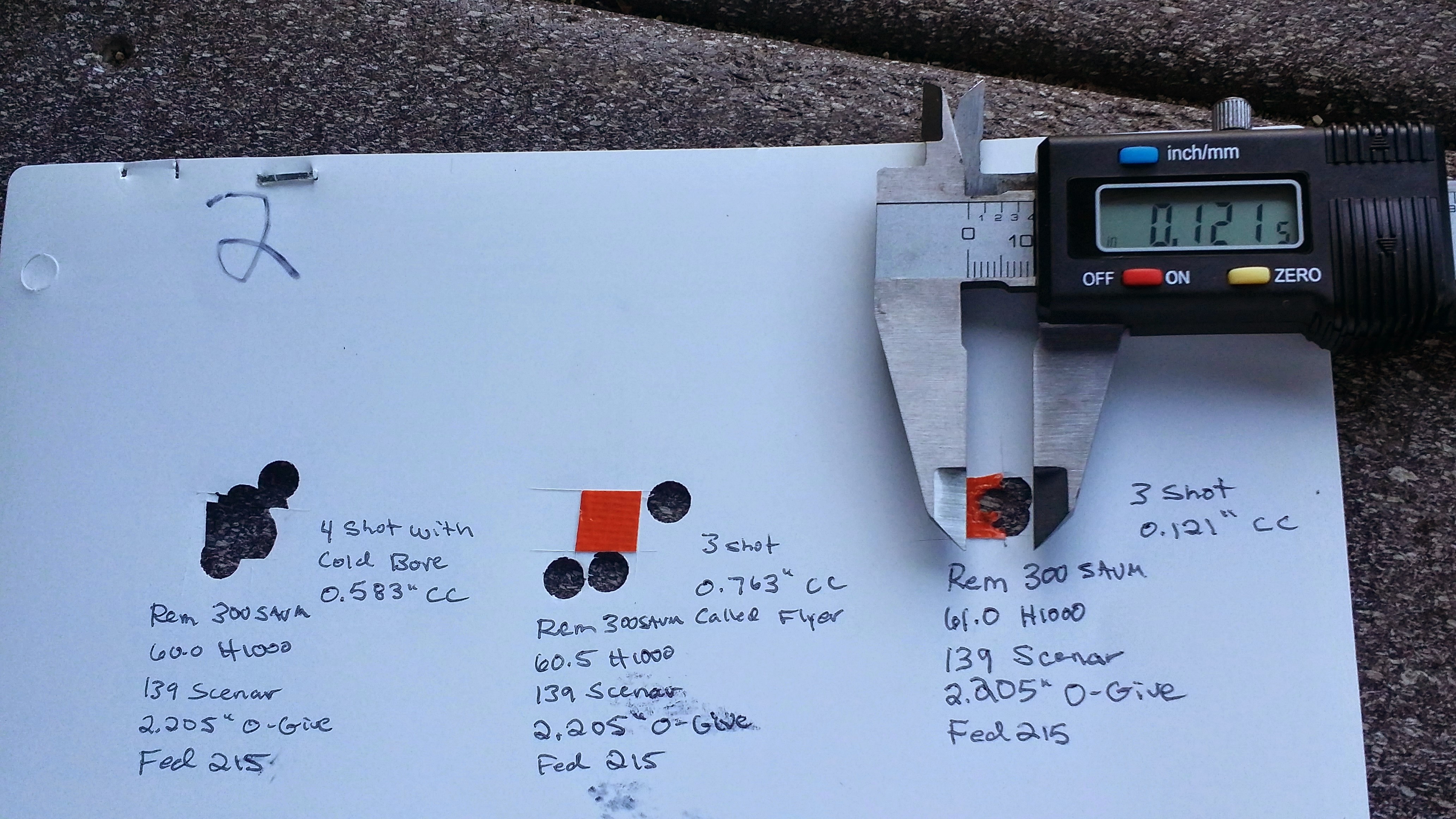

Ok fellas help a newbie out. This is my first wildcat but I've been loading .260,.308 and .223 pretty successfully for years.
I have a 6.4 4s from sac, with the redding set and prepped brass from copper creek. When I got them I Loaded all of them from copper creek with 61 grn of h1000 and fire them with no issues except all of them had some slight resistance closing the bolt but speed and groups were erratic but I chalked it up needing fireformed. So afterwards I tumble them and run them through the dies with a .291 bushing. They chamber check ok with an occasional one giving just a slight resistance right when I go to lower the bolt handle. So I charge and load a couple to with 139 scenar to 2.82. The bolt won't close all the way so I shorten them to 2.78 with no improvement.
Some guys from my earlier post told me to trim down the shoulder. So I got a k&m trimmer, used the expander, then trimmed down to the shoulder a little. Then I dummy loaded a scenar, which had light neck tension and loaded it to 2.83 and it chambered ok but came out 2.822. Needing to make a quick trip to the range I loaded 9 pieces of brass this way to do a little load work up.
So this is the case and results of 60.5 of h1000 and a 139 scenar. I'm looking to repeat that result obviously. ;) but the brass prep was not the correct sequence

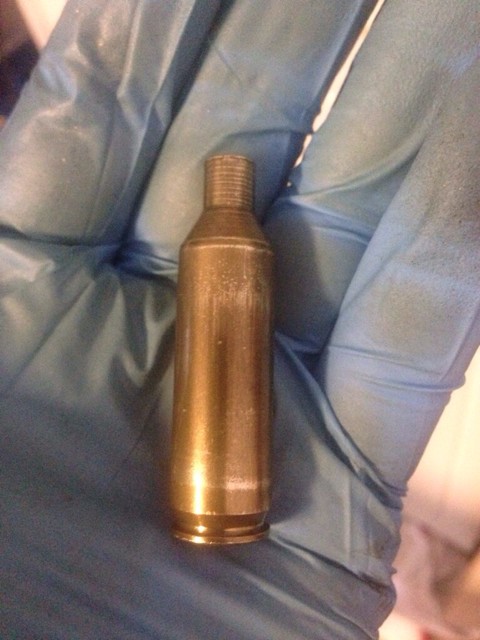

So today I run all my brass through my sizing die with a slight cam over in the press. I go to chamber check and still have a slight resistance on the bolt with the initial downward motion. So again I use my expander and run the trimmer down the necks once more on the stuff I sized earlier
Here is where I'm at
Fortunately the brass is slightly tarnished so this stands out better. What is causing the issues at the shoulder-body junction where the bright ring is?? Also look at the neck-shoulder junction. Is it ok to turn down that far?
Is this a die issue with the bushing I haven't done something with correctly?
Before I go any further I wanted to seek some guidance since most of you are having great success with this.
I've loaded 2 dummy rounds with 139 scenar at. 2.830 with very ligh neck tension and they came out 2.824 and 2.822 so my I've been loading 2.820.
If I take all my once fire copper creek brass that I've resized then expand the necks on a mandral and retrim down to the shoulder neck junction they seem to chamber ok.
I'm trying to figure out if I have a issue with the dies/setup or if something happened and there's a issue with the chamber SAC did.
I hae the same bright ring on the shoulder.. Not worried about it really... You're chambering issues are likely due to needing to turn the brass down on the shoulder more and bumping the shoulders back a bit more as well... In order for me to get a good clean closure on sized brass I have to bump the shoulders .003"-.004" from fired brass dimensions... Not sure why, possibly because I'm using a 7saum type a die...but I'm not sure..
i also turned my necks down slightly more to .014" for more clearance. Works the brass more but I like the piece of mind.

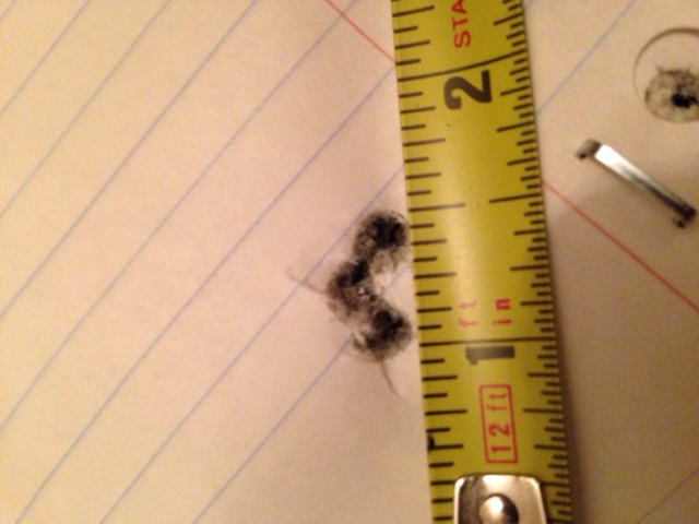

Got my GAP 6.5 SAUM about 6 weeks ago but have not had much time to play with it- Have about 100 rounds through it so far, started with Berger 130 VLDs and 62.9 grains of H1000 kissing the lands was shooting under 1/2 MOA. Worked up some 139 Scenar's tonight and I think I found my load to settle on. Its amazing how much fun this rifle is to shoot- feels like a BB gun compared to my 338 Lapua- Elk season cannot get here soon enough!

HEADSPACE.. I bet if u took a few thou off the bottom of your sizing die it would work like magic!
I don't think it's headspace. My RCBS MIC gauge is still not here yet but My buddy let me borrow his Hornady headspace comparator set yesterday . Granted I don't have 100% faith in this system as I was getting variations measuring the same case multiple times by a couple thousandths, but the stuff I sized that's still not loaded vs what I loaded and fired today is .012 avg shorter headspace. I've definitely pushed the shoulder back way too far on this go through the sizer. I measured 19 cases vs the 20 I fired today and they were all .01X shorter on the headspace gauge.
I set my trimmer up to .014 and turned the necks down to the shoulder this morning and they chamber ok with the ones I loaded today . Still some slight resistance trying to close the bolt. I'm hoping this was just a result of the brass needing turned down a little more than initially done.
I'll resize and load tomorrow and report back if I have any lingering issues.

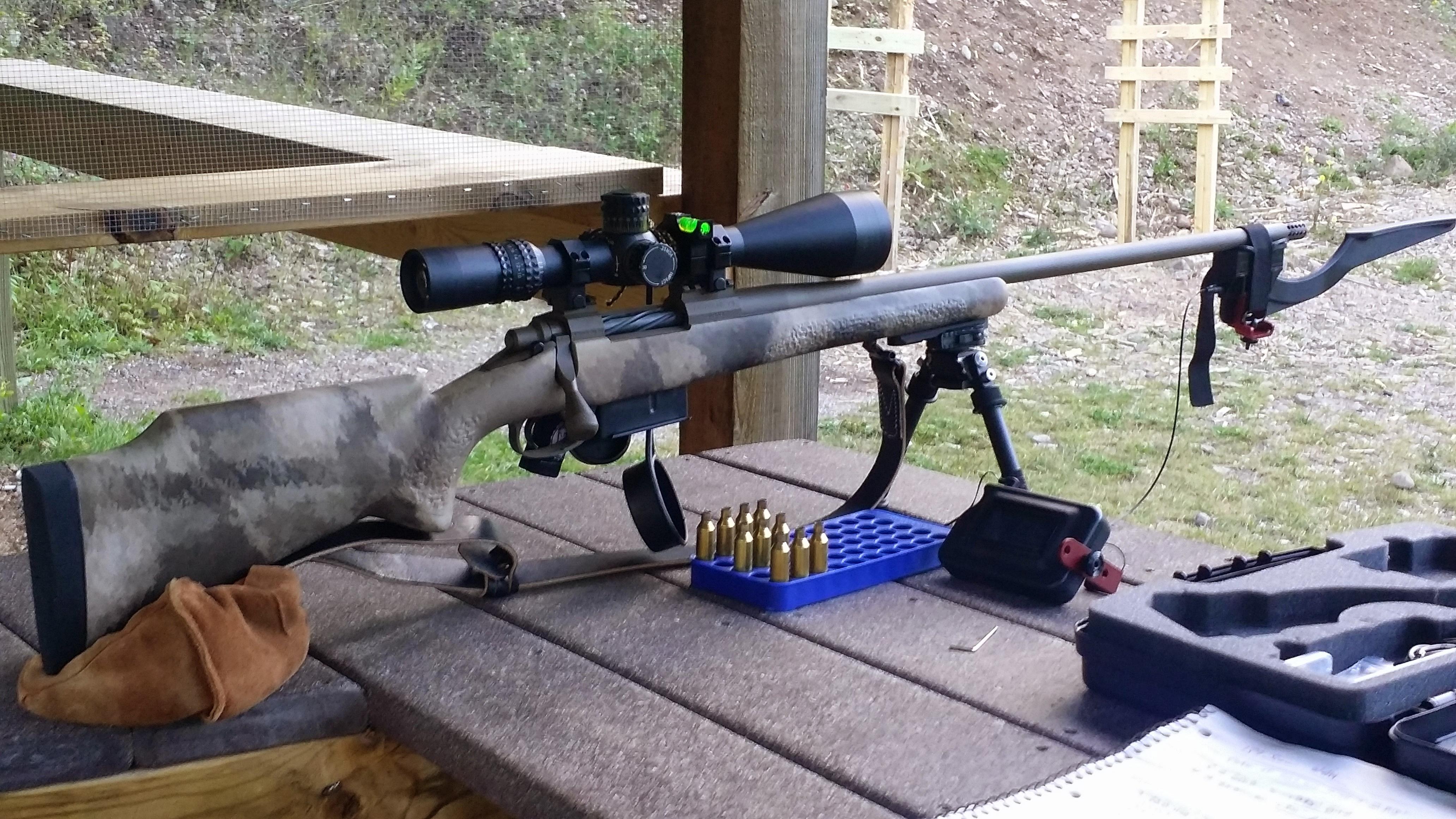

Tikka 6.5 SAUM
I got my re-barrel job back last week and thought I'd post the results here.
I had a Tikka 300 WSM re-barreled in 6.5 SAUM with a 24", #3 contour barrel, 8.70 twist. Chamber was cut by Francis Kuehl, who did a phenomenal job (more on that later).
<a href="http://s88.photobucket.com/user/gittings55/media/Tikka%2065%20SAUM/IMG_20140909_225532_623.jpg.html" target="_blank"><img src="http://i88.photobucket.com/albums/k175/gittings55/Tikka%2065%20SAUM/IMG_20140909_225532_623.jpg" border="0" alt=" photo IMG_20140909_225532_623.jpg"/></a>
I decided not to flute the barrel to start with, but may do that later. I went back and forth on a brake, decided not to. After shooting it, I'm glad I didn't brake it. Although a brake would make this gun very light on recoil, I found it to be surprisingly easy to shoot and I'd rather not deal with the muzzle blast. I had them sandblast it, with no Cerakote. I will Cerakote it later when I decide what to do with flute/no flutes.
The Mountain Tactical stock adds a pound, as does the #3 barrel over the OEM Tikka. Complete carry weight with scope and mount is 9 1/2 lbs.
<a href="http://s88.photobucket.com/user/gittings55/media/Tikka%2065%20SAUM/IMG_20140909_225725_407.jpg.html" target="_blank"><img src="http://i88.photobucket.com/albums/k175/gittings55/Tikka%2065%20SAUM/IMG_20140909_225725_407.jpg" border="0" alt=" photo IMG_20140909_225725_407.jpg"/></a>
I am using Copper Creek prepped brass, not fire formed yet. I necked the CC brass down to .291 for test loads. I may go with a .292 bushing for a little lighter neck tension. My test loads ended up with run out 2-12, not unusual at all considering the prep work.
I'm shooting 140 Accubonds, as I'd like one load for lopes/deer/elk.

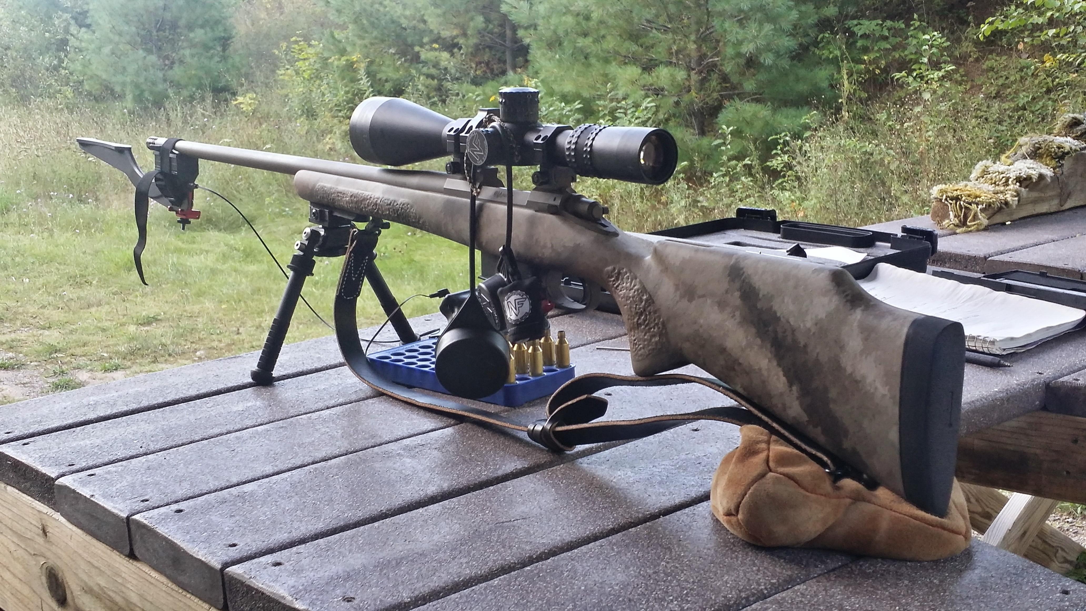

I have about 100 rounds on my 6.5 SAUM- when can I expect to see an increase in FPS? How much will it increase? Is it enough gain where a new accuracy node can be found or is everyone backing off powder charges until your getting the same velocities you have settled on while doing load developments the first 100 rounds or so?
Here is a picture from the other day, sure is a pleasure to shoot!
