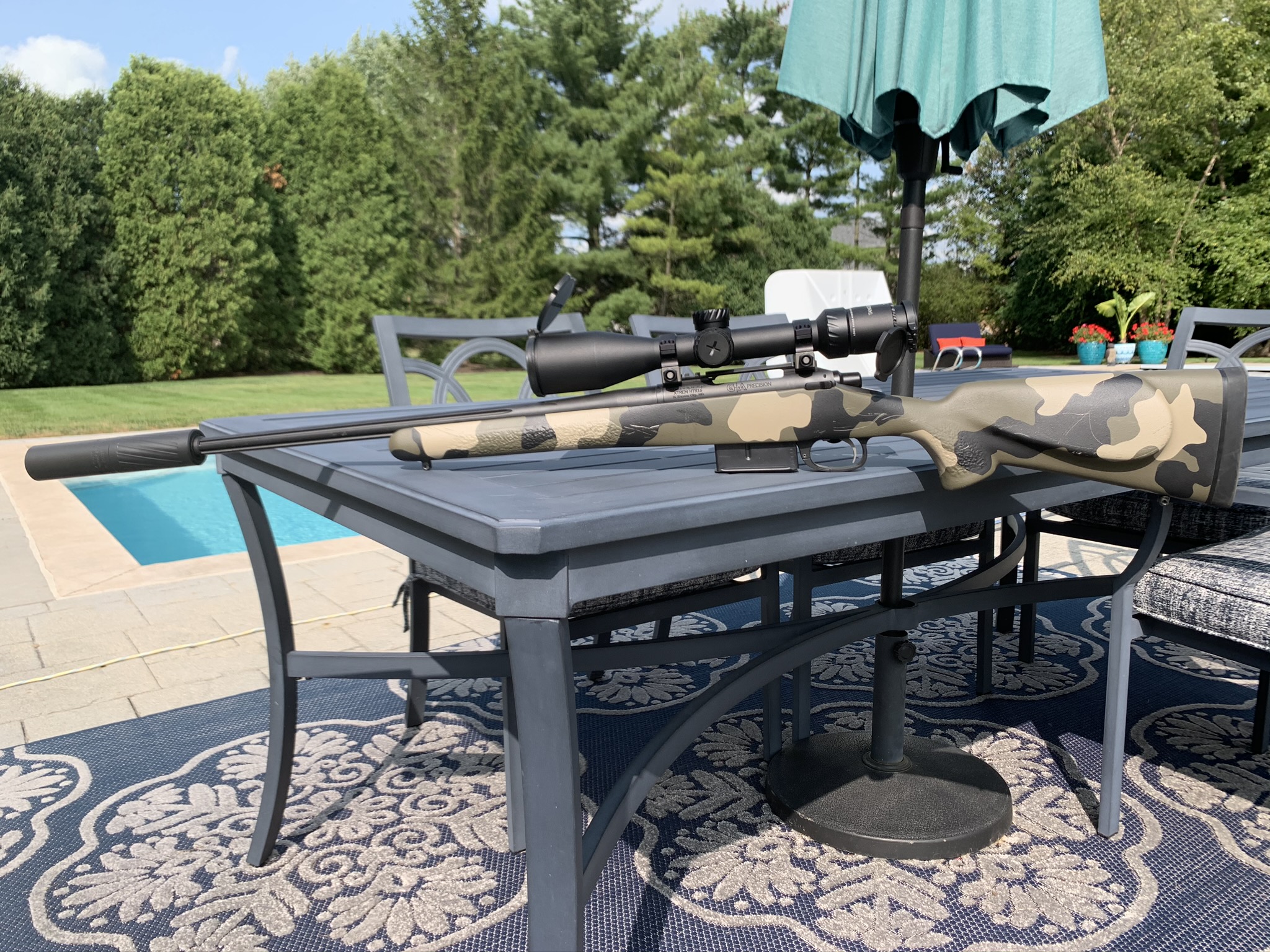

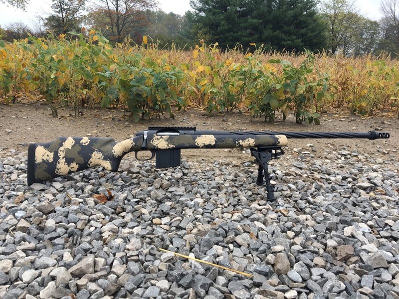

Forgot to show off this beauty in this thread. It's changed a little since then. Now where's Area 419 hellfire and a Conquest V6 3-18x50.

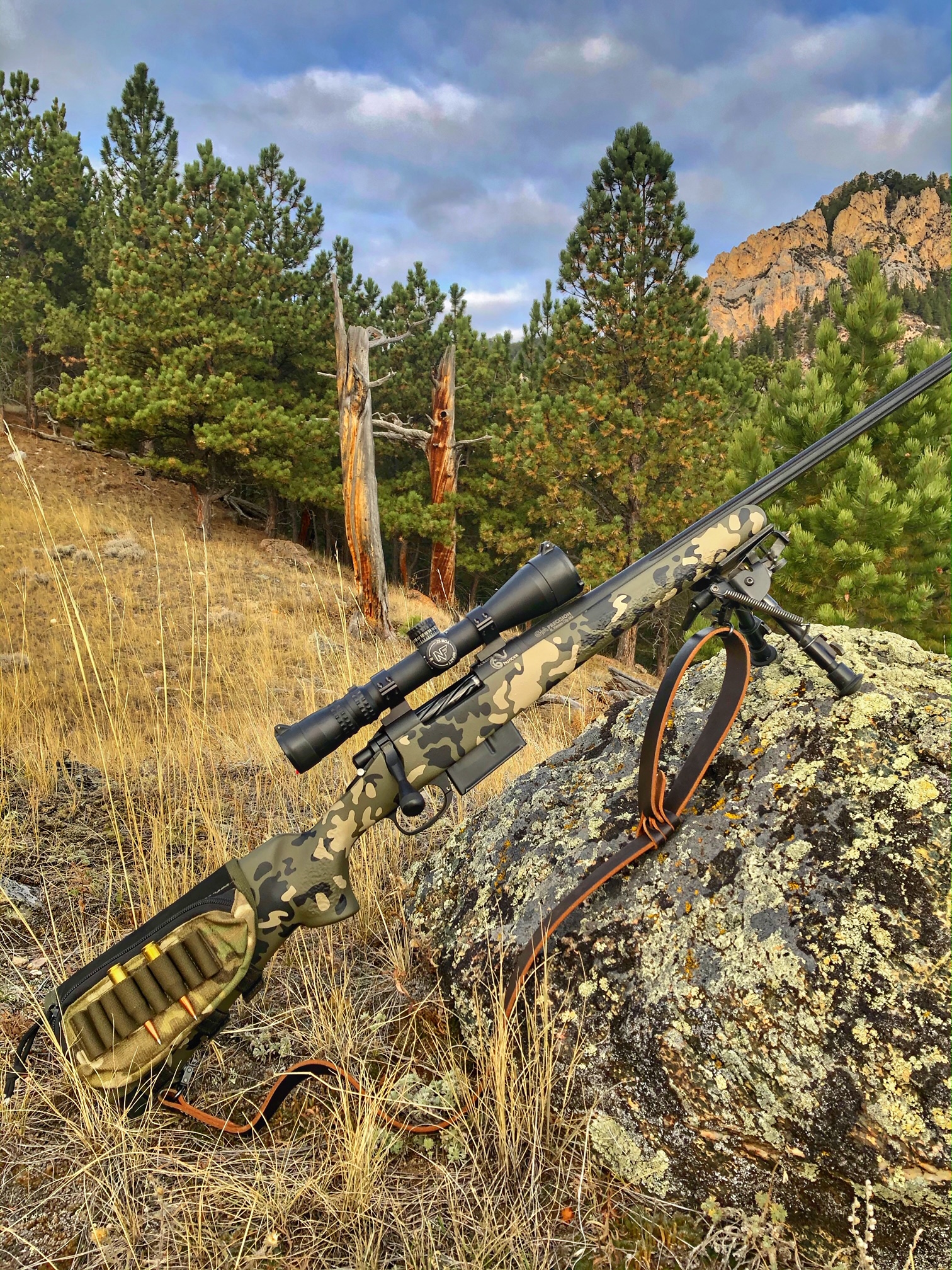

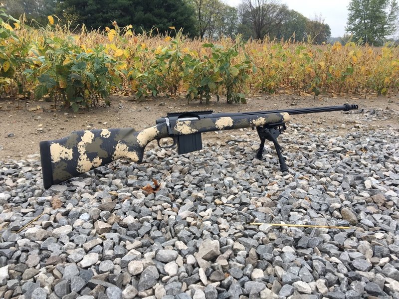

Looking to find Dad a flush mag as he says the length of the 7rd alpha is bothering him. I know Glen is coming with carbon fiber 3 round mags for AICS patterned DBM but until then idk of any 3 rounders except the Curtis Custom which is 308. Could it be modified for SAUM?

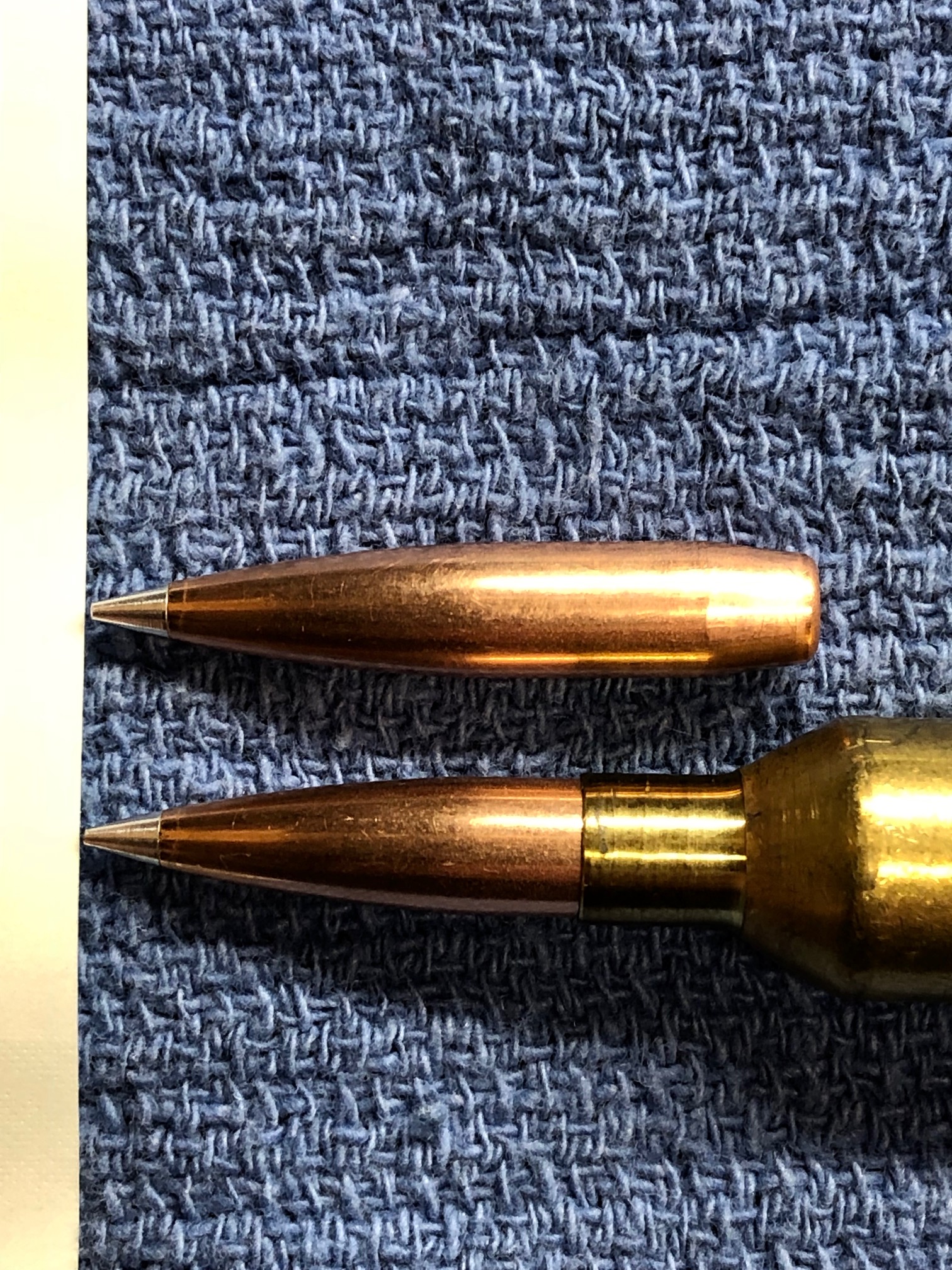

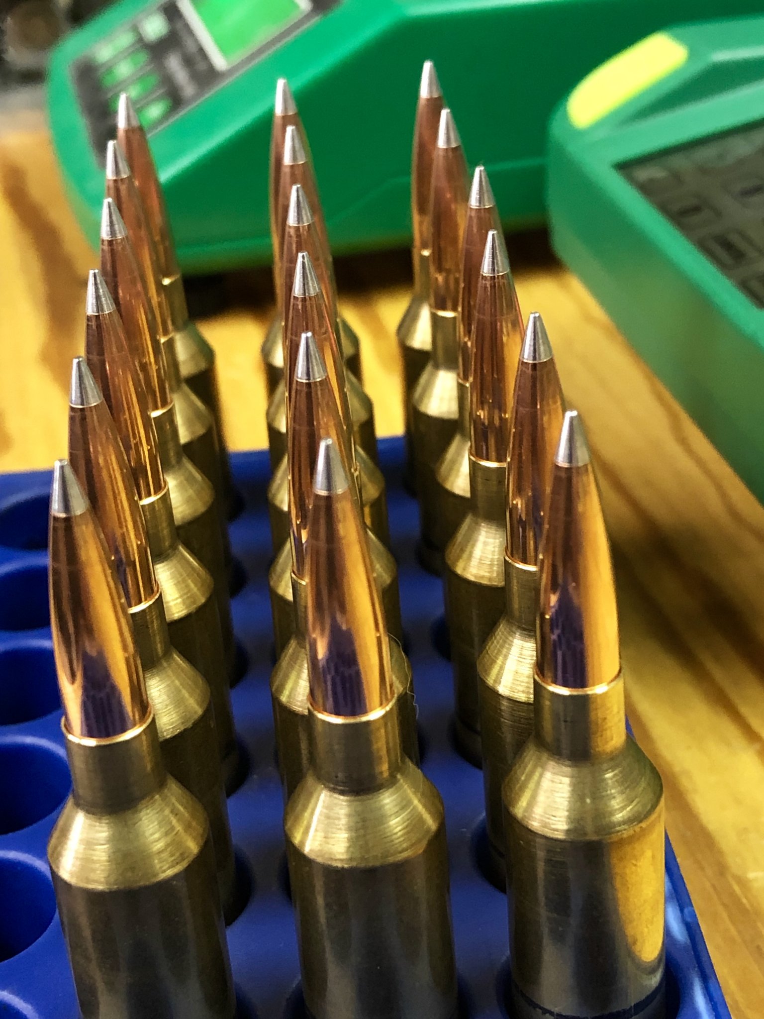

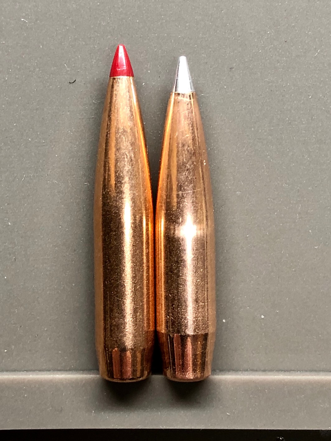

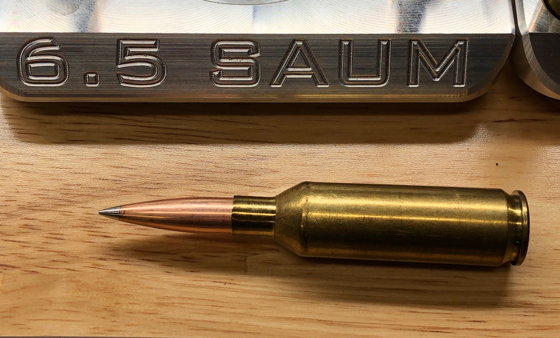

Hornady's new 135 A-tip is damn impressive ! Got some to T&E, I'll be running them out long range when the snow melts off :)
Base to Ogive is .542
Loaded 2.935 COAL which is 10 thou off. Shooting them in 120 FB, 26" Bartlein 8 twist in my heavy comp rifle. 3140 FPS
Pictures are loaded rounds, show how far bullet is seated and 135 A-tip next to 147 ELDM
