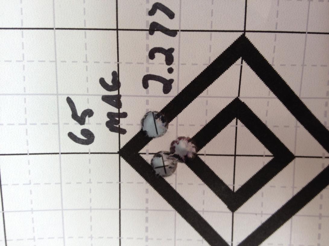

I've got an 8 twist on mine. (I've got an 8.5 twist on the way as well). Works great w the 140's. haven't shot any 130's yet though. Finally got the stock I ordered for it yesterday. Had to rob one off one of my 6.5x47 L's to get started with the shooting. Here's a pic of the rifle and a sample of a group. I think it will get a tad better by tweaking the seating depth a bit

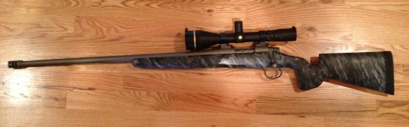

Mine is built! Now I have to get some ammo! I have 50 rounds on order from Copper Creek with the 140 Berger Hybrids...Their "house blend" for the Gap offering. My dies have been on order since March 23rd from Midway and are not expected to ship until June 3rd. I have Brass, bullets, primers, and powder....just waiting on the dies!
Gotta shoot some Cerakote at it, but it is already looking mean! I will post up some range results once I get to take her for a spin!
