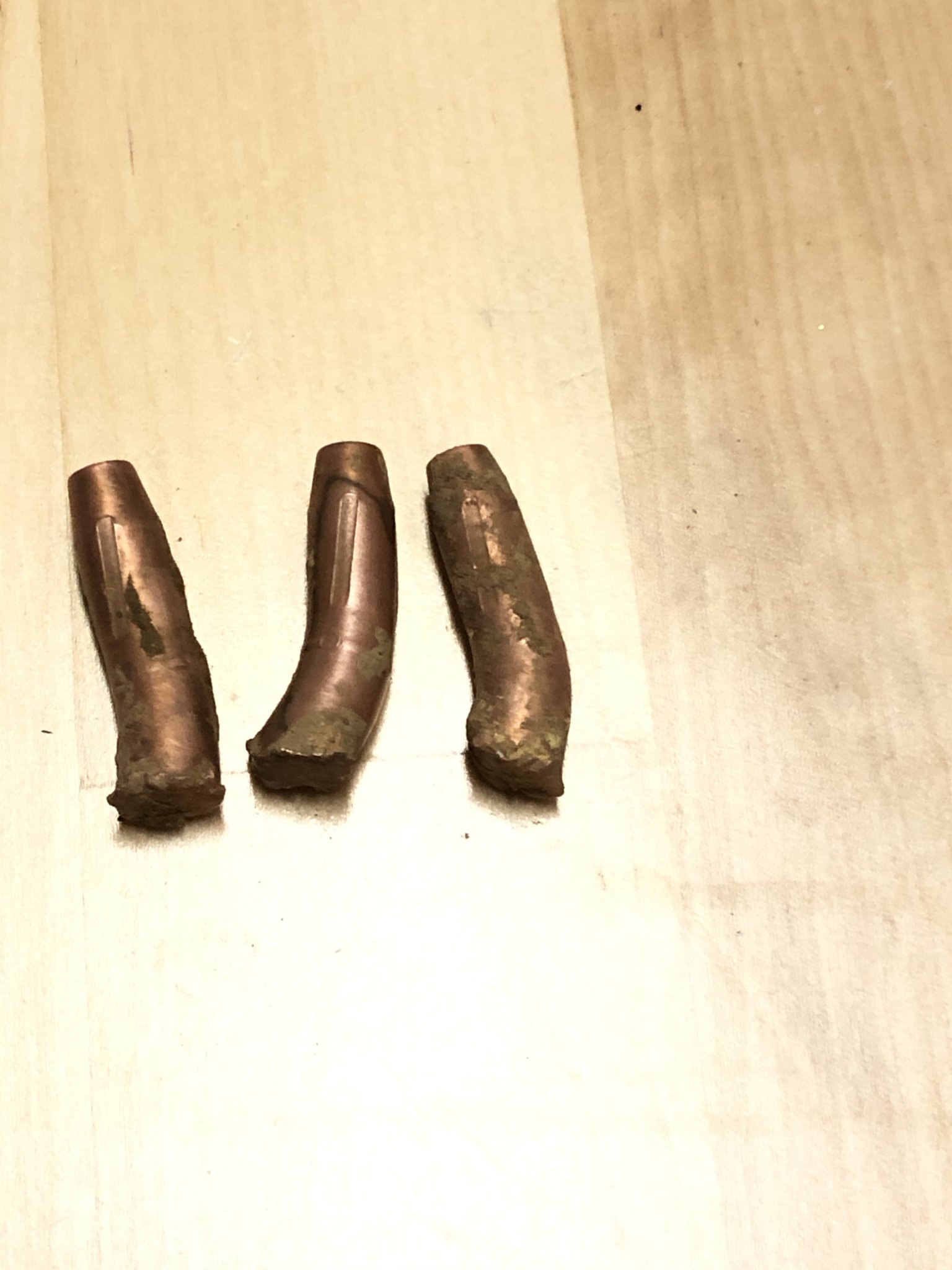

Here’s what I found in the dirt
It’s hard to say. I need to find a coyote to hammer I think. Weighed 158gr from 170. In my 28 nosler going 3100. I think I’ll take it to distance to see what bc I get. I have a 1:7 twist, so we’ll see what going on. Going to do the 185 cutting edge lazer also
To me that was alittle scary how they bent. What is the length difference between those and a new bullet? Yeah that would be great to find out. Isnt that alittle slow for the 28 with 170?
