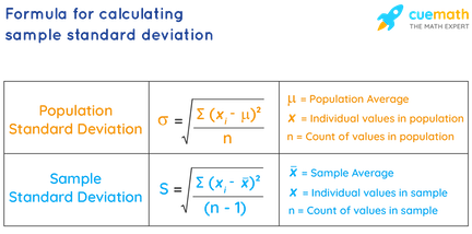

There are two ways to calculate Standard Deviation ... one (the correct way) is to use exclusively the data elements that are included in the measured group. The other is using a "sampling" methodology (not the correct way). The Labradar uses the sampling method. Lots of discussion on this in other threads. Here's a super simple example using numbers 1-through-5:
Having followed those "other" threads, I do not agree with you. Regardless, if we measure enough samples to get statistical significant answers, the two results are so close to each other as to not make a difference. And seeing that Labradar uses the same method as other chronograph manufacturers, you cannot use that as criticism of Labradar.
There are enough criticism as it is, no need to artificially create more.
Rusty - This is a useful exposition but (pretty sure) fundamentally wrong.
Reactions: westsidecamper
