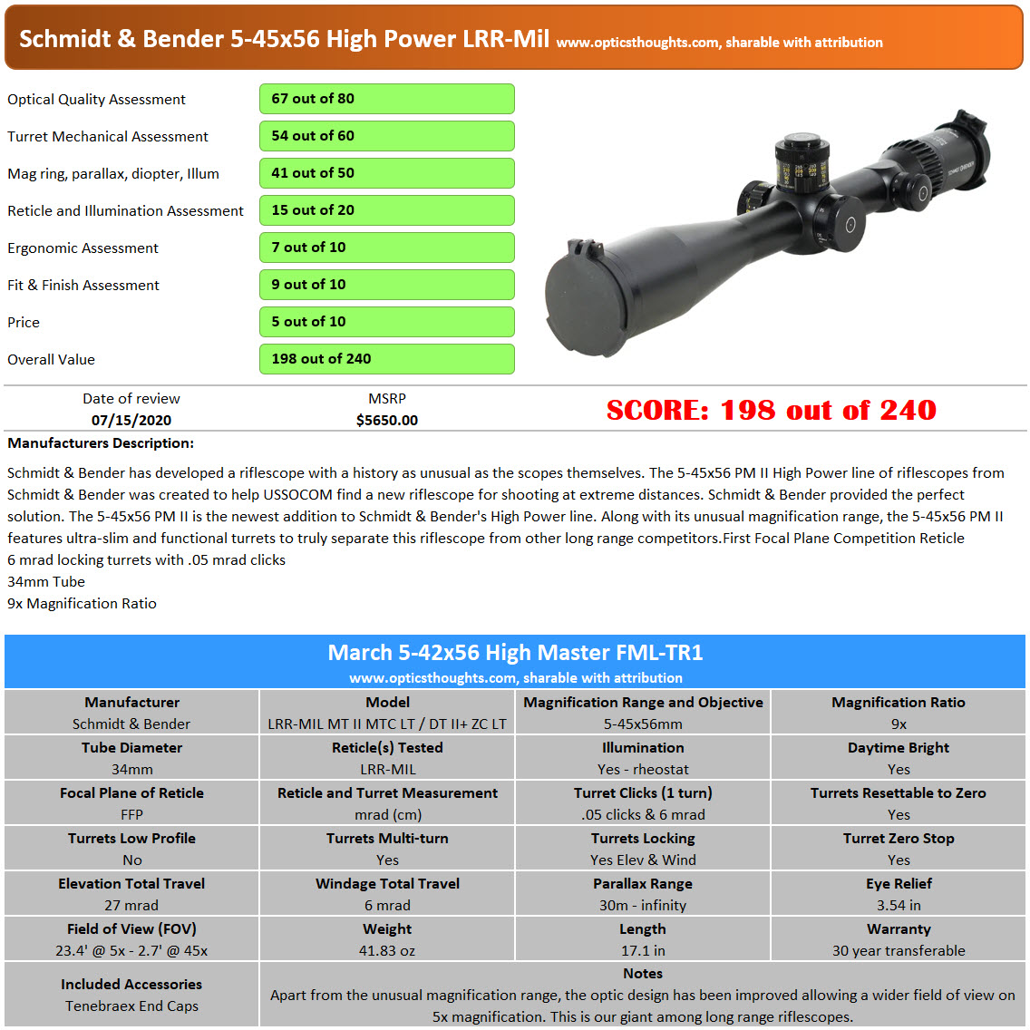

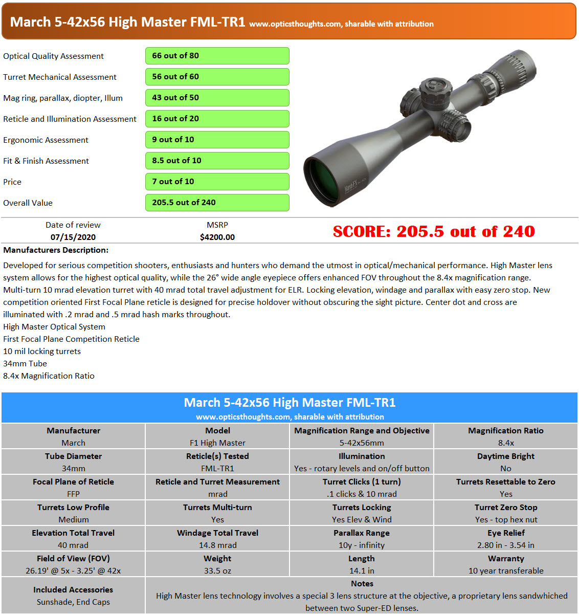

I know Frank was trying to put together criteria for a new scoring system, not sure how much they align but I tried to create some score cards for these two scopes, curious what everyone's thoughts are
I like this format for a quick review. But i prefer your detailed format because you may have rated one lower for a reason that means nothing to me or my use case.
You and ILya are in my favorite because you are presenting of the details not you opinion on how good it rates.
The numbering system is a good thought but in practice it is not suited for comparing high end optics no matter what manufactures think.
For instance I now have a Minox because of you guys detailed reviews both said that they have good micro contrast and that is important to me. Lets say it has a smaller eyebox then xyz it may have made the scope rate less but to me at this level the eyebox means very little.
I do my own optics testing etc for my own pleasure so small story lol. ILya has stated there is variation in IOR for optical quality sample to sample. I have had 3 he is correct I can verify that with my own tests. Vortex PST gen 2 I have had several the new ones are not what the first ones where.
So thanks for the detailed work you guys some of us really appreciate it and dont have access to all the optics to see for ourselves.
I use these to test optical quality. I think you could create a numbering system for it but best would be to have 3 numbers red green blue as the different colors show different characteristics of when the optic will fail. The white and black mean very little for real world proformance. You can definitely tell which has better micro contrast and resolution.
As you can see I'm into details lol. Cheers

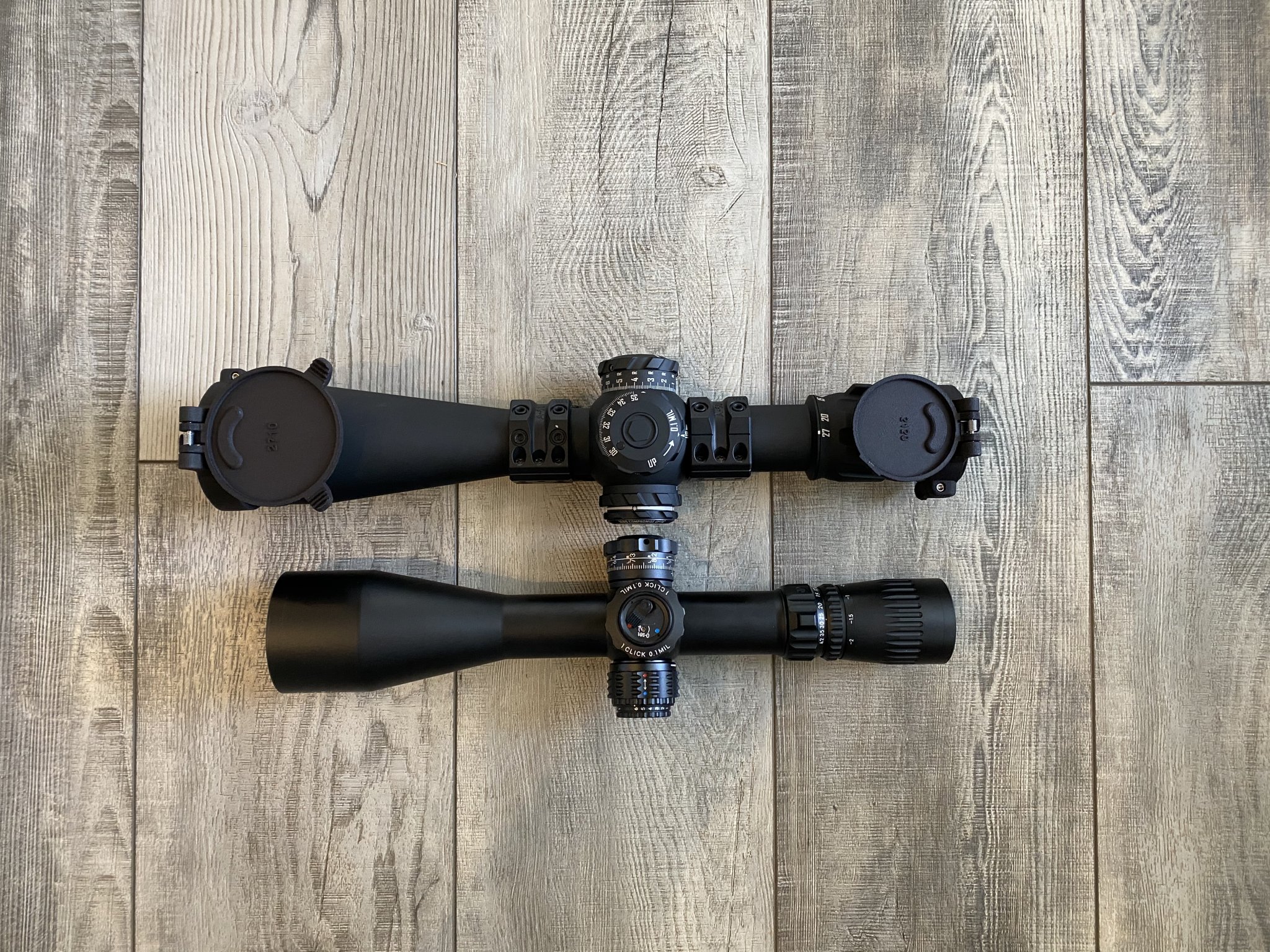

Just received my 5-42x56. I've had a brief look through it as compared to the ZCO, but don't want to say too much until I get it out to further distances. It definitely has a wide FOV for the power level it's set at, and I do see the edge softness discussed. I'll see if it only extends beyond the 'normal' FOV on the ZCO, in which case, it's not a massive negative.
One thing I will say, the illumination is not anywhere near daylight bright. It doesn't matter to me, but don't let anyone tell you otherwise. It's barely visible at level 6 (max) on a treed background in Texas. It's closer to min/low illumination on a Razor G3, for example. I will compare with the ZCO illumination later.
Also, as noted, the 'zero set' on this scope is somewhat 'soft'. The click just prior becomes more difficult, and then the actual click is fairly firm, but you can keep going if you want. I'm not going to experiment with this, as I have no idea if it's dangerous to the scope, but this really should be a hard stop. That said, you'd have to 'try' to twist through it.
On a positive note, I can say with 100% certainty, the turrets have a better 'feel' than my ZCO by a good margin. Between the spacing of clicks and the feel of them, these turrets are VERY nice.
Picture is a ZCO 527 next to the 5-24x56. I'm not taking the caps off the ZCO, but rest assured, the 5-42x56 is definitely a good bit smaller.
I look forward to hearing more about your side by side with the ZCO and especially once you get a chance to use both scopes in the field. Your thoughts on illumination mimic my experience as well, it's not horrible but it's not anywhere close to the illumination of some of the better scopes out there, low light situations it will do very well, but not really daylight situations. Also, your thoughts on the turrets mimic my experience, some of the best clicks out there, very distinct with very little play and really good spacing. I was hoping the new 4.5-28x52 was going to inherit the same turrets but for now they do not, still nice, but not as nice as the 5-42. I also like that you can turn the locking feature on and off, so if you don't want it locked you can leave it unlocked and you don't have to worry about messing with anything each time you adjust. Like you said, the 0-set is not a hard stop, you crank down the hex key on top and find increasing resistance, but if you manhandle the turret hard you can go beyond the setting - not sure if this will loosen over time or if it will stay pretty solid, but for those who like to go by feel alone, they may have issues with "did I really go all the way to my zero stop or did it go slightly past or short of the mark", I did a "blind" test where I spun forward then spun back and every time it stopped where I set it so maybe it's more reliable than it first appears. It is a surprisingly small scope, for a 5-42x / 8.4x erector it is extremely compact.

In my review on Opticsthoughts, I compared to the Schmidt 5-45 only, I did not compare to the ZCO or Minox ZP5 because I didn't feel that was a fair comparison; however, I may be getting another 5-42 specifically for comparison to the ZP5/ZCO similar to what you've done.
From what you say above, it sounds like you would put the 5-42 on par with the IQ of the ATACR series glass, maybe a step above Razor HD Gen II glass, but definitely not at the level of ZCO/TT. The price of the 5-42 is about $1000 more than ATACR 7-35, but you're getting more magnification and an even more compact package, I think those are some of the tradeoffs when comparing against more tradition 5x erector designs. If I do get another 5-42 to play with, I think I'll try and ask one of my friends who have ATACR 7-35's for a day of fun and see how those compare.
