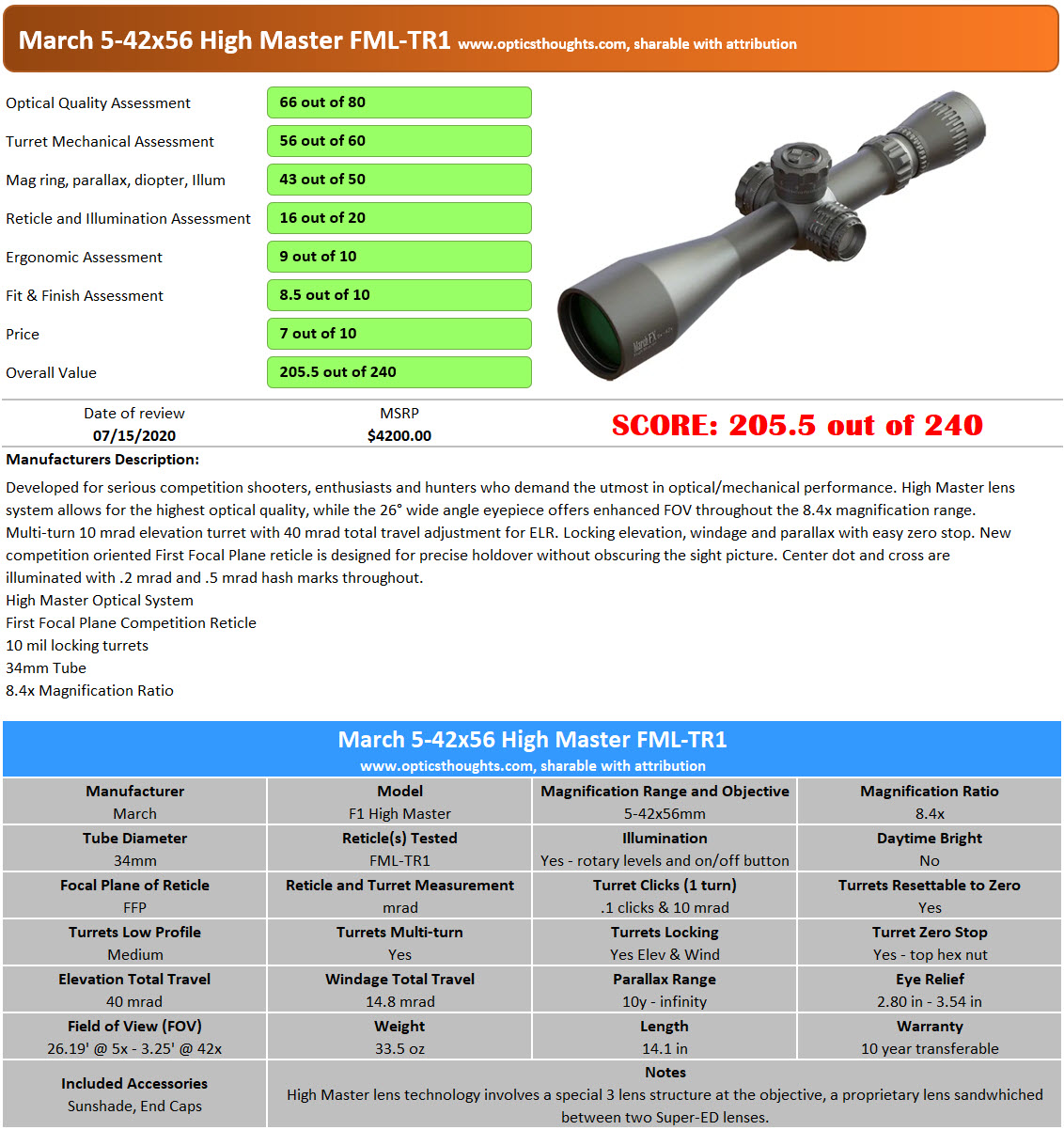

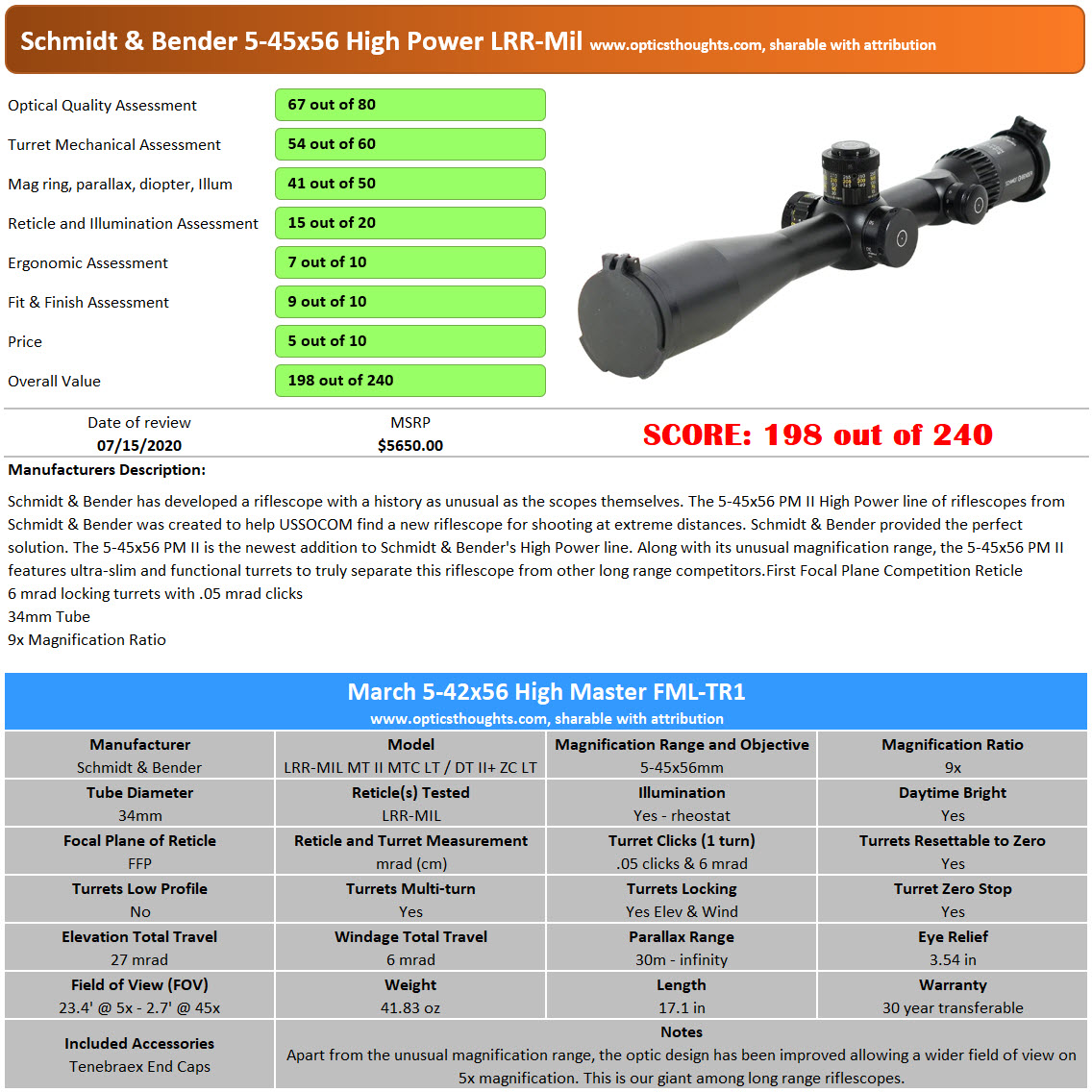

Rifle Scopes New March FFP 5-42x56 High Master FML-TR1 preliminary review
I have updated my review above in post #2 providing a more thorough optical evaluation. I will be putting together a thorough evaluation between the March 5-42x56 High Master and the Schmidt 5-45x56 High Power on opticsthoughts.com so keep an eye out over there.
Great review wjm308!! I've enjoyed reading many of your reviews on here. I was wondering if your thorough evaluation with the S&B 5-45x56 High Power has been completed/posted yet? I'm very keen to read the report.

Excellent review, extremely detailed and well presented.
I have 2 comments:
1- The March-FX 5-42X56 reviewed here is not the first FFP March scope with the High Master Lens system, that would be the Genesis 6-60X56.
2- In the section about the magnification ring movement, it is stated: "(In the S&B,) the magnification throw is much wider and my particular model exhibited a slight rough feel while the March throw was shorter and very smooth throughout the entire range. "
Yet in the Overall Fit & Finish, the S&B gets the edge by .5 with this statement as the reason: "the smoothness of each mechanical feature." One could see these two statements as contradictory.
I know, I'm picking nits.:)

Well that is an excellent point on the Genesis, I always forget it has the High Master lens system. With regard to your second statement/question the first system is specifically dealing with the magnification and then the final section is the entire mechanical system as a whole, even though the Schmidt had a slight rough feel on the magnification throw itself, it doesn't detract from the overall fit and finish.
Reactions: Bravo6 and Denys
I know Frank was trying to put together criteria for a new scoring system, not sure how much they align but I tried to create some score cards for these two scopes, curious what everyone's thoughts are
