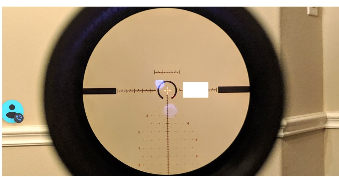

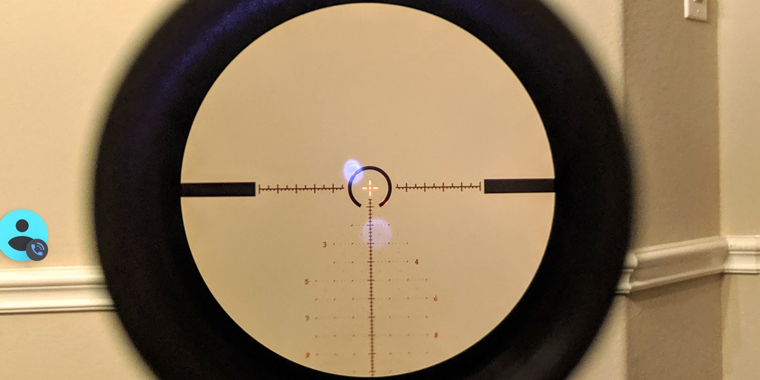

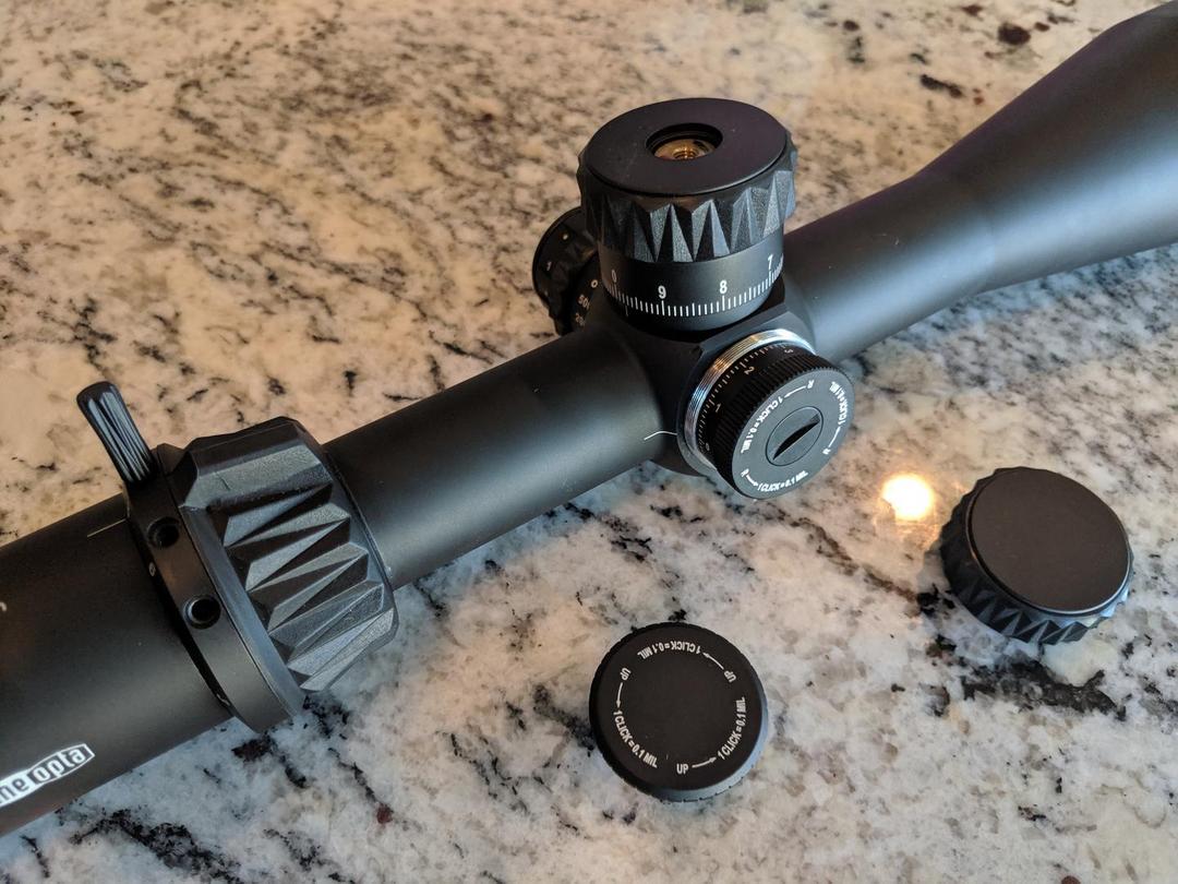

I was wrong...only cross hairs are really illuminated (3-18). The rest of the reticle has a faint red backlight glow to it. Attached is the illumination set on level 5 of 6, and @ 12X.
I have 25 MIL of adjustment; without touching the zero stop yet. I assume the default position of the zero stop is disabled.
Could you show some more pics of the reticle at max and min power?
Do you have any similar scopes (PST G2 etc) that you can review it against?

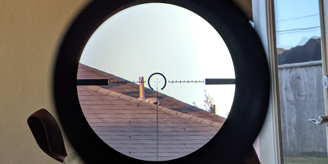

attached are 3X and 18X...unfortunately you need those fat bars and circle @ 3X.
I have a 5-25 PST G2 that i will bring to the range with me on Monday. will do my best to try and compare....thinking of setting them both at ~ 18X and see what differences there are.

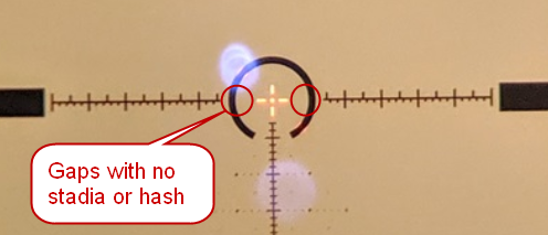

I understand, unfortunately those gaps are right where a lot of wind holds happen for me, my personal preference is to not have a huge gap from center dot out, this bugged me on the March FML-1 as well, it was too much distance and leaves me to figuring out, am I holding at .7 or .6 or .8?
Then the 5-30x56 with MRAD is for you.

I bought the 5-30 and overall it looks great. Very solid, nice reticle nice turrets, I have not mounted it yet. Just wondering how it will hold up banging it on props. Time will tell.
Have any experience with the Ares ETR? If so, care to offer up a comparison?
Thanks!
