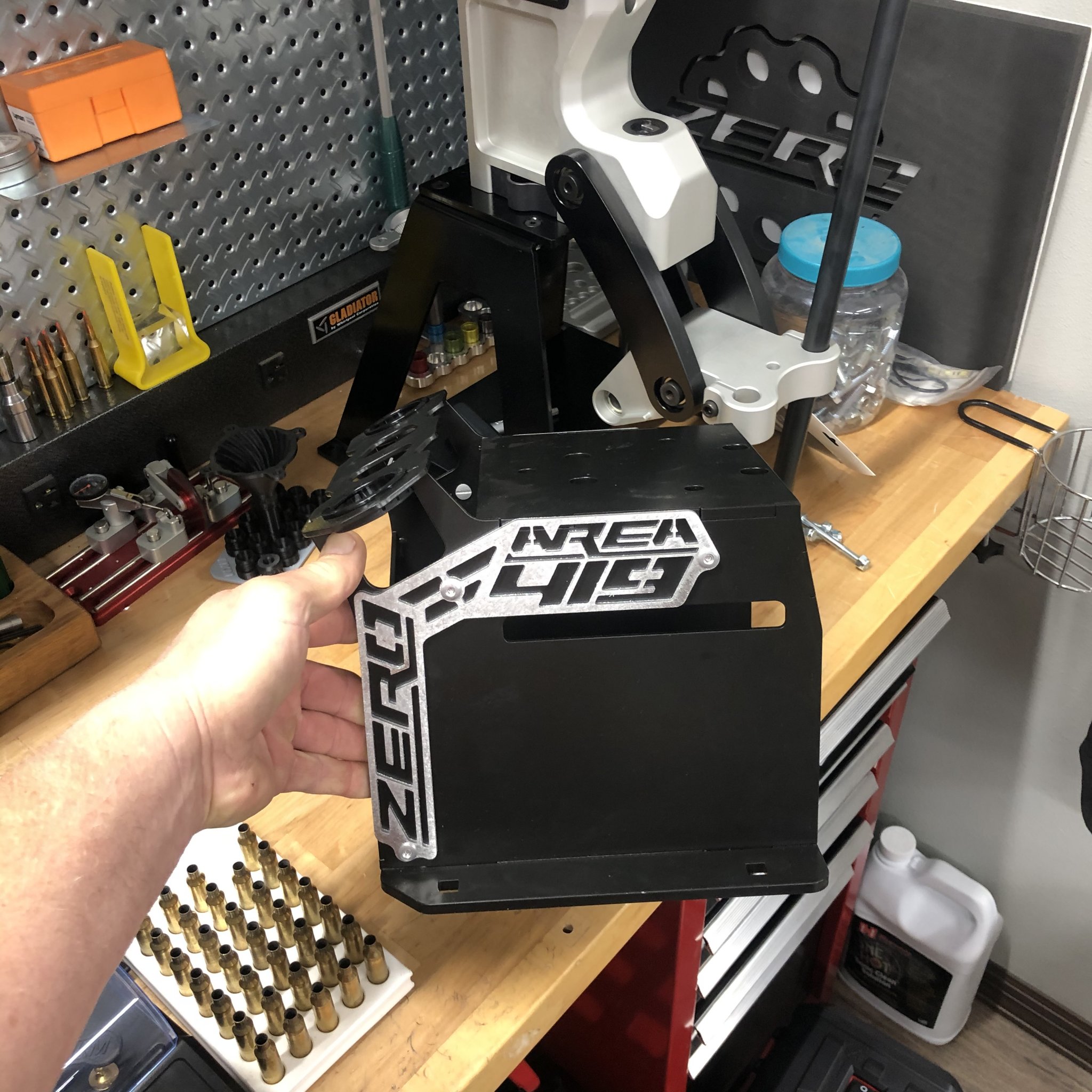

Does someone have the hole specs for the Big Dog Zero mount? I have the Inline mount on my bench and use the QD (had a redding and a co-ax as i run both 7/8 and 1 1/4 dies) and that Big Dog Zero mount is all i likely need moving forward but wanted to see if could reuse my holes in my reloading table.
They are not the same hole specs. In my picture, the ZERO Is on a Inline Mount. I have it now mounted on the Big Dog Mount and had to drill new holes.

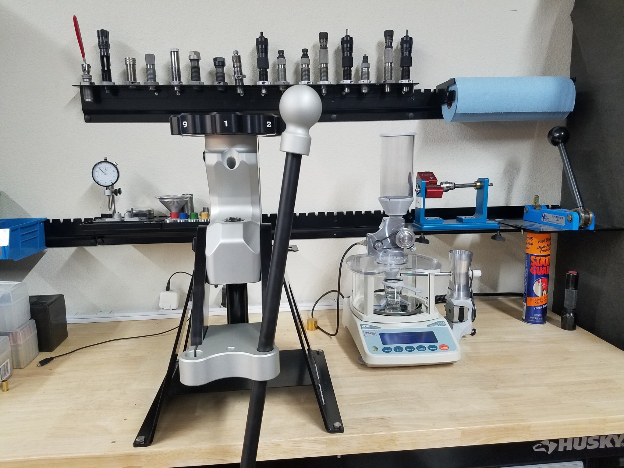

Mounted on an Ultra mount. It's 6" too tall but the other mount won't be here until next week.
