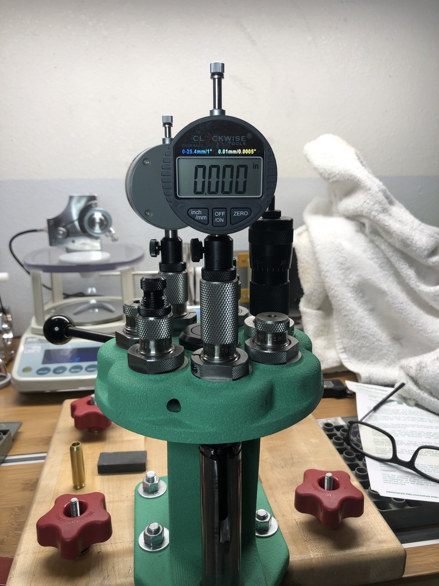

Can you provide a description (and pics!) about how your "mounting plate" (is that a cutting board?) for the press connects to your bench?
Lol.. yea one thing about Redding presses, that textured finish gets dirty quick if you touch it with dirty hands. I always use the turret handle. Oh and yea, I always use latex shop gloves from O’Reileys too when I reload.Your T7 is way too clean!
Nice setup.A turret style press is great. Especially if you want to check for consistency on the fly. And with different calibers all dies setup on one turret head. Once all set, no need to fuck around with them. I always check after sizing and seating every third round for consistency with a spin of the turret. Hits the mark all the time..lol. That’s why I think this 419 press with 9 stages leaves room for more work flow..

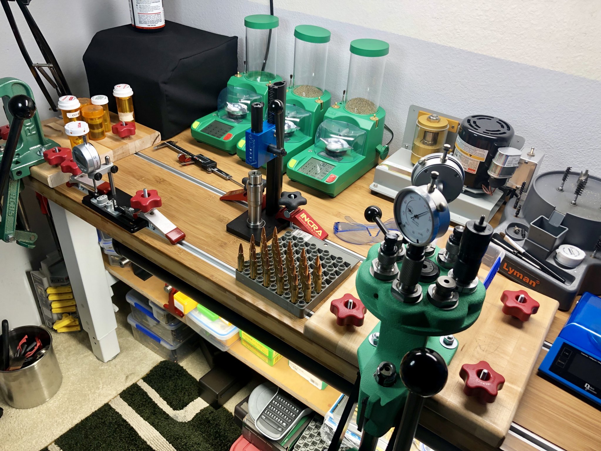

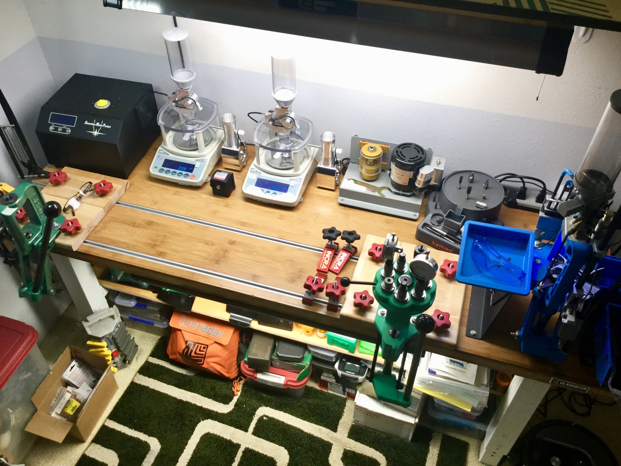

I routered in some T-tracks on my bench to make room. By removing or sliding my presses. I can even locked down other tools too.. sorry some old picture..
Yea my reloading bench is small. Had to improvise.. lol.That's a great way to go.
verrrry nice!
