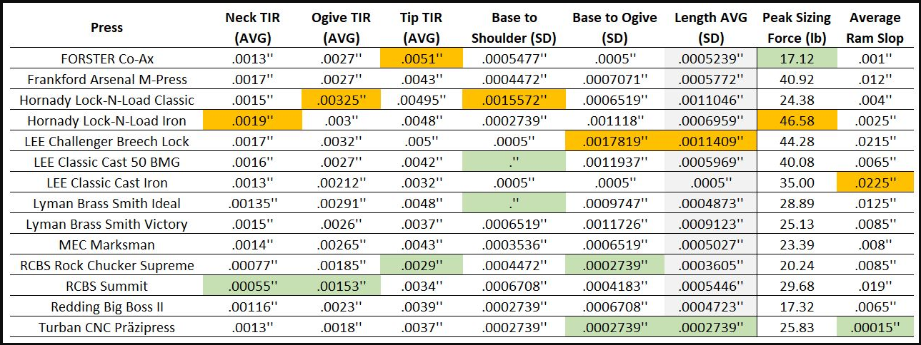

I'm not sure I follow how testing the Zero objectively versus other presses will be difficult? That's the exact data someone like myself would need before considering an investment like your press. And this is the data I think you would need for your own ability to market the press as being better than any other press besides how it feels.
Take 100 fired cases from a single rifle, in a generic caliber like 6.5 Creedmoor. Take 1 FL sizing die of known quality and reputation, i.e. Redding Type S bushing die or Forster FL non-bushing die. Using the same lube brand on each case, and best attempt to bump each case 0.002", size them on:
- Zero
- Co-Ax
- Rock Chucker
- Cheapo Lee
- Big Boss II, PraziPress, T7 Turret, etc
Measure and report the runout on each case.
Then do the same thing seating bullets. I don't care if you take those same cases and "stack" runout, i.e. load bullets into cases with high runout from sizing, or take 100 perfect sized cases with zero runout (which would eliminate the before and after variable of what induced the bullet runout).
Many people use $110 arbor presses to seat bullets, so prove to us that the Zero meets or exceeds loaded bullet runout compared to an arbor press or any of the above-mentioned single stage presses.
If you have a press that can best all the others out there both in sizing AND seating, then you will have a winner regardless of price. Just like owners can justify a TT or Prometheus or an AI (hehe) or whatever, they're not just paying for feel, they're paying for measureable performance and repeatability.
- Zero
- Co-Ax
- Rock Chucker
- Cheapo Lee
Beyond that, the rounds need to be tested in a rifle affixed to a testing device, to see what level of precision each of the loaded rounds has.
Run-out doesn't really mean anything if it doesn't show up down range.
I'm not sure if people (or A419) are ultimately expecting more precision from the ammo as a result, but if so, some method of testing as we are talking about would be a good way of measuring that.
I do agree though, one could certainly do a quality test of the resulting ammo from the press vs others if they were so inclined and implemented the correct processes and controls.
- Zero
- Co-Ax
- Rock Chucker
- Cheapo Lee
This is exactly the testing that Gavin at Ultimate Reloader has done and published, and exactly what you can expect.
I can say it again, I can say it louder, I can say it different ways, but what you're desiring is exactly what is going to take place. If you've read through more than a page of the thread you'll see this answer given as best I can.
The test, however, will not be blind. Blind and objective are not the same thing. It's virtually impossible to do blind testing of something like this as it requires real interaction.

Reading this thread, with very little chance that I’ll save up for one, it still struck me how aggressive some of the comments seemed. I’m not surprised really, having been on SH for many years, but it did make me wonder what purposes some people have for asking the questions that they do.
Anyway, I happened to check out this guy Gavin, since I normally don’t watch a lot of utoob vids and wouldn’t you know that the first vid that came up was comparing 14 reloading presses. Why I felt that it was pertinent to this thread is that he spends the first 7 minutes of his video explaining the methods and techniques he uses to compare one press to another.
For those of you that have doubts about his methods, I suggest you watch the first seven minutes of this video. It was enlightening.
It would be quite easy to test if a press could improve ammo performance. Just have someone load a significant number of rounds in press A and press B. Record which rounds were loaded in which. Hand them off to a thousand yard benchrest shooter and have them shoot groups with each lot, and don’t tell the shooter which rounds came from which press. There you go. Blinded test.
However, if a press could improve the performance of ammunition, it would likely be something like 0.01 MOA on such a test (and you’d need a staggering number of rounds to discern that). Remember that benchrest shooters have struggled to find any correlation between runout and performance.
And, I don’t hear Area 419 saying this will improve the accuracy of your ammunition. I hear them saying that if you want to spend a premium price for a really fucking nice press that will bring you a little joy every time you pull the handle, they will take your money. And that is very reasonable.
Yeah it's a really extensive and great test. He has an article to go along with it, as well as the results in a spreadsheet for anyone that is interested. Most of the presses actually do pretty well, and if you only size on the press and bullet seat on an arbor press, they're all really close in case runout performance.
