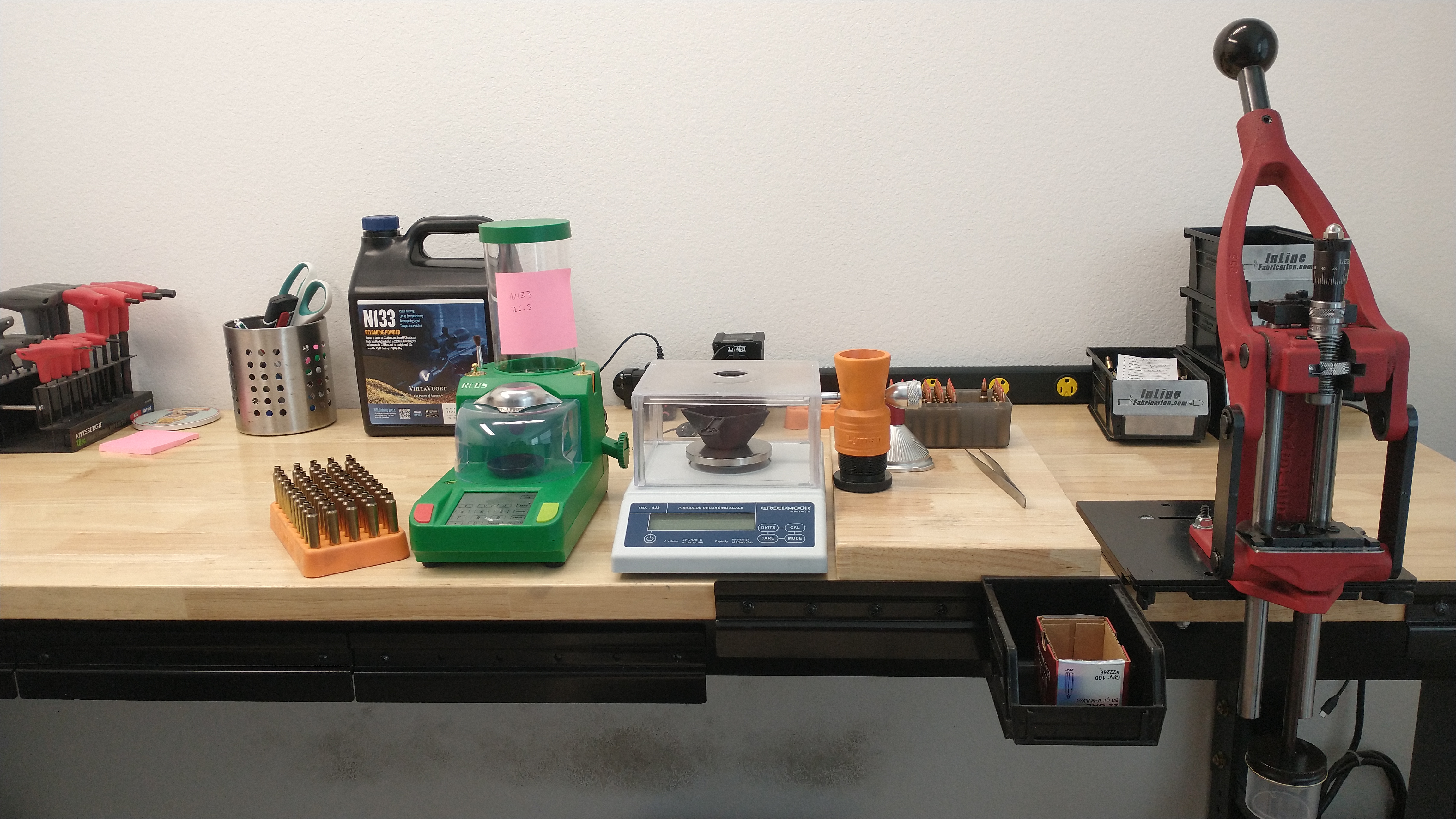

Thank you so much for the details, and particularly the pictures of your reloading setup and checklist/data card!

Having gone through this earlier this year, I can say don't overthink it. I started reloading my bolt 223 over the last month and the learning curve wasn't very steep. Just spent some time learning the setup, ruined 10 or so pieces of brass, and eventually loaded 950 rounds over about two weeks here and there. The ammo shoots about 0.6 to 0.7 MOA which I'm more than happy with. Here's my list that got me to this point. Spend whatever your budget allows knowing a lot of the items are going to last a very long time. I was doing it as budget friendly as I could without cheaping out on much and the ammo has turned out great and is easy to make. Next up for me is 6 ARC.
Hornady Headspace gauge
Hornady Case Gauge
Frankford Arsenal Platinum Series Case Trim and Prep System
Frankford Arsenal Platinum Series Perfect Seat Hand Primer Seating Tool
Hornady Classic press with One Shot Lube
Frankford Arsenal Platinum Series Rotary Tumbler, strainer ends
Hornady 223 Match Dies HOR545100 with 0.248" Bushing (Bushings made no difference on target)
Bullet Puller
Hornady Powder Funnel Set
Brass Cleaning Solution Armor All Wash & Wax with teaspoon of Lemishine
RCBS Chargemaster Supreme
Hornady OAL Gauge - Straight
Modified 223 Case
Hornady Comparator
