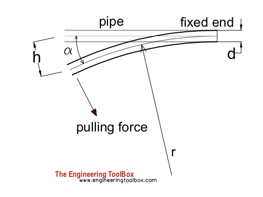

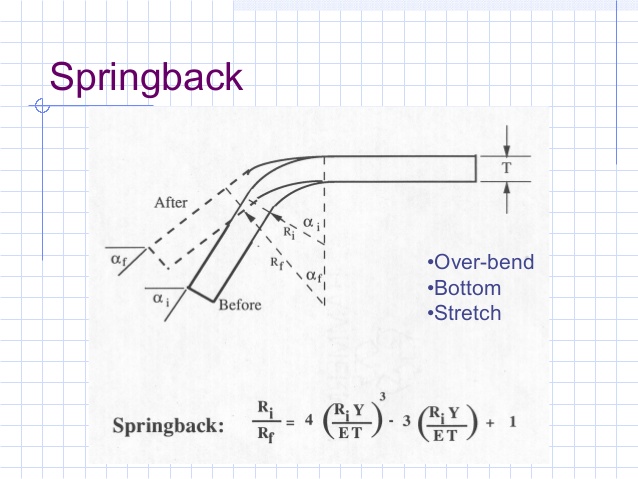

Stick it in between two close tree branches and give it a slight bend back up.
Or send it back.
You can also use a bench vise and a come-along. You have to account for springback though. I have a spreadsheet for different contours somewhere, I’ll see if I can find it.
