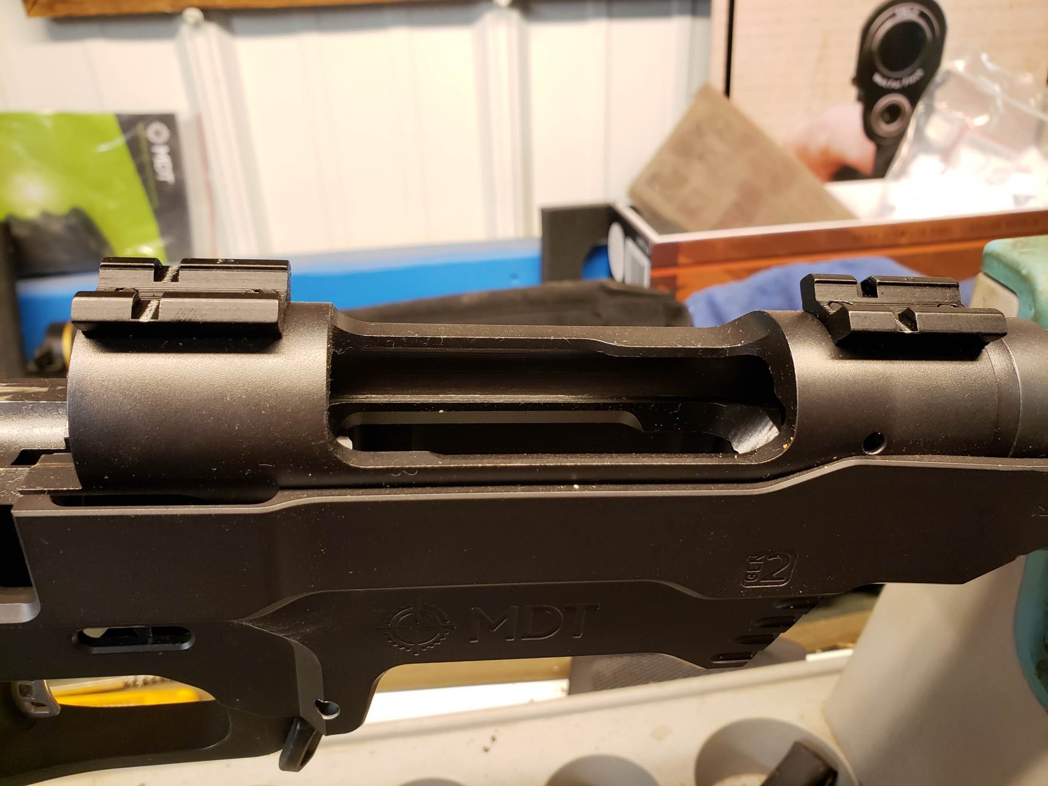

Screw a crooked barrel into a TL3 action with a Sphur mount, and TT scope, and see where your zero ends up. đź‘Ť đź‘Ť đź‘Ť
Is there a gas leak in here or something???

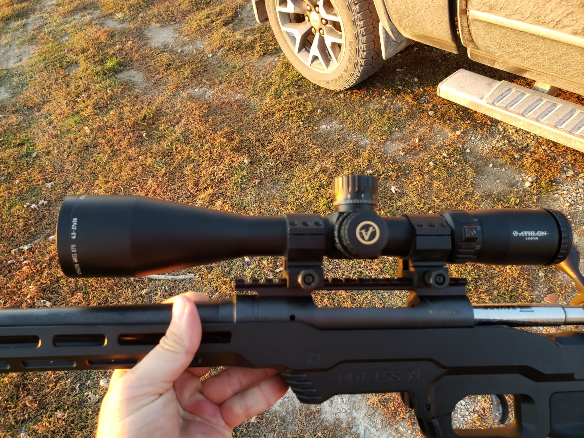

It would at least cut the error in half maybe a little more considering the scope will have more internal adjustment. I’m guessing with the equipment you proposed , the rifle would almost zero. Gotta pay to play homie.
After reading three pages of this stuff, I guess my take away is that it might be a good idea to shoot a gun as bone stock as possible before you start bolting a bunch of parts on. (obviously need a scope and mount here, but otherwise...)
I get that building out in one go seems cool, and if everything goes right, you look super awesome, but when they don't, and the "what the *&^% is wrong game begins, and you don't know where to start.
If the barrel or action is out of spec, it will be a lot easier to get the maker to take the gun back (in as built condition) and make it right when your phone call doesn't start with "we changed a bunch of things on this gun, and it doesn't work..."
Well he is correct.
Buys one of the cheapest worst designed Bolt action rifles with a long history of failure
Buys a low brand chincese import junk scope
Buys no name Chinese junk 2 piece base
Buys no name Chinese junk rings
Wonders why results are less than optimal. If you cant afford atleast decent quality then you can't afford this game. Thems is the breaks.

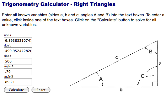

To have enough bend that looking through the breech would show the muzzle end as an ellipse, you would be able to tell it was bent from a cursory visual inspection of the exterior.
500mm or 20in barrel the displacement of muzzle approximates 1/4 inch (6-7mm)
(Trig calculation assumes the barrel is straight but off axis. Degree converted from Mils, etc)

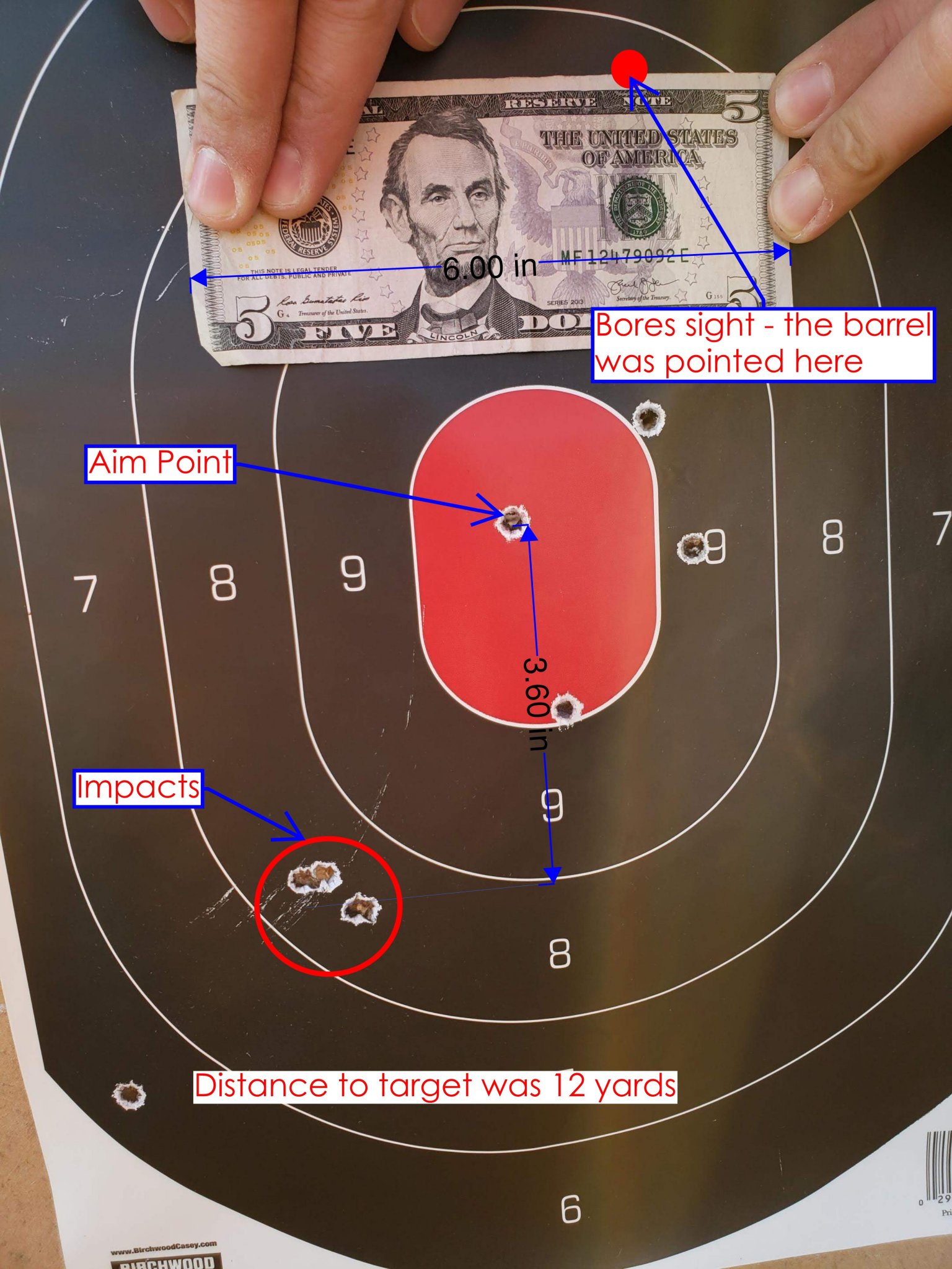

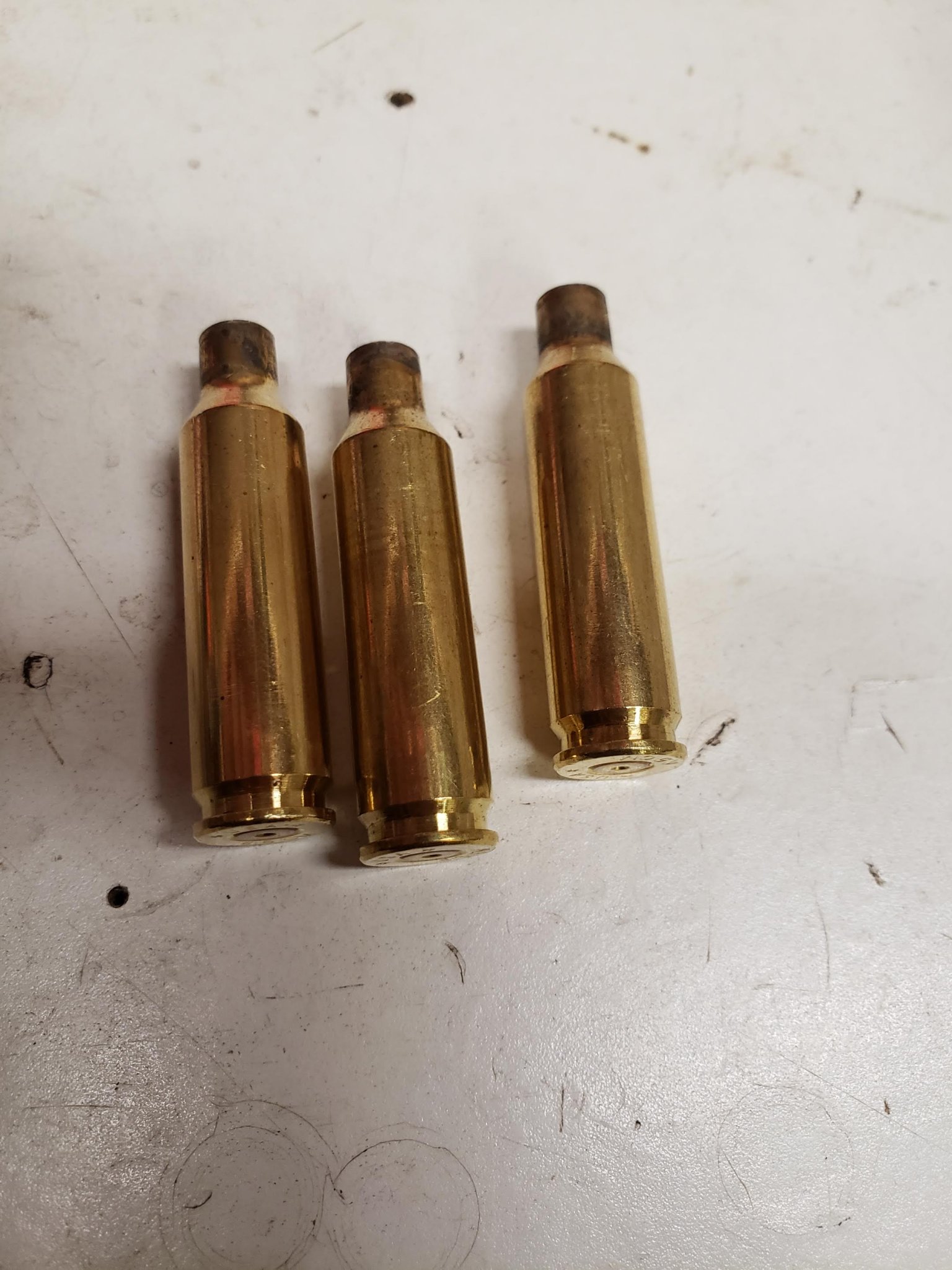

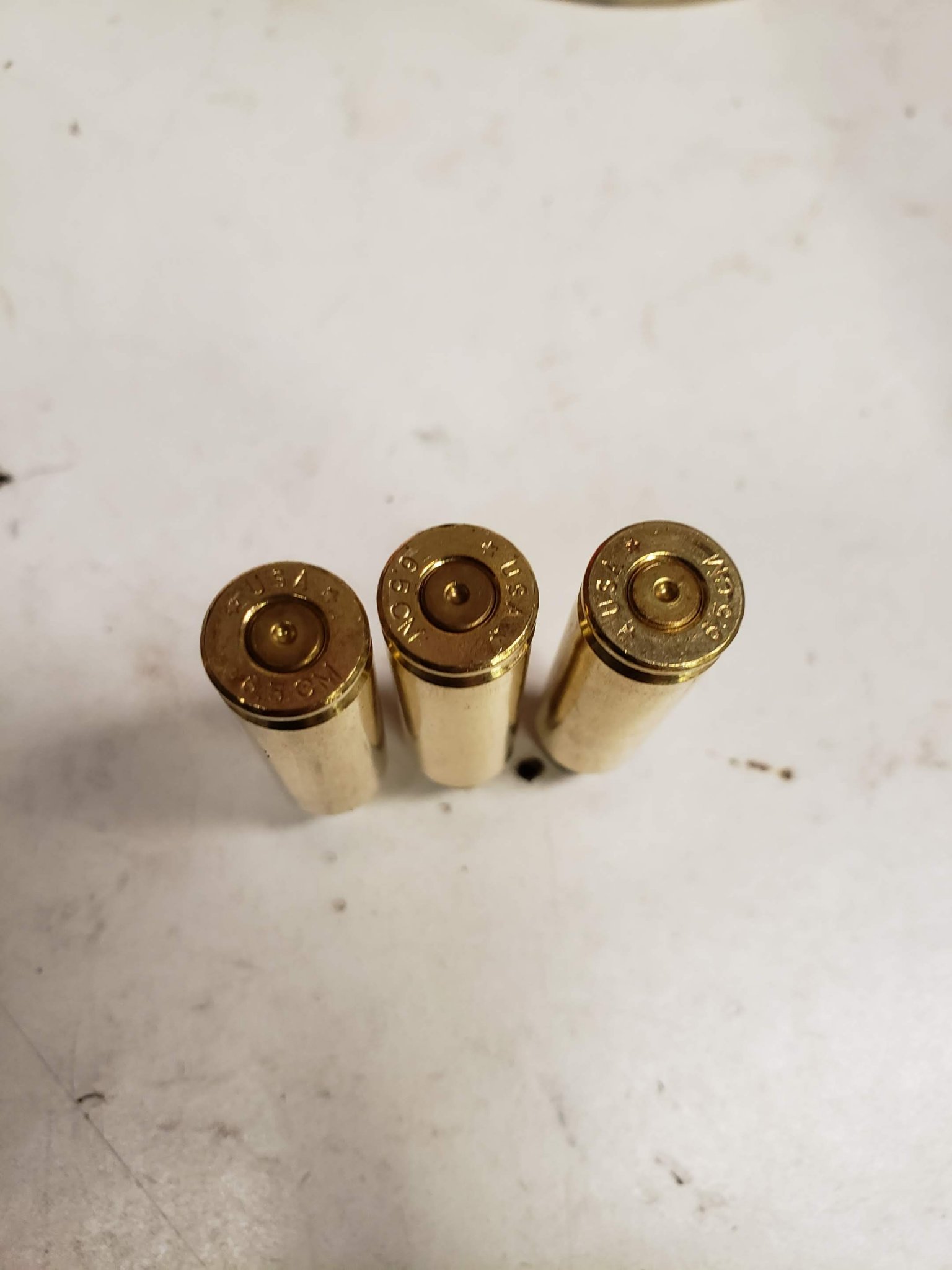

Update
Last night was our Thursday Gun Night Fun Night and I got to see that savage again. my Buddy got Plandemic tested and was negative so he could come out and play.
Last week
He took the rifle to the local gun store last week and they talked him into new rings for the scope. They got out the alignment bars and showed him the rings he had didn't line up.
Testing
We shot the rifle again last night. This time we dialed his scope all the way to top of the elevation and at 12 yards from the target we are still 3.5 inches low. This still leaves us 8 mils low and the scope is out of available elevation. I got behind the rifle to tripple check the bore sight. I aimed the scope at the center of the target and when I looked through the bore it was 4-5 inches above the center of the target. There is absolutely no way the barrel is pointed any where near the point of impact. The rifle shot about a 1" group at 12 yards, so there is some consistency in where the shots are going.
Scope, rings and base check
Just to triple check we switched to a one piece base and an Athlon Ares BTR that is a proven scope. (I've shot local comps with it) and shot the rifle again. Same result, 8 mils low. These shots actually landed within an inch of the last shots on the target.
Barrel Check
Our last step was to change back to the factory stock. As we were doing this I grabbed a framing square and laid it up on the rifle barrel. It rocked about 0.10" at the muzzle. Then I put the square on the bottom of the barrel and it had a gap in the middle about the same size. This barrel is surly not straight. About 7" from the muzzle appeared to be a change in the barrel alignment. Also, in the same area appeared to be a spot that looked different in the metal, like a fold in the steel.
Conclusions
We quite there and chalked it up being a bent barrel. Now we'll see what the gun shop and savage will do to help.
I forget to measure the bore (damn). Our next steps were to try the factory stock and then shoot it upside down but we quite.
Discussion
I know they straighten barrels in the factory. The "bent Barrel" could be the factory straightening the bore. Just because the outside is not straight doe not mean the bore is not straight. I understand this. The spot in the metal was the telling tail. Having these two together can not be a coincidence. (Gibs' rule #39) If there barrel was straightened in the factory I would expect there to be a slight taper or curve to the entire length rather than one noticeable bend. Unfortunately I didn't get a picture of the framing square on the barrel.
@Skookum had it right.
20201015_174812.jpg20201015_181153.jpg20201015_182031.jpg20201015_183928.jpg20201015_183942.jpg20201015_175800 2.jpg

Did you try dropping a 6.5 bullet in the muzzle, and is the fired brass blown out? I swear it sounds like rattling a 6.5 down a 7mm barrel.
Hey, before you laugh too hard, I had a guy shooting next to me one day figure out after 3 shots that he was trying to shoot 6s in a 7 and they wouldn't reach the target at 1000.
The part of this that is baffling to me is that you have aligned the bore with the scope POA so at 100 the impact should have been close. I've done the pull the bolt, line the rifle up on the orange dot and bring the reticle to the dot trick every time I've mounted a new scope and they are usually a little off but like you say, on a sheet of 8½x11. It makes not sense that the bore and the scope are pointed to the same place and the bullet doesn't end up there.
This is precisely why I asked about this in a public forum. None of it made sense. I don't think we could see the barrel bend through the the bore. We are aligning concentric circles when we bore sight through the bore and this 0.1" bend was not observable.
I for get to measure the bore, although I wish I would have.
