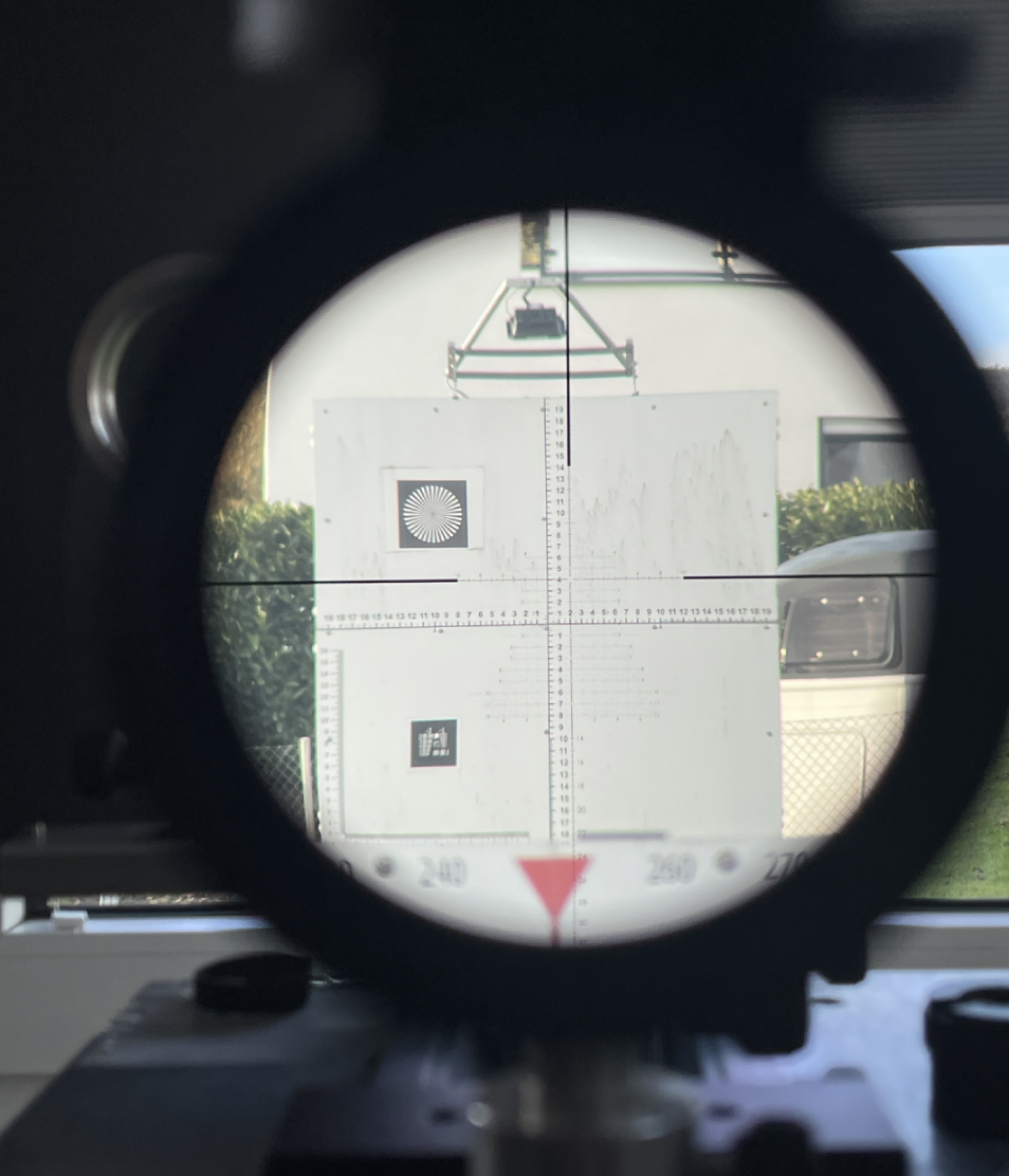

If you have a chance, it’s be cool to zoom each scope to the same mrad mark.
As in, zoom them both until it’s, say, 10 mrads left (center to the left edge) and 10 mrads to the right edge. Or whatever number you want.
That way we could really see the difference of FOV at pretty much the exact same zoom level. Doesn’t work when all you have is black lines to work with, so it’ll have to be zoomed in a bit.
Gotta point it at exactly the same spot, of course. The shots above are slightly off the same point.
But hey, just a request. Thanks for doing what you already did.
That's not really how that works.
It needs to be scaled by AFOV.
No promise, but we'll try. Might be hard to get the scopes together again.

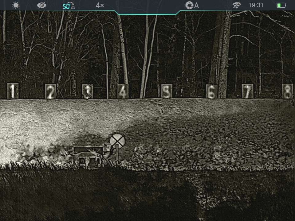

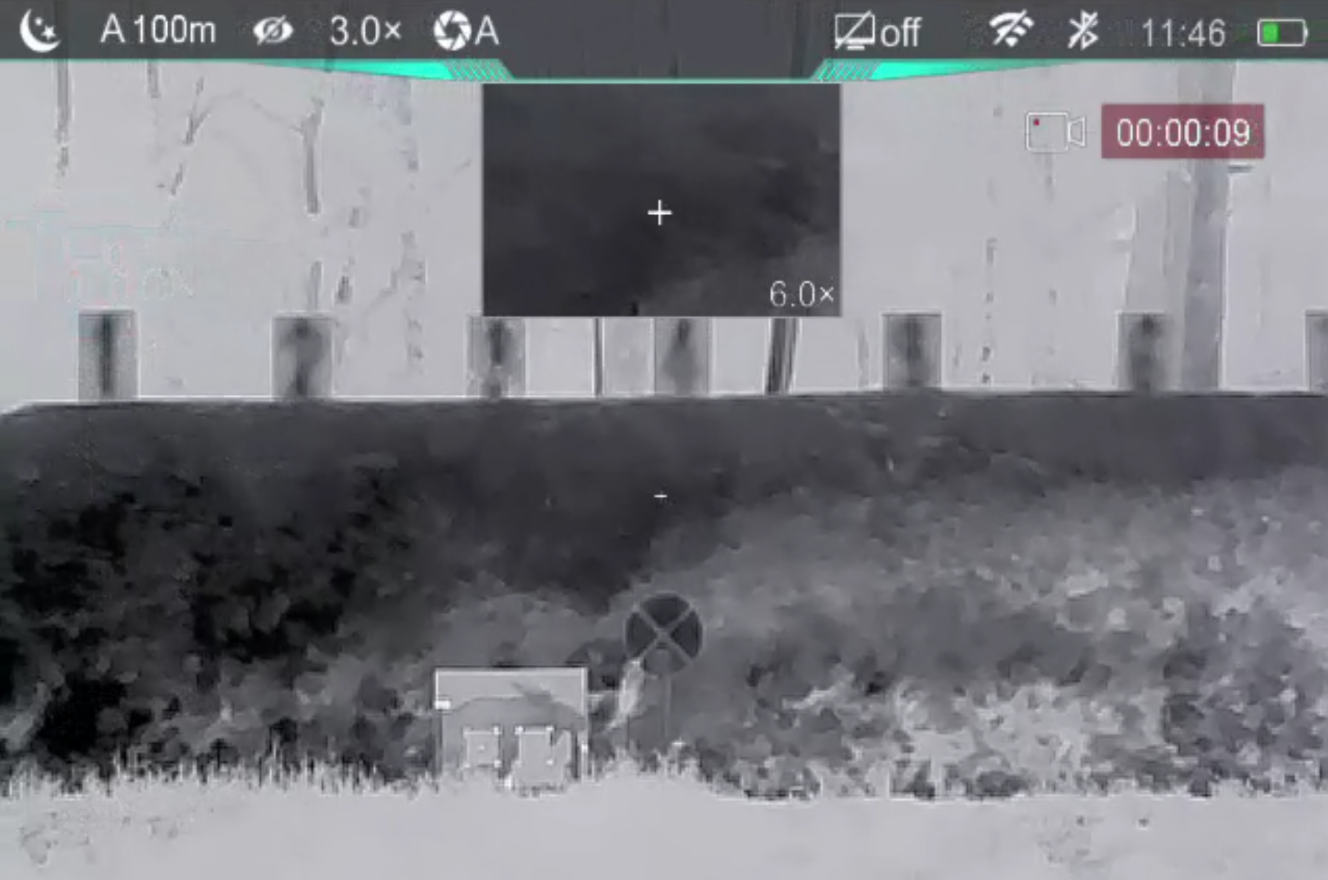

What I usually do is go to the shooting range, and put the left side to firing lane 1, and see how far to the right I can see at different magnifications. Works for thermals also, and beats all the data the suppliers supply.
Below are two InfiRay thermals (Zoom monocular/scanner at 4x and a Tube TL35SE at 3x) to prove the point. This "data" can easily be compared with other models and brands, (as well as the image quality, which is harder for an analogue scope).
