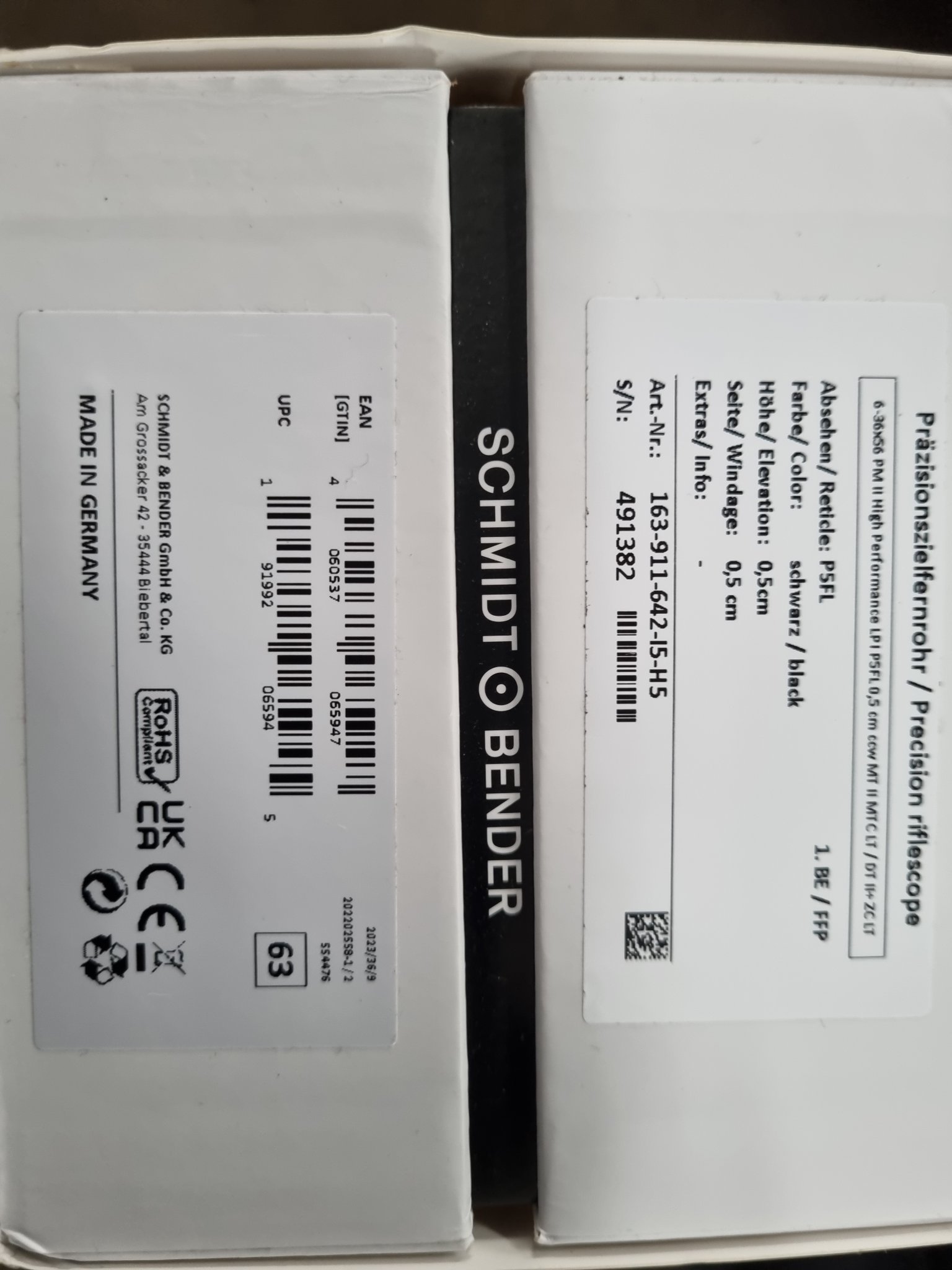

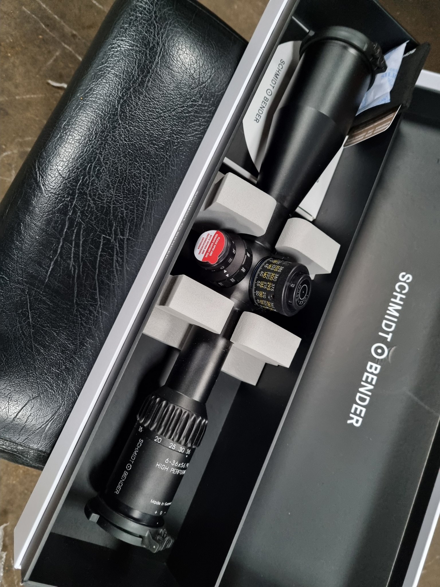

Scope turned up today. Stunning in all regards, keen to get range time asap.

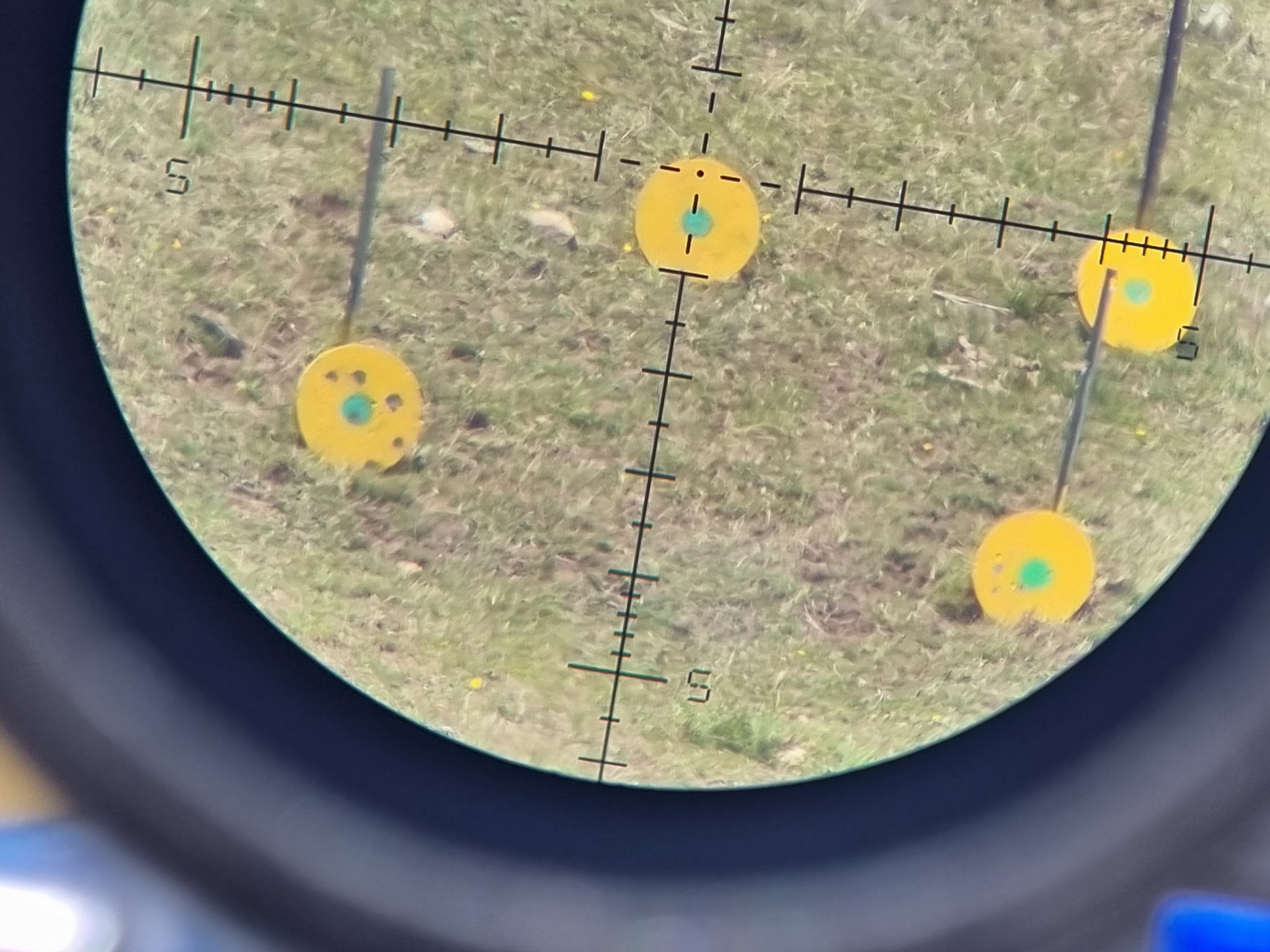

Regarding FOVgate, when I have the Scope set to 36x, I have the 6mil windage marking in view i.e the Euro version has the same FOV at 36x as the US examples have at ~30x.
Yep... i have 6.5 Mil Mil viewable at 36x...
More like 6.2, but a significant difference all the same

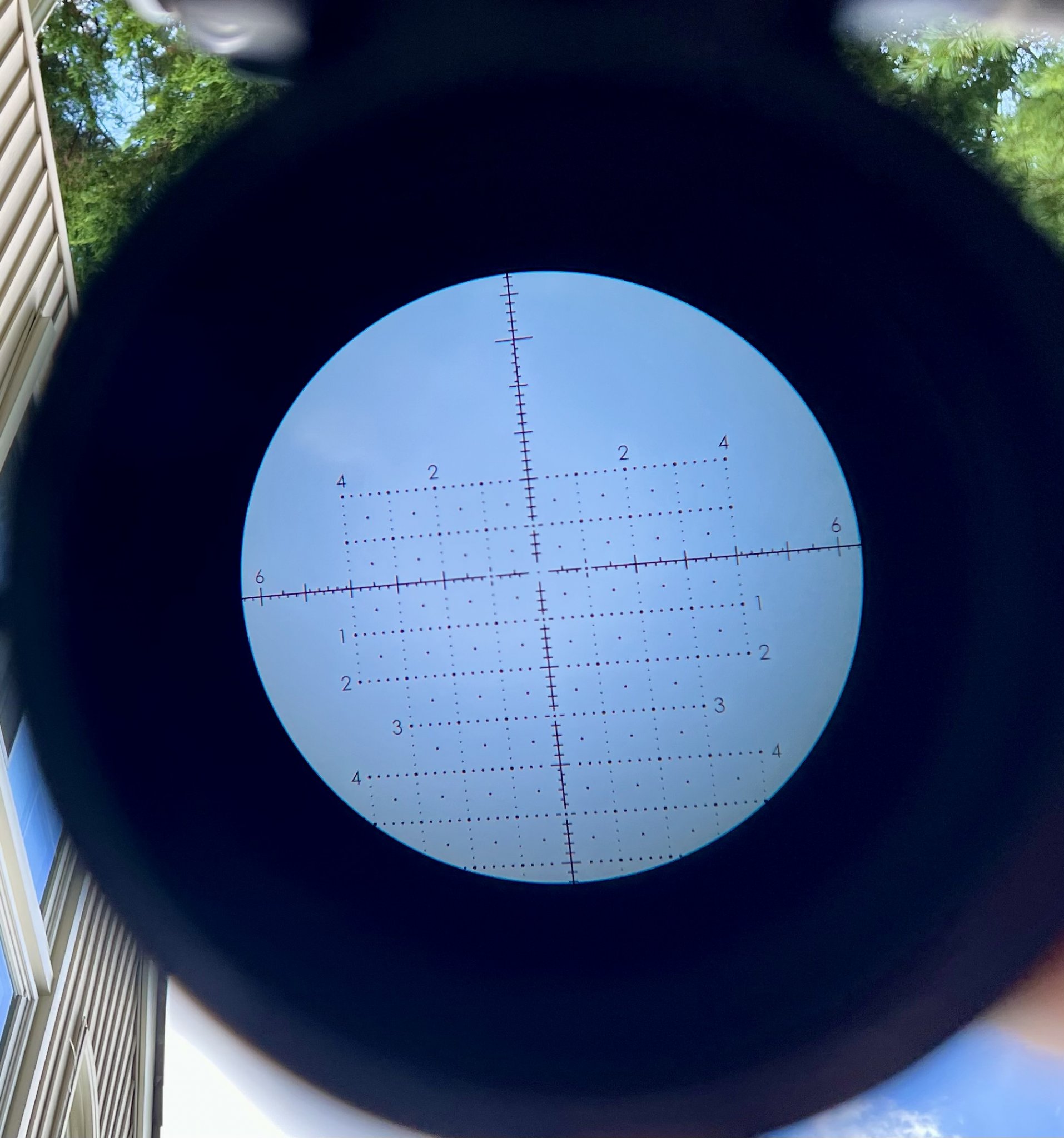

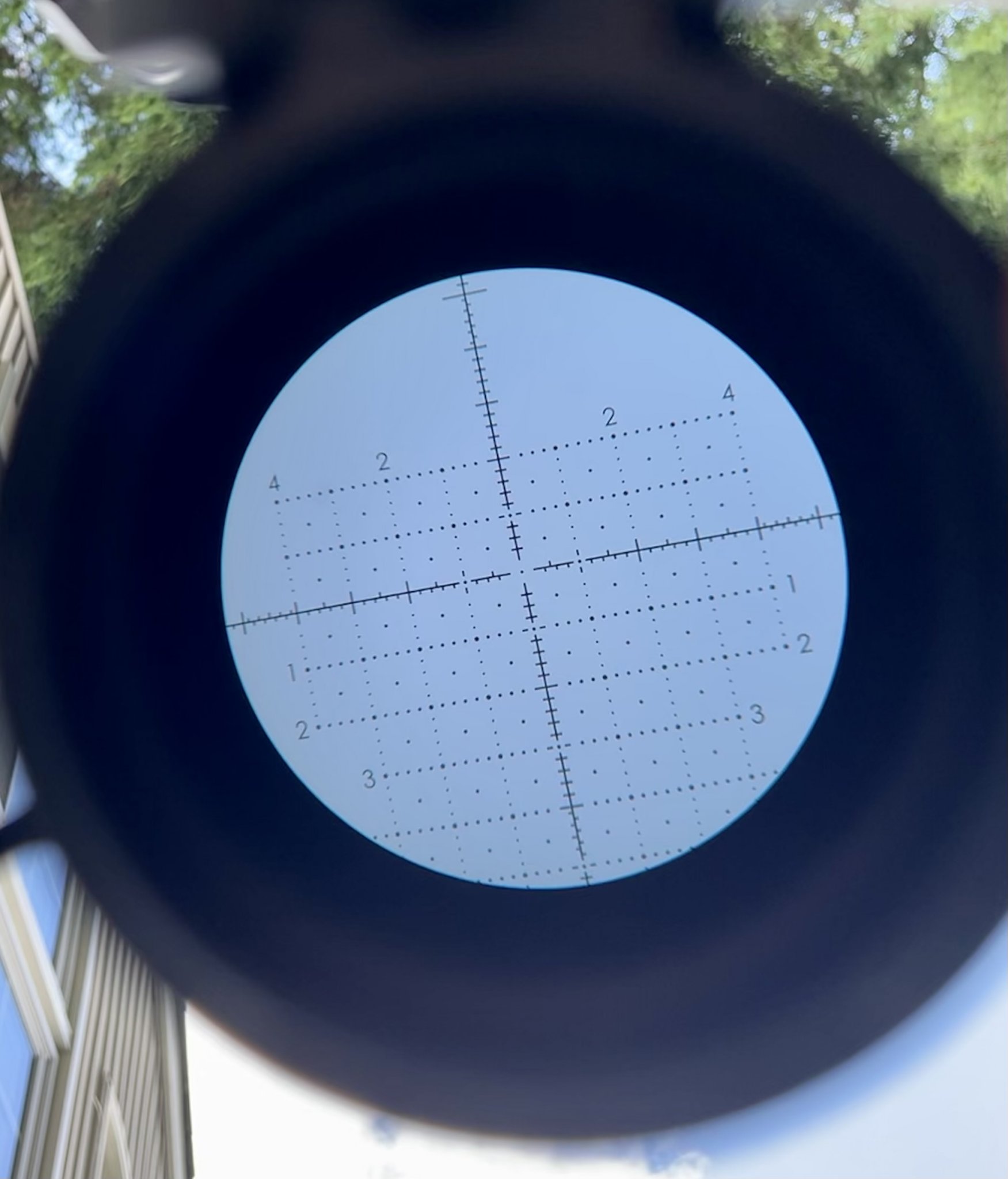

Probably the right reticle if you want something simple. I will say I was surprised by how unobtrusive the GR2ID is in practice. Very well executed reticle.
I like my SKMR3 but think the Tremor reticles are way too busy. This will be on a .308 20” barreled Tikka in a KRG chassis. With a 20 MOA mount, it should suit my needs well. Why so much mag? My eyes suck plain and simple and I prefer Euro glass with an easy to adjust diopter.

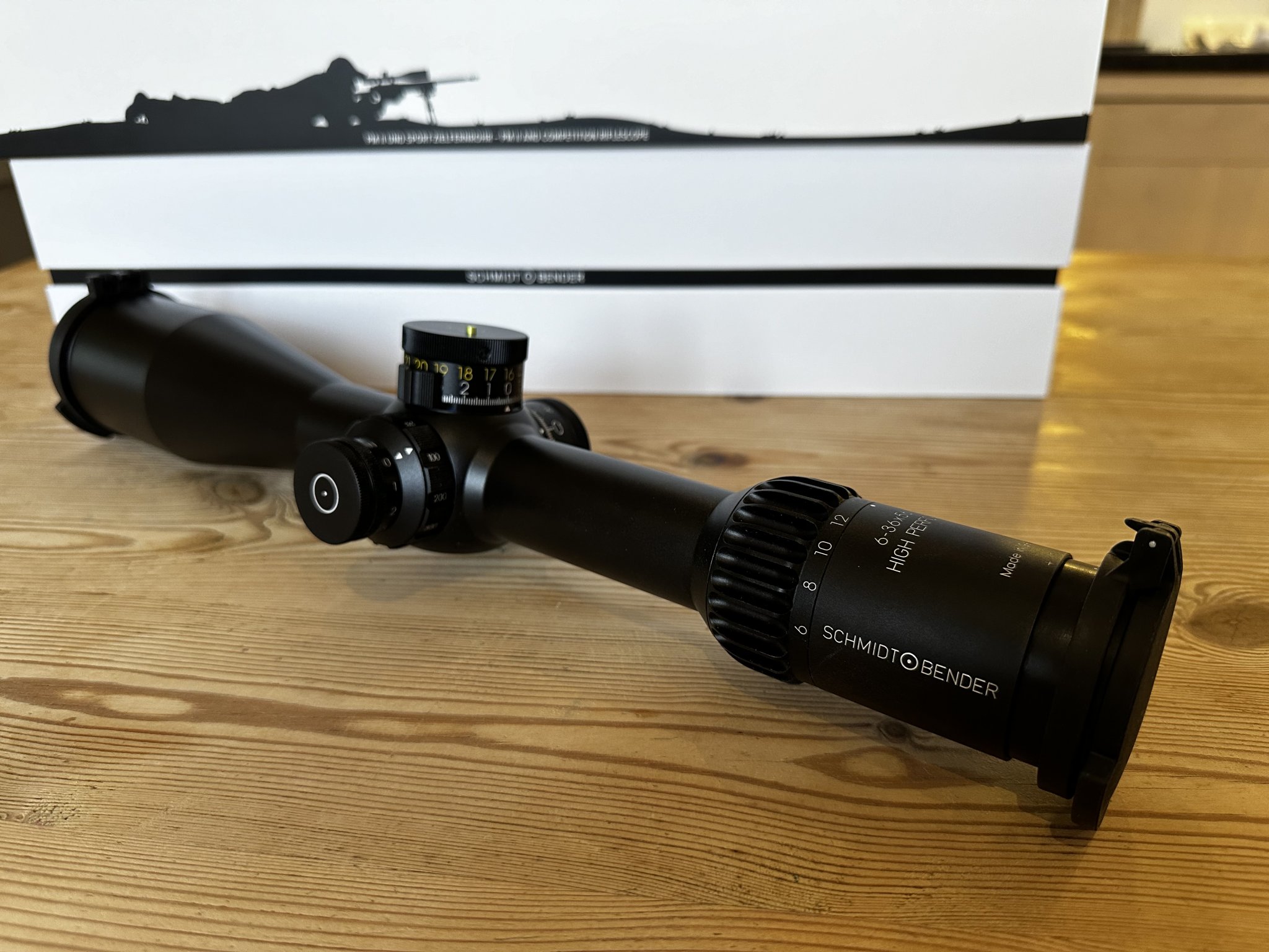

It's completely epic in all ways. One of the few recent product experiences that just blew me away - I've been trying to get it to slip up, putting it in difficult lighting conditions and looking for edge to edge clarity issues - it's truly astonishing.
Honestly difficult to see how it could be improved upon - perhaps with a smaller illumination knob. That said I dig the smaller footprint compared to the 5-25. I can't comment on durability as it's a new scope for me, but glass, ergonomics, size/weight, and the quintessential german quality makes it hard to beat. One problem I have is that it's hard looking through my other scopes without thinking of upgrading. One kidney is enough, right?

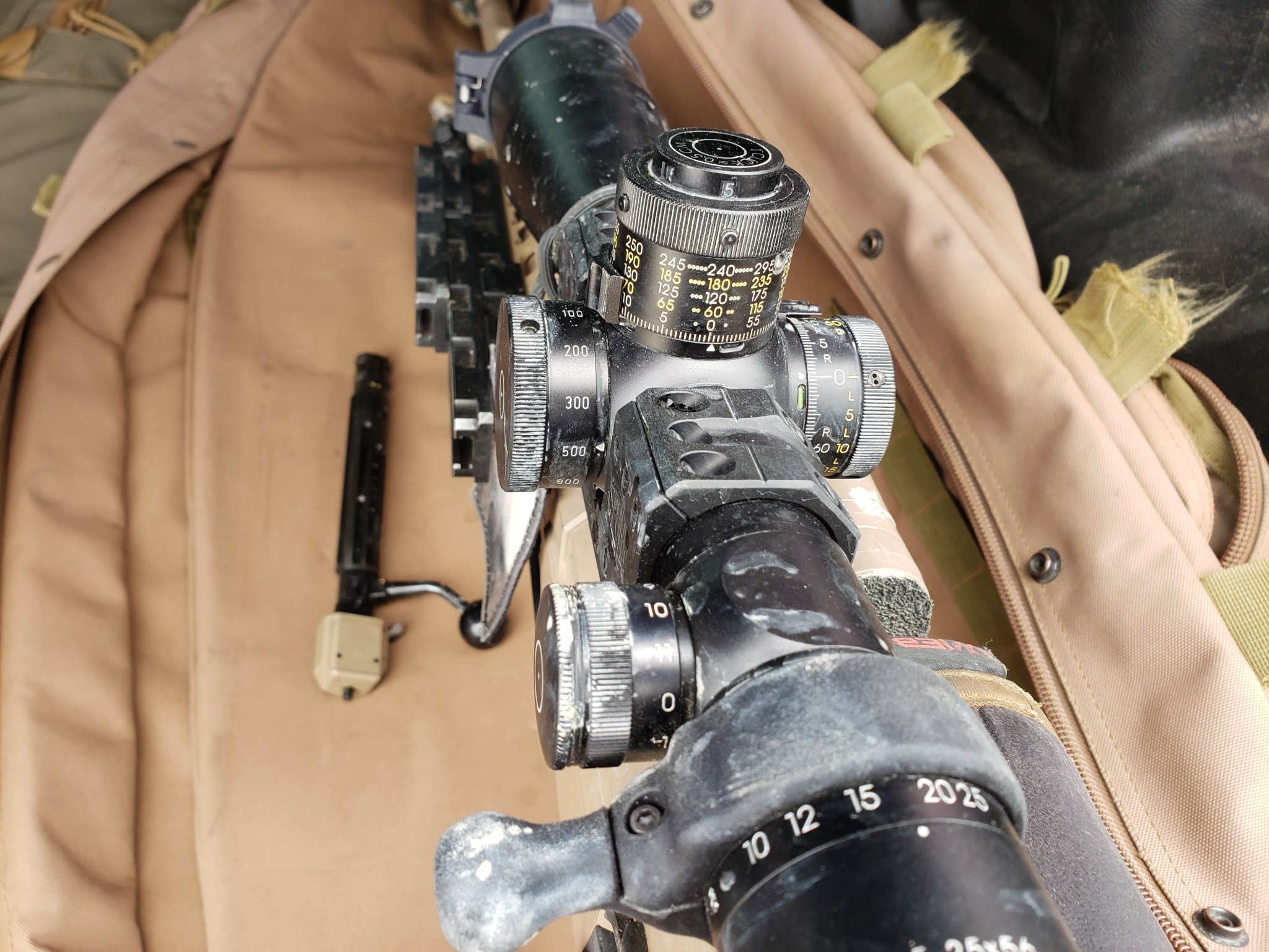

Just don't use those mtii turrets in the mud or rain..... They can lock up and fail... Only Schmidt I have ever seen this happen too... Haven't had that issue with the dtii+ but that was SB answer just remove the pins and shoot during the day lol

It didn't have anything at the time of that pic the turret had seized completely, you could move the lever but that turret wasn't moving 😂.... I would just use iron sights before I would be caught dead with a Leupold....
No just sticking with the dtt+ versions from now on but was a little upset with SB over it although they did repair it and swap the turret.
It didn't have anything at the time of that pic the turret had seized completely, you couls move the lever but that turret wasn't moving 😂.... I would just use iron sights before I would be caught dead with a Leupold....
I had something similar with my 5-45 it failed at the NF match in 2022, it was actually the design of the mechanism inside, nothing to do with mud or rain. They have since reconfigured the parts or fixed it, was something like a metal part wasn't heat treated right. Part of the fix was removing the indicator pins.
Wow... That's where mine failed... I was told it's due to fine dirt and debris getting into the pins and then it locks up and it's widespread so their solution was to just get rid of the pins...

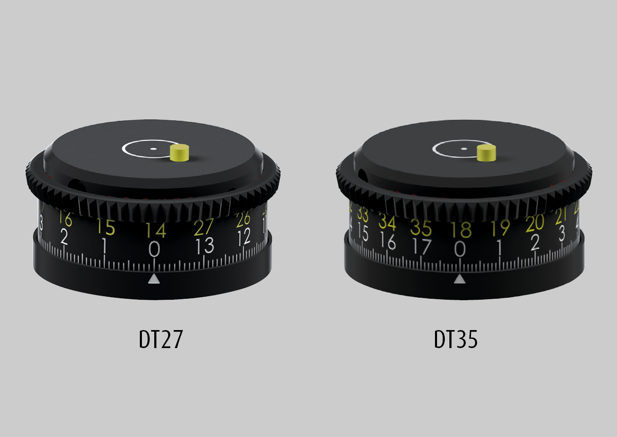

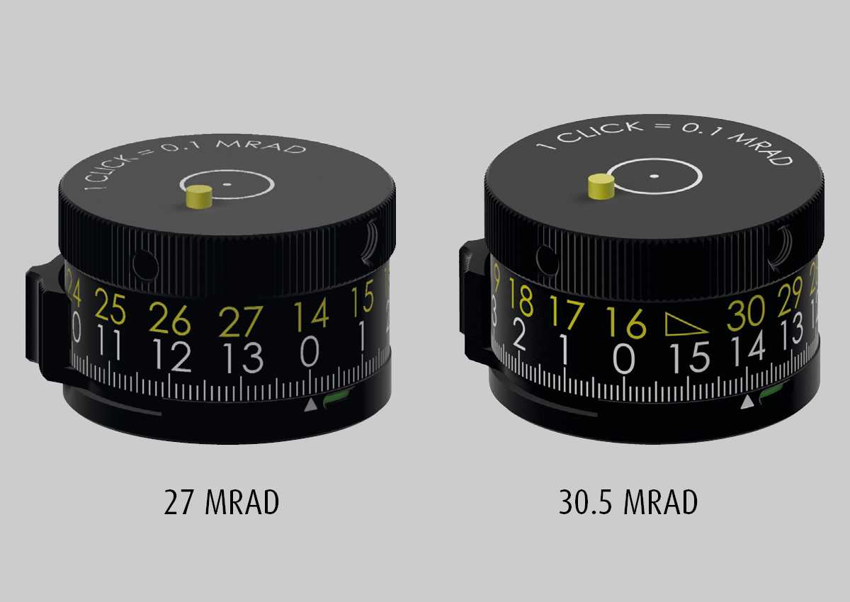

Why not the DT35 MTC?
Probably because 35 mil in 2 revolutions is like:
Can't imagine the graduations on the DT35 turrets are any finer than the older standard DT turrets that allowed 26 mils in 2 turns, but some people do have a problem seeing the closely spaced together hash marks.
S&B actually has an entire page on their website about the different turret options...
DTII+ 27 vs 30.5:
DT MTC 27 vs 35:
A TTII+ (triple turn) turret with 13 mils per revolution would allow 37 mils of dialing (the entire erector travel) and probably have easy to read widely spaced graduations, and they could have a turn indicator pin that pops out higher for the the third revolution similar to how the razor G3 works (or even have a second pin pop up.) However, they may have to make the turret taller for the third row of numbers. Given that S&B seems to stick to single turn, double turn, and multi turn, I doubt we'll ever see a triple turn TTII+ turret.
