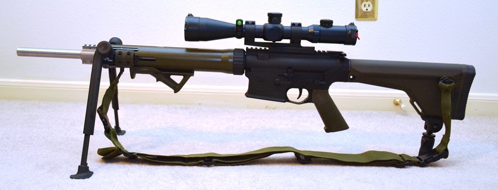

I've also taken my Armalite deer hunting (the very few times that I hunt) and it's heavy, because it has a heavy 20 inch barrel on it. It comes in around 11-12 pounds with the scope installed, and the bipod off . Here is a picture with the Larue mount. I have since replace the grip and the stock. That Nikon Tactical 2.5-10X44 is a big scope.

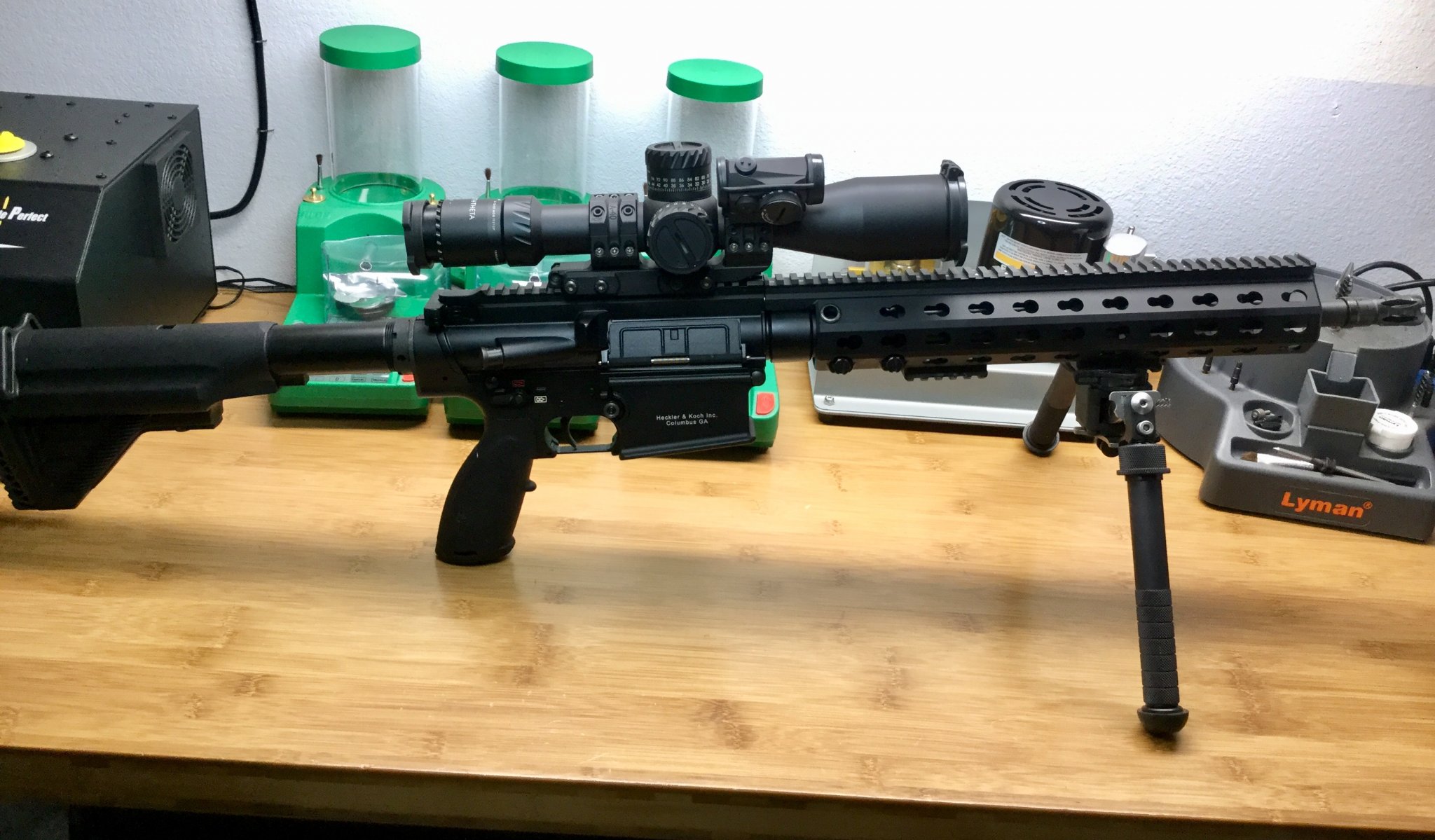

What kind of mount do you have your ATACR in on your Noveske?
For the 16x i used a Spuhr Cantilever 1.50 height.What kind of mount do you have your ATACR in on your Noveske?
Are you using the 1-8 for your 308? If so what do you like better about than the 4-16?For the 16x i used a Spuhr Cantilever 1.50 height.

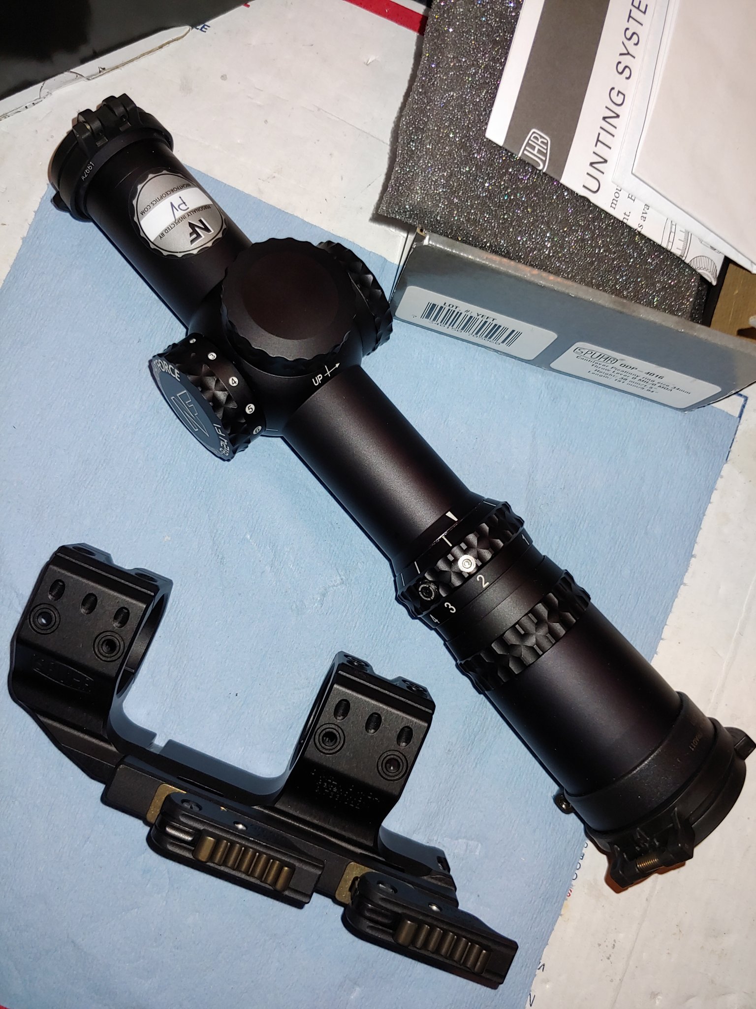

But for the new 8x. I am trying a QD cantilever spurhr
