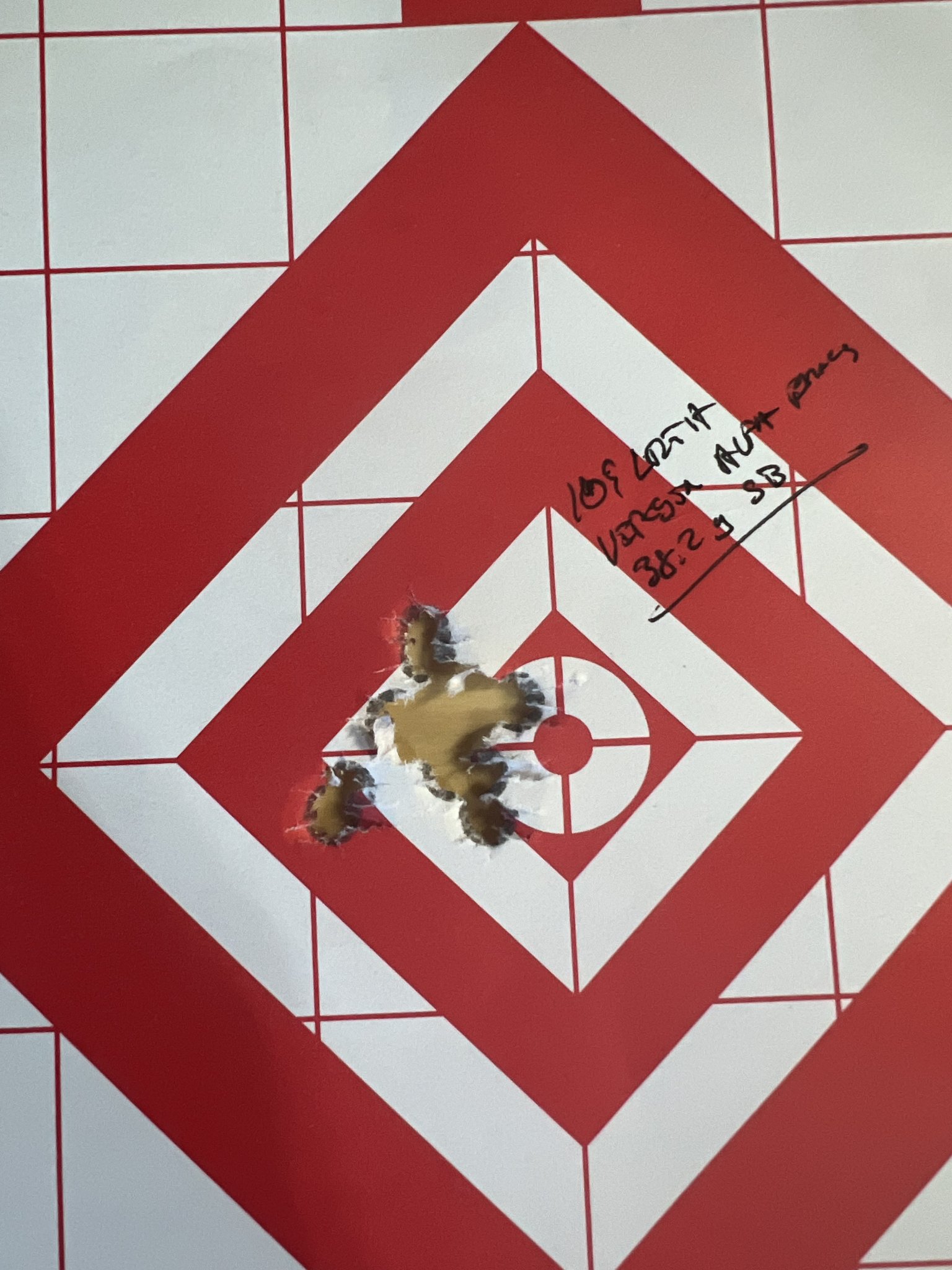

When I developed a load for a new barrel I go with a medium load and work up 5 shot groups at .2gn increments. If a group shoots well (sub 1/2 inch) I will load up 20 rounds and take it back, fire that 20 rounds string (2x 10 round mags) and if that group is 3/4 or under I go load up enough for a season (2k or so). Then I just spend my time practicing and getting used to the load and memorize my dope in various conditions. Calibrate my wind dots in my tremor3 and I’m gtg.
The pic is my current 6GT load with Staball 6.5 and 109 bergers, 20 shot groups in 8-15 MPH winds. I use a Dillion 550 and can pump them out consistently and quickly. I don’t have time to trickle each round so I really like using Staball. IMG_3339.jpeg
