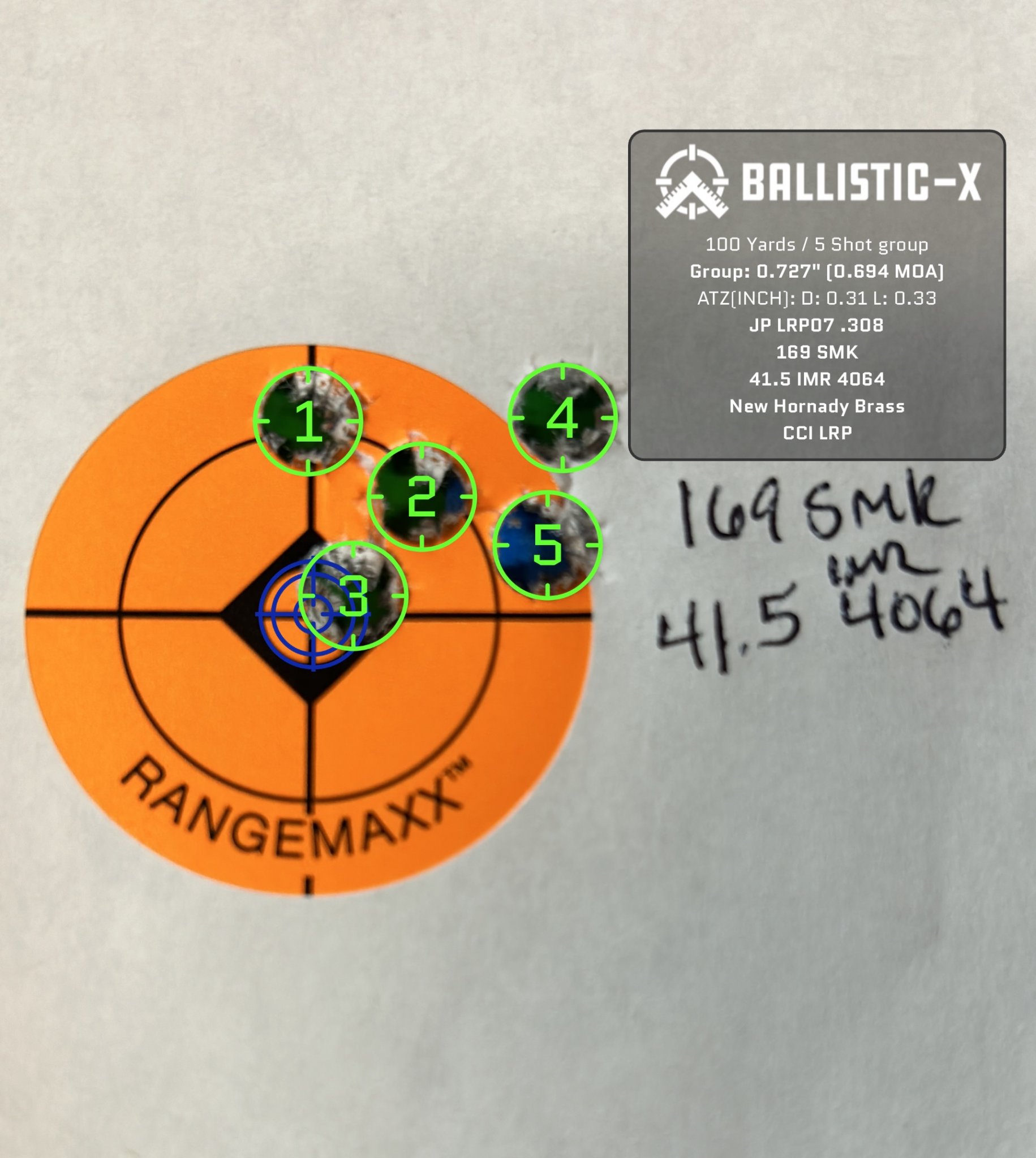

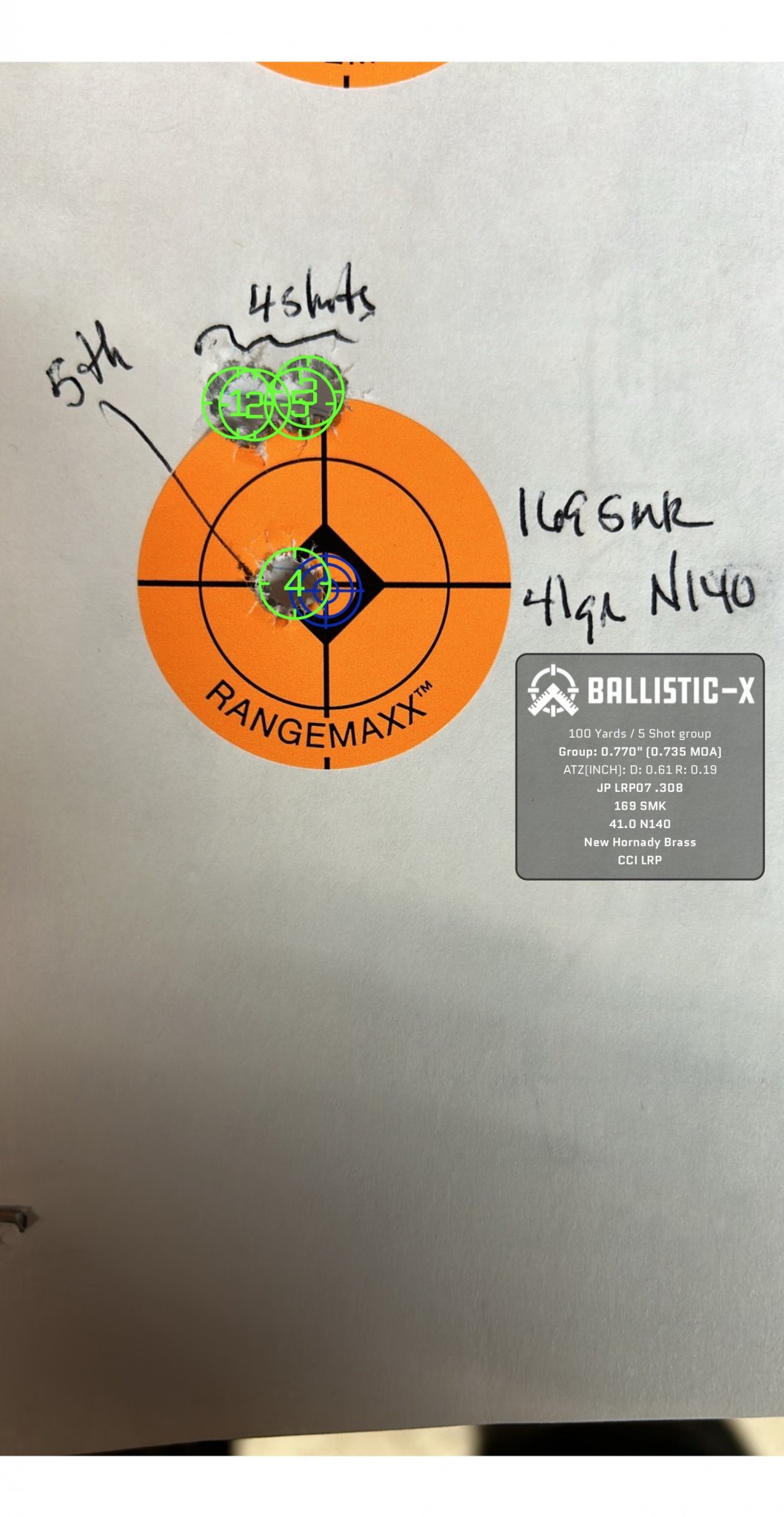

I bought some 169SMK to try in my JP LRP-07. JP is new and only has 100rnds on the bbl. Brass was new Hornady which I found cheap. I normally run Lapua but didn’t want to in a gas gun (loss of brass and possibly have it torn up during extraction). I don’t start serious load dev. until 200rnds on bbls and I use 1x - 2x fire-formed annealed brass. I was just looking to see if anything showed potential while I got some rounds down the bbl. Tried Varget, IMR4064 and VV N140 at a few charge weights with the 169s loaded at mag length (PMAG) 2.800. Best groups pictured. VV N140 could be a real winner. I was surprised Varget didn’t shoot and it also showed pressure (swipe and ejector mark) at low charge weight. Will retest both of these loads and will get serious after I get another 100 rnds down the bbl. I‘ll take best load to distance and report back. On a side note, I tried Hornady 155gr ELDM with same powders and they didn’t shoot. Hornady 110VMAX with H335 shot .6-.7
Ballistic-X-Export-2024-03-17 14:37:22.331074.jpgBallistic-X-Export-2024-03-17 14:29:31.177665.jpg
Reactions: BlueDemon

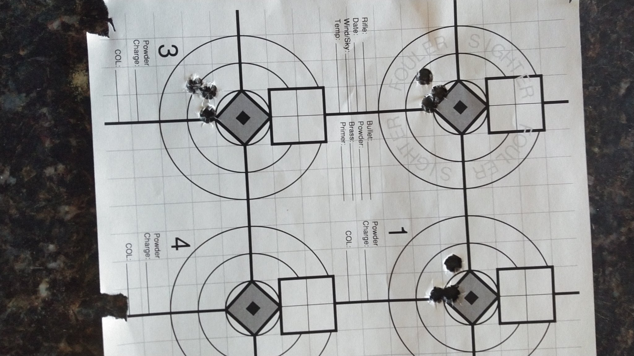

I've been competing PRS tac division and other matches with the 169 SMKs for about 1-1/2 years now, getting decent groups (0.21" and 0.17"). Seating depth nodes aren't as forgiving as I'd like, but I've found a 0.010 wide node around 0.110 jump. It liked touching the lands best for me, but it didn't last through two matches. Other small nodes were found at 0.010 and 0.070. I'm running 2750 with Varget and 26" barrel. Pictured are 200yd seating depth tests.
Reactions: 6.5 GUY

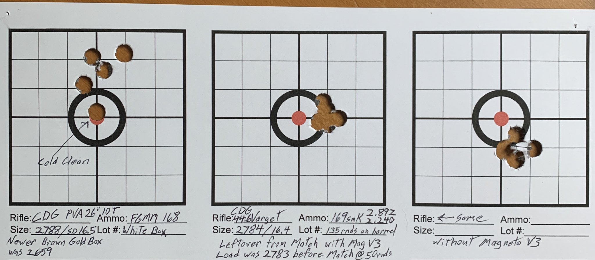

Now I’m interested to see what I can produce with my new 169 recipe, I had a 168TMK that was mint but I ran out of them.
169 Varget load written on target. Have a 2800 speed limit for Tac class. Can’t remember what that jump was & not home to look.
I switched to the 177’s mid summer last year using RL15.5
That load just happened to be within 5fps of factory 168 FGMM (the old white box). The newer Brown box 168 has been disappointing @ over 100fps slower. Sucks cause my 18” AR Loved the White box. Brown box lot I have sucks.

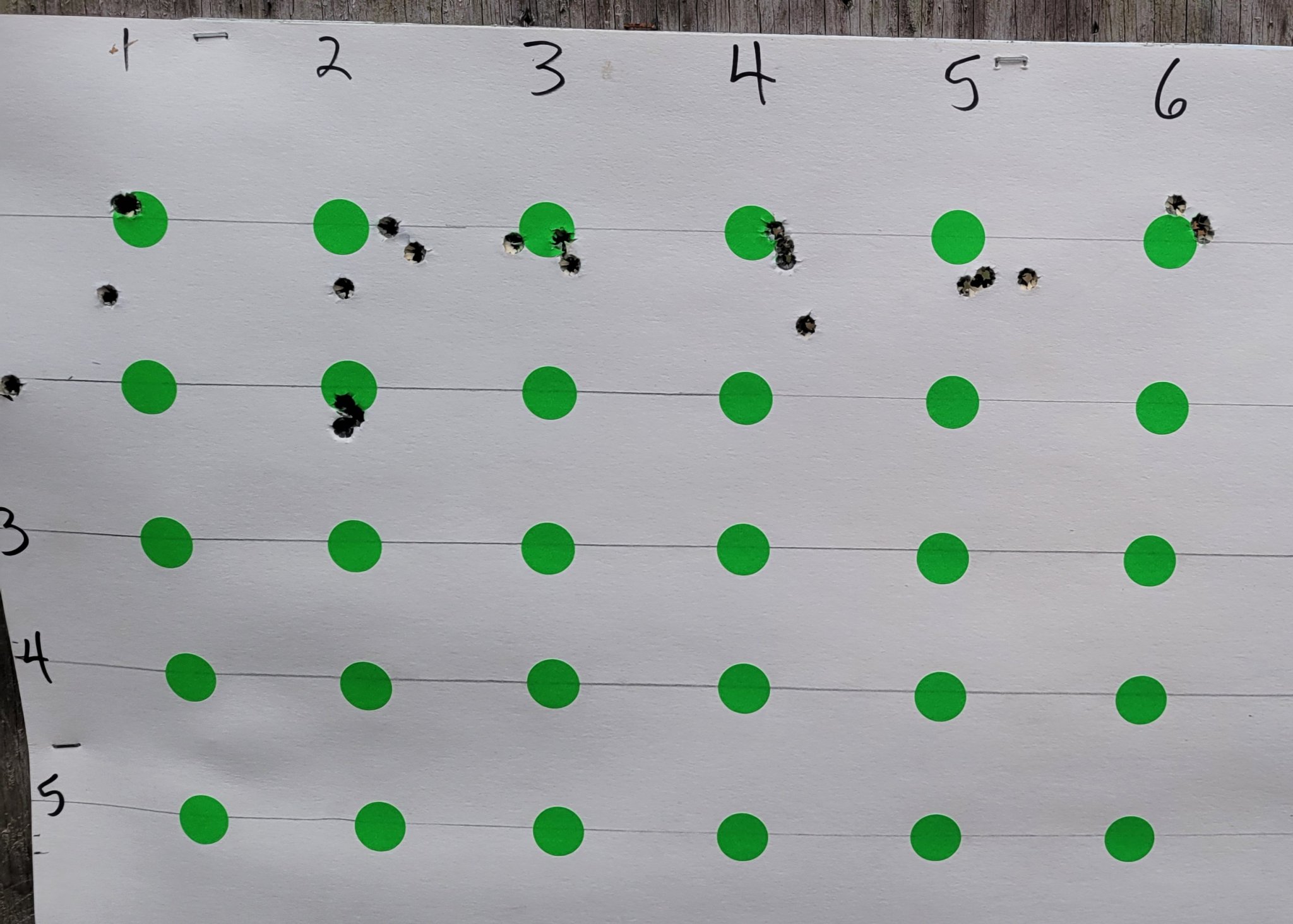

Finally got to test these in my 20" AI. I started with a round robin length test with new factory primed Federal brass, 43.0gr of N150 and the 169. It didn't care about OAL from 2.280 to 2.190 base to ogive .030 at a step shot pretty close to the same. Chrono graphing all the shots showed it liked that powder charge
I than did a OCW powder test with the shortest oal. Turns out 42.8, 43.1, and 43.5 all did pretty decent and velocities were acceptable.
I loaded 50 rounds with 43.0 @ 2.190 base to ogive and tested them this morning. Accuracy was 3/8" for 5 shots velocity was 2610fps with good enough es/sd. After getting a perfect zero and slipping my turrets I shot some random distances between 410 and 905 and every shot tracked with my kestrel, water line hits, and 1/2 to slight more than 1/2 moa at all distances.
Something odd happened at 1027 and it took a full mil less than my program called for but once I "found" the plate I shot an 8" group. I will revisit this some afternoon when I can set up in a different direction so the sun isn't burning a hole in my eyes.
Honestly I'm not a comp guy I just like to tinker if I'm planning on shooting 1000+ Im not usually packing around a 20" 308 if I was Id want another 100fps.
