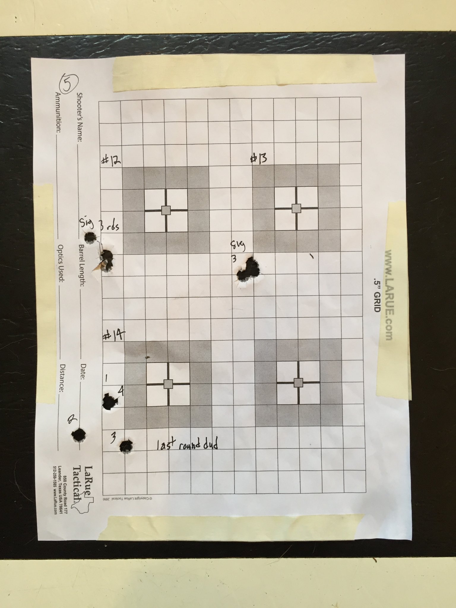

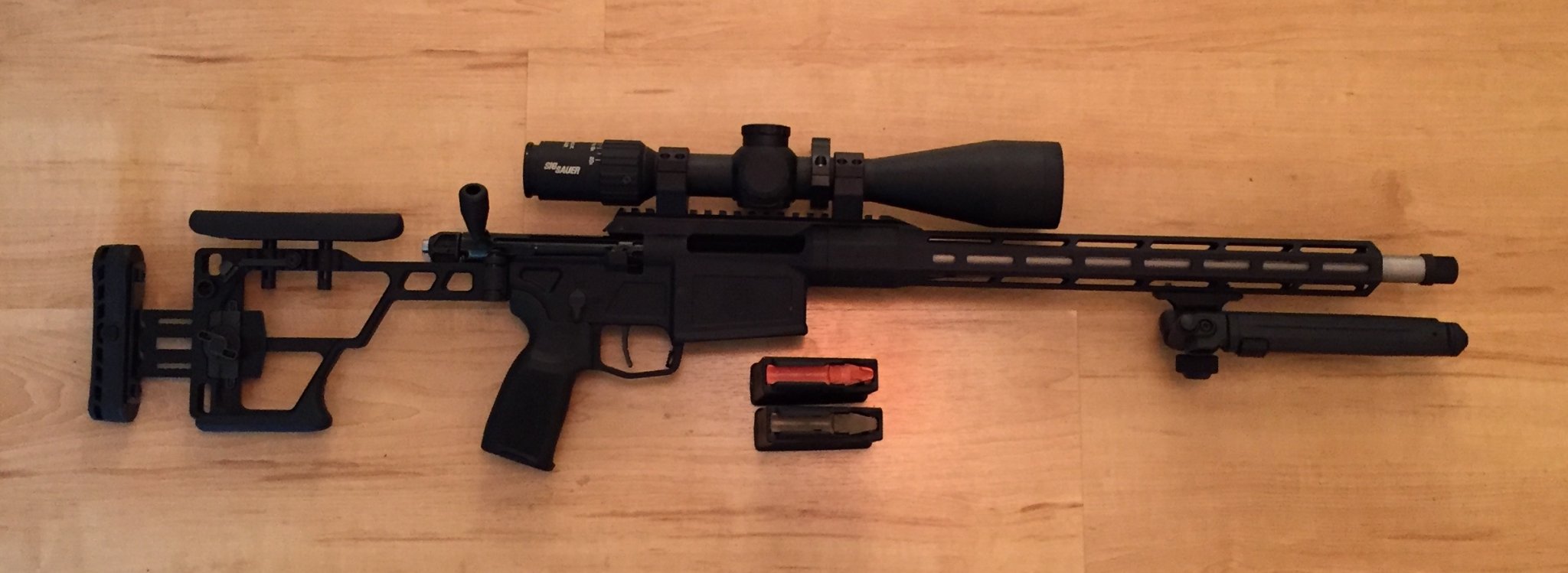

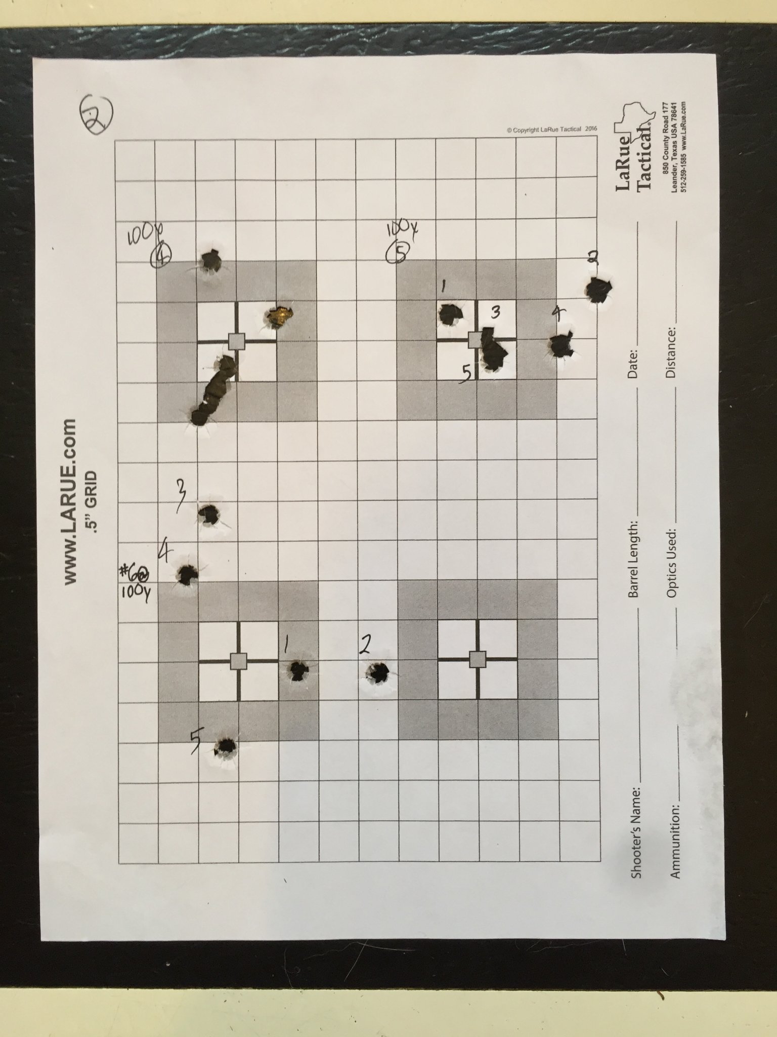

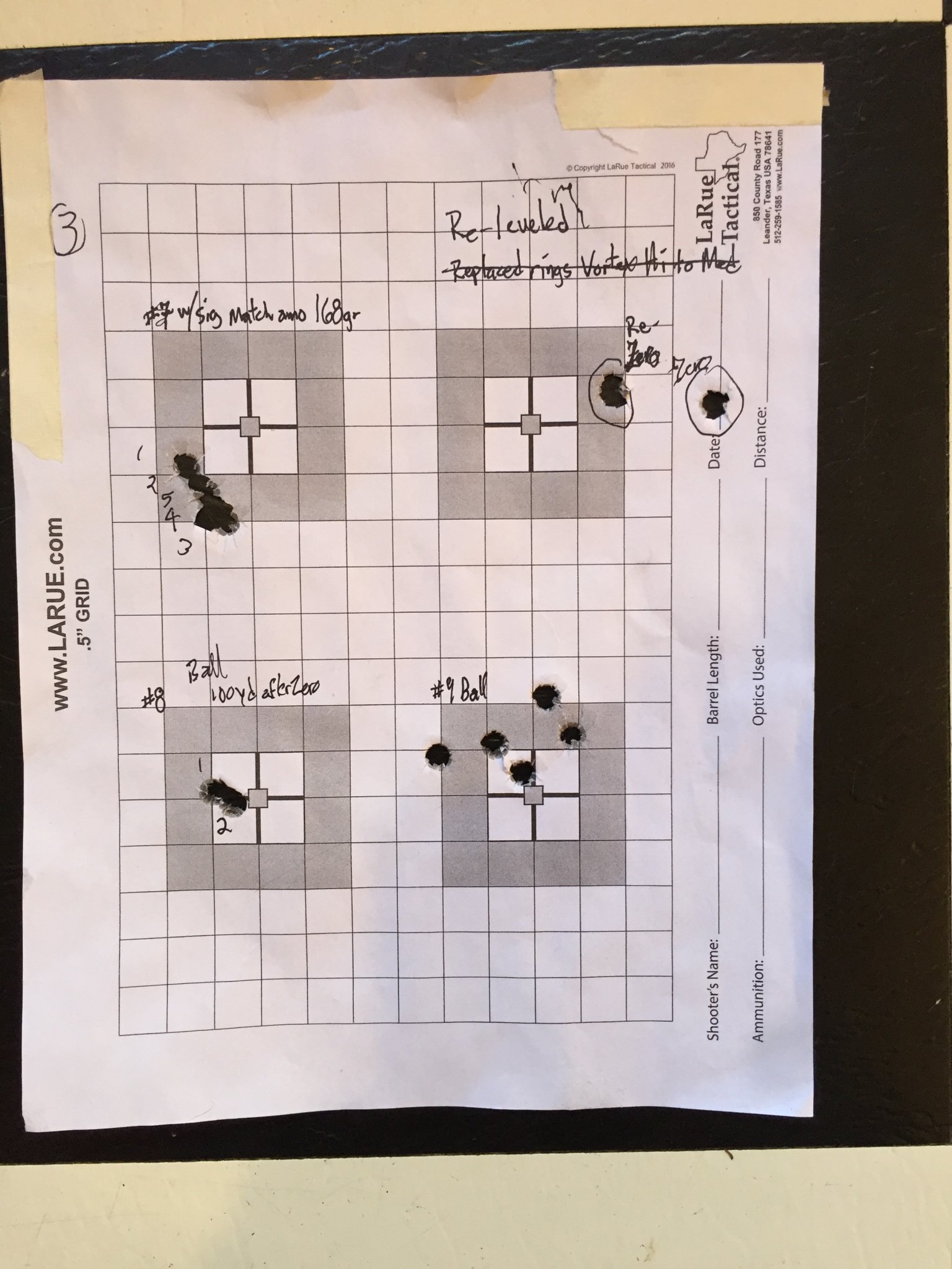

This is my first post to the forum and I hope it’s in the right place, my apologies if another thread is more appropriate.
I’m not a prs guy and don’t have a lot of experience hunting or shooting so take this for what it’s worth. Also don’t have any feelings to worry about so do your worst and be as brutal as you think is necessary.
Bought a Kilo 2400 rangefinder for the milling reticle then learned about the BDX system. Bought the 6-20x52 then found a Cross in 308 (a buddy who shoots a lot says he’s sticking with 308 until Lake City starts making 6.5cm. Made sense to me). These are all of my first shots with it, done this past weekend. I can’t find ammo, so used Ball, plus a buddy gave me a box of Sig match ammo: as indicated on targets.
Used factory trigger setting which seems like it was in the middle somewhere between 2-4 lbs. Bought the cross for hunting black bear and Sitka blacktail deer. As you can see, the ball ammo gave a paltry (but not surprising) 1.5-2.0 moa, while the Sig match was under 1” with 5 shot groups and around .5 with 3 shot. Ranging was right at 104 yds. Shot 86 rounds total (1 dud Sig match). There is one group of 15 shots missing at 25yds from the last session after replacing high scope rings with mid. I used a clean target someone left on the stand and it wasn’t worth including here. The zero wasn’t adjusted for the match ammo because I won’t buy it. Will start working up handloads. Long post but the bottom line is that the gun is capable of shooting .5 MOA off the shelf in untrained hands with factory match ammo using a relatively thick BDX reticle.
The barrel was cleaned once with 2 passes of a bore snake on target 3 AFTER the first group of Sig match ammo. All shots were done in 3 sittings over 2 days indicated on targets by scope releveling and ring replacement.
Not sure why the last shot group with Sig ammo opened up other than sore shoulder and dud round distraction (which was actually shot 3 out of 5, not shot #5 as indicated on target.
Two other things to mention.
1. Bolt was a bit stiff before shooting but seems to have seated and I would say is now actually smooth. Not Tikka-smooth, but very good.
2. The included magazine required some (too much) effort to lock in the mag well. I bought another mag for the last session and it took slightly more effort to lock than the first. Noticed wear marks this morning on the top edge of each mag (both sides) where it seats in the receiver. Buffed those points with an Allen wrench (it was handy) and the mags now seat perfectly.
Hope this is helpful.
View attachment 7429224View attachment 7429225View attachment 7429226View attachment 7429247View attachment 7429248View attachment 7429249

Another Hide noob (long time lurker) with a new Cross and rather similar results. Have not owned a bolt action for a few years but when this one was announced at SHOT thought it might be time to change that. I mostly hunt pigs and deer on my property in west Texas, but do also have a 500 yard range.
Bought the .308 version from my local Cabela’s. Cleaned and re-lubed it, lightened the trigger pull up a bit, mounted a 2-10x56 AccuPoint in Warne rings, can mount and a rail and bi-pod. Had some Federal 168 GMM, 165 Game King reloads and some Fiocchi 180 Match Kings on hand. I’m not much on barrel break in rituals so mostly just ran a wet patch and a few dry ones after each box of cartridges.
Much like the other posts I’ve read on this rifle, everything grouped around a half inch at 100 yards. The action is smooth, trigger is as good as any after market 2 stage I have on my ARs and it shoots consistently where it’s pointed. It’s freakishly light but the recoil is very manageable.
Overall I‘m happy with the rifle and think it will suit my purposes well. Have started to work up some 165/168 Sierra loads and gonna play around with some Berger classic hunters, as well.

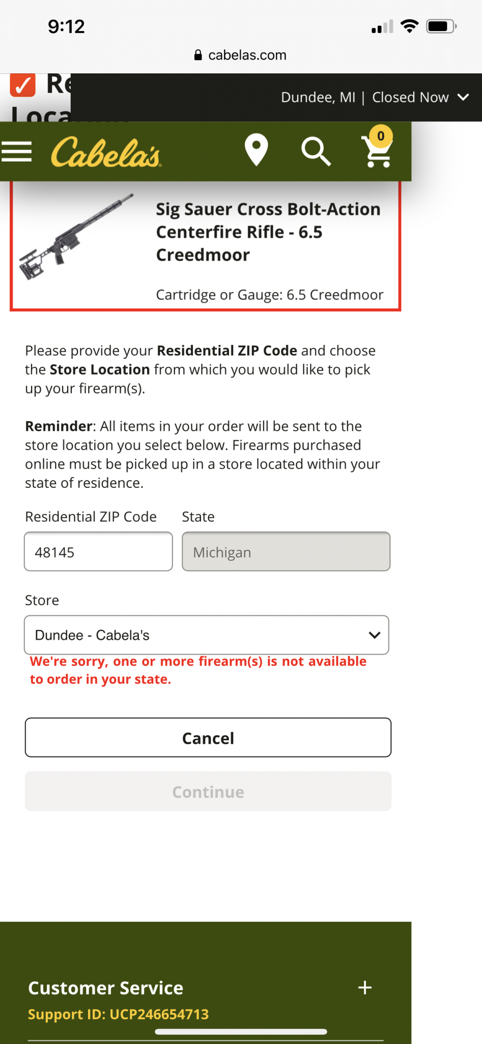

Hmm...I just called their customer service line, and asked why it shows unavailable for purchase in my state. She said that it’s just unavailable right now, none in their warehouses, which is why that pops up.
But I just tried an Ohio zip code, and ship to one of their Ohio stores...no problem, no pop. So she’s full of shit. I’m going to run to the Dundee, MI store in the morning, see what they have to say.

Went to cabelas this morning, another waste of time (besides getting a few boxes of 6.5 Grendel ammo).
Told the guy behind the counter what the website said, his response was that he works at the store, and doesn’t do anything with the website. Understandable, I asked if he could order one for me...was told no, they can’t order items they usually stock. Ok...So you can’t special order one, your website says they can’t sell them in my state, which is 100% incorrect. I can’t order online to have it shipped to the Ohio store, where I can legally purchase it, because it’s against their policy for some reason. Can’t get a Manager or anybody a little more knowledgeable to speak to me, or call back.
I’m getting a little fed up here...I may just blow my Cabelas points on a new spotting scope, and order the cross through Eurooptic when they have them in stock.
Just looked again, not seeing the option to order online at all anymore.
So I ordered a 6.5cm last night. This morning I had an email saying my card was declined. Credit card company flagged it as fraudulent so I tell them it was me. Go back to Cabelas website to put in the order again and now they aren’t available. FML

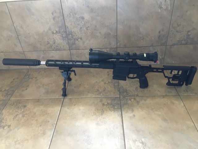

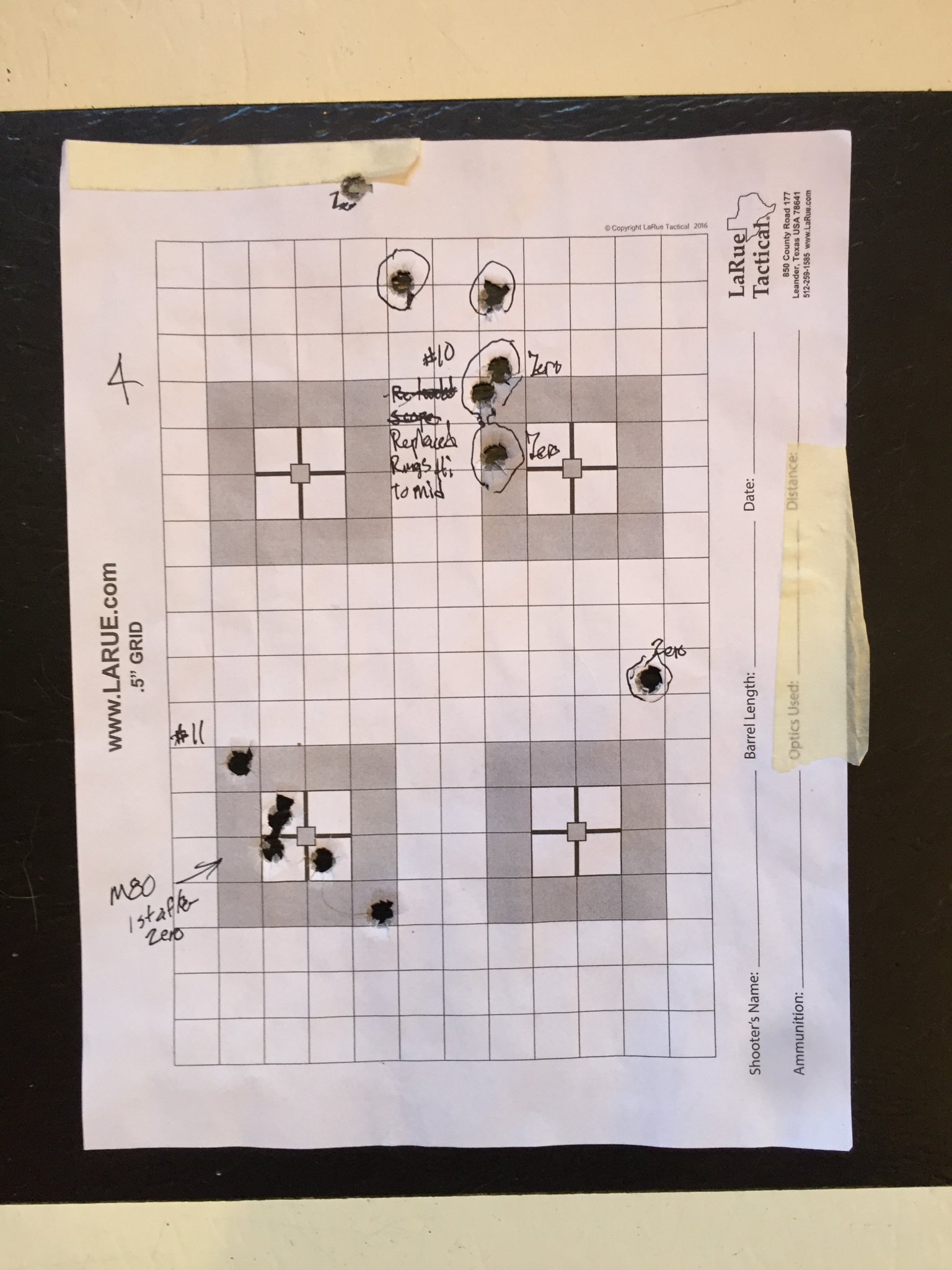

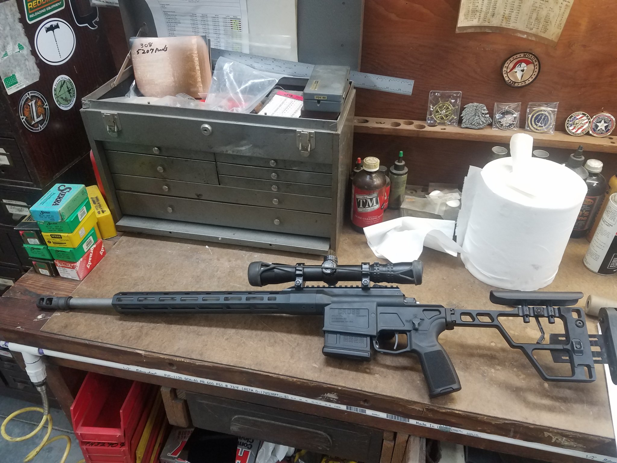

As you can imagine I couldn't wait to tear into this rifle. Yesterday was spent getting familiar with it. trying hard not to break something. Making tooling for assembly and disassembly. Today was a new barrel. Scrounging around the shop I found an AR10 Bartlein 6.5 barrel left over from a project. Turned the breech down, shortened it up a bit. Finish length ended up 18 1/2". The AR barrel weighed a good bit less than the 3 lb. 18" factory barrel. When finished it weighted 7 ozs. less. All weights are with the extension installed. The rifle with mag weighed 6 lb 9 ozs. Add a Surefire brake and it is still under 7 lbs. . I installed a NF 2.5-10X32 in aluminum rings. Rifle with scope and Surefire can weighs 8.37 lbs.
One sighter, adjusted scope and the next 3, H 140 Amax, went into 1/2". Mission accomplished. Attached the Magneto Speed. H140 Amax 2625 FPS, BH's B140 Hybrids 2645 FPS Not for an 18" barrel. I polished the bolt cocking cam, I do on every build, and bolt lift was easy. With a small firing pin I need to see where the upper limit is on pressure. Fun two days.
