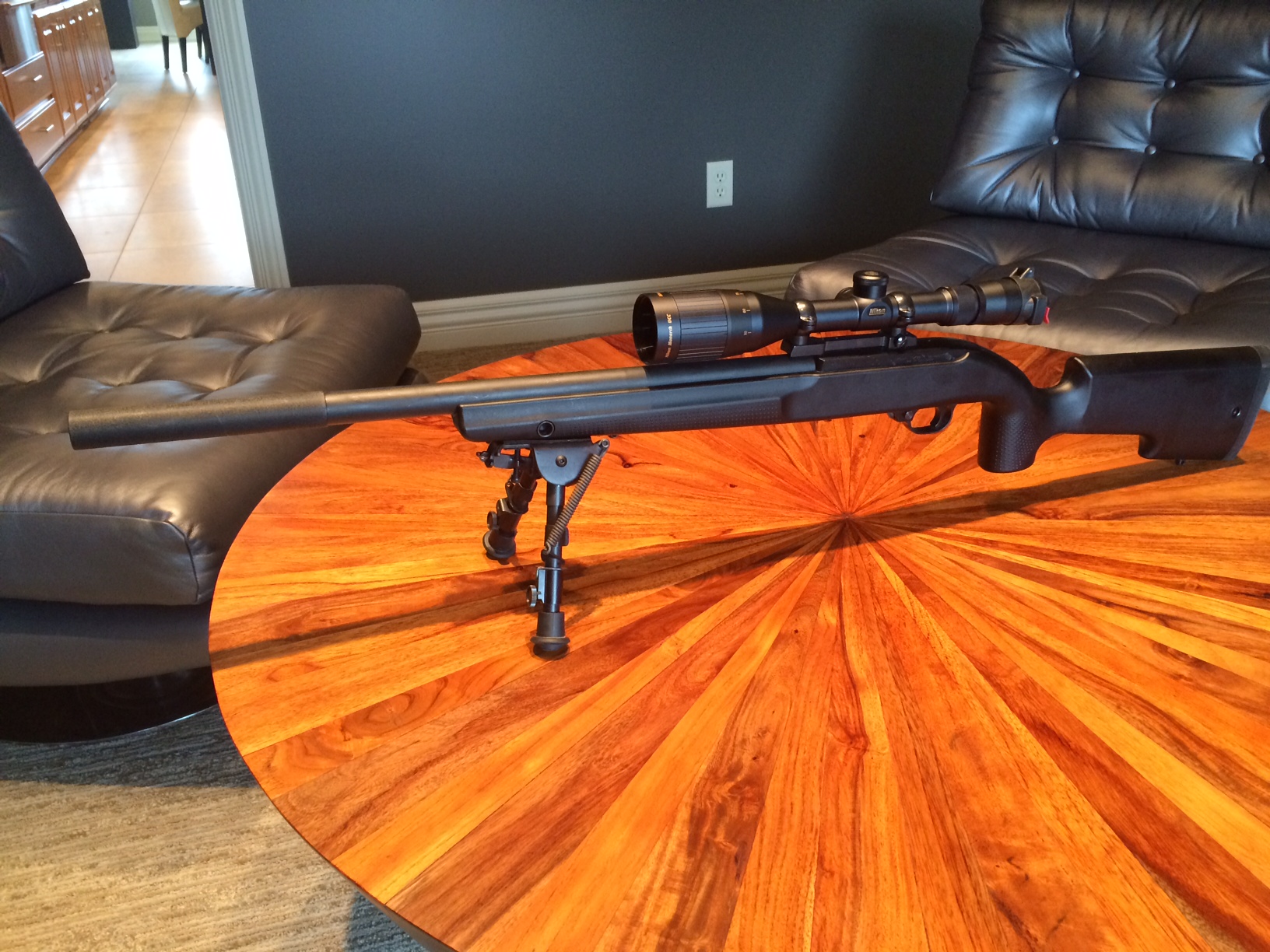

OK here's a pic of my new Titan stock. Standard 10/22 receiver/trigger with an Adams and Bennett barrel trimmed to 16" with an old school AWC Archangel III can. This looks and feels awesome. SOOOOO much better than the Hogue overmold it was in.
I can't say enough about the great comms and service from Victor Co. I had a slight fit problem due the age of my 10/22. Michael personally took care of my issue. Top notch service and responsiveness.
I will report back on accuracy!
