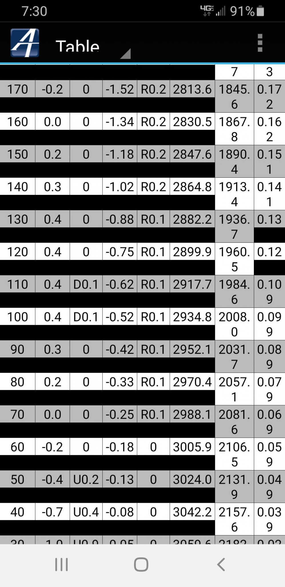

I didn’t want to start a new thread and I'm basically "New to Applied Ballistics App...." I have been using AB app on my Samsung phones for over 5 years but I'm age challenged. All updates have been allowed. Version 2.2.7 All bullet data was inputted from the Bullet Library.
My issue is that even though "Zero Range" is set at 100 yards on the app for each Firearm Library entry and in the field, the Trajectory Chart for all my rifles has changed showing zero at 2 distances now. This started about a year ago and I haven't been able to figure it out on my own.
I assume that it is in the app settings because it is affecting all my Trajectory Charts. I don't want to just start changing settings by the brail method. What setting needs to be changed to fix this issue?
This is my 6mm Creedmoor; my 338 Federal has different zeroed distances. I did not make any setting changes on purpose and have checked my firearm data to be what I originally inputted that was working before.
Applied Ballistics "calculates" Aerodynamic Jump and includes it in all of its solutions. This makes for a royal pain in the ass when trying to make printed drop charts that include wind drift.
Make your wind speed zero and it will go away.
