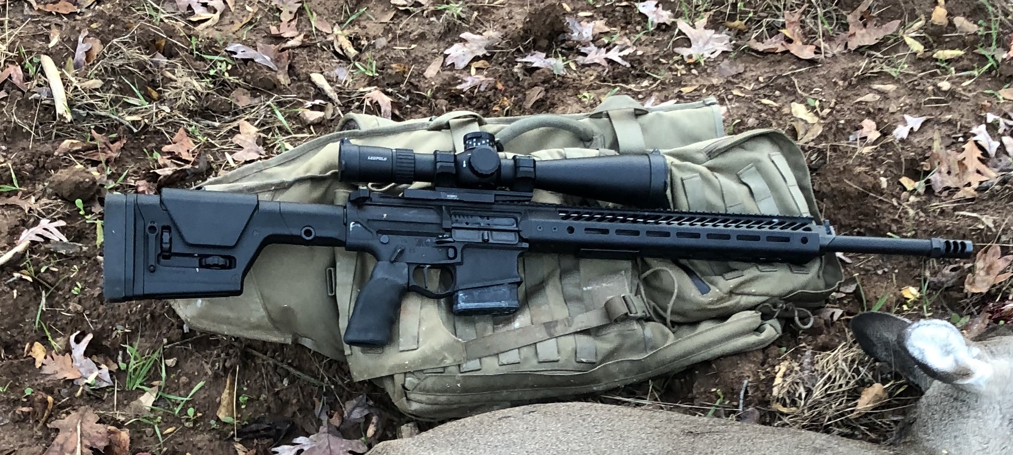

One of my recent builds...
https://www.snipershide.com/shootin...on-another-6-5-cm-build.6965944/#post-8025119

AGB has definitely helped fine tune the gas system on 22" or longer 6.5cm barrels with +2 gas systems. When I say fine tune, I dont mean to get to run. I mean to get to run and optimize lock time to prevent case damaged from the BCG coming back a hair too soon and having to rip that case out of the chamber which causes the case damage. Ive tested all this combos extensively over the last few years, HP bolts, different weight rifle buffers and power springs, AGB, rifle gas, +1 gas, +2 gas and JP SCS springs in every combination of spring and steel and tungsten weights you can possibly think up.
What I have found, is a JP SCS Heavy tuned with the second heaviest spring and Tungsten weights (have to check my rifle on how many tungsten and how many steel) and the +2 gas system on a 22" barrel provides a super smooth shooting rifle with brass that looks like it was fired out of a bolt gun. That is with custom barrels, all of which have used JP's QPQ barrel extension with is honed and QPQ coated. This stops the cases from getting the nasty deep scratch and guage in the neck and shoulder upon ejection which BAT and similar non - honed barrel extensions cause.
Just some info from my experience and testing..
I am also a big fan of moderately "heavy" recoil parts combined with Adj. GB's on Large Frame AR's .... they do shoot very smooth for me as well.
Lol, Smooth like soft butter.
Soft enough that most people are surprised after shooting them... exclaiming "That wasn't nearly as bad as I was expecting".
And extraction at a lower chamber pressure, ( slightly slower cyclic speed from those heavy parts and Adj. GB ) does wonders on brass condition, and ( IMHO ) Large frame AR function.
The recoil impulse is markedly improved, allowing far quicker followup shoots as well.
Good to hear others enjoying a heavy setup and its generous benefits.... I was beginning to think I was one of the few "followers" of that doctrine. Lol
