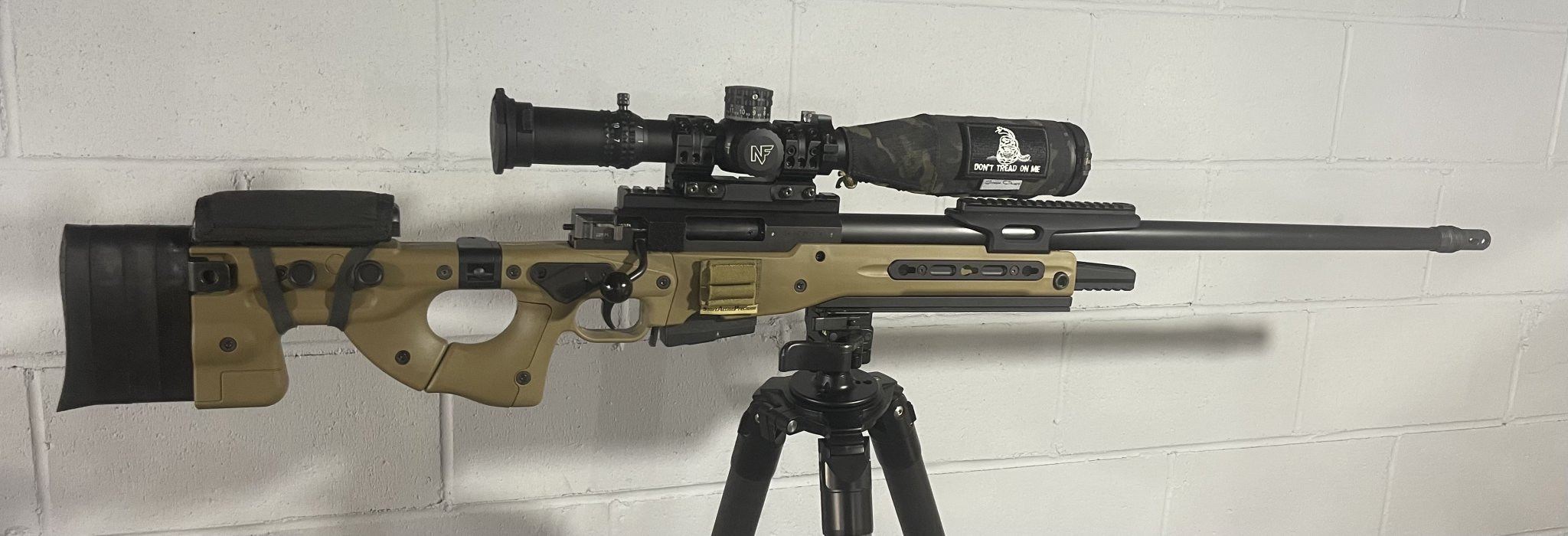

Just fyi AI’s are heavy. At least my AT’s are. Built like a tank is a very good analogy. Green in 308 and DE in 260 and soon to be 300 WSM
