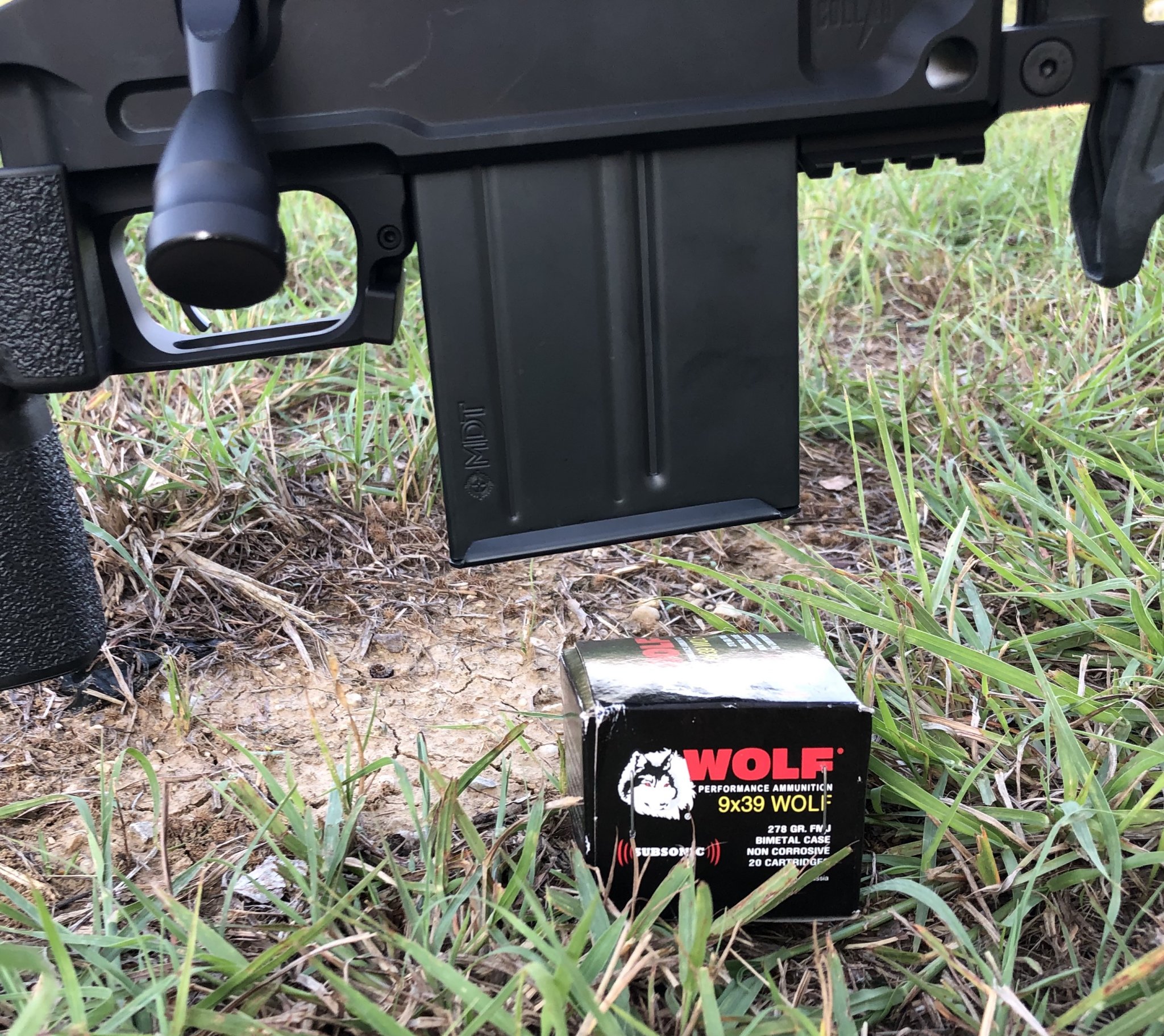

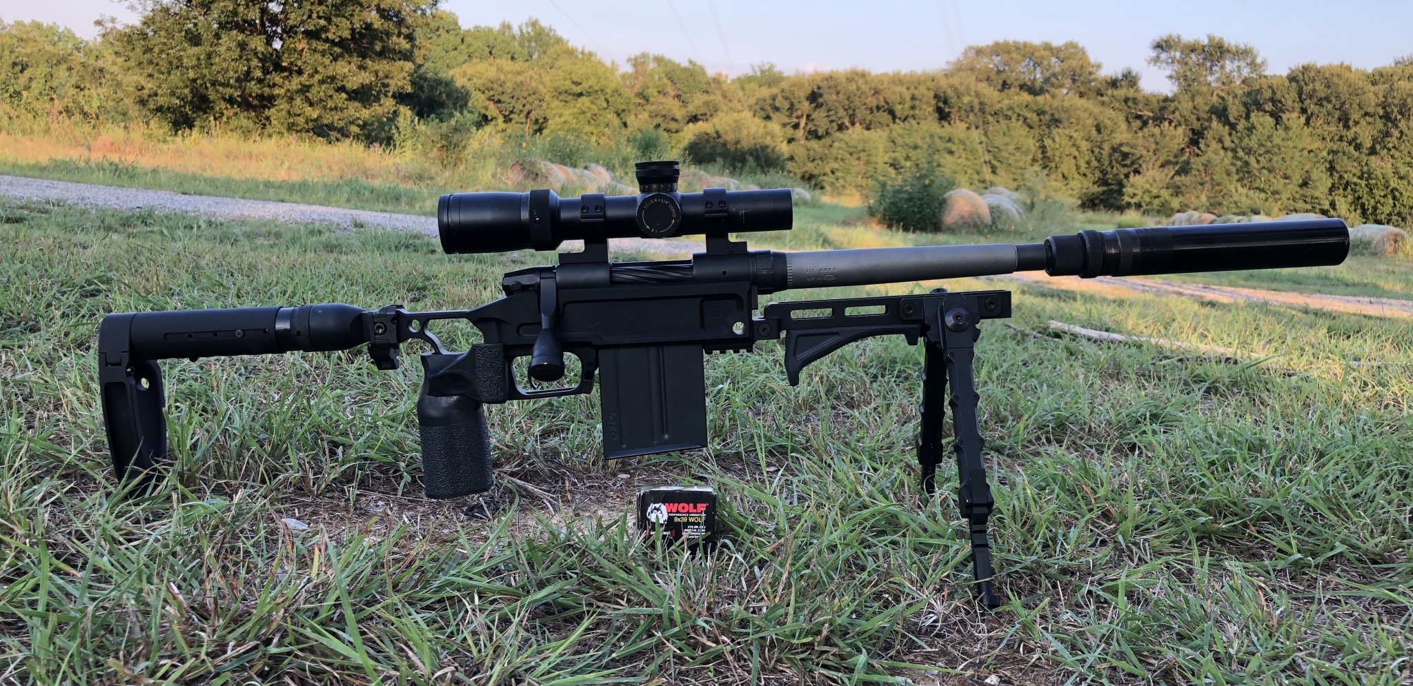

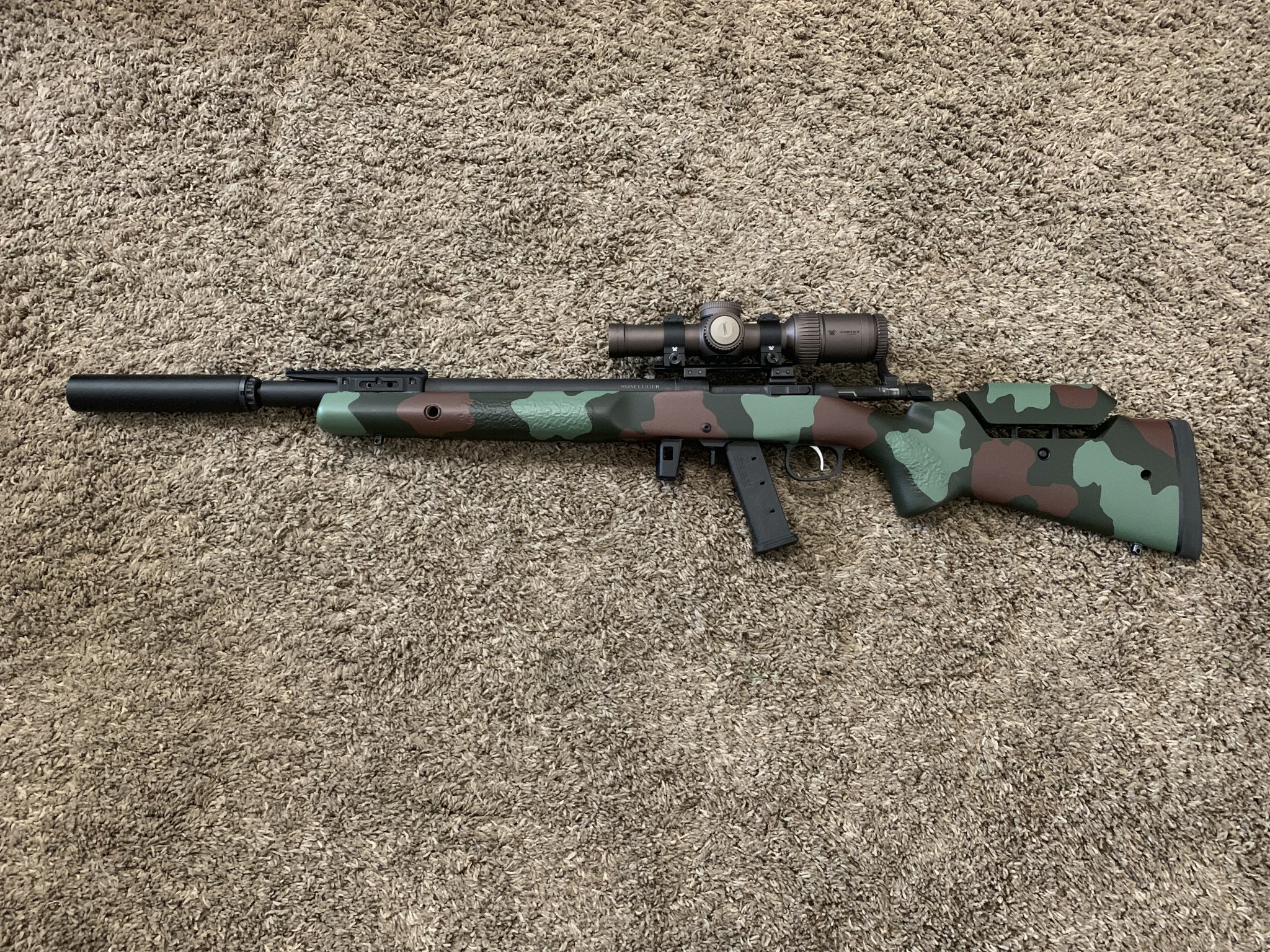

Got it to the range for the first time today and it’s ridiculously fun and stupid quiet. Was ringing steel at 300 yards pretty consistently with 147gr subs.
It's a one off (actually two) build on a CZ action in a special made Manners stock that takes Glock mags. The can is a Griffin Resistance 9. At the shooters ear, the firing pin and spring is louder than the report of the shot.

Mr. Louroo, can we get a picture through the mag-well? Last I looked you had to do a bit of cutting on the bottom of the receiver to fit a G17/G22 DSCF mag.

I'll take a pic for you, but my understanding is that the bottom metal on this one is completely custom milled from scratch. Not sure if the receiver was milled.

The bottom of the action has to be opened up for the mag.
The biggest problem with say the 357 sig or any pistol size cartridge is the distance it has to travel unsupported, so tapered counter bores and furthest forward feeding mechanism is key. Also extracting is problematic with such a small case on a rifle designed action. It could be done for sure but a lot more to it than just opening the bottom of the action

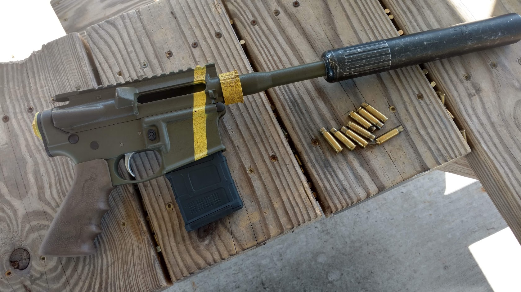

I got some of those Endomag inserts with the CMMG Guard 9mm upper. Its having significant extraction problems. The Endomags work great. I think the problem is the CMMG bolt / extractpr / ejector. (its semi auto) I'll be contacting them this week. But in a bolt gun the Endomags should work great.

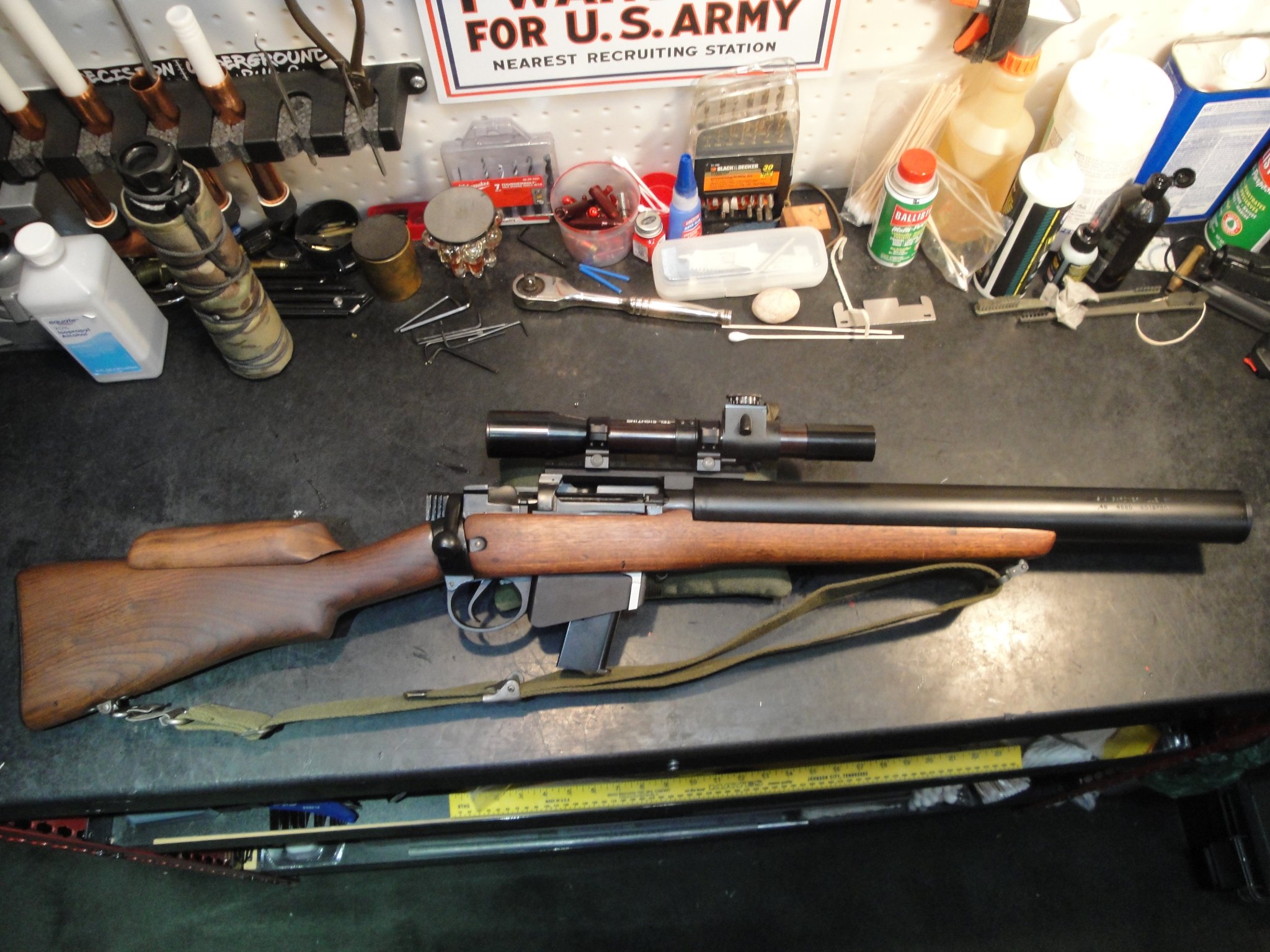

That thing looks like a modernised version of the DeLisle Carbine. I love it!
My version of the De Lisle carbine (Integrally suppressed, 45acp, 1911 magazines) built on an Enfield by Special Interest Arms. They are no longer building these rifles, but I'm sure it could be built by someone else... I added the cheek rest and scope for a sniper rifle.
That thing is beautiful!!! Congrats on a sweet rifle.
Still gives me a boner
It’s so much fun to shoot. I was recruited to be a range master for a church youth group outing a few weeks ago. I brought this with me and let the kids shoot it. I had a bunch of Dads come up to me at church the following day to tell me how much fun the kids had shooting it and asking when they were going to get to shoot it. ?
