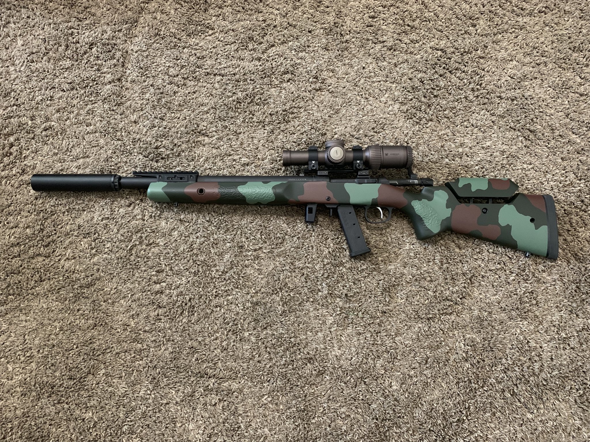

New to me 9mm Bolt Gun
Built by @VJJPunisher
Got it to the range for the first time today and it’s ridiculously fun and stupid quiet. Was ringing steel at 300 yards pretty consistently with 147gr subs.
It's a one off (actually two) build on a CZ action in a special made Manners stock that takes Glock mags. The can is a Griffin Resistance 9. At the shooters ear, the firing pin and spring is louder than the report of the shot.
The question I have is, what kind of accuracy are you getting?

Plenty good for 9mm. Was ringing steel at 300 pretty regularly in the video I posted in the OP. That said, I've mainly just been plinking with it inside 100 yards at various targets, steel, spinners, etc.
