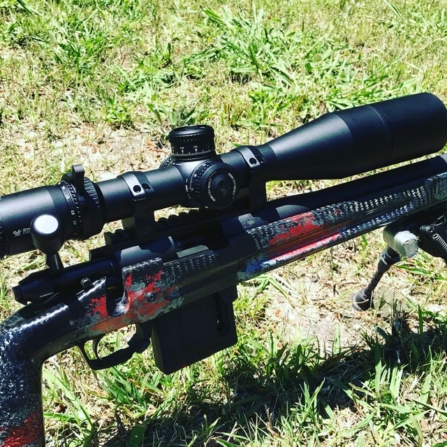

Medium is a generic term and is different from ring maker to ring maker. For the SE with the 56mm objective I wouldn’t go any lower than a 1” high ring. This is a set of 1.1” high rings on my Vudoo with 40 moa base and SE.
And moa in the base is so small in difference ring height is not an issue.

Love it! Thanks for the help on that. Sick Vudoo!!!
