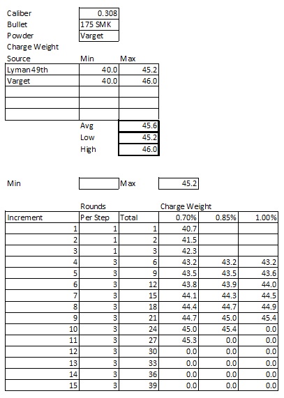

Now the question is do I start over and work up loads in 0.3gr increments from 40gr to 46gr as some suggested I should have done in the first place in case I missed a node? Or should I make some refined loads in 0.2gr increments above and below the best groups noted above? I didn't make any loads over 43gr this first round. Might also make loads above 43gr up to just over the max. Here's what I'm thinking:
Or here's the OCW suggested loads per the above linked Excel file

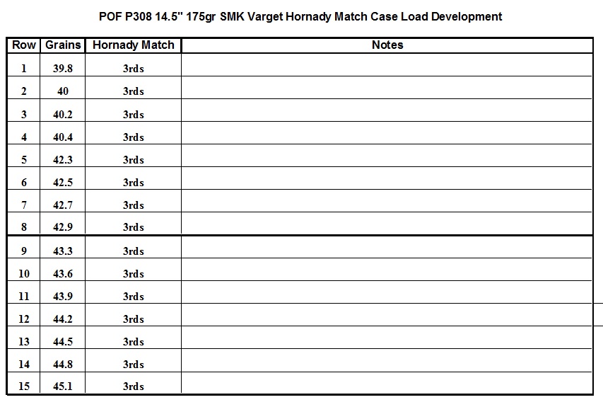

Ok so I made it to the range today to shoot my OCW loads. Here is the sighters and OCW load groups in the first picture. In the second picture I added 3 loads below the first OCW load group. All shots were fired over my ProChrono Digital with Chrono numbers for each load below. When firing the 45gr load, the first 2 shots were ok but the third shot popped the primer out half way. This did not happen on any other loads. As the loads got hotter there were more and more extractor marks on the cases.
OCW Sighters and Loads
Additional Loads I added below first 3 shot OCW group
Chrono Numbers
40.7= 2237
41.5= 2275
42.3= 2318, 2335, 2326 Avg 2326
42.5= 2314, 2339, 2326 Avg 2326
42.8= 2355, 2359, 2364 Avg 2359
43.2= 2364, 2376, 2376 Avg 2372
43.5= 2380, 2393, 2411 Avg 2395
43.8= 2419, 2402, 2406 Avg 2409
44.1= 2433, 2428, 2428 Avg 2430
44.4= 2419, 2450, 2419 Avg 2429
44.7= 2469, 2464, 2455 Avg 2463
45.0= 2487, 2501, 2506 Avg 2498
Based off the above groups, I'm not sure which loads I should start working around? Any help?
