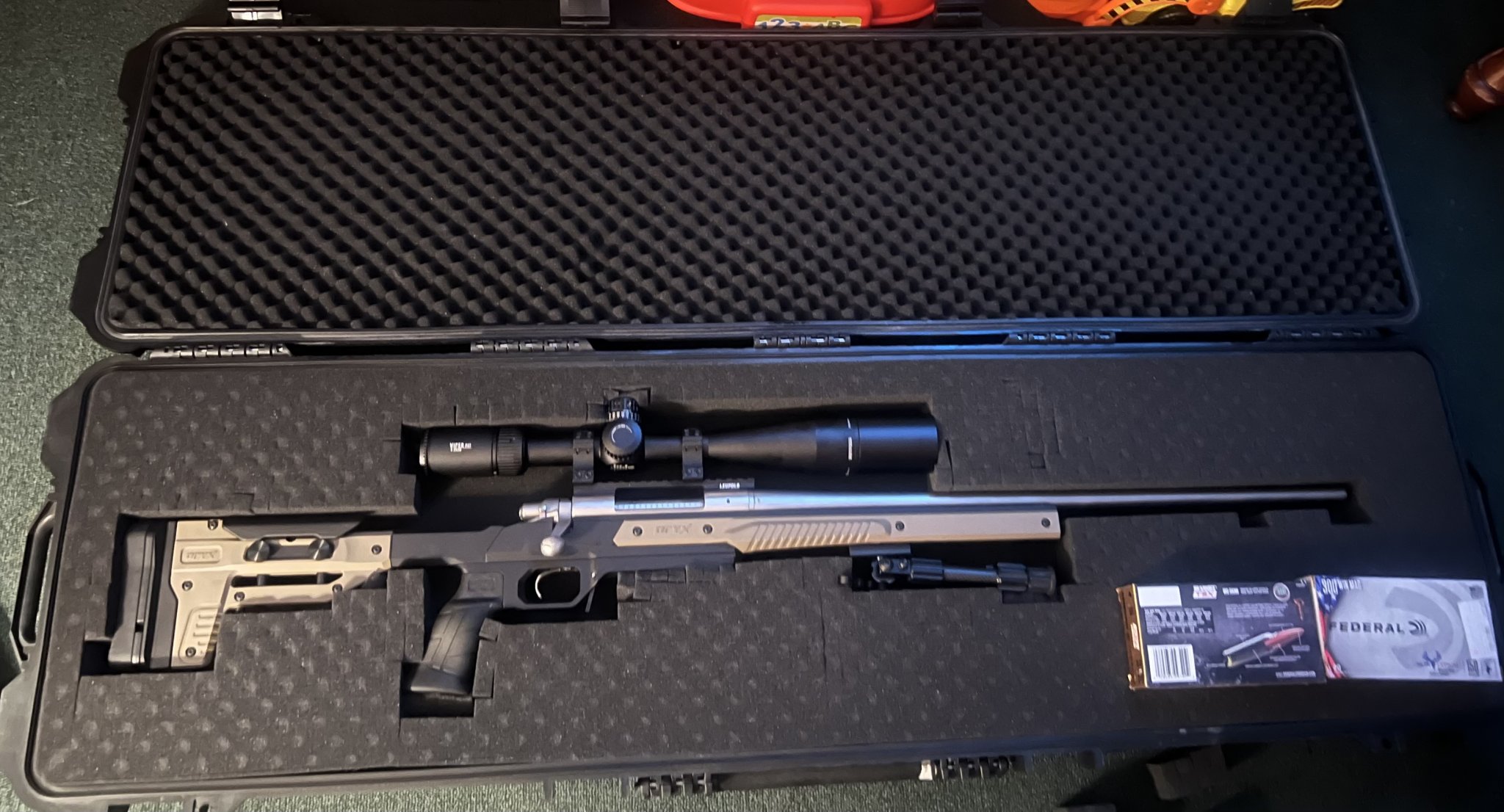

So I just picked up a Hornady LnL classic reloading kit , with their case trimmer , and their match 300wm die set . This is completely new to me and I have no idea where to start . This is an elf rifle I plan to shoot to 1000 and beyond.
It’s a blueprinted rem 700 action with a 24” 1/10 twist barrel sitting in a mdt oryx chassis with a vortex viper pst gen 2 5-25 optic . I have some federal premium ff brass for it , but as far as new casings , primers , bullets and powder selection , I’m lost .
I was going to get some h1000 and retumbo but my local store has nothing ..
Anyways , I’m open to any suggestions as to what projectile will work well , as well as powder primer brass suggestions , so I can start down the rabbit hole asap

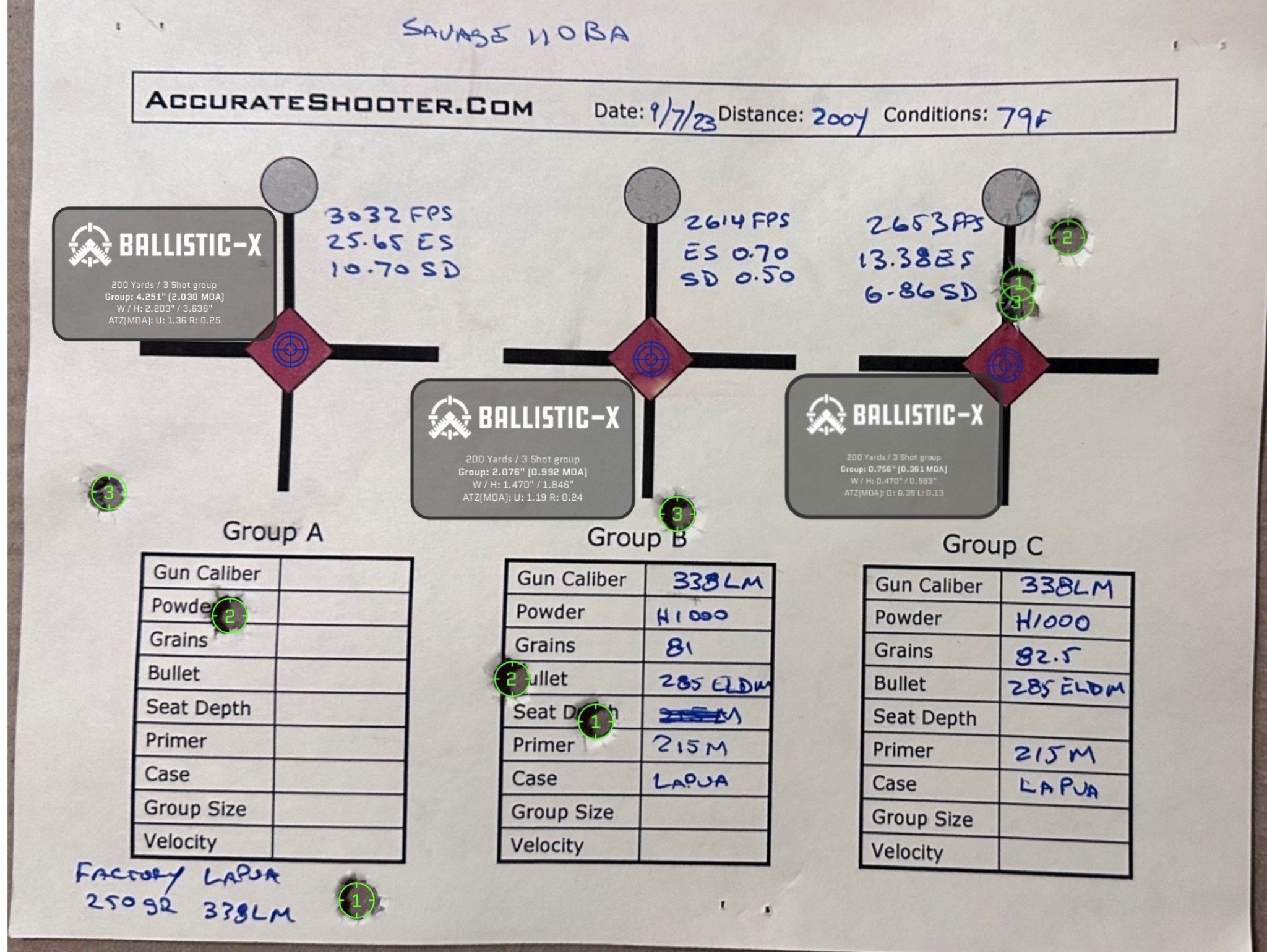

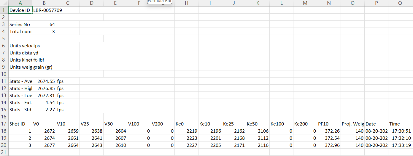

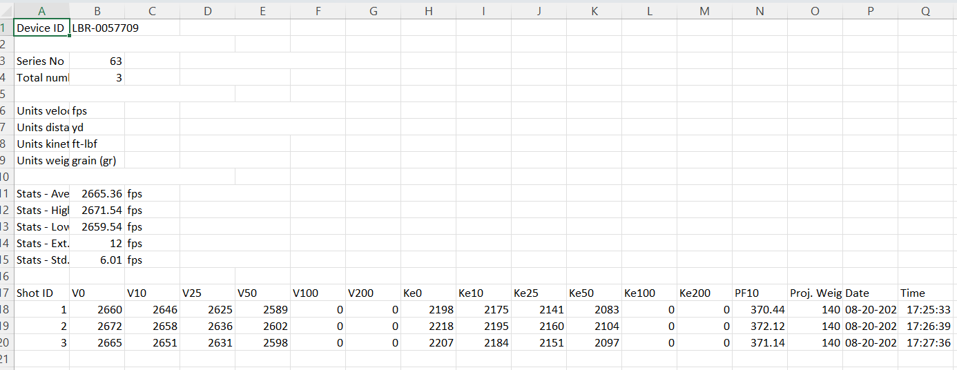

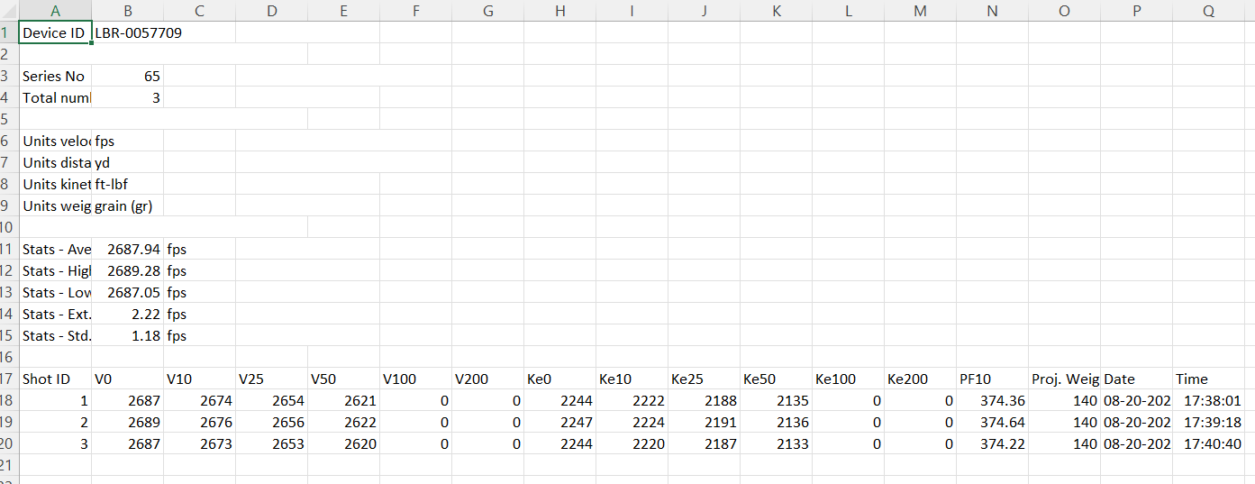

I haven’t chrono’d any of the federal , but in my rpr 338 lm , we were shooting just under 1000 yards “926 to be exact “ and when chrono’d ,with hornady match ammo we saw as much as 50 fps swings . I understand fully what you mean in that aspect - in comparison , my buddy was shooting hand loads in 37xc and saw very little variance compared to my 7 dollar a round hornaday ammo.

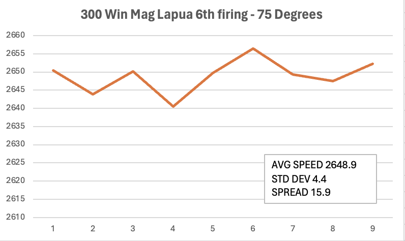

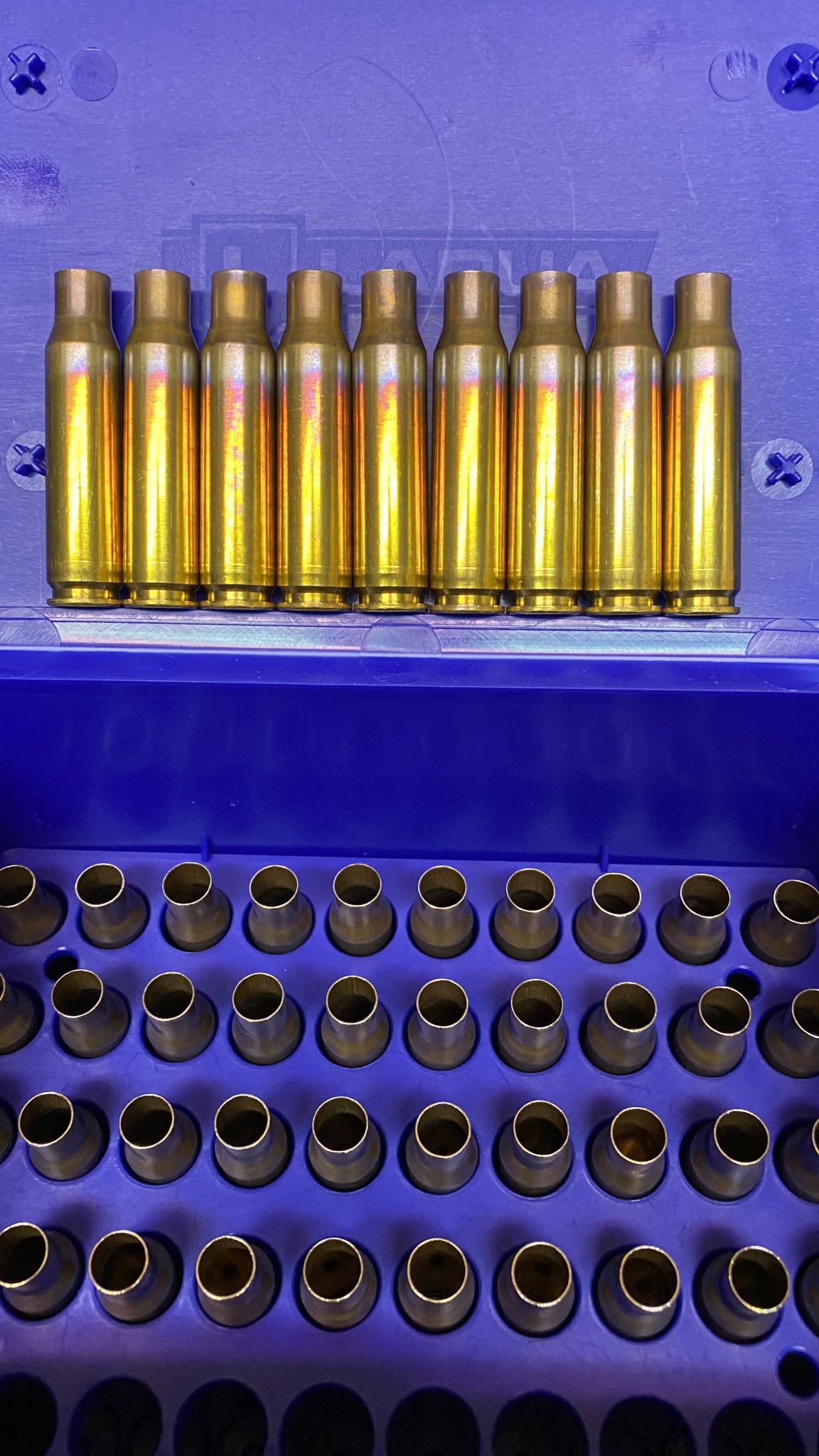

You can go quite far with 100 pieces of brass if you don’t stretch the primer pockets or over work the brass.
I had 23 firings on 200 pieces of Lapua 308 brass. I retired the brass when I swapped barrels.
I have 338 Lapua brass (Lapua) with 10 firings of 90gr of H1000.
Reactions: Dennis5374
He’s better off ordering an annealer.

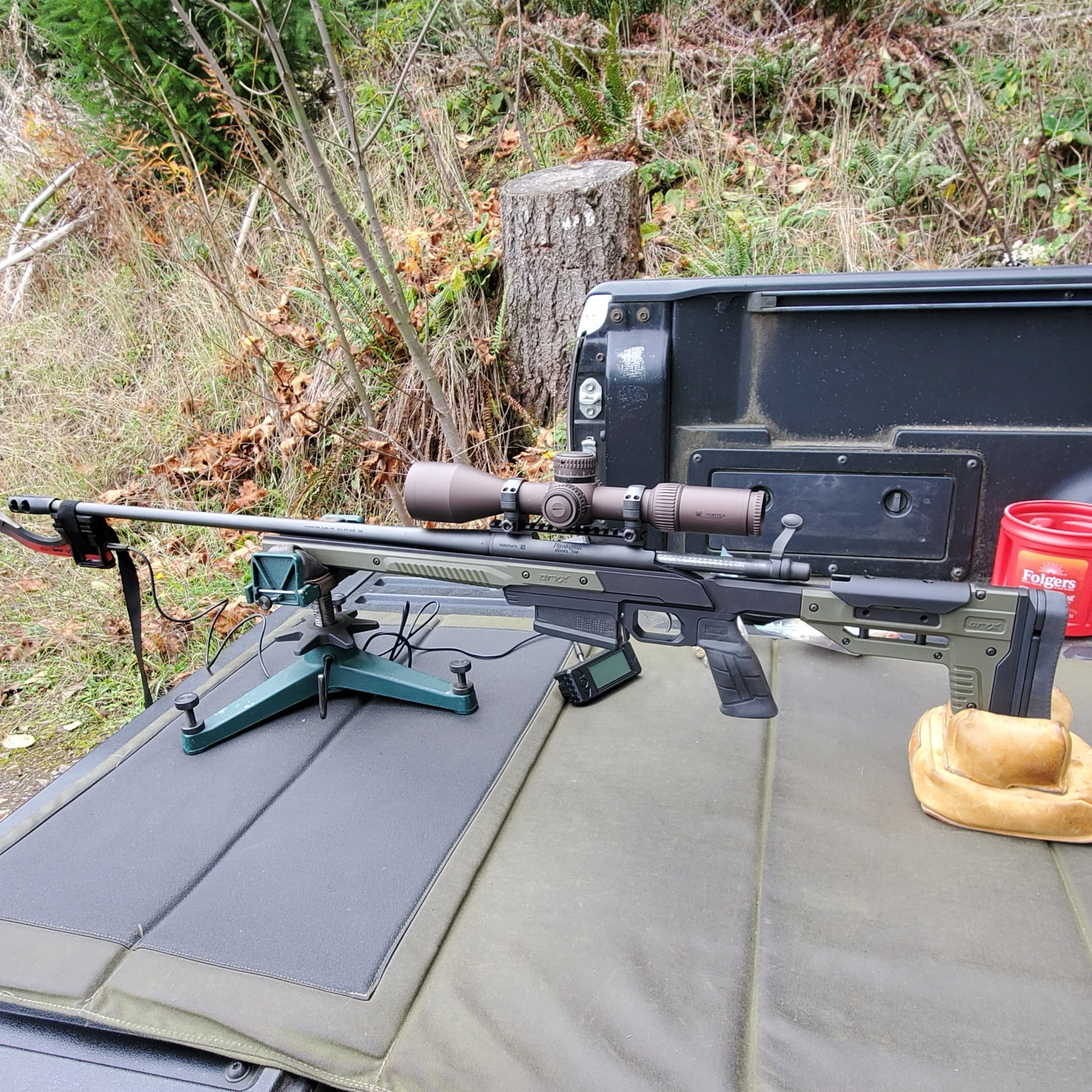

The chasis is what I used on a new Rem 700 300 WM ADL on sale for $540, and $375 for the chasis, on sale, plus $80 for the 3.715" detachable mag. Get the long mag to improve performance like 230 SMK at 2962 fps for LR endeavors.
Also threaded the barrel in the lathe and installed a muzzle brake.
It will put 3 or 4 in the same hole and is a 5 shot 1/2" shooter, as the example shows. Totally all cheap factory Remington 700, which I actually bought only for the action.
Then decided I should shoot it first as it is, a 300 WM.

I wonder if annealing would help my 6x fired lapua shooting under 5sd?

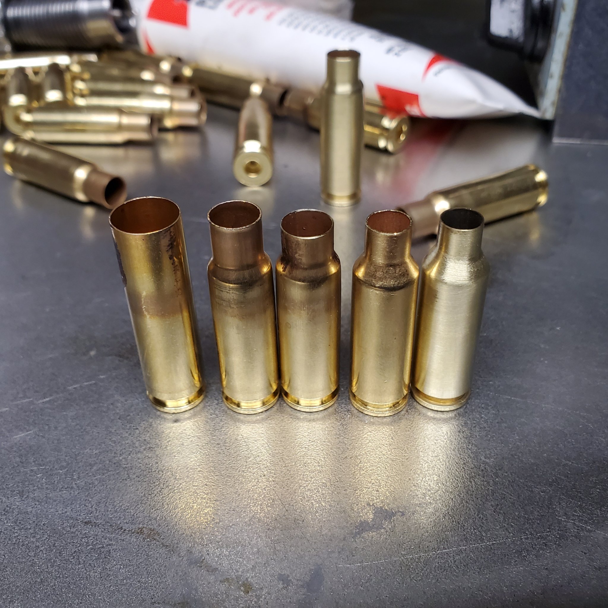

The neck begins to spring back so I just made a .001" smaller bushing, on the lathe for free, and keep shooting.
These were max load charges, on the cases, after 40 reloads, the brass keeps stretching, and needs trimming, cycles, you will see the headspace seperatetion similar to the magnum cases described., then discard the cases it can be seem and felt with a hook tool internally down at the head there is a distinct bump in the case where it should be smooth.
I have shot belted magnums for many years, never annealed them, and never had a problem with them, just use the shoulder to headspace after the first firing. No special tools needed.
Even fired a too hot load with a QL recommended powder, with a 200 gr SMK st 3280 fps, didn't blow the primer but expanded the pocket too much, a stiff bolt lift, but the whole case came out no seperation problem.

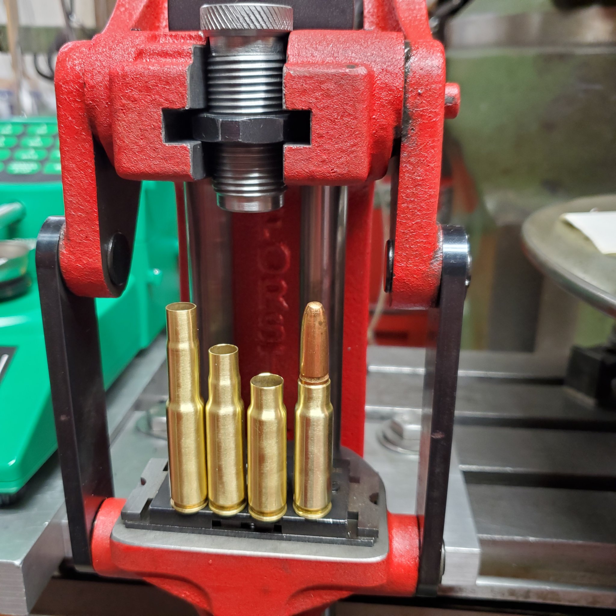

I form lots of wildcats and anneal them because of all the brass movement on some. A flame and a homemade holder made in the lathe, the brass turned in the lathe with a touch flame to the neck/shoulder...works great. No expensive annealer needed ...at all.
Some test were done and even way over annealed the brass, but they all shot about the same group size, with the over annealed slightly better...LOL. Annealing brass is not a high tech endeavor .
Spend your money on whatever...don't care, or anneal on ever firing, but I have better things to do...time consuming and brass isn't that expensive for many calibers.
I, only anneal when case forming, in most cases. And it will help with shoulder spring back especially in forming cases, but it's better, or at least add, turning the complete neck and shoulder back in the lathe, with the exact angle, example 308, or 30-06 to 8.6 Blackout, for a perfect smooth fit in the chamber. Depending on brass condition from manufacturer, annealing on the first step will collapse the case. A special home built die is made the first step can be done with a dry case, but a light spray is used here, shoulders come out very nice.
Or sometimes basic cases come in all hard from Starline and requires annealing in every step... so for me it depends...but I don't use it on already factory formed cases for the caliber I'm shooting.
Perhaps it would.
I want to make it very clear that I am not implying that annealing affects E.S. or S.D. numbers.
I was suggesting that case life may be extended by annealing.
We can both play these games.
These are some of the LabRadar logs from my 6.5CM load development but with actual data.

3 shot groups don’t mean anything but good try. 2” groups at 200 yards isn’t precision even in a 338.
I have no idea why you’re recommending an annealer to a novice reloader. They can spend their time on real things that make an actual difference. Not playing with flames with no proof of helping them except maybe extending brass life (which only experienced reloader really need due to volume)
Where do you see 2” groups at 200 other than the factory Lapua ammo?
4/7 groups are sub 1/2 moa.
6/7 are sub moa.
This is load development don’t forget.
