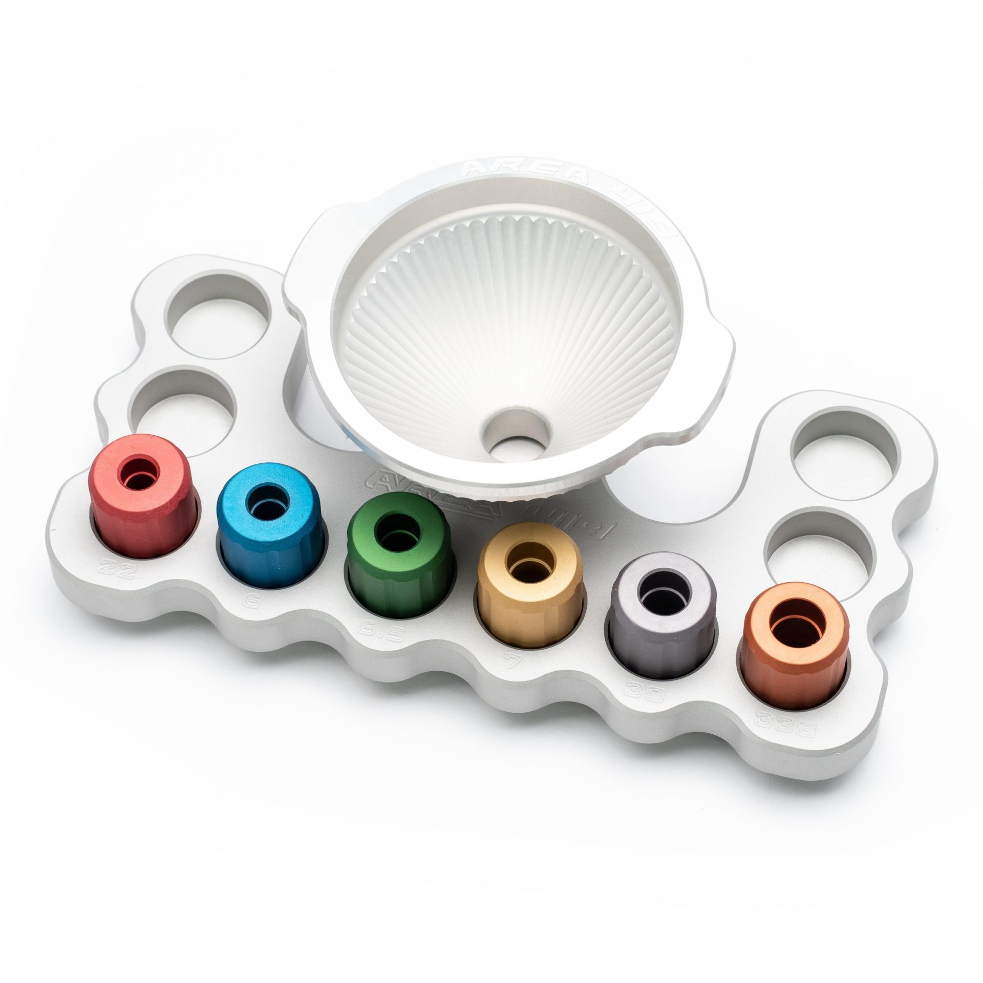

Don't see a powder funnel kit mentioned but you might already have one.
Couple of add-ons that you might want - Forster Coax curved linkage, KMS Squared lighting kit (better than the Inline Fab lighting kit). Inline Fab ergo roller handle is great. @justdreaminglr riser/draft shield is a nice quality of life upgrade for the V4.

I don’t have a funnel kit, that’s one of the many “small” things I still need to get.

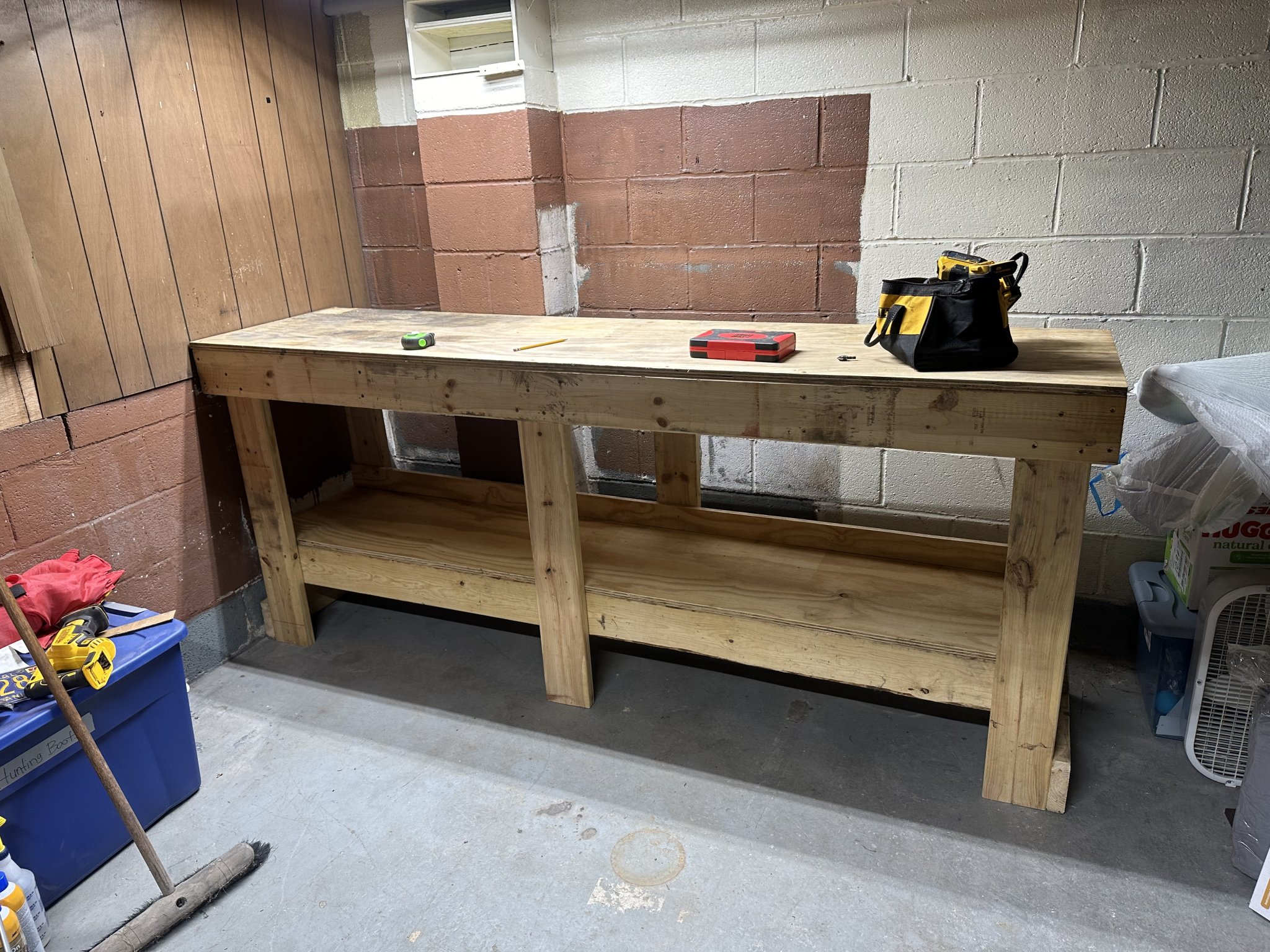

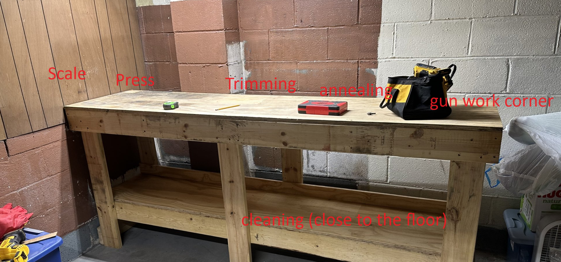

I’m working on getting the work area put together. The bench is 8’x2’ 40” tall. My foundation has a protruding block pillar in the corner, rather then notch the bench around it im going to make shelving to fill the 8” void. I think im also going to build a bench on the left wall to add additional work space as well as tear the paneling off the wall and install pegboard or something similar, maybe inline fabs wall system.
What I’m not sure about is how to setup workflow, use an inline fab mount and rotate my 2 presses and Henderson trimmer around on it? I have plenty of bench space especially once I build the left side bench. I could also permanently mount both presses on that smaller bench to the left. How would experienced guys set it up?

I mainly want to keep some open table space for cleaning rifles, trigger swaps, assembling ARs and just general gun work that I currently do in my living room.

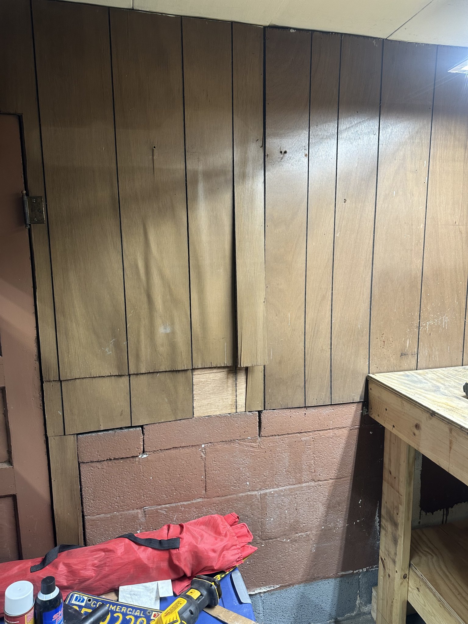

I would set up "cleaner" reloading stuff on the left side towards the wall and the right side area where the tool bag is for a bench vise as well as more "dirty" work. Measuring out extra space (longest rifle/shotgun + 2 to 3 ft) should give you a reasonable amount of space for general firearm work. The dirty work would be like case tumbling and trimming would be closer towards the general gun work area and the stuff that should remain clear towards the left. You should put anything annealing related (less of a concern with induction annealing) farther away from any of the powder charge related equipment for safety reasons.
I don't see an electrical outlet in the picture but that's gonna determine where you can put anything that requires electricity. Your overhead lighting if it isn't LED, should be switched to LED since fluorescent lighting can mess with your scale tracking.
Thanks for that. I’m probably going to extend the bench along the left wall and I was thinking about putting my presses over there then they’d kind of be out of the way and leave the larger bench open for whatever else.
There’s no power outlets in that corner. I’m planning on putting an outlet in straight off the panel box just for the scale then running additional outlets to power whatever else.
The overhead light above the bench is LED and I’ll be adding another along the left wall that will also be led. I have a 5 shelf storage rack I’ll put to the right of the bench as well for keeping things organized and off the bench.
Reactions: Herb Stoner
I have my scales and presses on different tables. Scales don’t like to run when the table is vibrating from the press.
Makes sense, not considering that I would’ve tied the small table into the large one but maybe it’s better to leave them separate from each other for that reason.

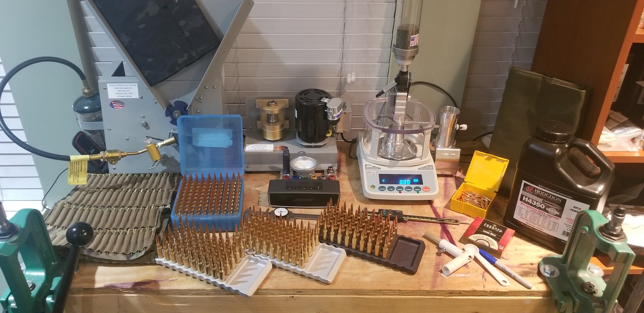

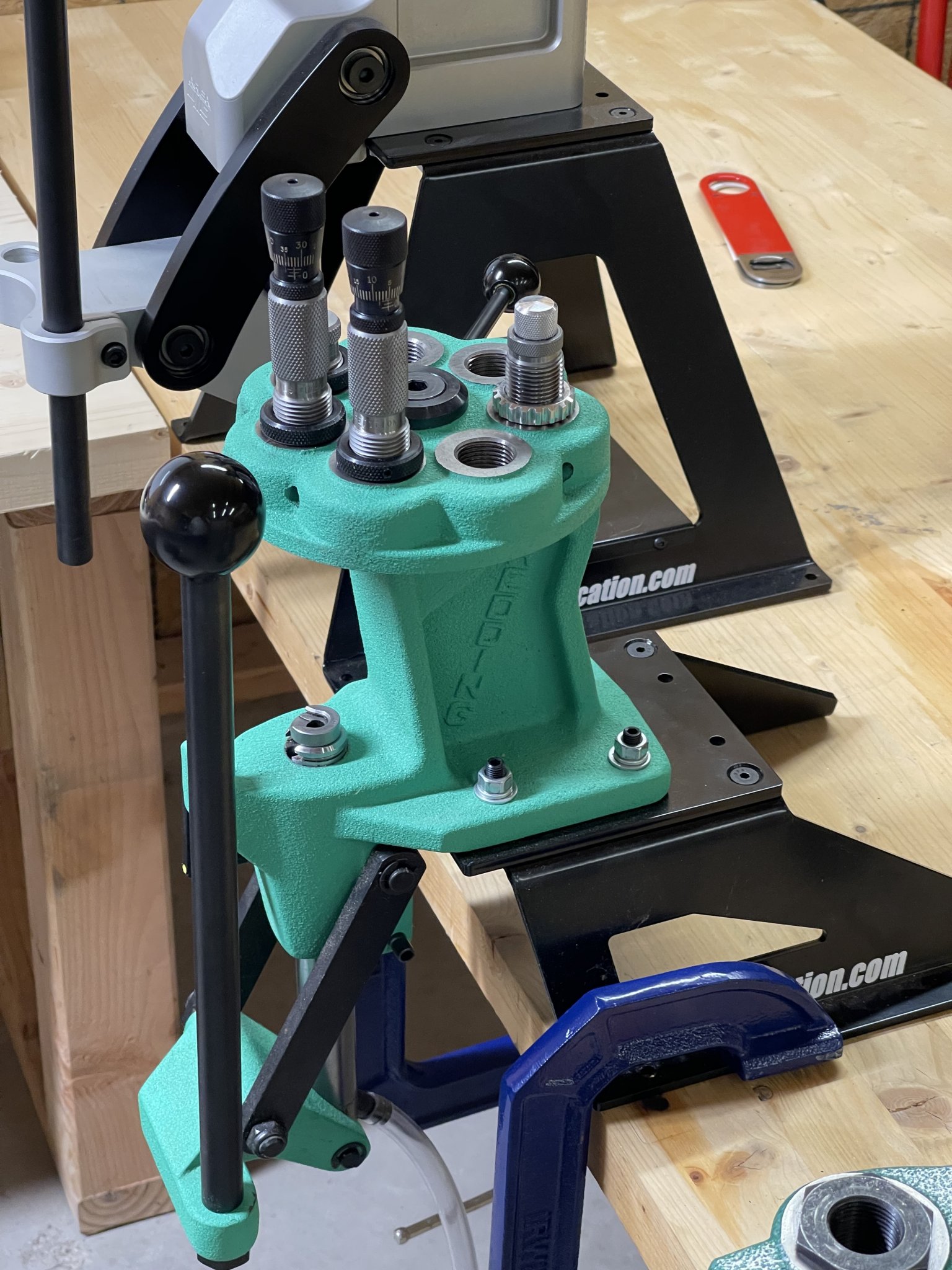

Your T7 is so clean...
Mine is caked with black crap :)
