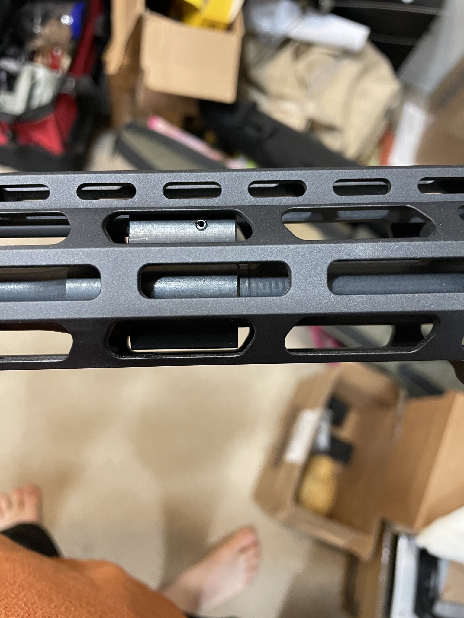

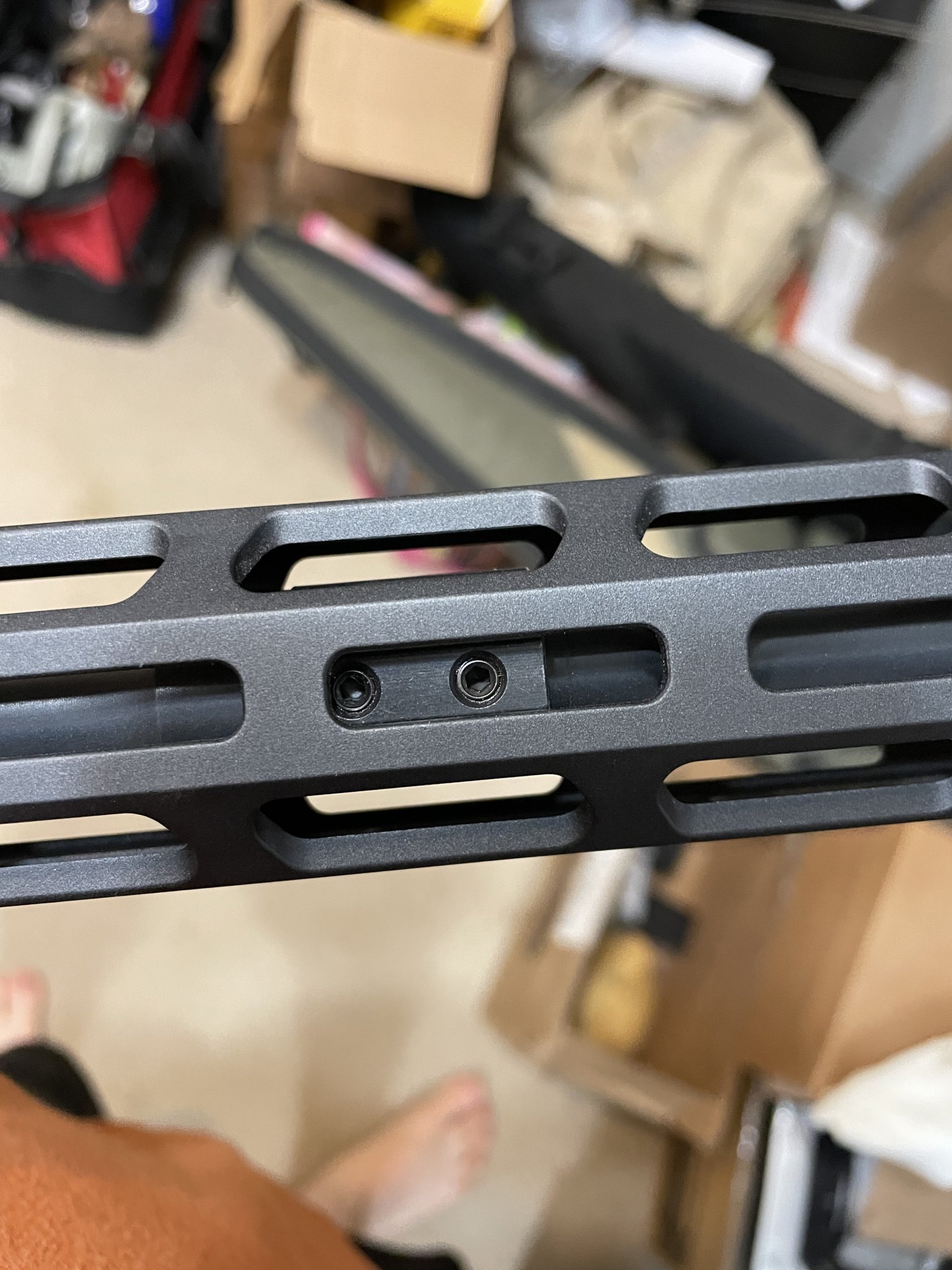

Go easy fellas I have a lot to learn. Books have been ordered but they aint here yet. Bought a new 3rd Gen Tactical brand AR in 223 Wilde a few days ago. Will be used for Varmint hunting out to 200 yds max usually at night. So far so good with load development. The best yet is 26 grains of CFE223 that shoots .495" 6 shot groups at 100yds with my varmint bullet of choice (Sierra 55gr BTHP) However it appears when I added my can it is making the brass very black now. Before with just the factory break they looked a lot cleaner. Am I to assume im overgassing now? How do I tell if I have an adjustable gas block and if I do how do I adjust it? There are two Allen head screws on the bottom of the gas block under the hand guard. Accuracy went WAY up with the can (SilencerCo Hybrid) but so did the "soot" on the brass. Come on with the comments as I know next to nothing about semi autos. I am on old school bolt gun guy.

There is usually a detent that is marked for an adjustable gas block. Without seeing a picture it is hard to tell because there are a lot of designs. The brand of the rifle may also give us a clue. My guess would be it is not just because the vast majority are not adjustable.
As far as the too much gas issue, the fixes are actually pretty easy. Installing an adjustable gas block is actually a pretty easy do it yourself project. There are a couple of good options, my favorite is the JP adjustable gas block but I have also had very good results with the Seekins.

The two screws on the underside of the gas block are the tension screws that hold it in place. If it's adjustable, which would be unusual for most anything other than a premium rifle from a big name brand, it'll have a screw or two near the top.
While it's likely the rifle is overgassed once a suppressor is attached, the sooty brass is pretty much here to stay regardless of gas adjustment.
The two Allen screws below are likely indicative of a clamp on gas block, so loosening them would remove it. A picture would be helpful, but typically an adjustable gas block has a screw or other adjustment point parallel to the bore. As for the soot, while you probably are over gassed with a can (solveable with an adjustable gas block or bootleg style BCG) you will probably always have some buildup as that is simply how the AR action works.

If it’s adjustable I can’t see where you were adjust it. I think the replies above are correct I think that’s just the mounting screws. Looks like there’s two screws on the bottom and a roll pin on the top. As far as the Black brass thats not really a problem as I have an ultrasonic cleaner and a corncob vibratory cleaner. I can make em look new. I just thought it was a symptom of overgassing.

Yes, that is a standard gas block and not adjustable. If the felt recoil is too much with the can, the first step is to switch buffer weights (H2 or H3 is a good start). To control gas, and adjustable gas block or BCG is the way to go.
