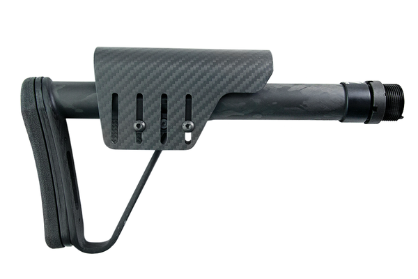

Is there a way to attach a sling to the carbon stock?
Fantastic concept and weight savings.
Or direct from the stock manufacturer, Smoke Composites:
Reactions: raschiller
Smoke Composites does build these for us hence the name but the stocks they build for us are different than the ones on their site. They have worked with us to build them to our spec and lengths we have set forth. So if you order from them, it will be different than what you get from us.
Edit to add: if you are referencing the sling mount options then you are correct. Our Mlok QD adapter or theirs will work just fine.
