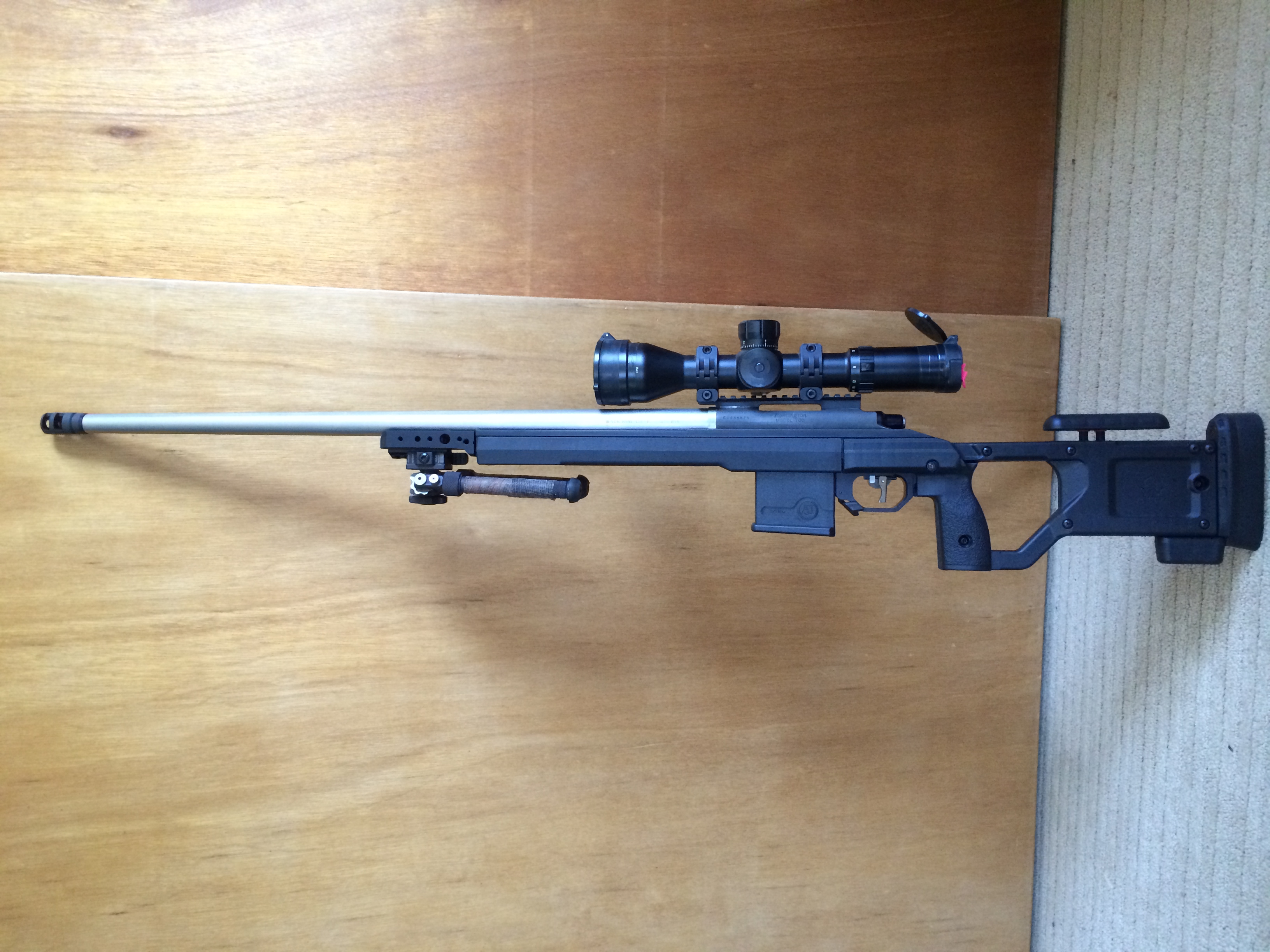

It's a little too eurofag with the black and stainless so I'm going to give it some green and brown.
(223 mag is for effect as my 308 mags weren't accessible)

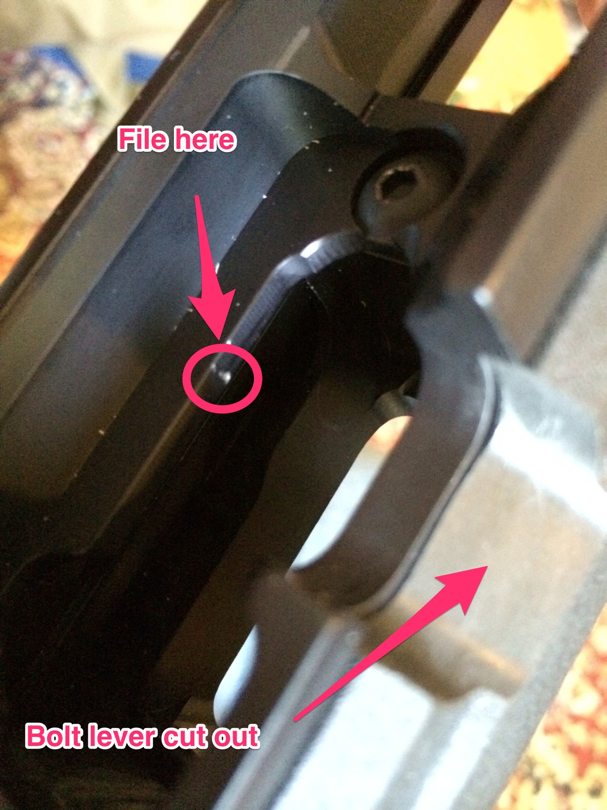

I installed a Timney 517 trigger on my x-ray chassis and the safety is hard to move. Anyone had this issue or suggestions to resolve it ?
remove your action and check that it is installed level. First time i bolted my Tac30 in the pin that protrudes on the timney when you engage the safety was hitting the trigger guard area. i removed the action screws and then just held the action in by hand and the safety worked fine...installed the screws again and it works fine now all torqued down...somehow i had the action very slightly canted...it looked straight but was off just enough for that pin to hit...chassis is awesome btw...switched my barreled action from a whiskey3 to the xray and matched the length of pull and cheek piece height and after some slight adjustments to my zero it was shooting tiny groups just the same.
Yes. I posted a thread on this, and at least one other user had an issue. Our issue was the little pin that moves in and out when you actuate the safety. As was recommended to me, mount the action in the chassis and loosen the bolts enough to work the safety with some friction. Work it back and forth a lot and see if you can get it to mark the chassis (the pin on the Timney is a hardened steel vs the soft aluminum of the chassis, so this wasn't too difficult). Once I had the spot marred, I used a set of very small hobby files to cut a small slot in the chassis where the rubbing was. See the attached photo. Unfortunately, I was so excited to get the safety working, I forgot to take a photo of the trough I mounted and torqued the action.
I will say that the chassis rocks, and the modularity exceeded my expectations (I'm a new large caliber "precision" shooter). I moved up from one of the B&C M40 stocks that everyone used in a "budget" precision build. I was a little surprised how much "play" there was with the action in the chassis (Remington 700 SA/AAC-SD in .308), but I feel like I got it trued to the best of my abilities-don't have any tools or jigs to make this fit correct.
I have a Timney as well, so that photo will come in handy when my stock arrives.
Damn, I'm getting excited now. I'm upgrading from a B&C Medalist/Light Tactical that I dremeled out for PTG bottom metal, so moving to a real chassis is going to be a great upgrade for me. The B&C was just a touch too short for my gorilla arms, and I wanted a better method of shooting off barricades/windows than jamming the front of the magazine against them.

Is it safe to assume that whatever modifications that was needed to fit the Timney 517 will be needed for the 510 model as well? I've read about some that just drop in with no modifications needed, and then others that have problems; not sure how the tolerance between these two parts can vary that much unless the action it is mounted to has something to do with it... If I have that same problem, I'm thinking about modifying the pin on the trigger itself (grind it shorter) than touching the chassis, unless that is not recommended.
Thanks so much. That picture was very helpful.

To those about to modify your new chassis - why not just modify the trigger instead?
For those that have a Timney trigger and are not wanting to modify their new chassis, the safety plunger (on my 510) is very easy to modify.
On the left side is a C clip. On the right, the safety becomes a flat triangle piece that pivots at the bottom.
Squeeze the trigger assembly (left & right sides) and pop the C clip.
The assembly will want to spring apart, so carefully separate the safely lever from the housing, and the safely plunger (and small spring) will fall free.
I trimmed the shaft of the safely plunger with a grinder down to no less than 0.310", rounded the edges, and hit it with a K-B cold blue pen.
Put the trigger assembly back together, and you should have plenty of clearance to get the action squared up with no interference.
