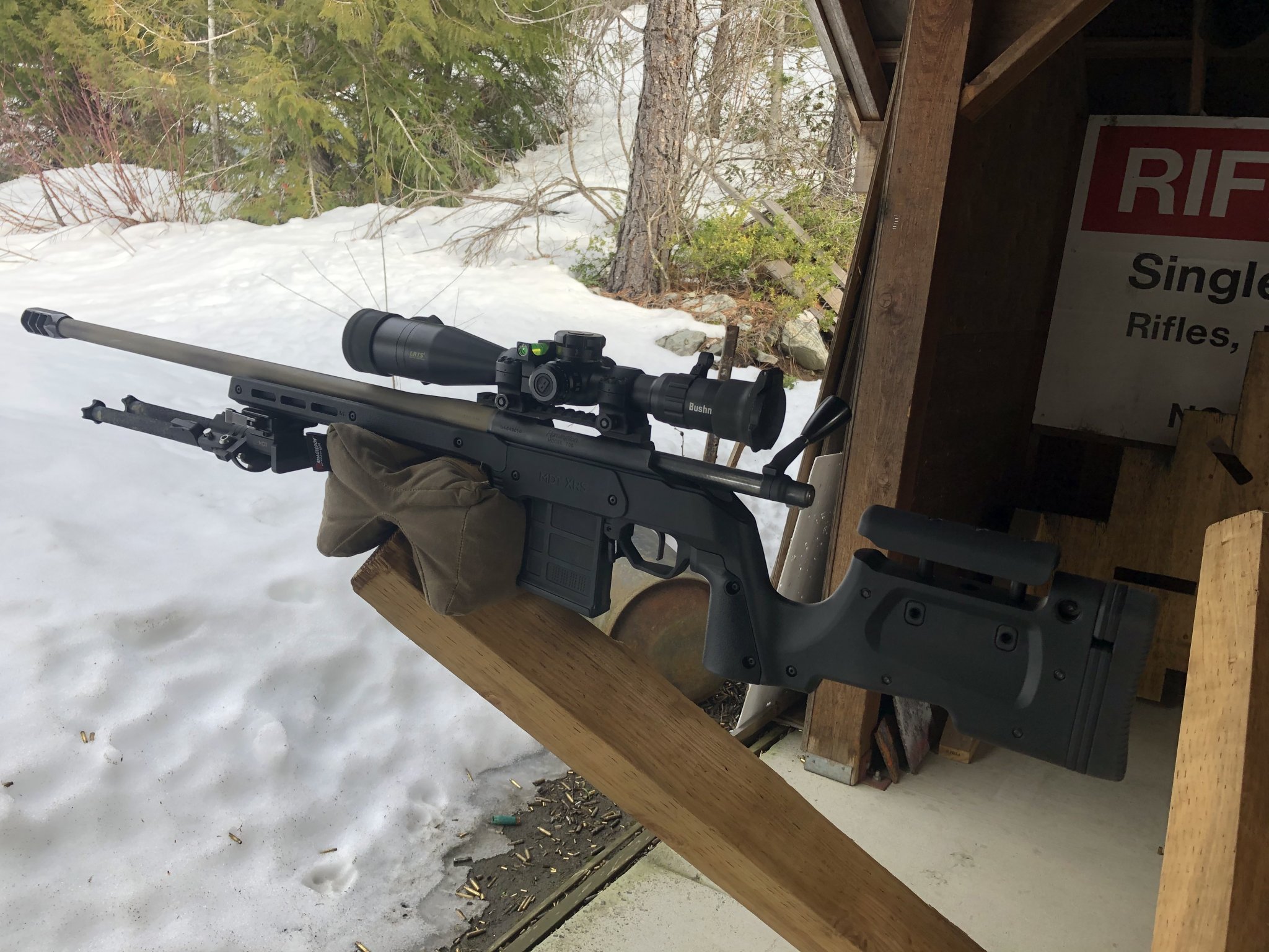

This might help. Rem 700 with 26" med palma. About 14lbs all in.
Hey @littlepod good question! @dgheriani is right that his photo displays how much the weight distribution is different in the XRS than the ACC or Oryx for that matter. Basically, it comes down to the fact that there is very little aluminum in the buttstock of the XRS meaning that you can get the centre of gravity a lot further forward with a decent barrel profile.
I think that for your setup, the XRS would be a little under 14 lbs, but you may find that the balance point is not far enough forward and could have to add some external weights to the forend. So by switching out from the light ACC to an XRS with minimal weight added, you'd probably get good balance and drop the weight off the gun you're looking for.
The Oryx is a little different in the fact that it still has a bit of weight in the buttstock (more than the XRS but less than the AC w/ alumnium buttpad base). To get the correct balance on the Oryx, you'd either need a heavier barrel or more weight up front, which means you'd probably be at a similar weight that your ACC is at now.

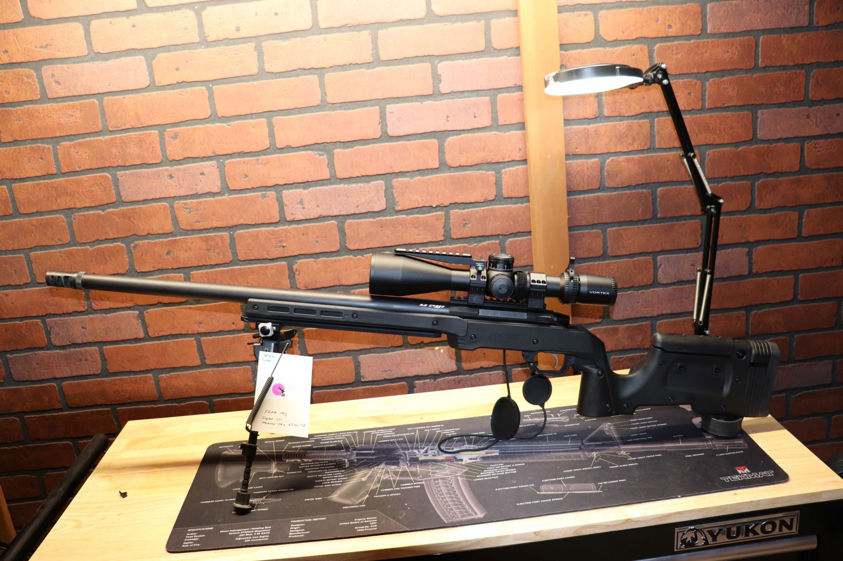

Well, win one for MDT. My Impact Precision 737 dropped right in. No inletting, no Dremel, no modding. It also fit my truck axle of a HawkHill Barrel, with room to spare. In addition the Area 419 Universal Arca rail line right up.
The only gripe I do have is that the XRS mag well is super tight and doesn't seem to like my metal Accurate mags or AI mags. They will fit but not without some coaxing.
Now my p-mags, no problem slide right in and out. I thought about maybe filing a bit away to make room but if the p-mags work than I'll just stick with them and keep the metal mags for my AX chassis.
Installation was a breeze but the captured action screws could be a PITA if I decide I need to switch them out for any reason.
I finally took this build out today to zero, the first time being fired, no break-in process and I'm a happy camper. I almost forgot how much I liked shooting a traditional stock setup vs ergo and chassis.
So not knocking the Bravo, but I think the extra $ for this is justified.
It fit the Impact without modification. That right there saved me $200 from a smith.
It fit a bull barrel contour easily.
The ability to switch grips is actually very effective.
The forearm is longer than the bravo.
