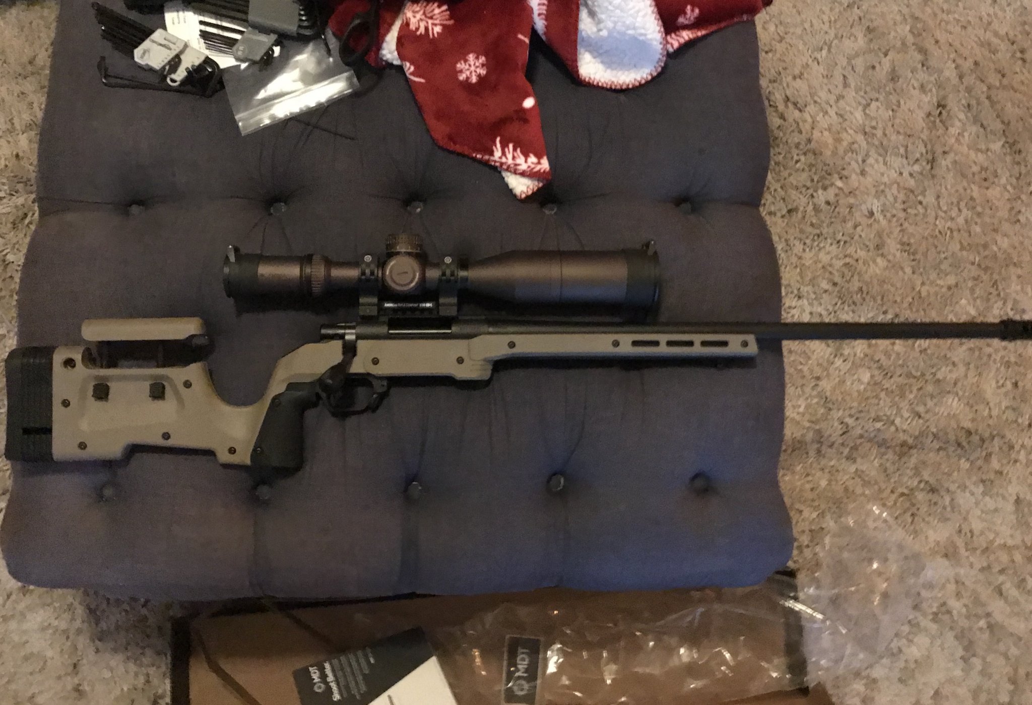

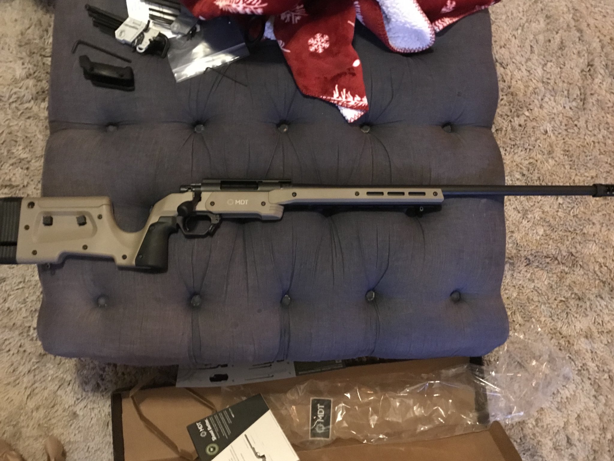

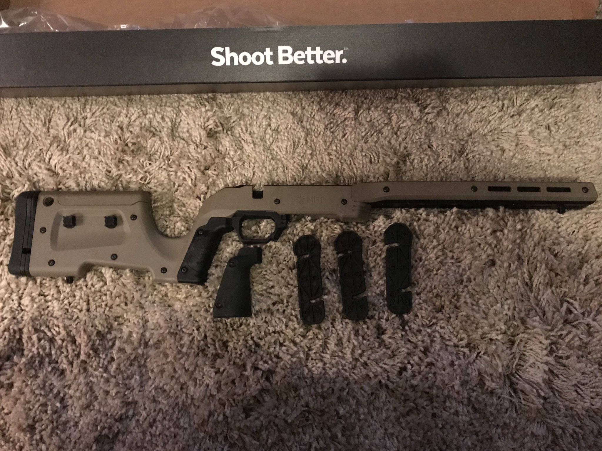

Look what came a day earlier than expected:

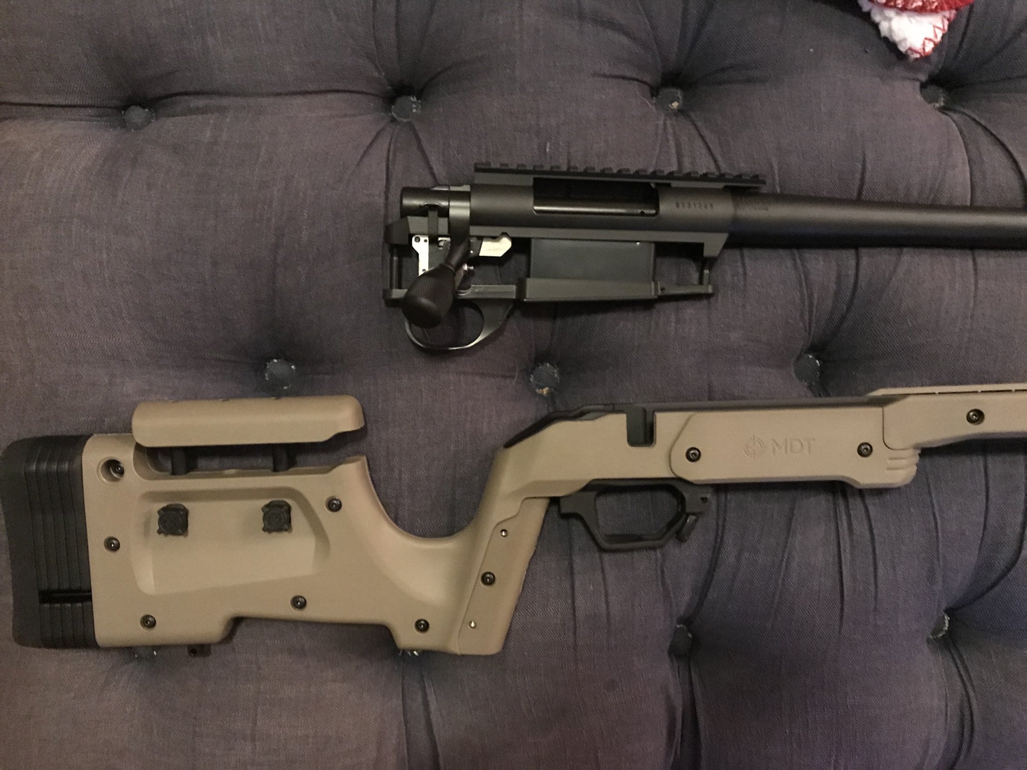

Only spent a half hour unboxing and doing a quick fit test with my Howa BA and the cheek piece, LOP and grip -- I'm slammed with work tonight and all day tomorrow but will spend a little more time with it tomorrow night and Thursday. Will get it set up properly this weekend and then heading off to shoot it next week on vacation.
Initial thoughts:
1) color is great and rubber surfaces are nicely tactile.
2) it's a noticably heftier/more solid feel than the KRG Bravo, especially the polymer.
3) the barrel channel is a cavern: you could fit a cannon in that thing and it would free float.

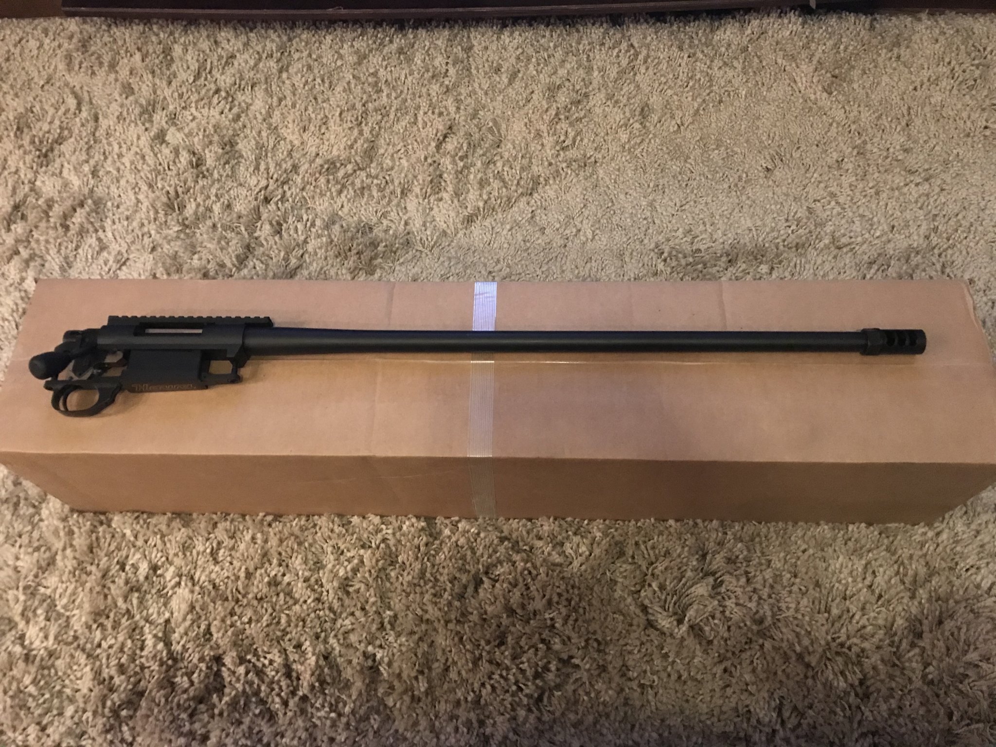

4) a 26" barrel with a Little Bastard on the end is quite barrel-heavy; I'd be interested in some heavy/steel LOP spacers for balance.
5) after spending over a year putting this rifle together I can't wait to shoot it!

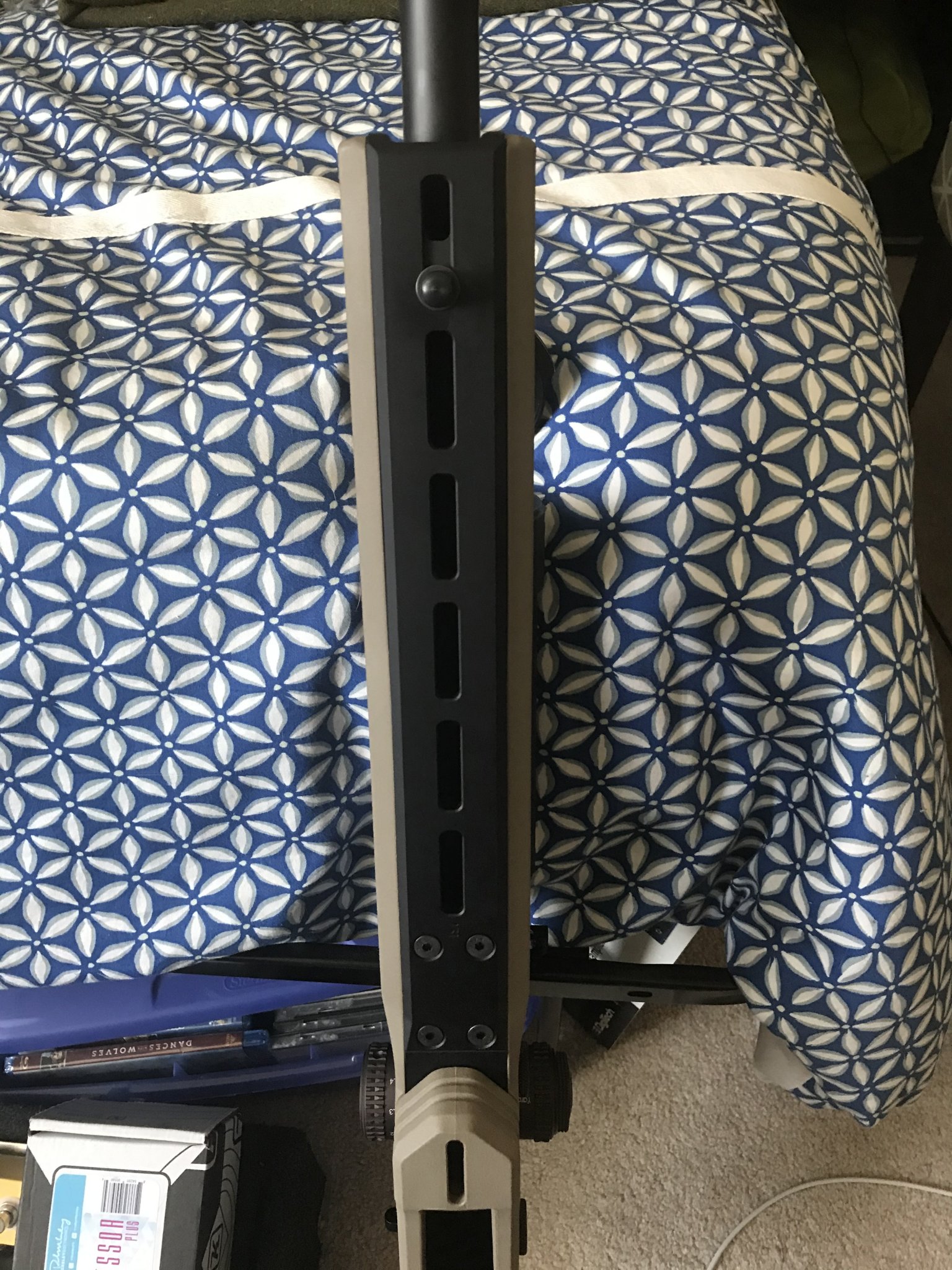

How many mlok slots on the bottom of the stock? Wondering is a area 419 12” arca rail will fit.
Five full ones and a half one at the end (the sling stud mount takes up about half of it but it’s integral so you can’t non-permanently remove it — you can see how it’s partially filled-in in the pic).
Front edge of the receiver is exactly 12.5” from the end of the chassis and the back edge of the first mlok opening is 2.5” from the front of the barricade stop.
That’s on the Howa version btw.
That black part is just anodized aluminum, no polymer panels. Outside edge to outside edge of the mlok slots (including the halfie at the forend) is just a hair under 9.25”
I’m debating an arca rail myself but that’ll be a later thing anyway. Can’t wait to get this all set up tomorrow and shoot it next week!

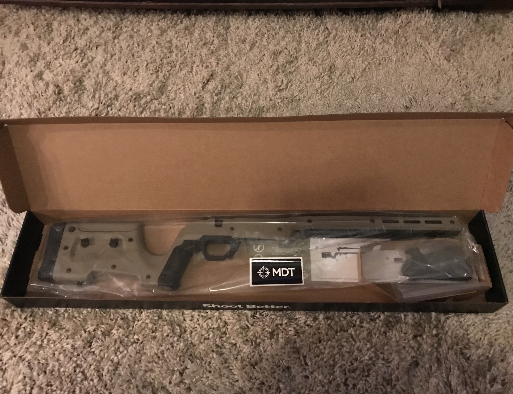

My XRS in FDE arrived this week for my Tikka T3 CTR.
Super happy with the product, this is the first time I have upgraded from a factory stock on a bolt action
Only issue I had is that I couldn't get my Toque wrench in to tighten the action screws. So I don't know if I got it to the correct torque specification. Just tightened it as much as I could.
Loving the FDE color and the vertical grip that's included

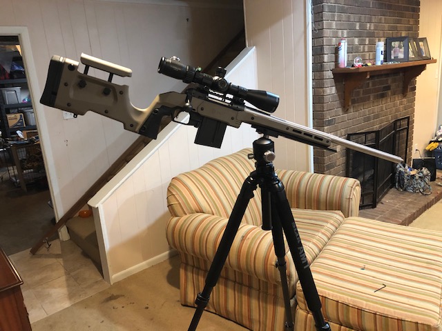

I got mine back from the smith and really like how it turned out. 26" Hardy carbon in 7SAUM on a R700 SA. Load dev is done and dope verified. I think I might have to shop around for a replacement scope over the winter though, prob either a Mk5 3.6-18 or NX8 2.5-20. The 4.5-18 LRTS is kind of the weak link when I go to ELR distances (1500, 1600). I didn't want to put a bigger, heavier scope on like my match rifles and dedicated ELR rig but the LRTS doesn't have enough elevation to dial out past 1450 or so. Not a big deal for most of the use this rifle will see (hunting/long range hunting) but a bit annoying.

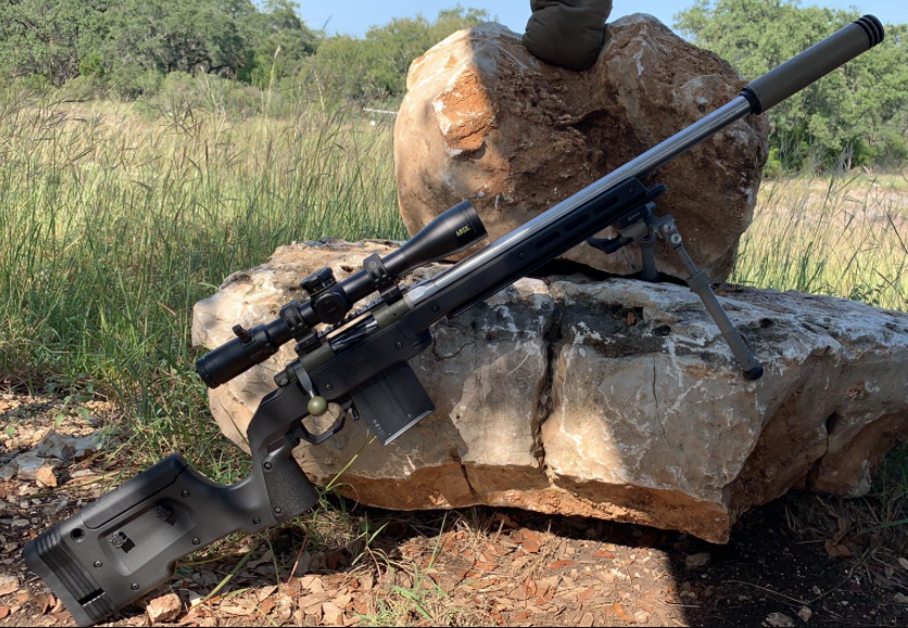

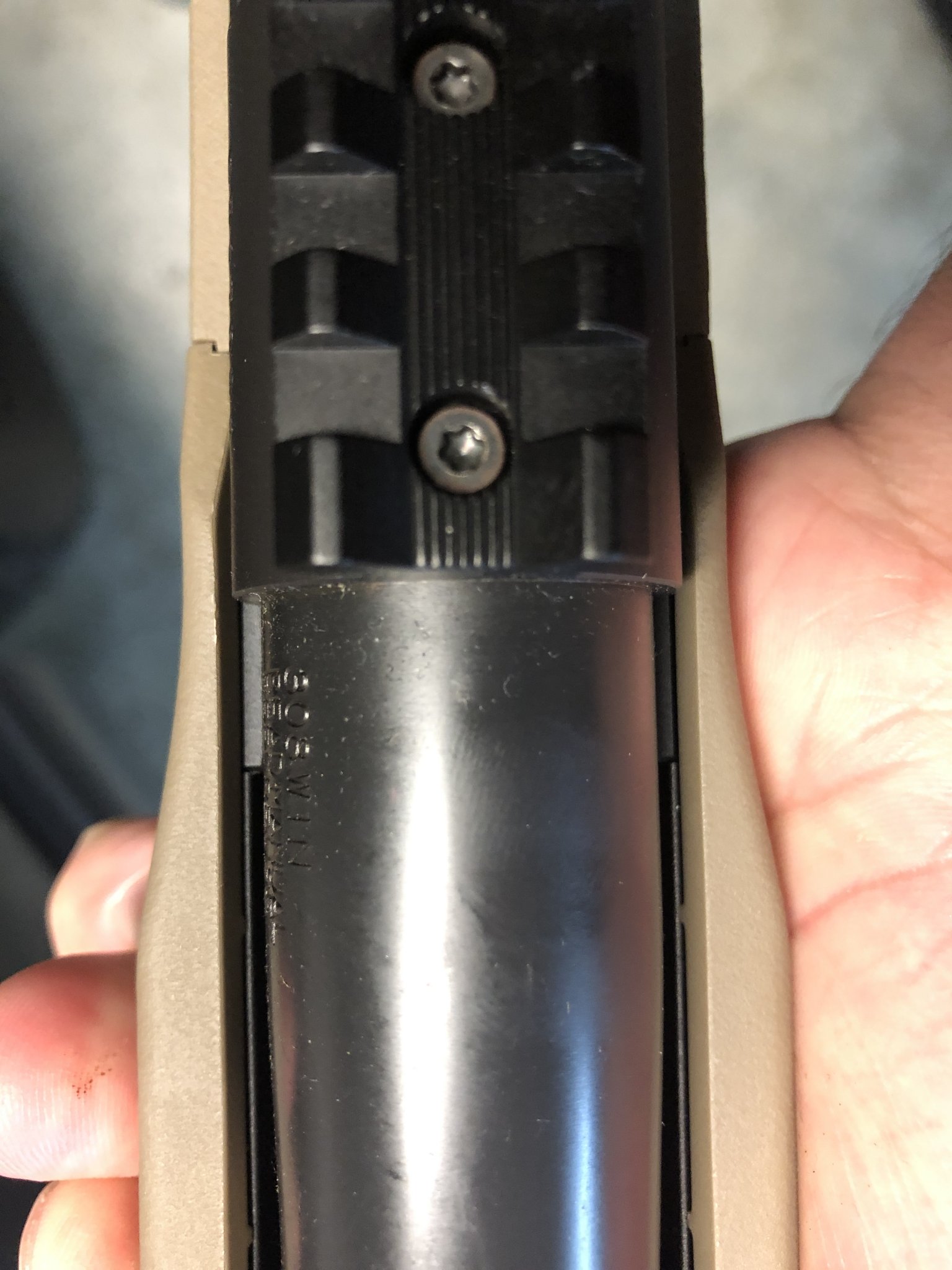

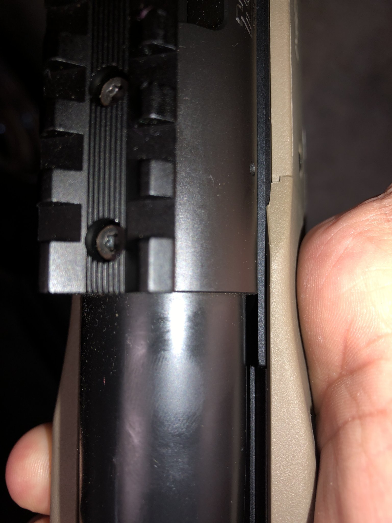

I saw people talking about the barrel channel, this gives you an idea of the contours this barrel channel can accommodate. So far I am loving this stock, but I have not taken it to the range yet, hope to Saturday. I will say this thing does not flex, period, rock solid. A couple things I would love to see would be screw holes for an optional thumb rest on the side of the stock instead of having to rest your thumb on the top, and also as I mentioned an optional bag rider. But I am highly impressed as to the amount of quality you get for your buck with this chassis/stock. Awesome job MDT!
Reactions: MDT_Josh
Thank you for the feedback, the XRS is new for us so we will see what other items become available for it!
