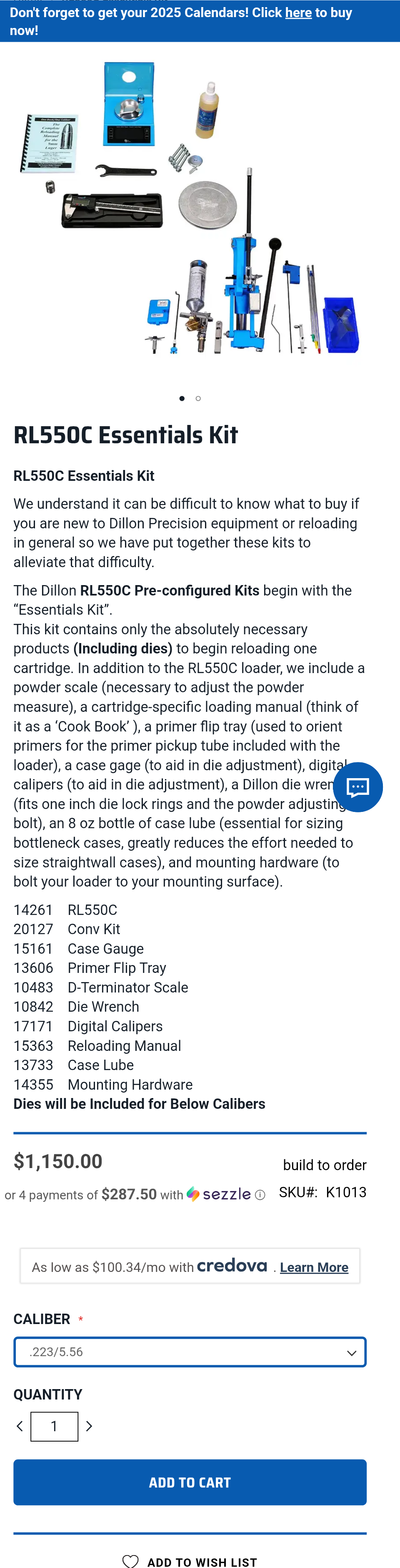

Took a look at the Dillion 550C kit they offer. First thing I noticed they don't have a 6.5 kit - the only thing that comes close is a 308.
Say I purchase this with the 223/556 kit - would I just need a set of 6.5 reloading dies? What kind of value am I looking at here? I mean like kit price vs piecing it together myself?

Correct, you would use the 308 sized conversion kit for the 550 as the case is the same at the base. Kit is 20130 if Im seeing it right. Also 20127 is the kit for 223. 20128 is for 9mm. Be sure to verify. Its always helpful when you can 1 for 1 the instructions from your mentor. The 550 can be used as a glorified single stage as well as it is manually operated. The real upside on the 550 is the ability to load semi-progressively if you need to load up some blaster ammo for an AR or a pistol. I would not use the powder measure on the 550 for extruded powders, and just replace it is with a down and dirty simple powder thru funnel like the Hornady Powder Funnel Die that you just run the press up and drop the powder directly into the case.
