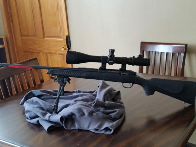

GTRMechanic, can you post a pic of your rig for me? Also, do you have a final price for everything? Just curious as to why you didn't go the 6.5 Creedmore route? Thanks for the info you did for your build Pretty much what I'm looking to do.

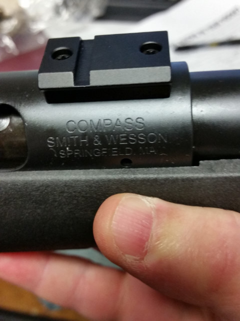

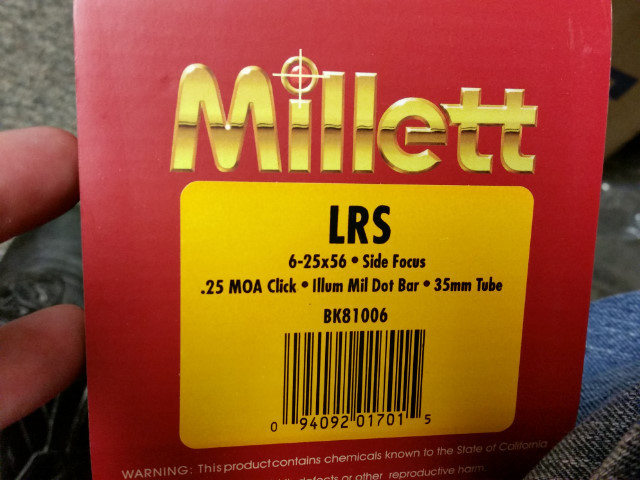

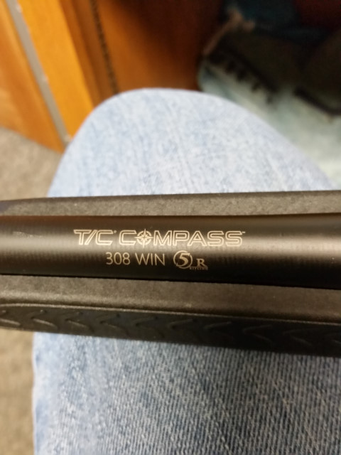

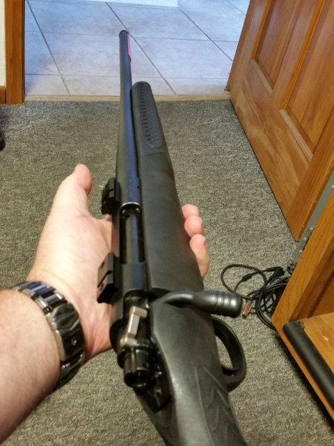

I decided to go with the .308 because a good friend of mine ( who is active LEO / sniper ) is using .308 . We can trade reloading supplies back and forth if needed. He also has been cooking up a couple of different loads over the past 2 years, so why re-invent the wheel..? He comes to me for .223 recipes.
There have been a lot of good suggestions for optics in the various replies. If you can spend the cash, go with the Vortex ( GREAT warranty ). I was purely trying to stay within a VERY tight self imposed budget. I saw numerous optics out there that would have fit the need, and the feature set I wanted, but they exceeded what I was willing to put out for this particular rig.

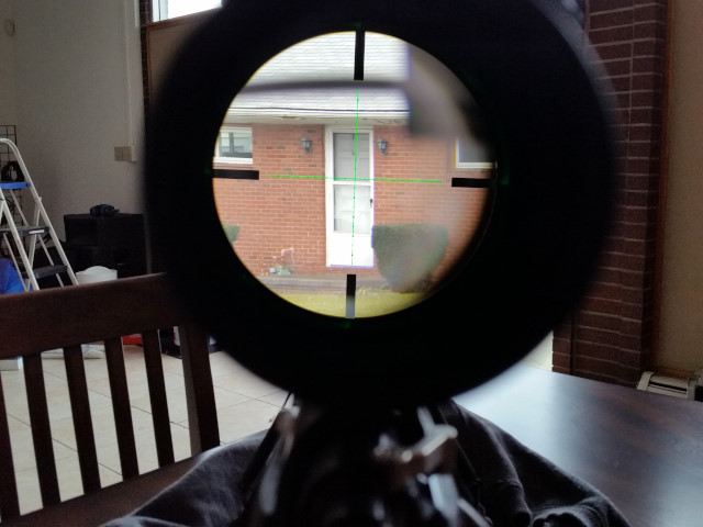

The only pics I have are when I unboxed the rifle, and one shot of it mocked up with the factory supplied 'high' scope rings that are like stilts...LOL!
Project Cost:
TC/ Compass .308 = $274.95 ( less $75 mail-in rebate) --- Net cost= $199.95
Millett 6-25x56 LRS optic = $478.97 including shipping from Optics Planet
One piece 20MOA picatinny style base = $39 + shpg from EGW
I still have not ordered the rings. Christmas snuck up on me. Its either going to be TPS rings or Vortex prices run between $129 and $149 / set.
Once everything is here, I should still be under $880!
** Before everyone FREAKS out about the view through the glass, the gun was completely empty and the removable magazine was out... **
The blur at the top of the view is a reflection from the door handle on the front door of my shop. The doorway in the sight picture is about 200 yards away.

gtrmechanic, thanks for all that info. I appreciate it. I like what you have going on. Couple more quick questions, How does that TC shoot? Do you like it? Does it seem cheaply made with the stock? Also, the scope, does that mean it goes from 6 times magnified to 25 times magnified? Thanks
The Ruger Predator is not a bad choice, the Thompson is a great idea too! Just to make things super clear, you can NOT use a stock 5.56/.223 barrel for .224 Valkyrie. You need a new barrel, bolt, and magazine i think.
As for scopes i always recomend the Primary Arms 4-14 FFP Mildot or RGrid scope. Ive have good luck with them on budget builds. If its going to see rougher use, or if you need it to track more reliably, id get the SWFA Super Sniper scope for like $275-$300 bucks. 10x or 12x will work great for you! But you give up adjustable magnification for dependability, which depending on your preference may be a good/bad thing.
I think your caliber choices are great, 6.5 is solid, and if you hop on the .224 Valkyrie train, im sure that would be a fun ride too (im planning on a .224 build soon).

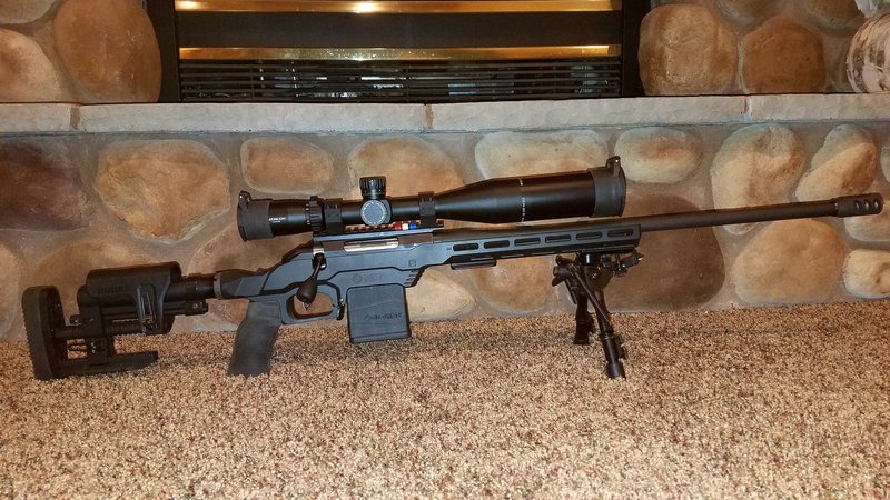

Just seeing this post now but here is my budget setup. Ruger American Predator 6.5, Ruger RPR stock and bolt handle, MDT LSS Gen2 Chassis and Ergo grip. Optic is Athlon Ares. Shot .76 MOA @ 100 yards with factory Hornady 120 AMAX.

Thanks! Between the weather and work, I haven't had the chance to shoot it yet. The stock is not the highest quality, but remember the gun was only $200. All things being equal, its decent enough. Yes, the scope is variable from 6x to 25x magnification.

So, just curious, why go with a 6 to 25 magnification scope? What is the reasoning? I haven't seen one with that much variation in it, but then again, I haven't looked that hard. Does it take away from the quality of the magnification compared to say a 4x12? Just curious why such a huge gap.
Obviously the field of view is going to be smaller at 25x than it would be at 12x, but if the scope is built well you won't really notice any decrease in quality of the sight picture. I went with the 25x for 2 reasons. #1 I'm 54 years old now, and my eyes just aren't what they used to be. #2 If the gun shoots well, I may want to stretch out the distances that I'll be shooting.....again refer back to #1...LOL!!
I always try to think ahead so I only have to buy stuff one time (buy once, cry once). I'd rather buy something that is just a bit of overkill and not need it. It really sucks when you do need it and you don't have it.
