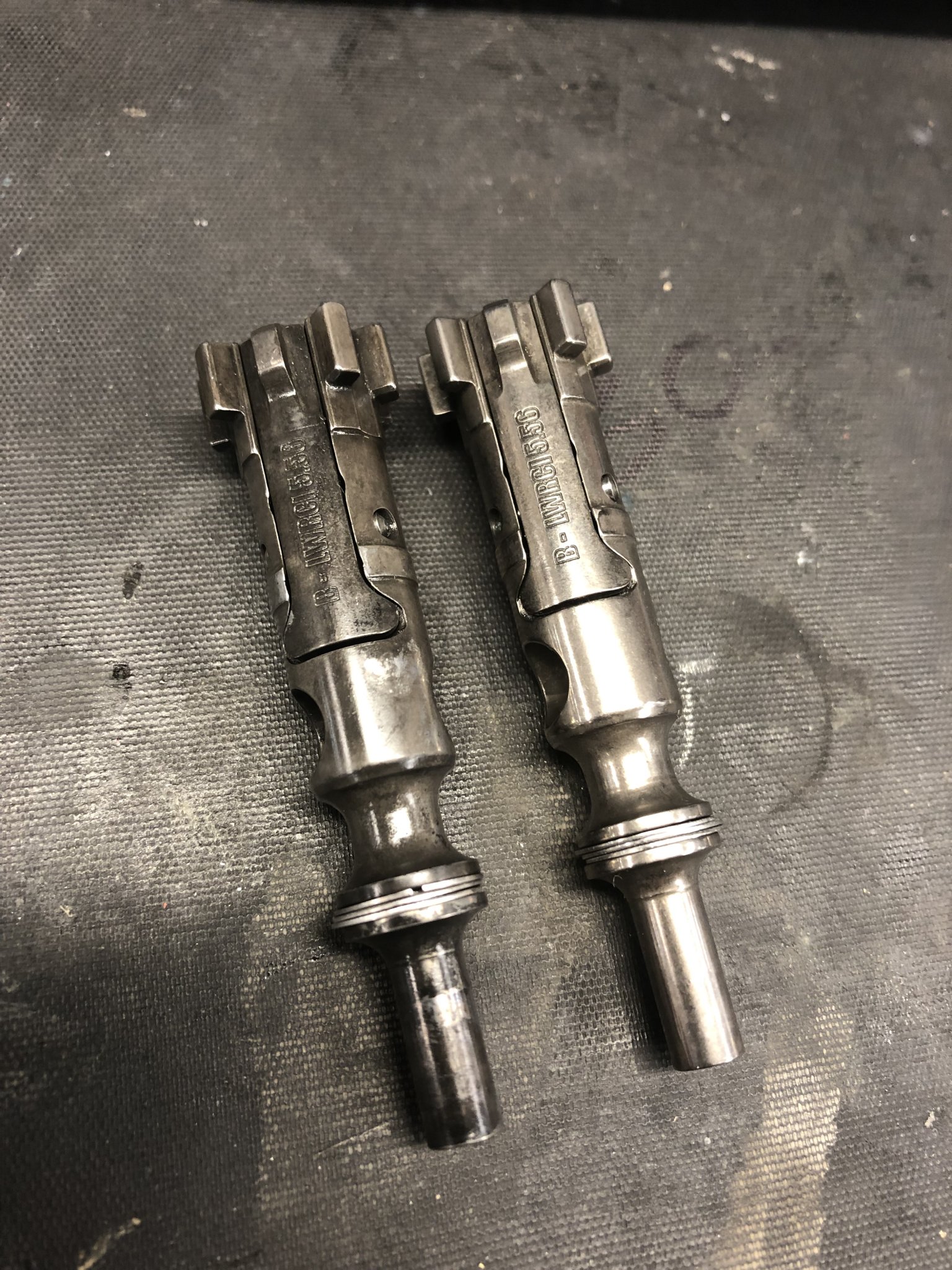

I actually found the ultrasonic cleaner destroys NiB. It did that very same thing to 2x Spikes Tactical NiB bcgs that I ultrasonic cleaned.
Foe the record, I prefer QPQ, melonite or DLC bcgs

Clean/used NiB on the left
Clean/new NiB on the right
Left one has seen extensive time in an ultrasonic tank.
