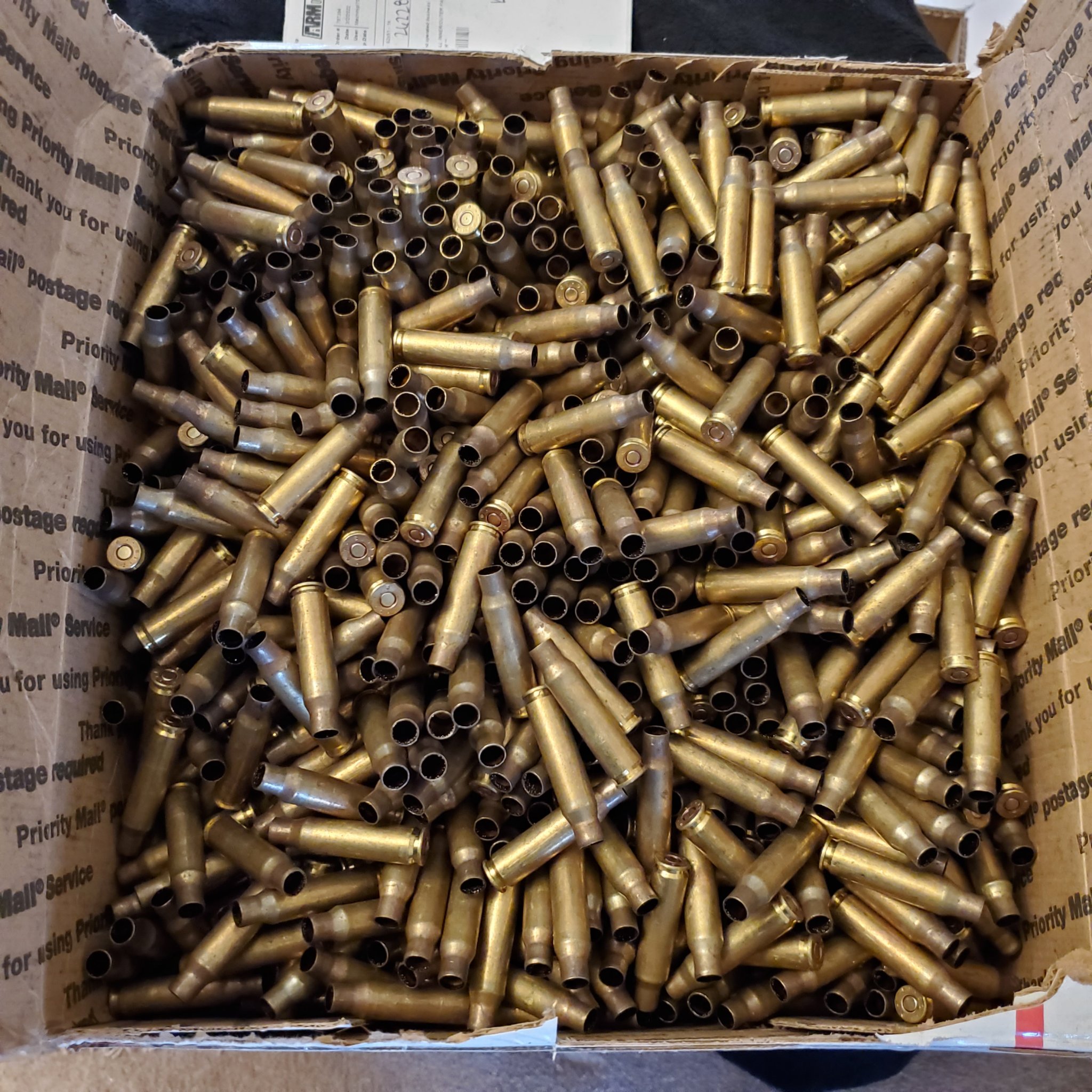

No need to anneal or do any other case prep....especially for 500 yds and closer...and these can be loaded on a Dillon progressive with a case activated Hornady drum powder measure....and hit clay birds at 600 yds with ease, with most any bullet 125 gr TNT and heavier...even use primed LC brass and Win 748 for this plinking endevor, along with the cheap 125 TNT bullets...
Pictured is a box of 1000 primed LC brass already fired through various 308s. It shot .3" and .4" 5 shot groups back to back in AR 10 18" proof with W748 and 130 gr Speer Varmint bullets.

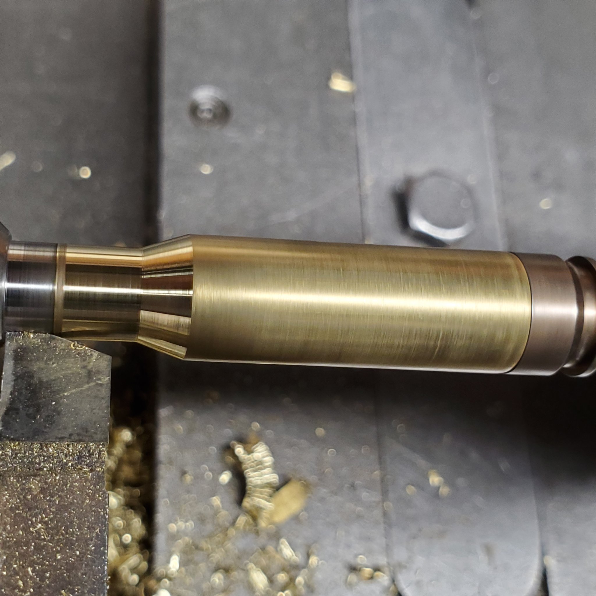

But sometimes I neck turn and shoulder bump with a ground carbide tool in the lathe for specific cases like this 6.8X51 hybrid case necked up to 308, this procedure, along with a mandrel gets rid of donuts in the neck.
I just got done doing this... for two specific 308s with 8 and 9 twist barrels, for mostly 200 to 230 gr bullets, not needed for your average 308. These are for high pressure loads with minimum chanbers, made with the same reamer on my lathe.
