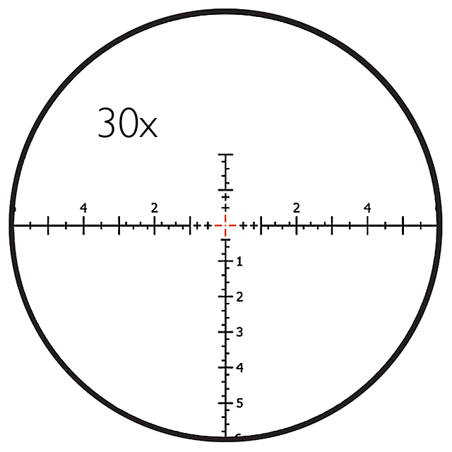

Thanks for the feedback guys, I think I’ll stick with my choice of a non tree reticle. I would like to start training more with dialing elevation and holding wind. The reticle I’m looking at has 0.2 mil hashes on the main cross so I think it will work out well.
And, as much as it’s interesting what the pros use, I’m not too concerned as I might shoot one to three matches per year and mostly for fun and to try to improve my shooting.

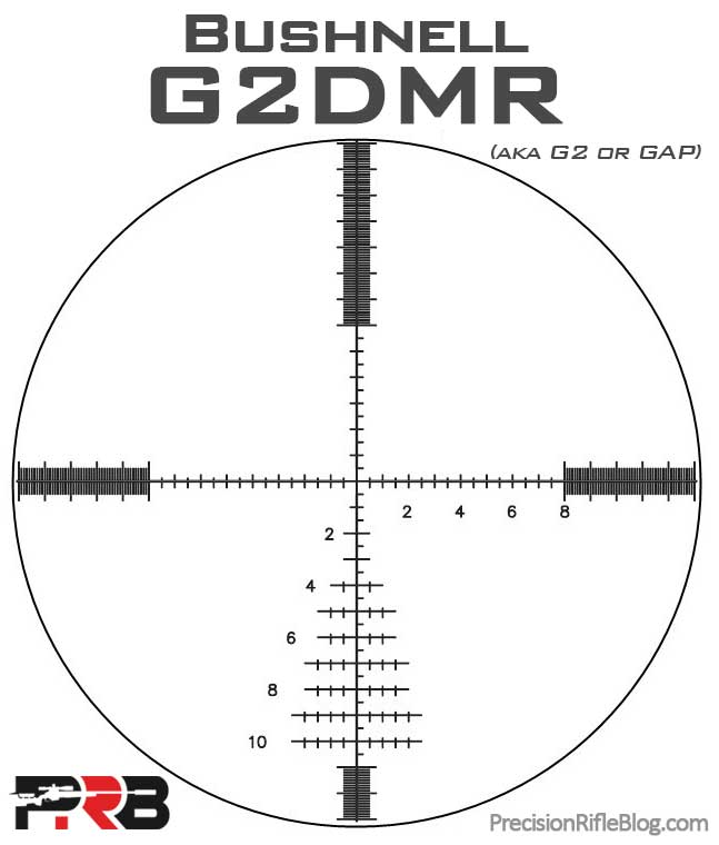

The Bushnell G2DMR reticle is very close to perfect.
