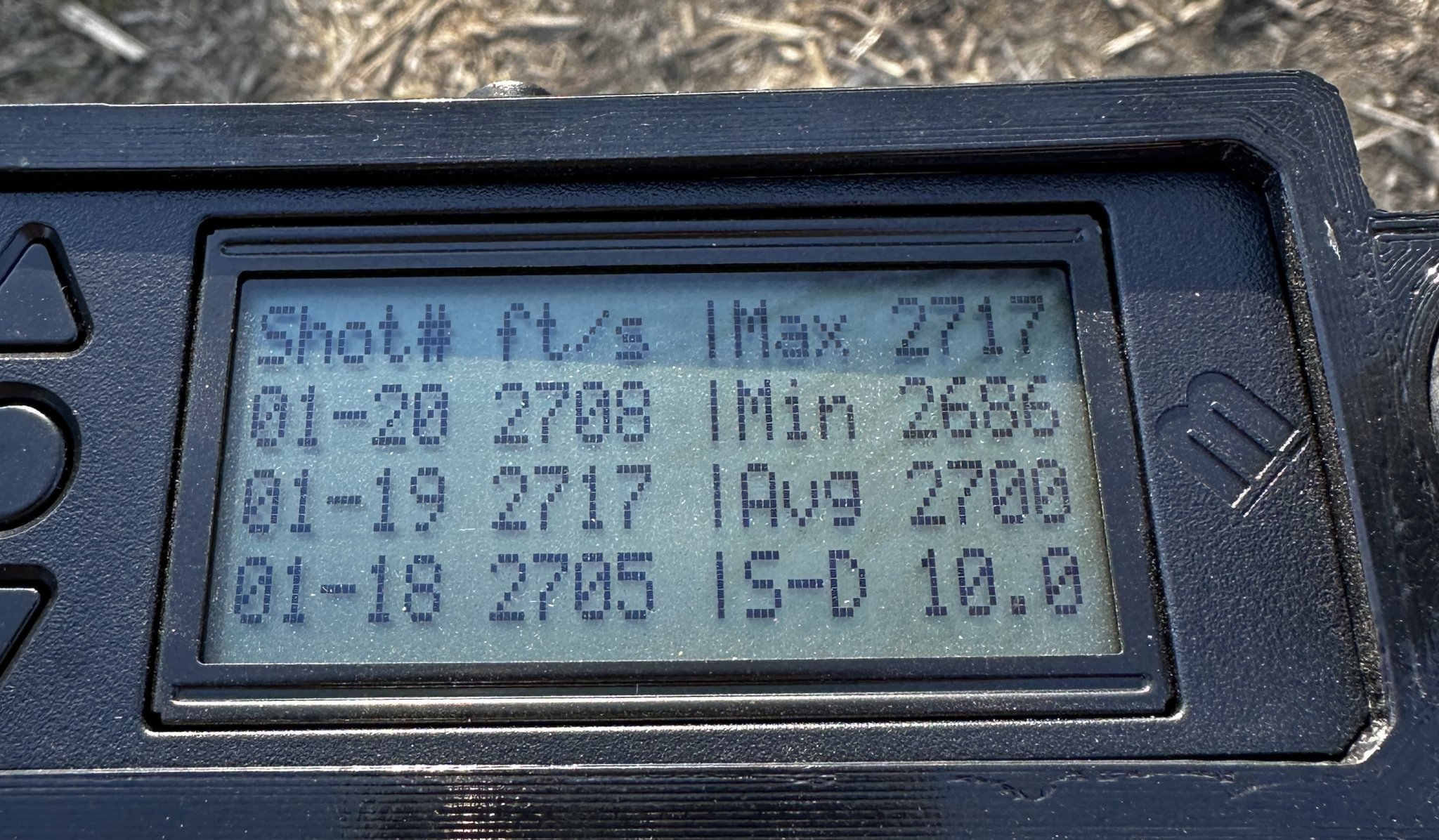

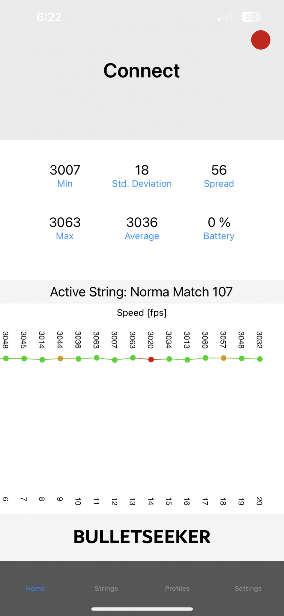

What kind of ES/SDs and how many over the chronograph?

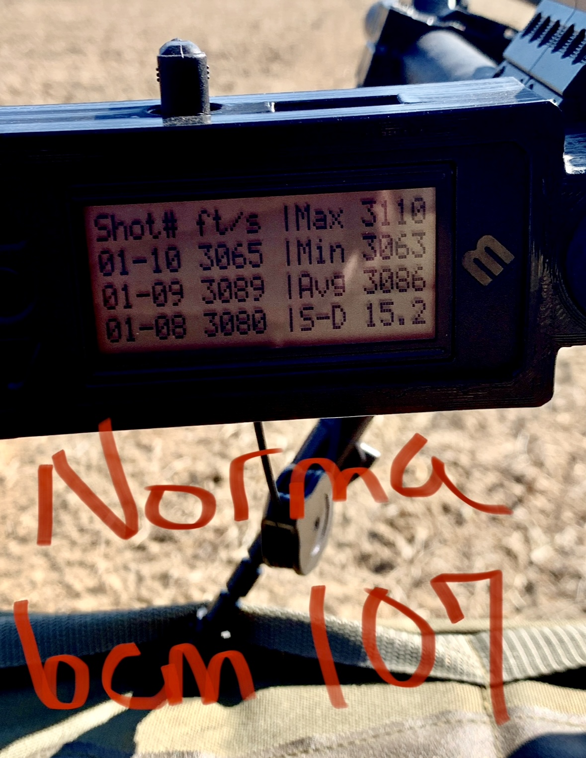

I don’t know my lot number at the moment but I think a call to Norma is order for me. I shot five rounds and they are hot, hot, hot! First round showed 3198 on the LabRadar and the next three were in the 3130 range. The last shot didn’t register, but the primer fell out when I ejected the round. The group was probably 2”. 5 rounds of Berger 105 ammo gave me a 2995 five round average and that is normal in this barrel.
Had anyone else had such speed with their Norma 6 Creedmoor ammunition?

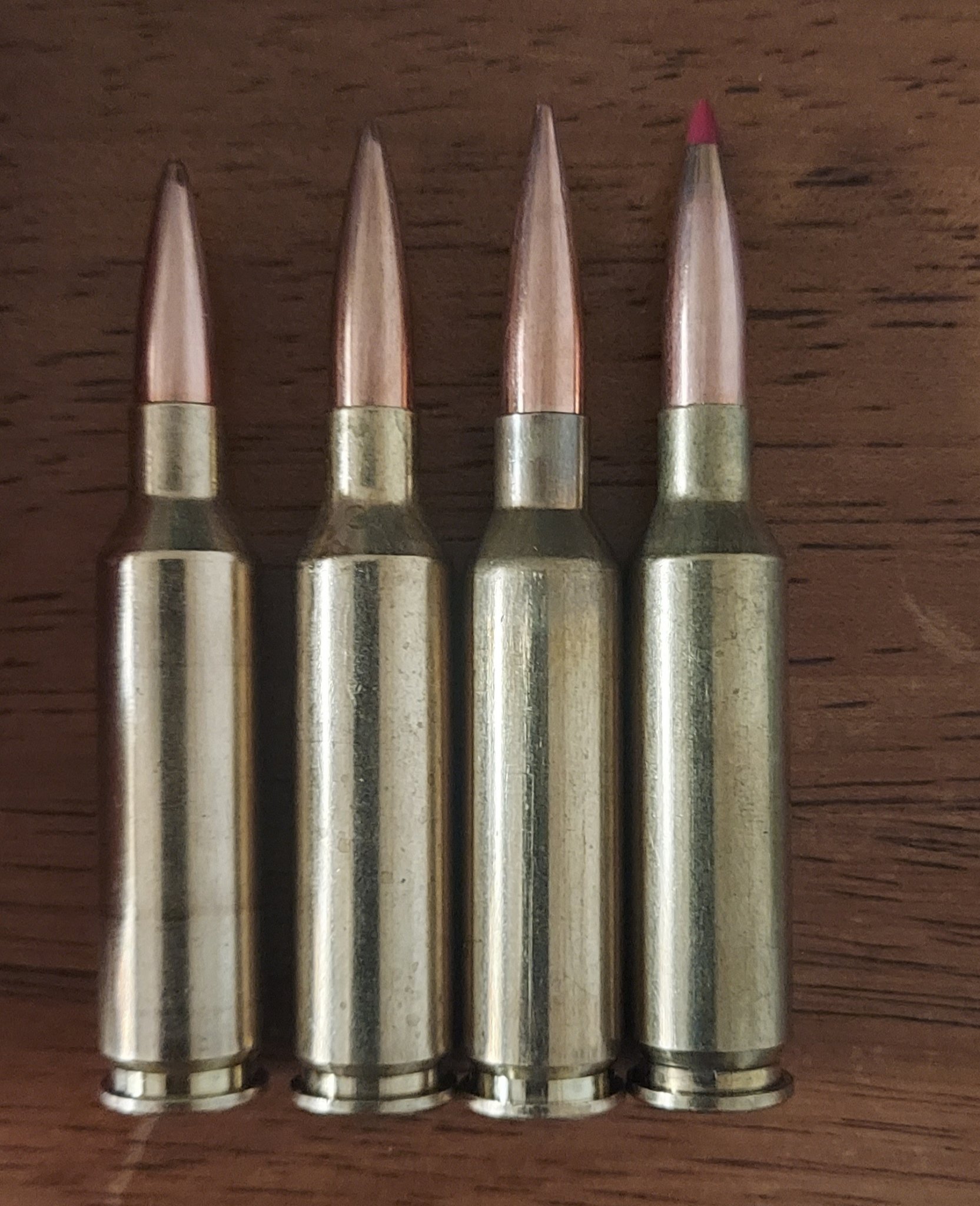

I found my high pressure cause in the Norma Precision Match ammunition I have. First, let me say this was no fault of Norma’s. Secondly, I’m disappointed in myself for not figuring this out earlier.
So what is the problem? There really isn’t a problem per se, it’s a compatibility issue. My barrel is a Shilen chambered with their spec reamer which uses a .275” neck. My Norma ammunition measures .2745” to .2750”. There is no room for the bullet to release properly. The grip on the bullet is such that it’s causing high pressure to build before the bullet is finally forced out of the case and down the barrel.
I was talking with my buddy tonight about the high pressures I was having and it made me think about what I would check if this was ammunition I was hand loading. Then it dawned on my that this is acting like rounds that have too little neck clearance. That made me think about a post Northland Shooters Supply made about the Shilen reamers and how the neck was smalller than SAAMI spec. SAAMI is .277” and Shilen uses .275”. I went home and measure my loaded factory rounds and there it was. My barrels not compatible with this ammo. My fired case necks were smaller than loaded rounds.
Not all is lost though. I have a bunch of Hornady Black ammo and it measures .271” loaded so I can use that and reload those cases in this barrel. Buy time it’s loaded it a few times it will be time for another barrel anyway.
I have another 6 Creedmoor with SAAMI spec chamber so I should be able to shoot up the Norma ammo in it.
Moral of the story, make sure everything is compatible before you go too far off the beaten path.

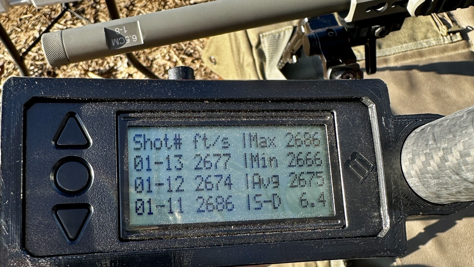

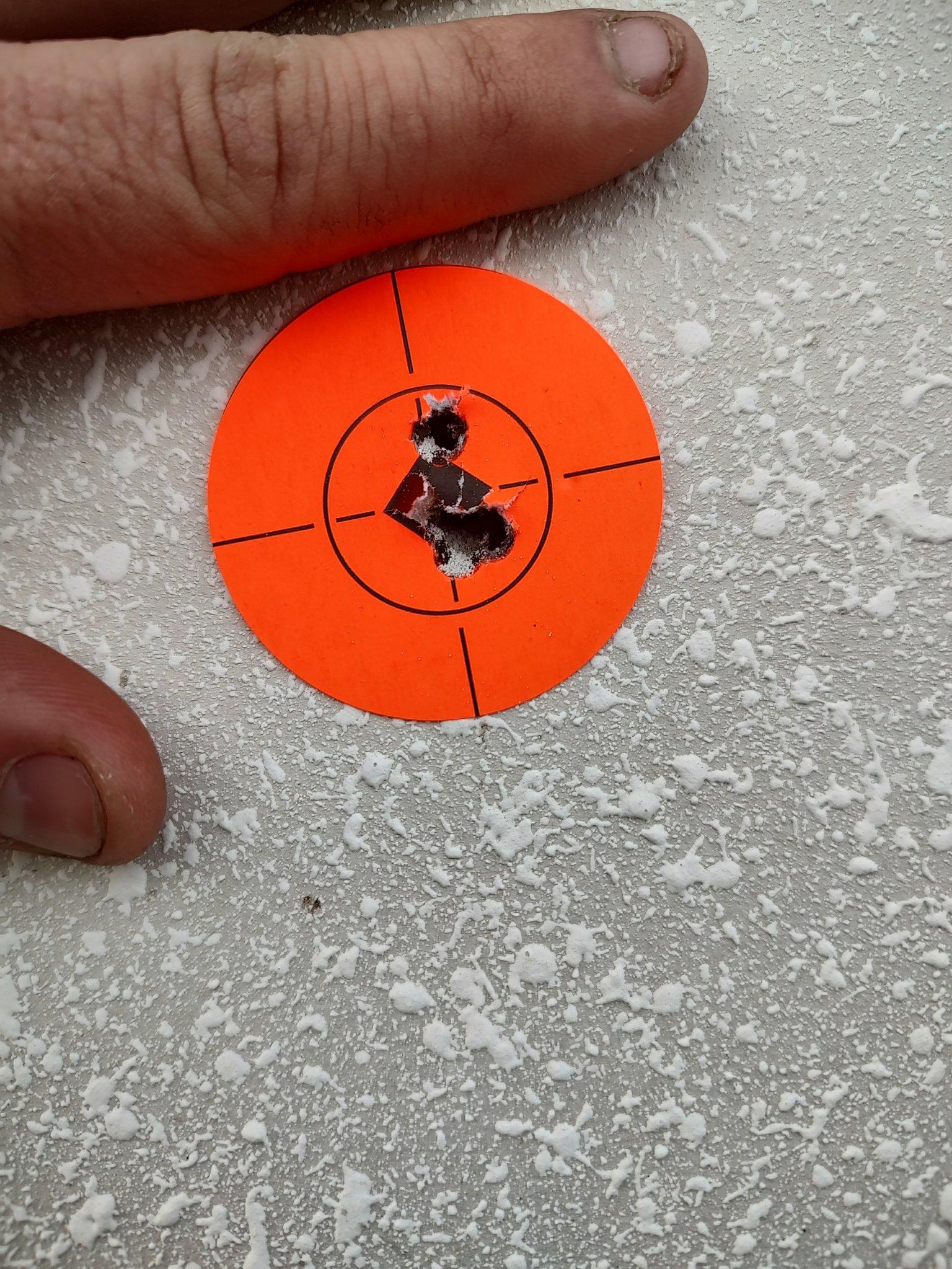

6cm Norma 107
5 shots @ 556y

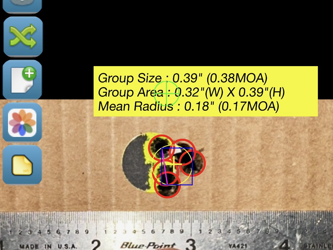

It shoots really good. I had a 1 hole group at a 100yds. SD of 9 and ES of 22..... 6 creed Curtis action and barrel. 1:7 26" 3025 average velocity

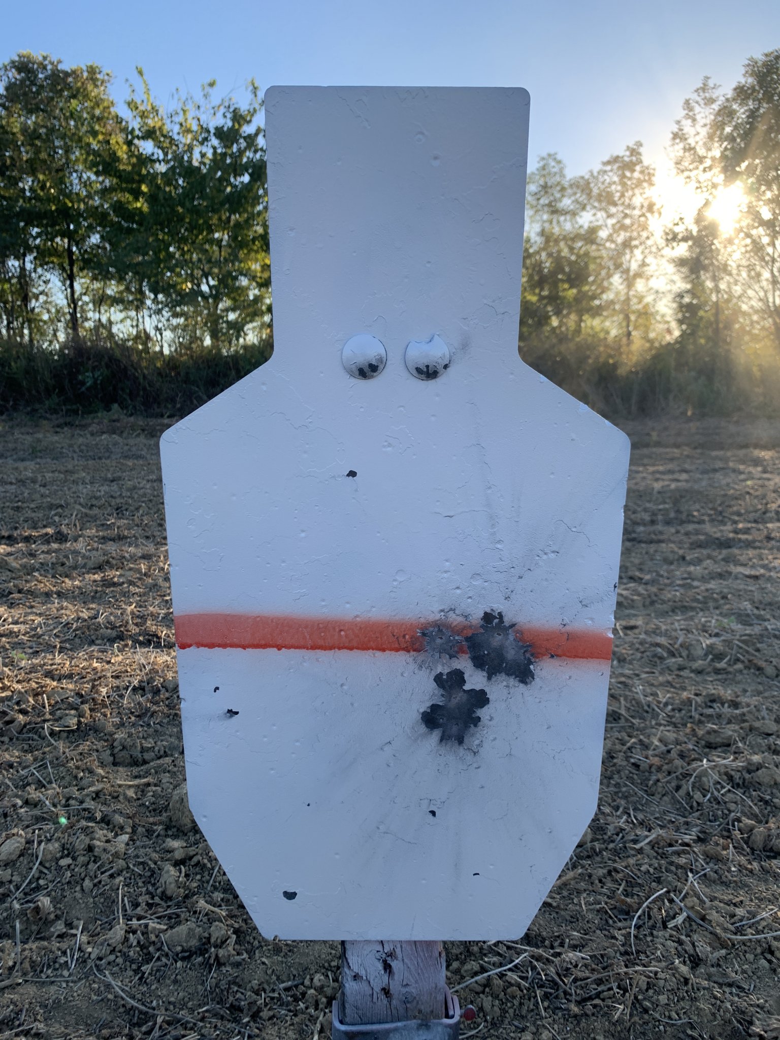

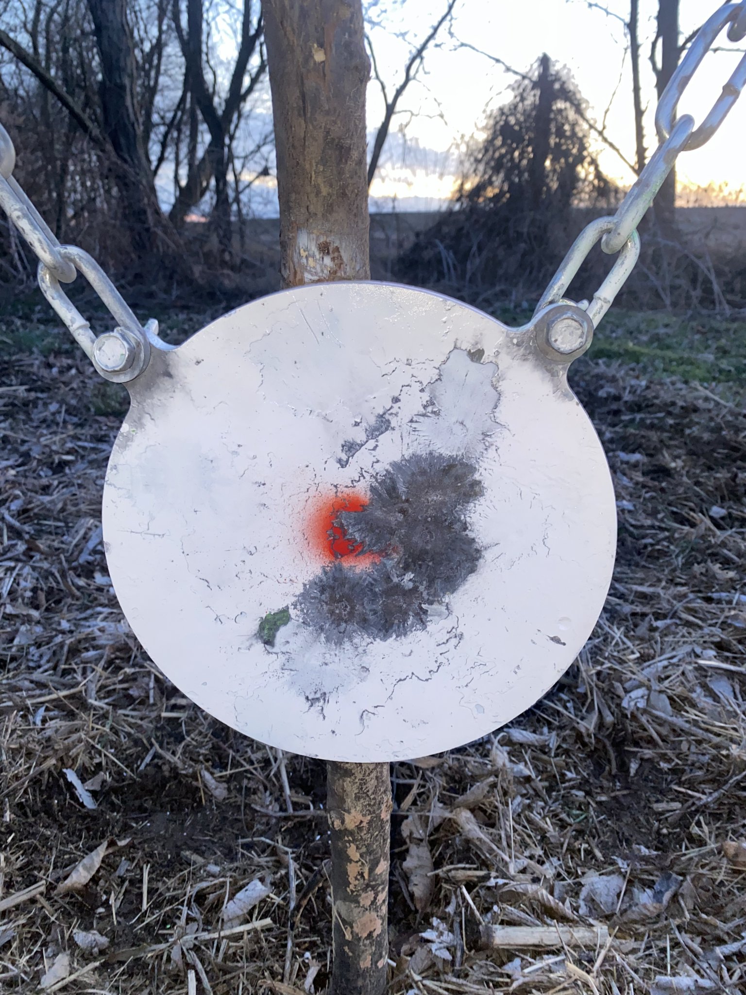

My experience has been with this in 6.5 prc flavor, and it shot very well in my bone stock browning xbolt. I didn't chrono it since it was a brand new gun and had no use for it other than sighting in and getting used to the gun. Great ammo though, and won't hesitate to get more of it.
as good as everything you see in the thread. bugholes @100. consistent hits all the way to a mile+.
312 G7 @ 2680 fps, little slow but incredibly cheap for how good it performs... like less than rolling my own, cost wise.

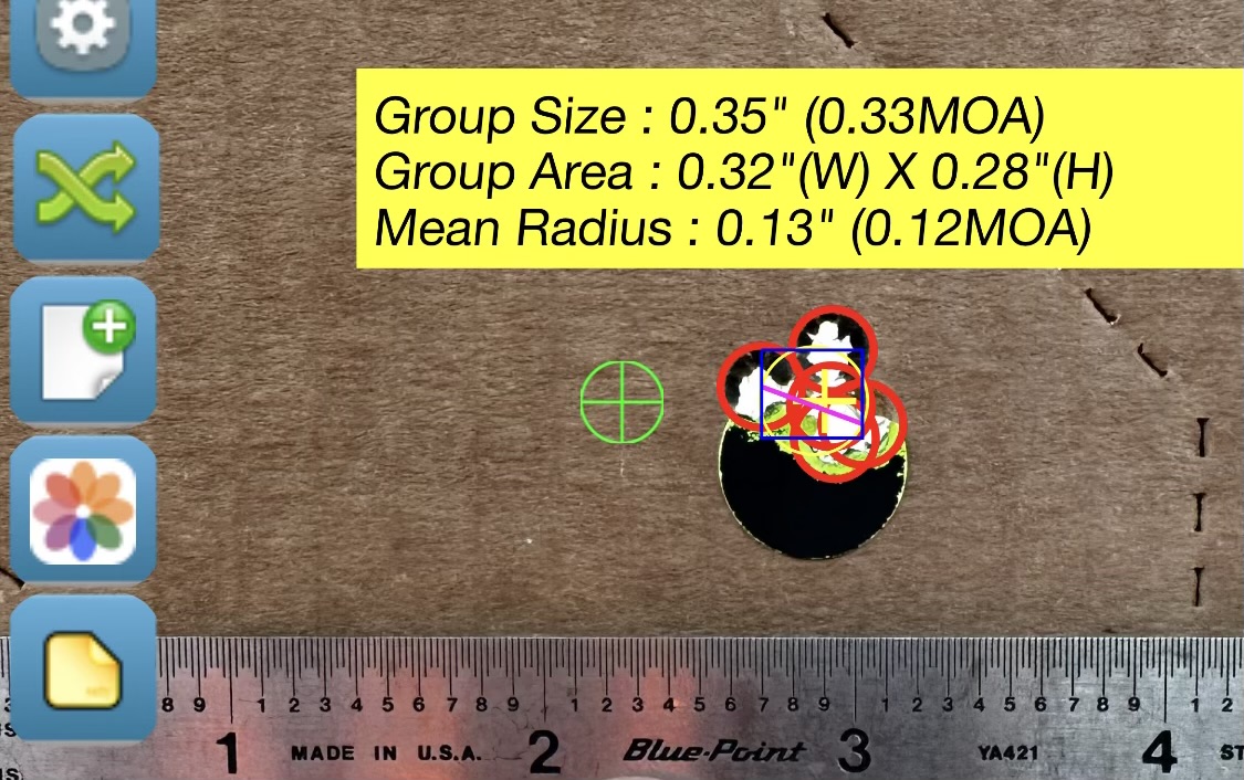

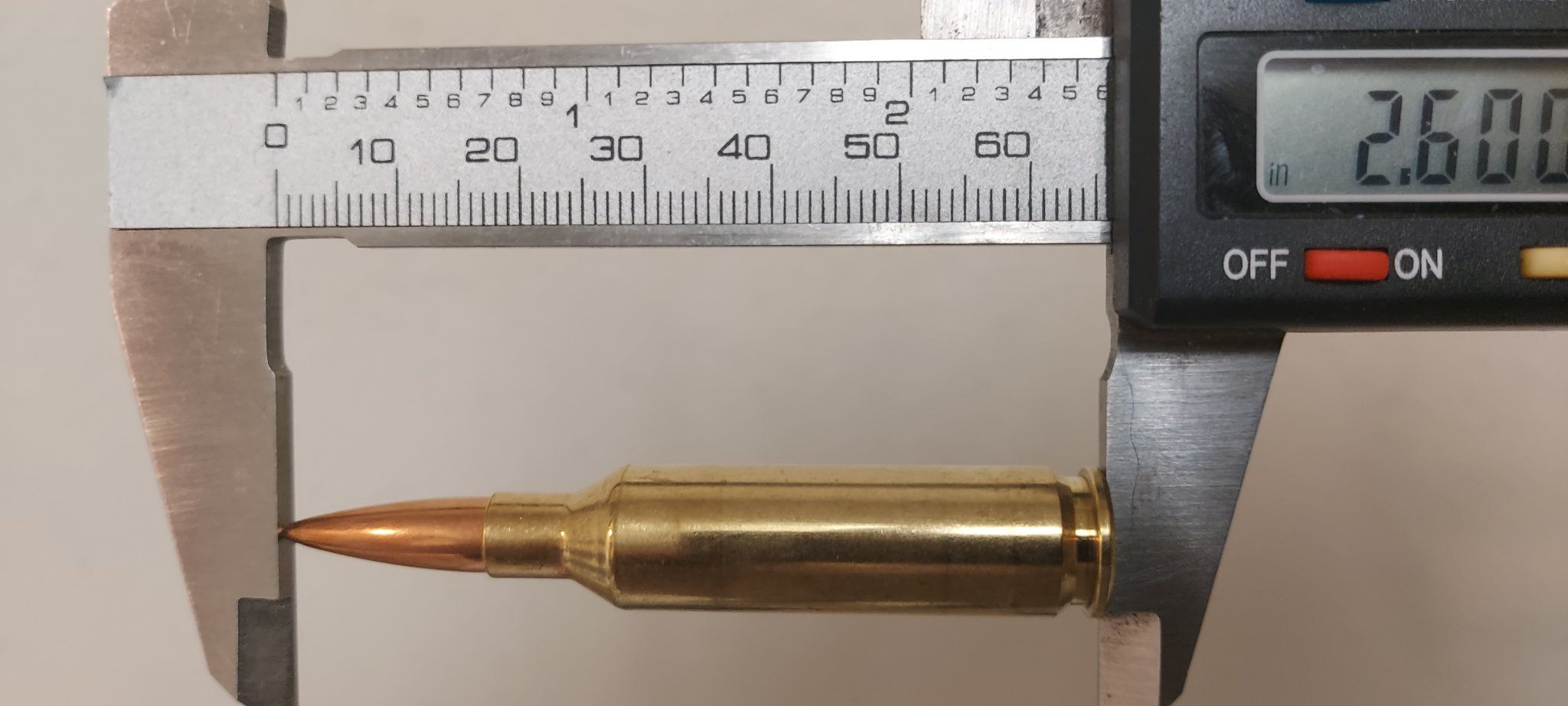

Hi, all. I'm not finding much info on the Norma 6CM Golden Target. I bought some to try and COAL is only 2.600". Seems ridiculously short, bullet is obviously seated very, very deep. In the pic: Norma on the left next to Sierra Competition 107gr 2.730", Berger 105gr Hybrid 2.789" and Hornady Match 108gr 2.794" (all factory loads). Is this typical for this ammo or do i have a grossly defective lot? No response from Norma yet. Like others have said, 0.275" neck. Thanks.
Yeah, that seems out of whack! I just measured one of my factory 107 golden target rounds @ 2.742" COAL. Dont know WTF Norma's deal is on this 6 creed ammo. Between the very thick necks and your COAL issue, i'm surprised they sell stuff like this.
Reactions: 338dude
Thanks for the measurements, wind gypsy! I'll call Norma.
Reactions: 338dude
I think that’s it. I’ll check mine when I get home next week.
FWIW, my seating depths weren’t near as deep as yours but they had about .060 spread in a 20rnd box. 5 round groups were 1moa at best. I sorted them in 5 round lots according to seating depth +/-.004” (about 6-7 lots) and shot them. All lots shot substantially better after being sorted, with the lot that was CBTO .100” off the lands shooting about .4moa. Fortunately for me I was able to re-seat about 95% of the factory ammo and it has consistently held .5moa or better.
A bit of a pain for factory ammo, but a quick fix once I figured it out.
