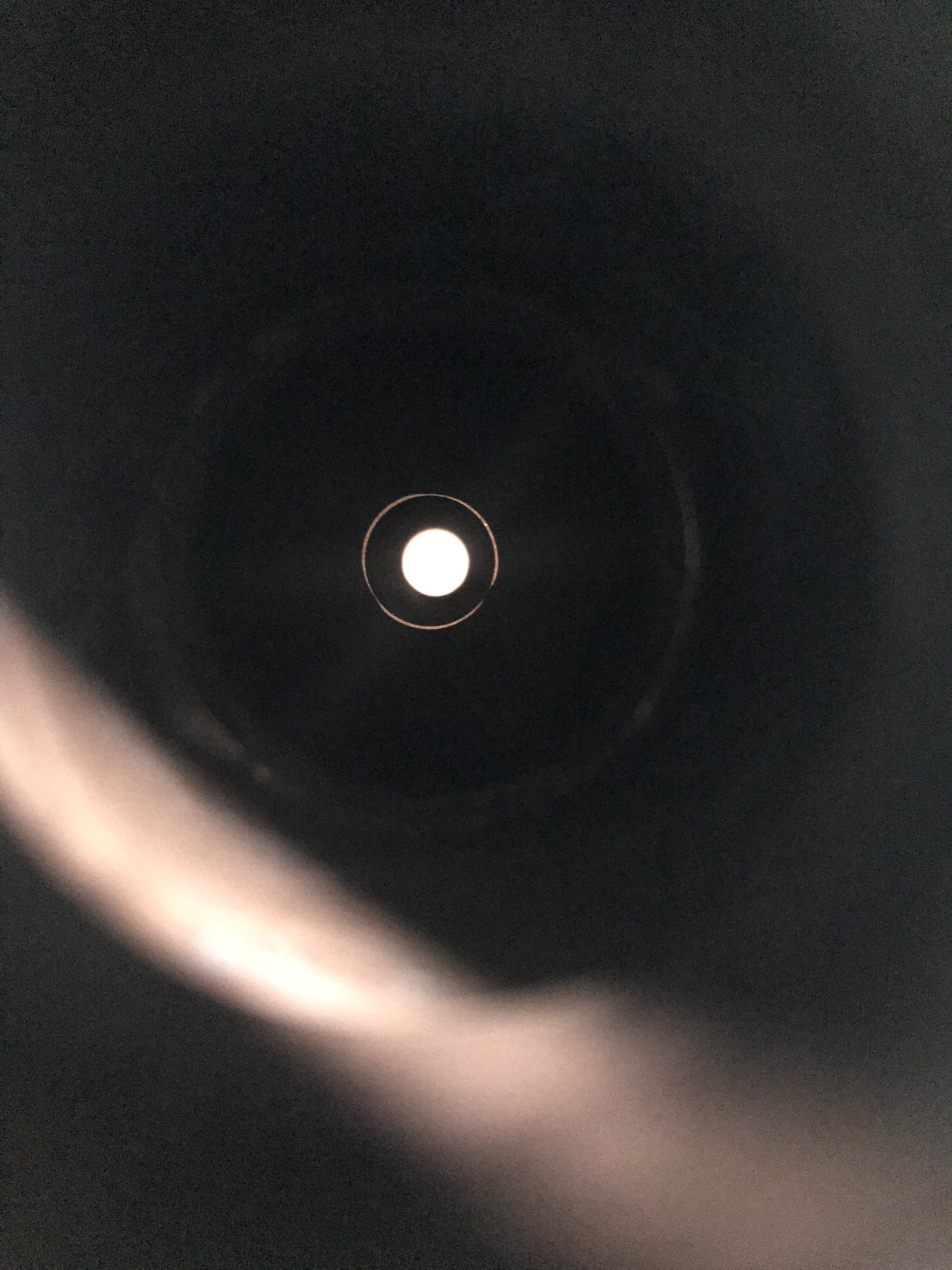

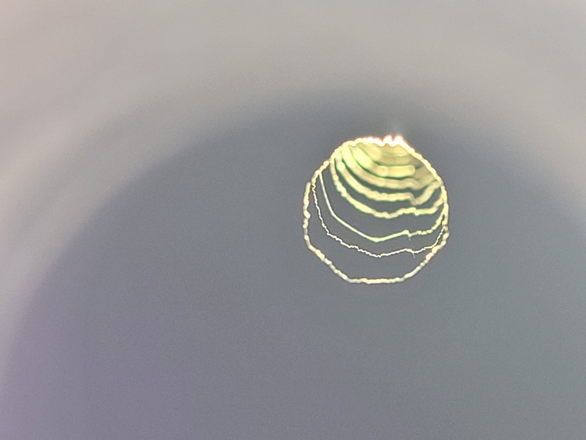

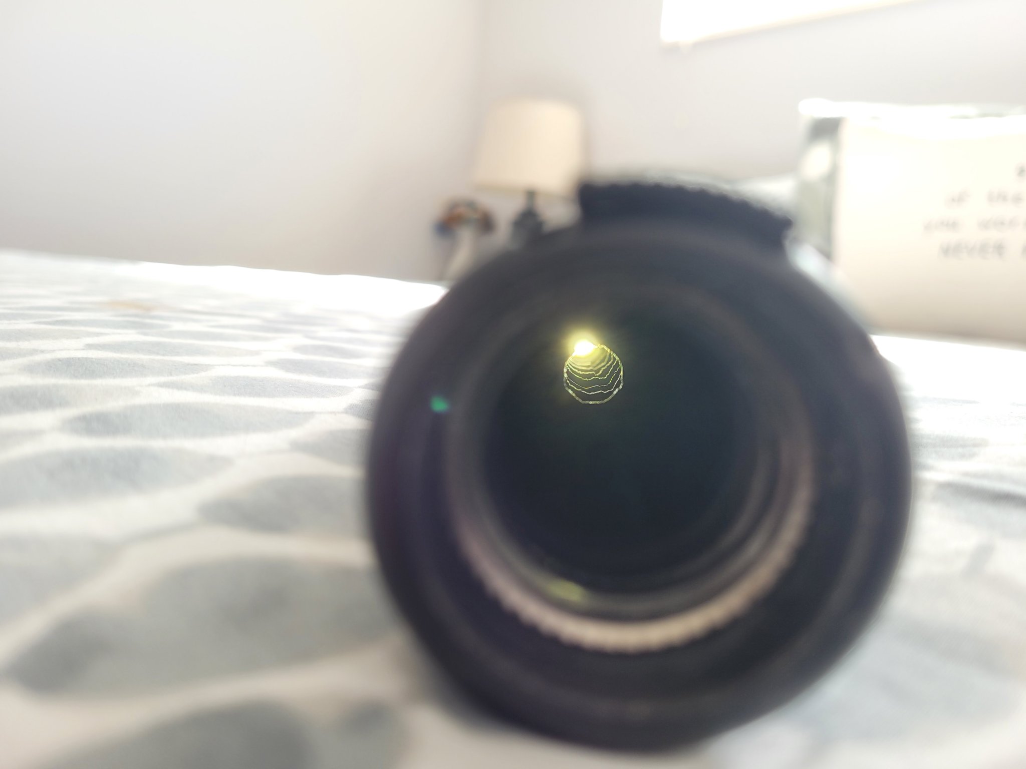

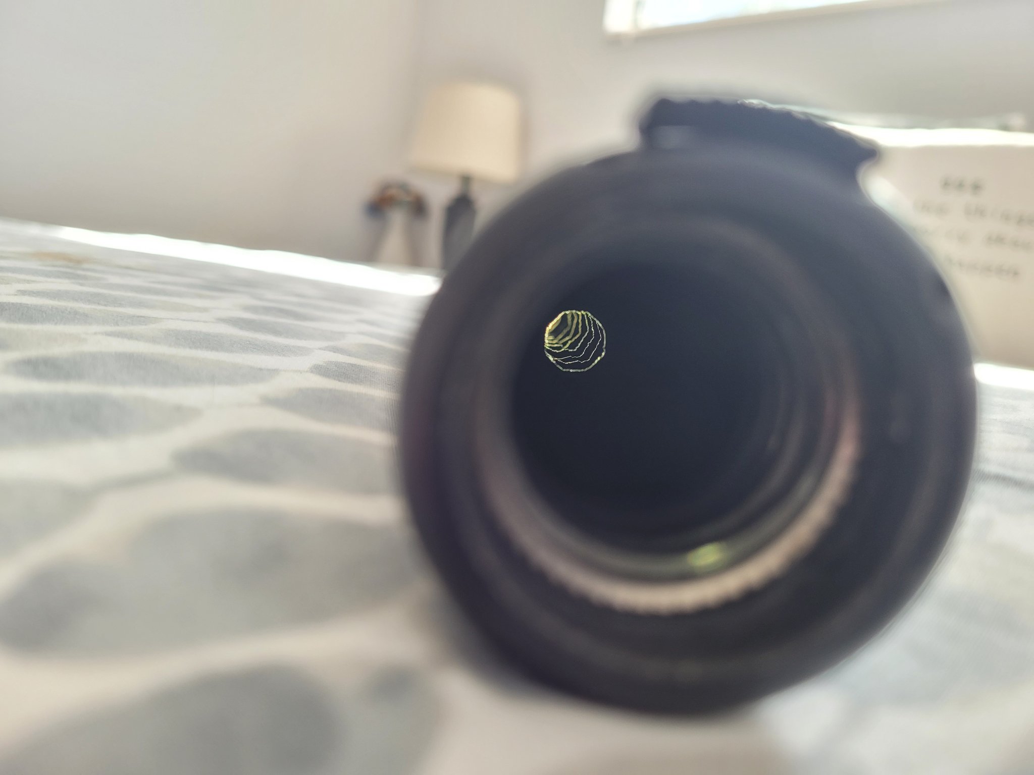

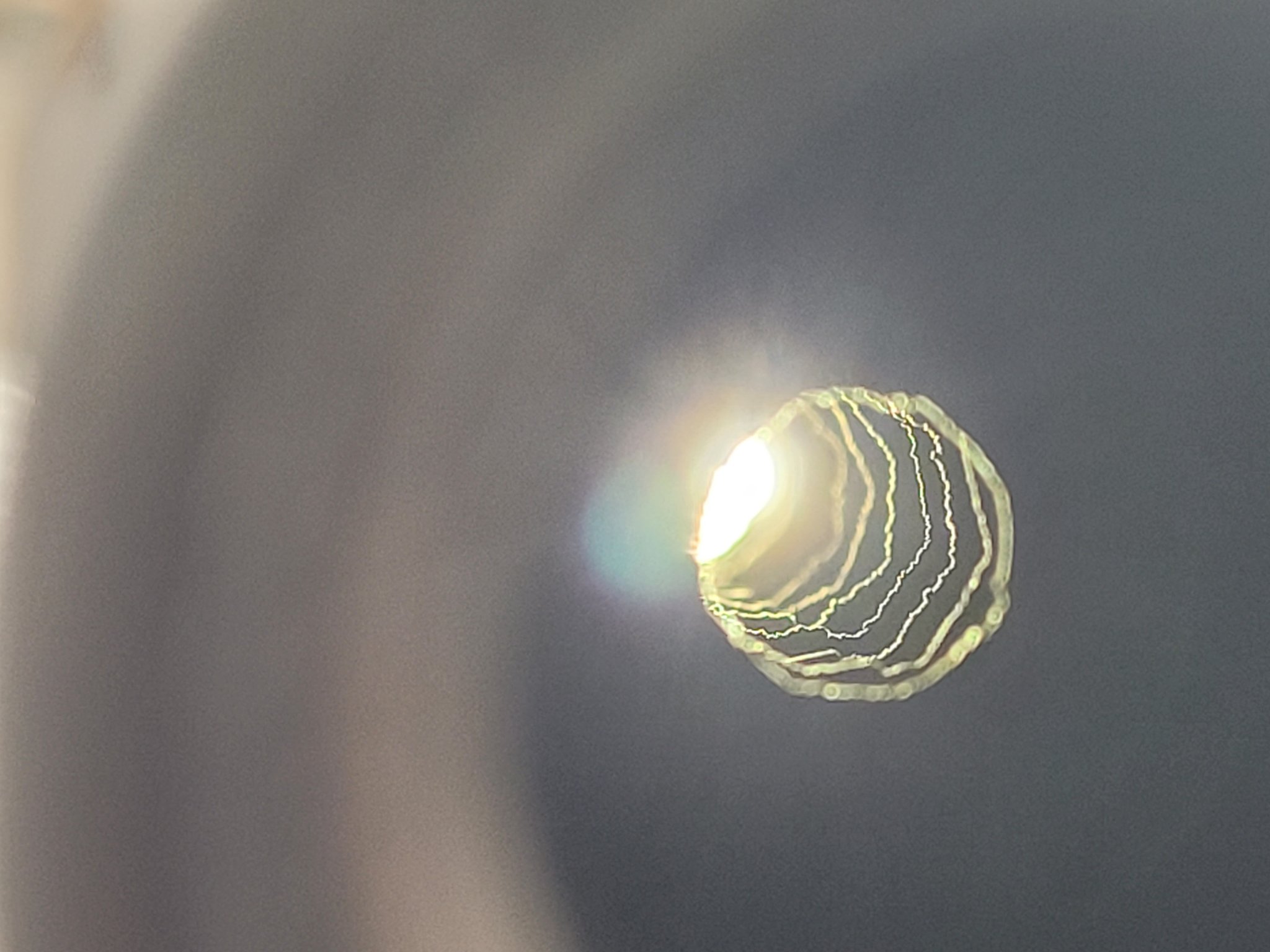

These are pics of my AAC SDN6 with probably 2k-3k rounds of 55gr .223 out of an 11.5" AR. Does this baffle wear look normal? I've never looked at them before to be honest.

Pretty normal. Brand new they are not totally smooth and have a few of the jagged edges like you can see in your 4th picture. Mine looks about the same.

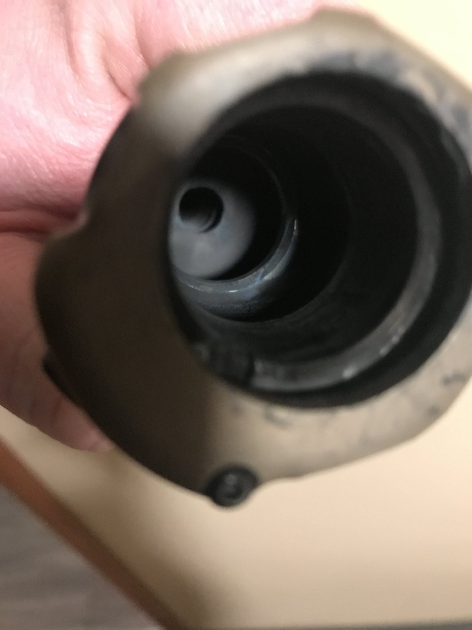

I’ve only seen aluminum cans from Europe get chewed up like that

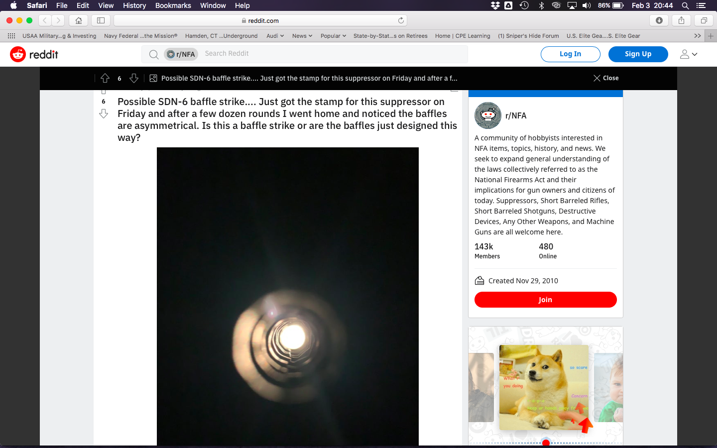

Not my can in the pic below, but that pic is a can with about a dozen rounds down it... That is how my SDN-6 looked new as well. 2013 or 2014 timeframe. They were asymmetrical from the start. Try google. My SF can and Rugged are completely round and smooth. SDN-6 - never was.
Looks normal. Shorties do wear them out a little faster. Might be worth a quick message to AAC but to me it looks about like average.
