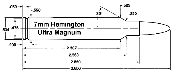

@918v is this how I would measure expansion? Sorry for the ignorance. I honestly don't know what else I would be measuring.
The case expands in every direction to seal your chamber. Measure how much it expands in your chamber vs saami. Assuming .001” springback, your measurements will tell you where your chamber is tighter.
