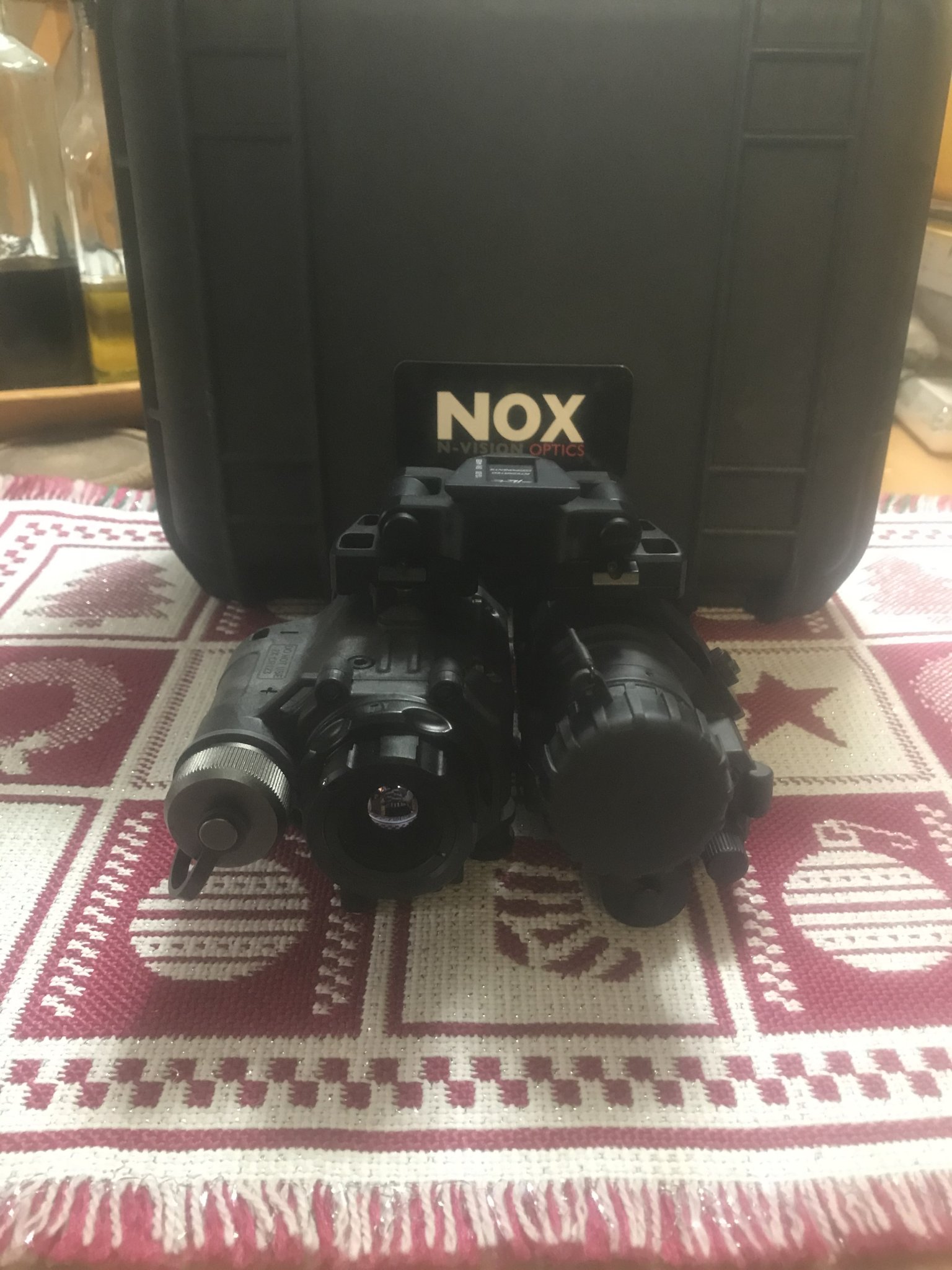

Just received my Nox35.
Turned on once and then nothing!
Damn near 7K and this damn thing doesn’t even work!!!
Waiting to hear from Nvision 🤬

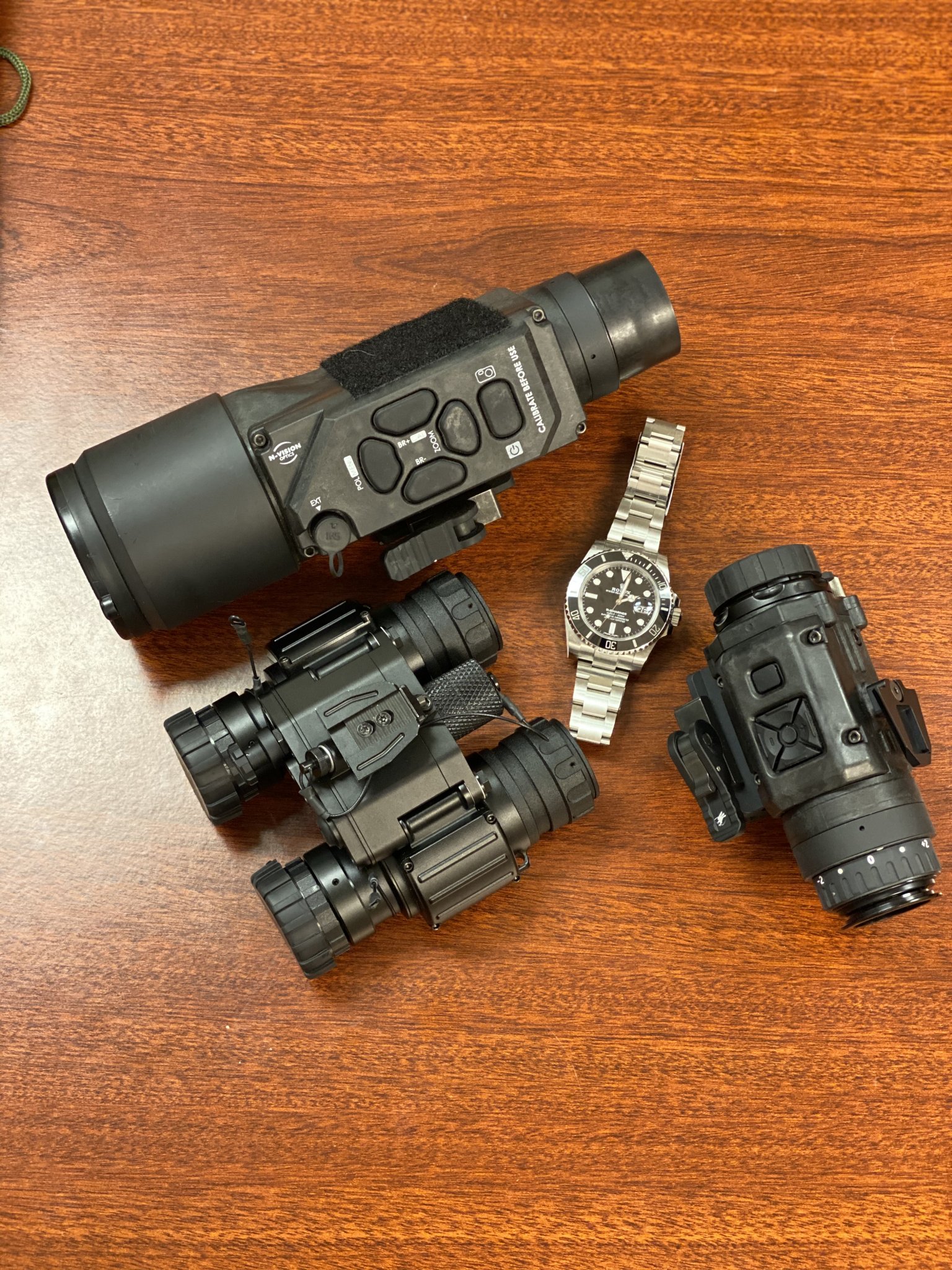

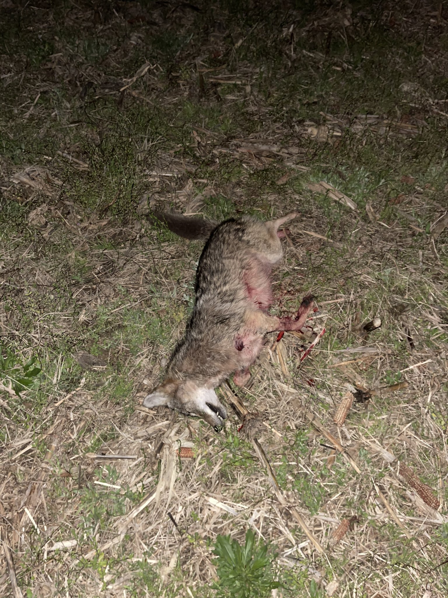

Just finished a 4 day hunt with my Nox 18.
It’s a phenomenal spotter, and I managed to center punch a yote at 165 yards. That said, I find it a little light on native mag, and I’m trying to decide if I should trade for a 35-50mm setup or sell it and get inline for the Halo-X35
