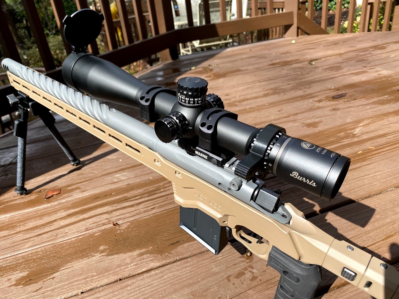

So it looks like mine will be coming together sooner rather than later. Have an MDT ACC folder in its way, and found a lightly used Nucleus action with an 18" 308 barrel (I just got a 26" PVA 6.5cm barrel so will keep the 308 as a spare or use it for training). Has both 16# and 19# springs.
So the last part of the equation is a trigger. This will be my first r700 footprint rifle. I really like the Geissele SD-E trigger in my AR so wanted to go with a 2 stage trigger. Leaning towards the Bix N Andy as they seem to work very well with the Nucleus action (haven't heard of many BnA trigger users having light strikes) and get good reviews... anything else I should consider?
Sounds like Geissele has fixed their Super 700 trigger to work with the Nucleus, but leaning towards the BnA for the custom top sear fitting? Reading that the low sear seems to be the best for the Nucleus?
Now I need some magazines (will probably get MDT or ARC) and an action wrench and I'll be set. For now I"ll put a Burris XTRII 5-25 I have on the rifle, maybe upgrade the optics in the spring after I see what comes out at SHOT.

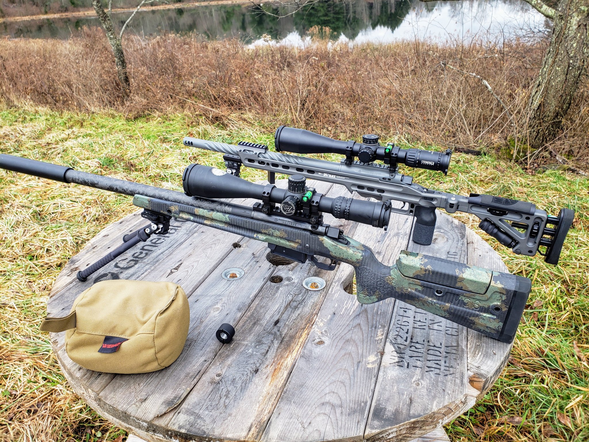

My nucleus dropped into a manners T4A with mini chassis, KRG whiskey 3, and an AX AICS perfectly.

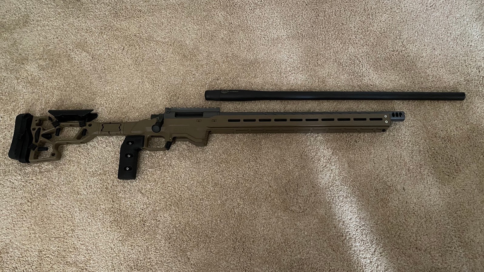

@Emc_2015 pretty sure I bought your old 308 Nuke barreled action (just saw the photos on page 3 of this thread). I have a PVA 6.5CM shouldered prefit for it that I'll put on it soon but can't wait to take it out and shoot it. LRI sent me the specs on the barrel, might send downrange some 175SMK's and see how it likes those..

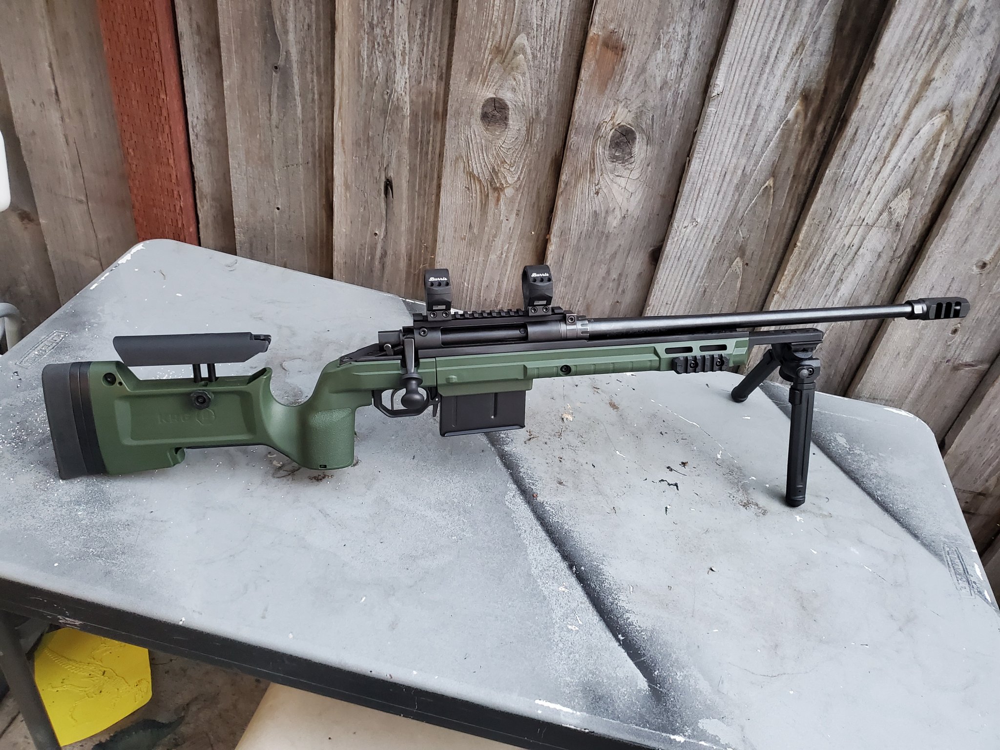

Put it in a MDT ACC chassis (the short barrel look a bit odd in the longer chassis) and a Timney 2 stage CE trigger. So far so good.

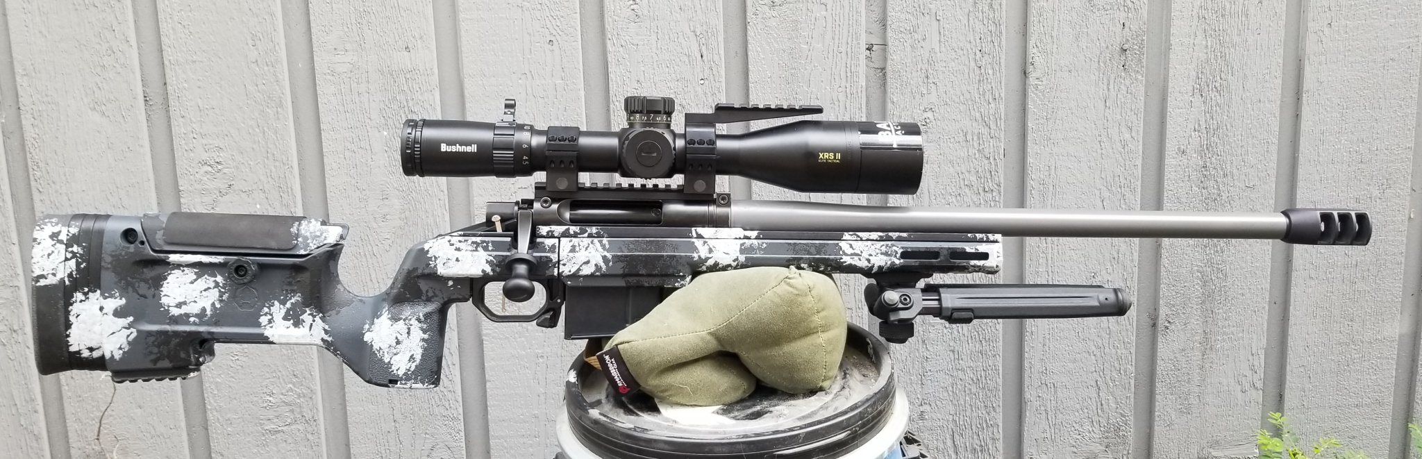

So this will be my first real foray into bolt guns, I owned a savage 10 for about a month... But I decided I wanted to build something worth shooting. So far I have a barreled action in hand and a few more parts on the way.
I went with PVA 308 marksman with barloc, went 308 to fill a role in certain competitions. Krg bravo for chassis and a trigger tech primary.
I will probably pick up ARC rings for my Bushnell XRS2, and I am up in the air on a muzzle device. Anyway, this should be a fun rifle when I get it all together.

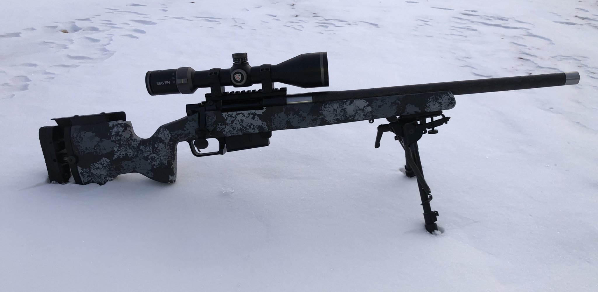

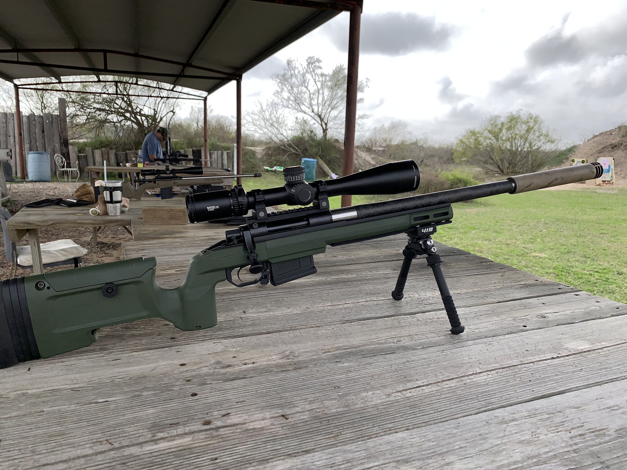

I only have 50 rounds through it but I'm already happy I went with a long action with the 7 SAUM because my last one was on a short action. It was a good shooter but being able to run these 183 SMK's all the way out is awesome!
This is my first KRG product and I'm really pleased with this chassis. I've had a few other chassis rifles but everything with this Whiskey 3 is right on. Very intuitive design, it just fits right. Nothing is awkward, everything is where it should be. I'm glad that I went with it, but maybe next time I'll get a folder.
ARC Nucleus Long action (From a Hide member here!)
TT Diamond Trigger flat bow (Not sure if I'm a fan yet:unsure:)
LRI K&P Shoulder prefit 7SAUM HV 27"
Impact Precision muzzle brake
KRG Whiskey 3 Gen 6
Vortex Gen2 Razor 4.5-27x56
Badger Ordnance USMC rings 1.00"
Atlas CAL bipod

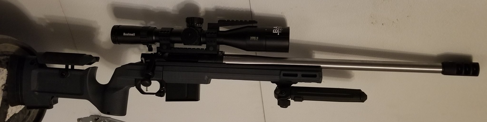

Well, so much for not buying another action. It's a good thing I'm single haha. This 1.1 will be replacing my Tikka varmint 223, possibly my 308 T3 CTR "general purpose rifle" as well. Current plan is a 20" bbl chambered in 223 rem, Whiskey 3 folder and eventually upgrading the PST II to something like an NX8 4-32 next year. Dealer only had the 0.535" and 0.473" options in stock so waiting on the 0.380" bolt head to be ordered in. I have to say, the 1.1 is noticeably nicer than my 1.0. There's a little less "clunkiness" during bolt closing, for lack of better term. Both have the 19lb springs. Haven't had any issues with light strikes on my 1.0. Keeping my fingers crossed for the 1.1.

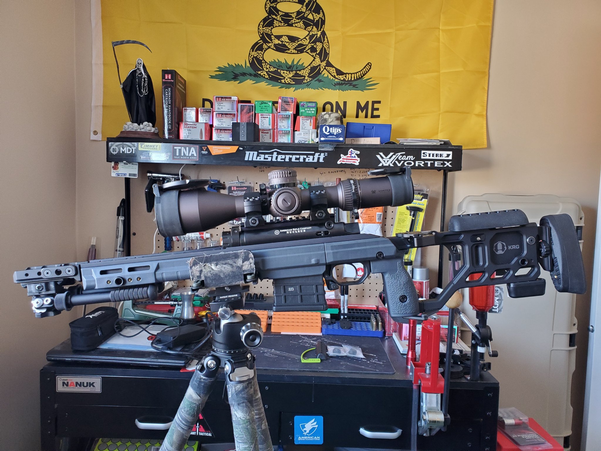

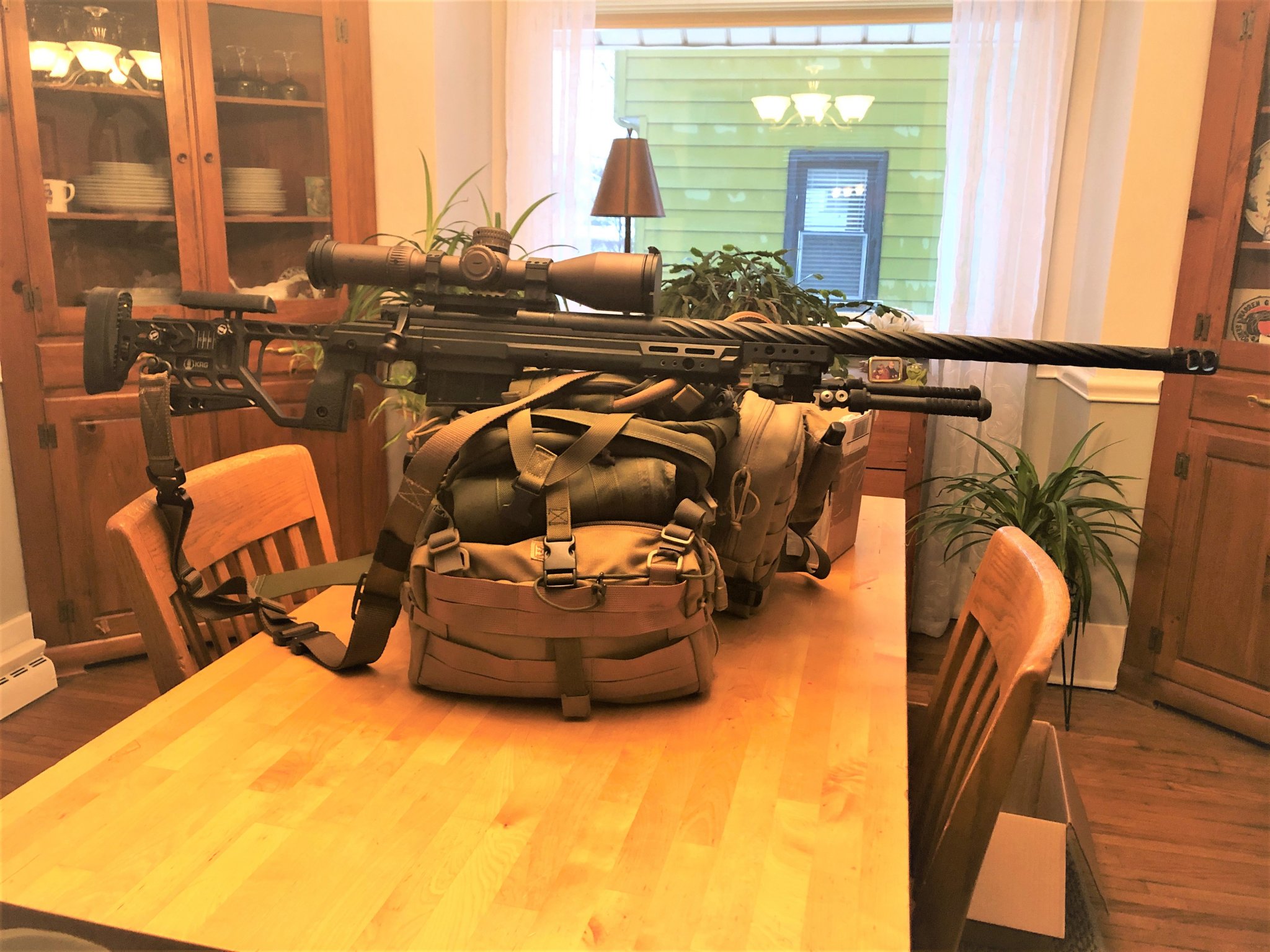

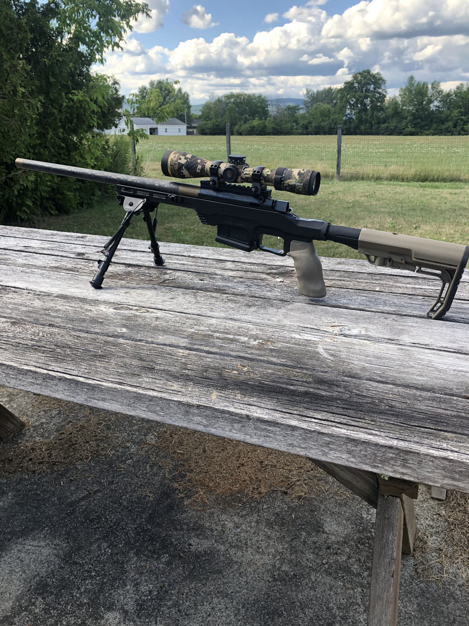

So I can finally post up a photo in the thread as my nucleus comes together...
A bit of background- newbie to precision shooting (but not shooting/reloading/etc) and wanted to get something nicer but didn't know too much about many of the customs on the market. Put money down on a PVA John Hancock late 2018. Waited. and a bit more waiting. And learning and reading. Fast forward to the end of 2019, used my deposit money on a PVA 26" 6.5 creedmoor barrel, cut rifled, black cerakote, etc. Picked up a new MDT ACC chassis. Was going to buy the Nucleus direct but right around that time I found a low round count nucleus barreled action on the hide built by LRI with an 18" 308 barrel. Couldn't pass up the opportunity to have both a 308 barrel and a 6.5CM barrel (I have a few rifles in 308 and a lot of brass). So the build began.
It looks a bit funny in it's current state because of the short 308 barrel, but the guys at MDT assured me no issues shooting it the way it is, and it'll look better when I put the 6.5 barrel on it I'm sure. To round it out, I picked up locally a Timney CE two stage trigger, and just received my MDT mags (2 12 round non backing plate metal) and a new Ckye-Pod with ARCA rail mount.
So current specs:

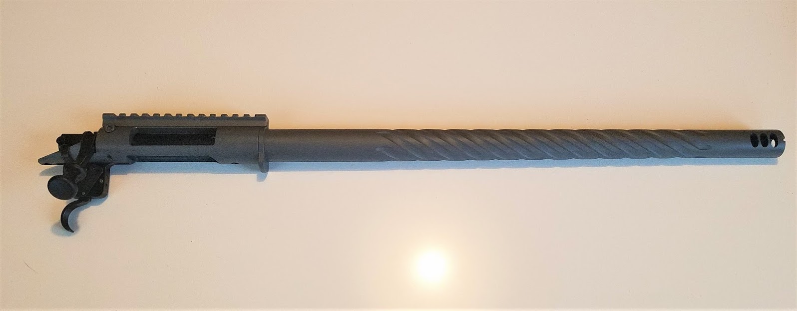

ARC Nucleus action (version 1.0)
LRI 308 fluted M24 cut rifled barrel finished @ 18" (barrel and action cerakoted gray)
PVA 6.5CM Marksman contour barrel, cut rifled, threaded and cerakoted black
Timney CE 2 stage trigger (will swap it one of these days for an Bix N Andy 2 stage)
MDT ACC chassis with folding stock
MDT Ckye Pod ARCA mounting
Currently have a Burris XTR II 5-25 mounted but have it for sale locally and will probably get an XTR III to put there instead.
Anyone have a spare Nucleus action wrench they want to part with???
Should go out next week and at least put a few rounds thru it and then will start to develop a load for the 308 (chambered for 168's, and of course I have a bunch of 175 SMKs).

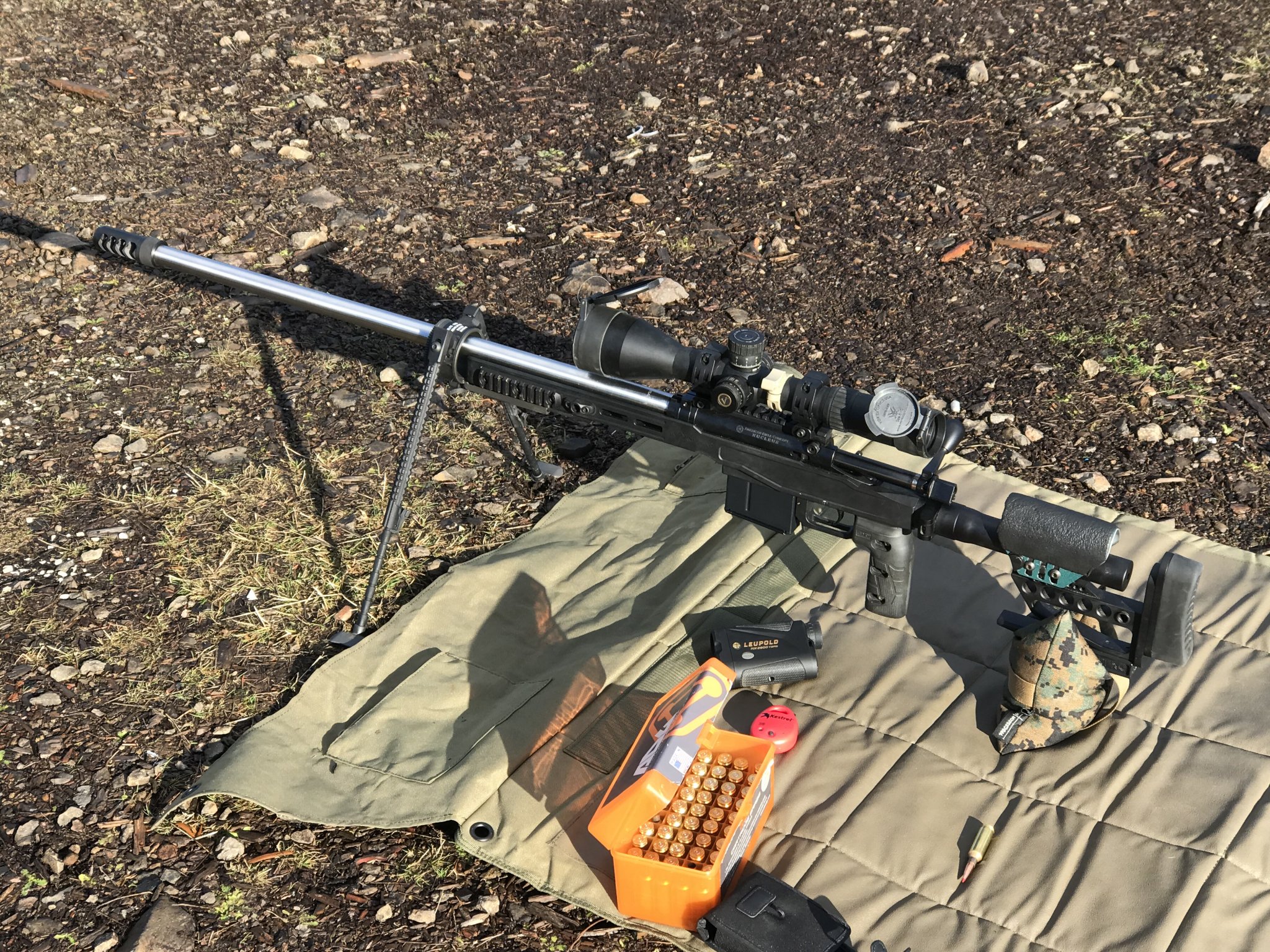

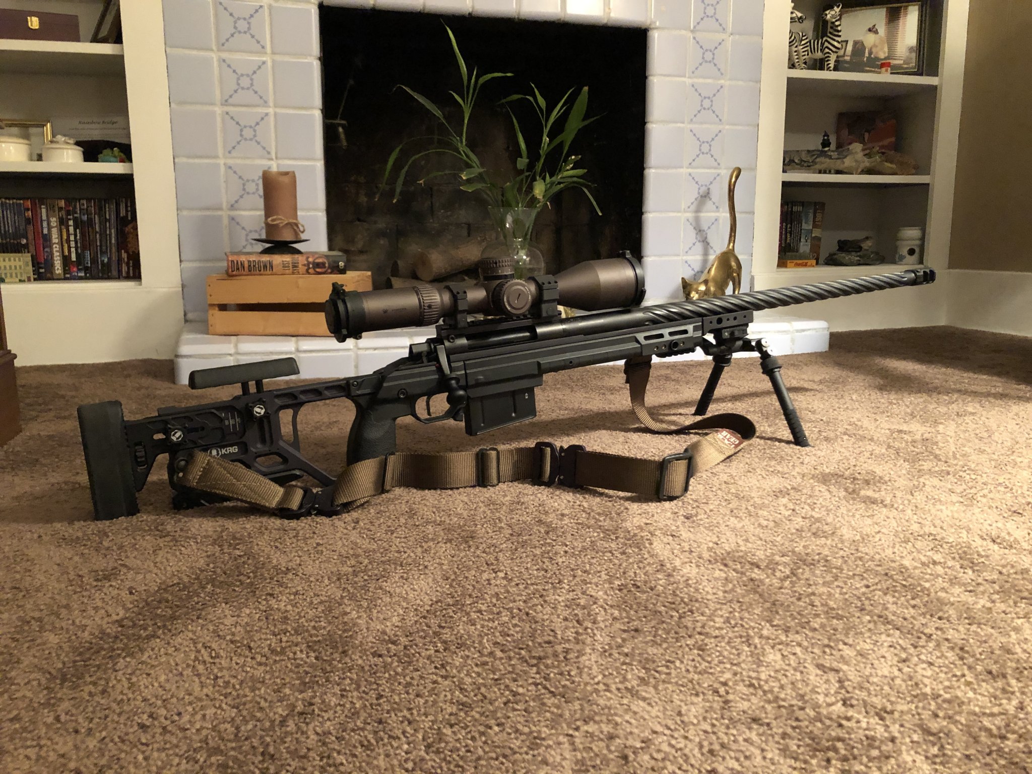

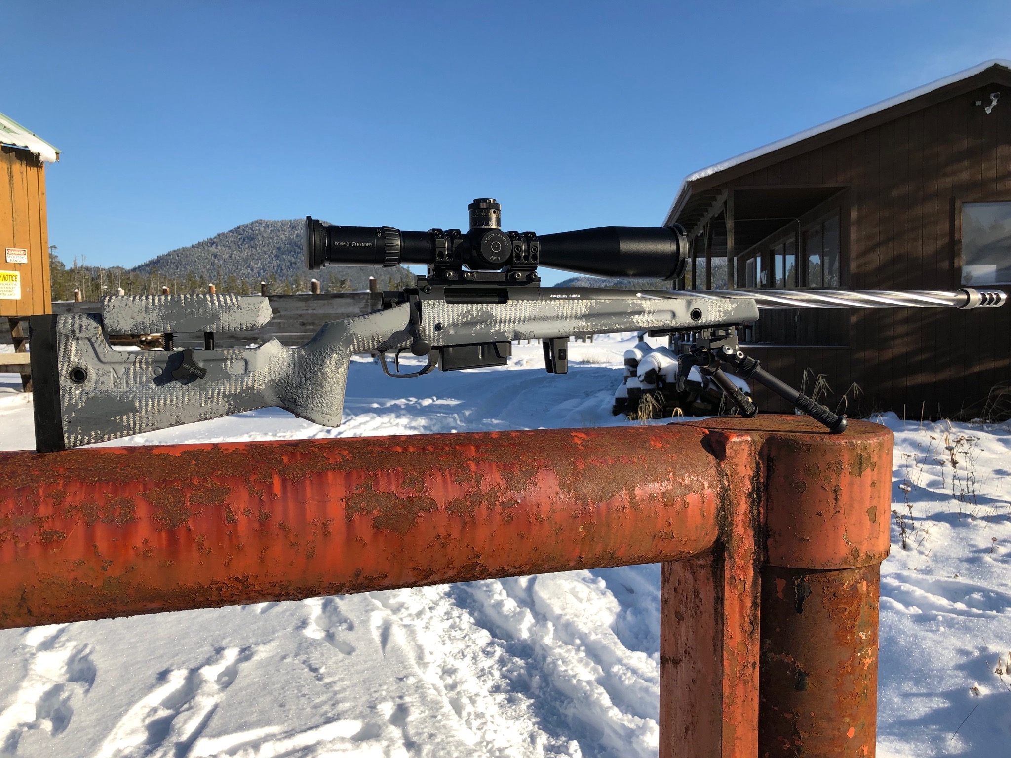

Finally finished my build!
nucleus action with a 20 inch proof sendero light chambered in .308. MDT LSS chassis and a Leupold VX-6 2-12 to top it off. Hats off to LRI for the amazing barrel work and cerakote! Going to be kind of a do all rifle for me, excited to see how it carries for whitetail in the Adirondack mountains this fall!

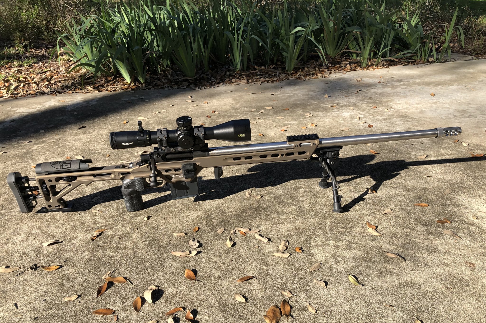

Question for you guys with ARC Nucleus actions. My action is here but I won't be able to barrel it until Thursday due to work travel. I have a 6mm BR barrel & was wondering if anyone has used that caliber in a nucleus with either the MDT 6mm br mags or ARC mags with PVA kits installed for reliable feeding? EDIT!! I should have read all the threads as my question has been answered.
I have a McMillan A5 all decked out with Area419 acra rail & KMW bottom metal, Bix & Andy Tacsport pro trigger,
will be used in a couple NRL matches but mostly for priairie dog shooting.
Seems you have your answer, but just to add to your confidence, I have since finished my BR build and running a PVA bbl, gen 1 Nuke, and MDT mags has had zero issues

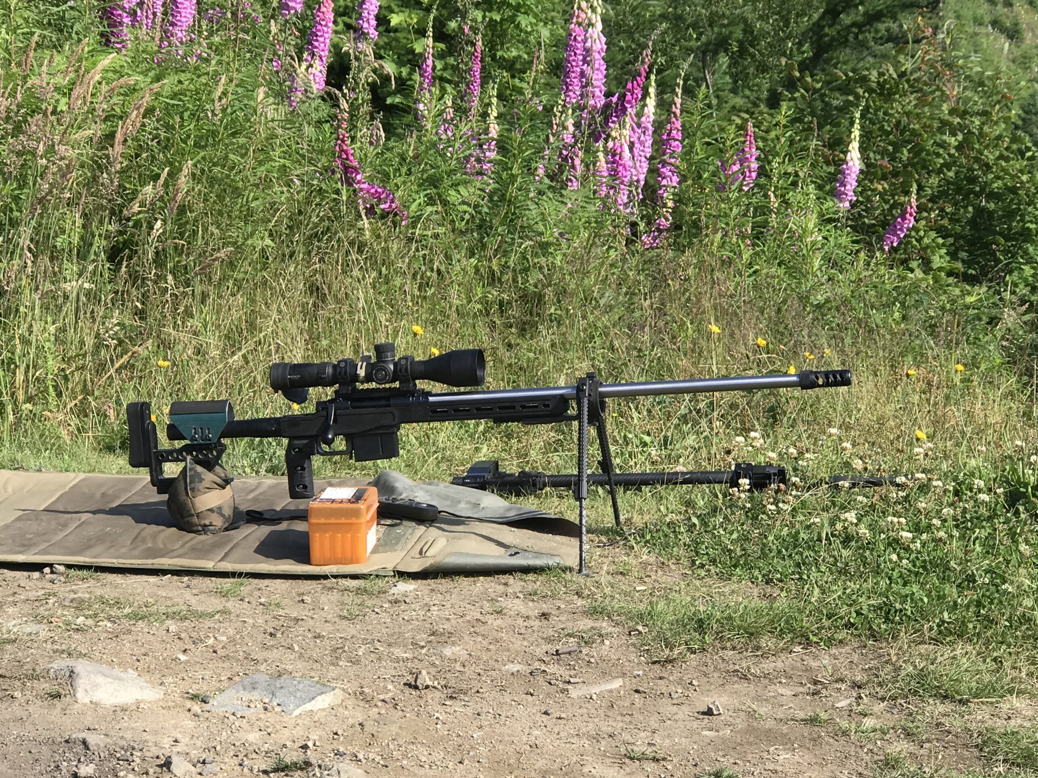

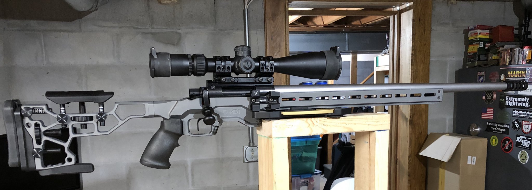

since this thread is back near top- any of you running a Vortex Razor 4.5-27 on the nuke? what height rings (MDT ACC chassis if it matters) are you using? was assuming around 1" height but figured I'd see if I could verify so I can get some rings on the way before the scope gets here..
Reactions: BigdaddyWSM
Here’s a nuke with an identical sized scope and medium ARC rings
Using a Spuhr 4001 - 1.18 with plenty of clearance.
