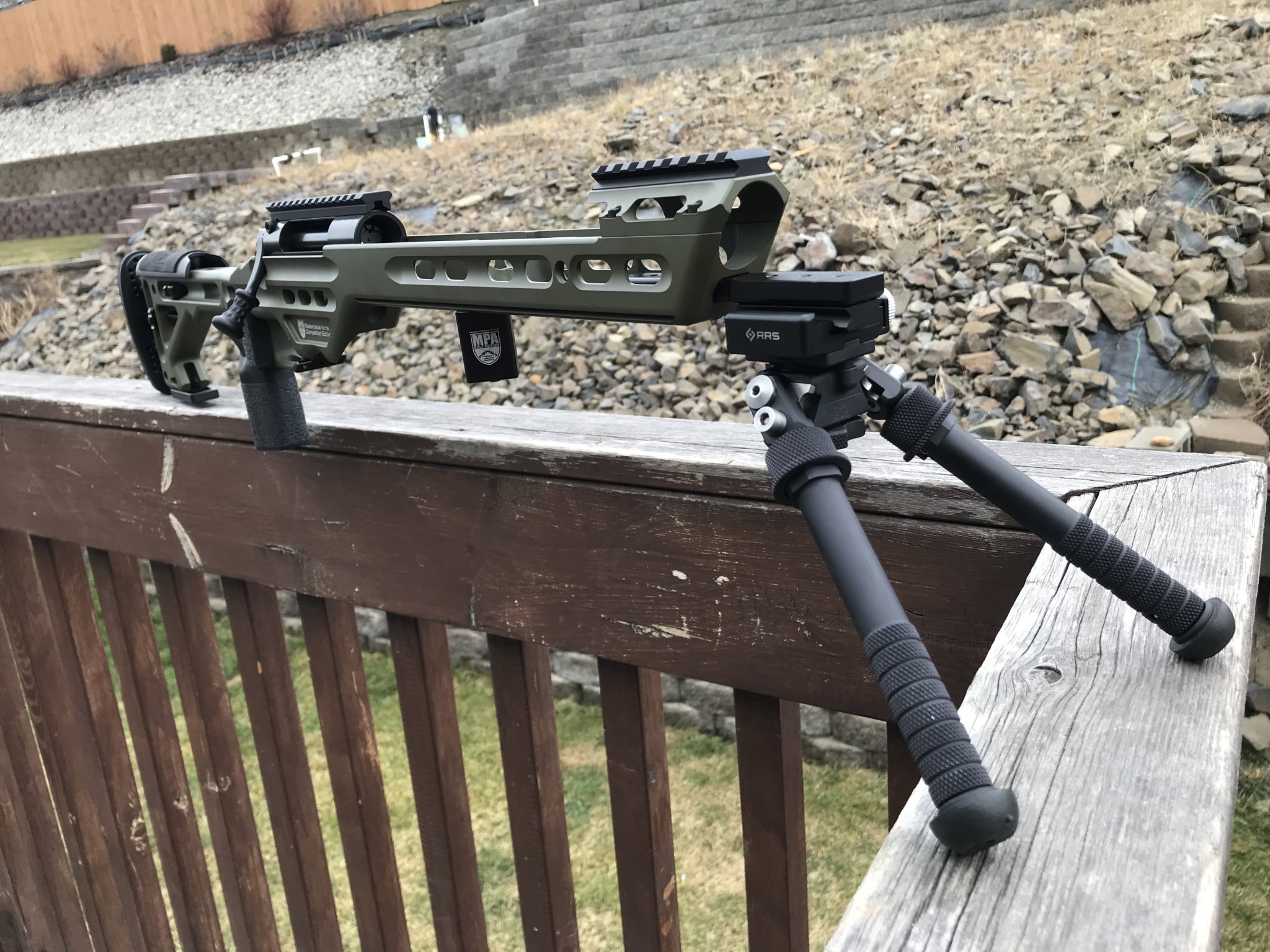

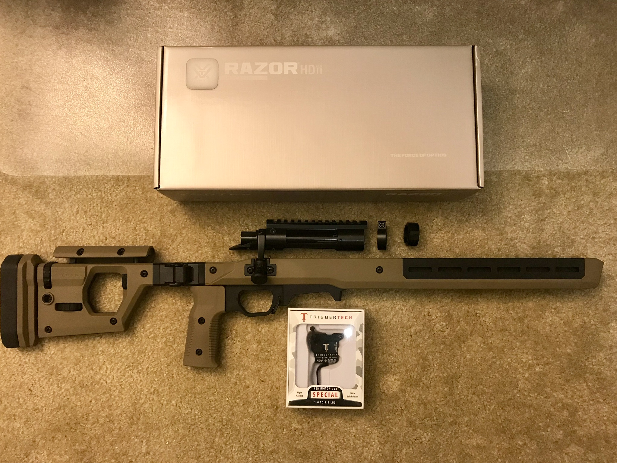

Nucleus Build Pictures
L/A Magnum Nucleus 20 MOA rail
Trigger Tech Special
Manners T2A mini-chassis, CIP length
Accurate mag CIP .300 mags
ARC Barloc
ARC 30mm uni-mount, 20 MOA
SRT 30 cal magnum Ti can
Proof 6.5 SAUM 28" barrel ( stand-in until I get my 30 cal blank from Bartlein for a 30" 300 PRC)
Stand-in Vortex 2.5-10 until my 6-24 AMG shows up
Going to take it out for the first time tomorrow with the stand-in barrel/scope just to get some initial feelers. The SAUM barrel is from my S/A Mausingfield but the thread specs on the two actions are the same. LOTS of extra room for the SAUM rounds in the CIP magazines... I'll probably just be single feeding.

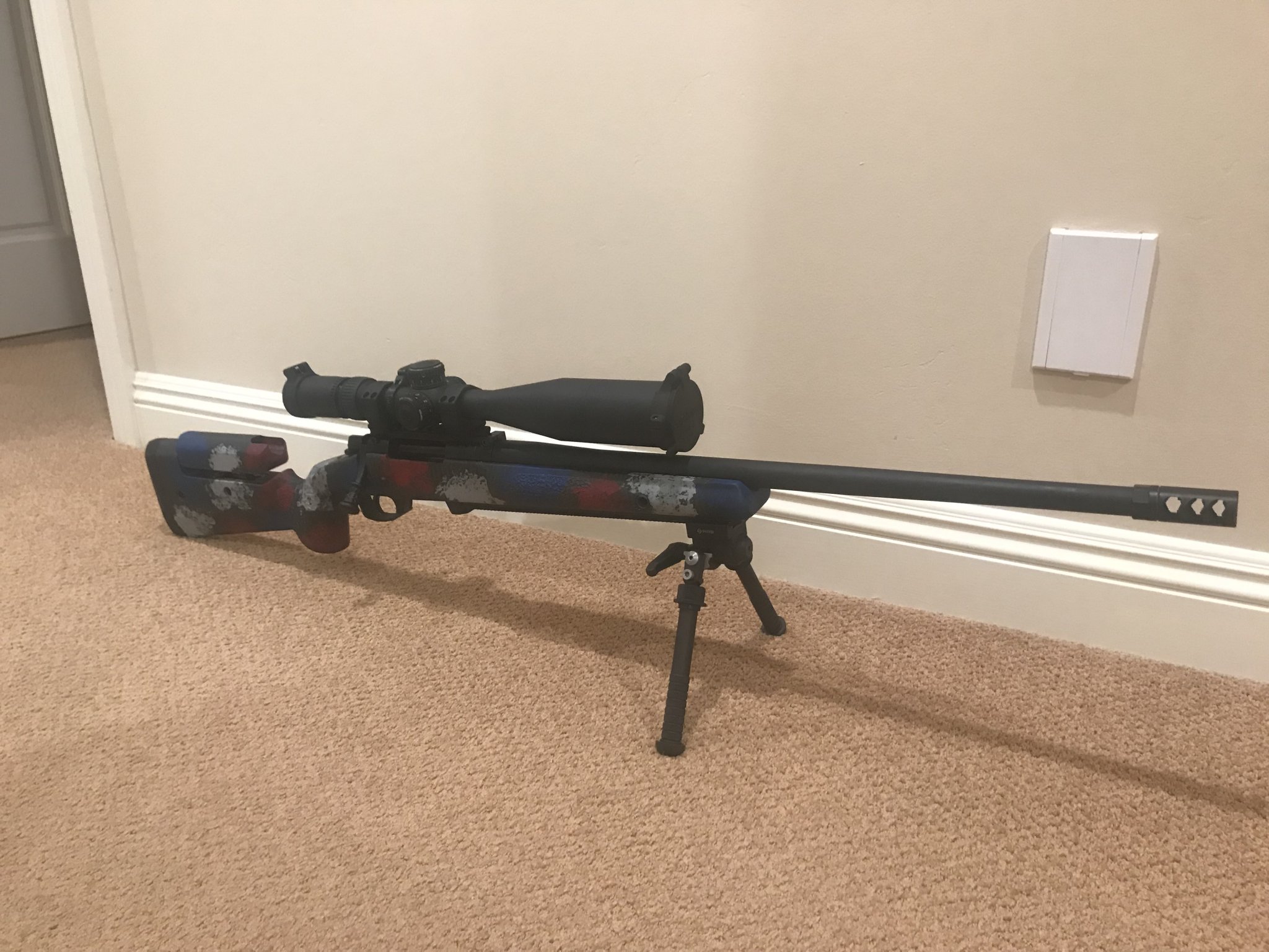

I would be interested in hearing how it does with the 300prc. I would like to do a Nucleus 300prc also before too long.

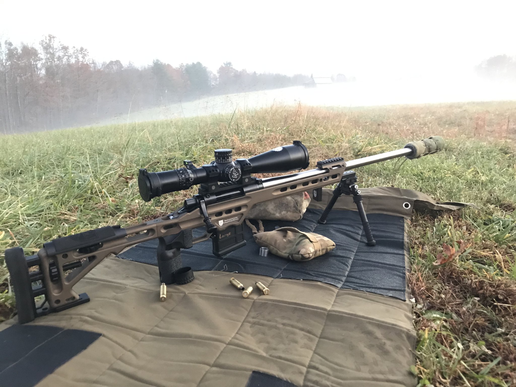

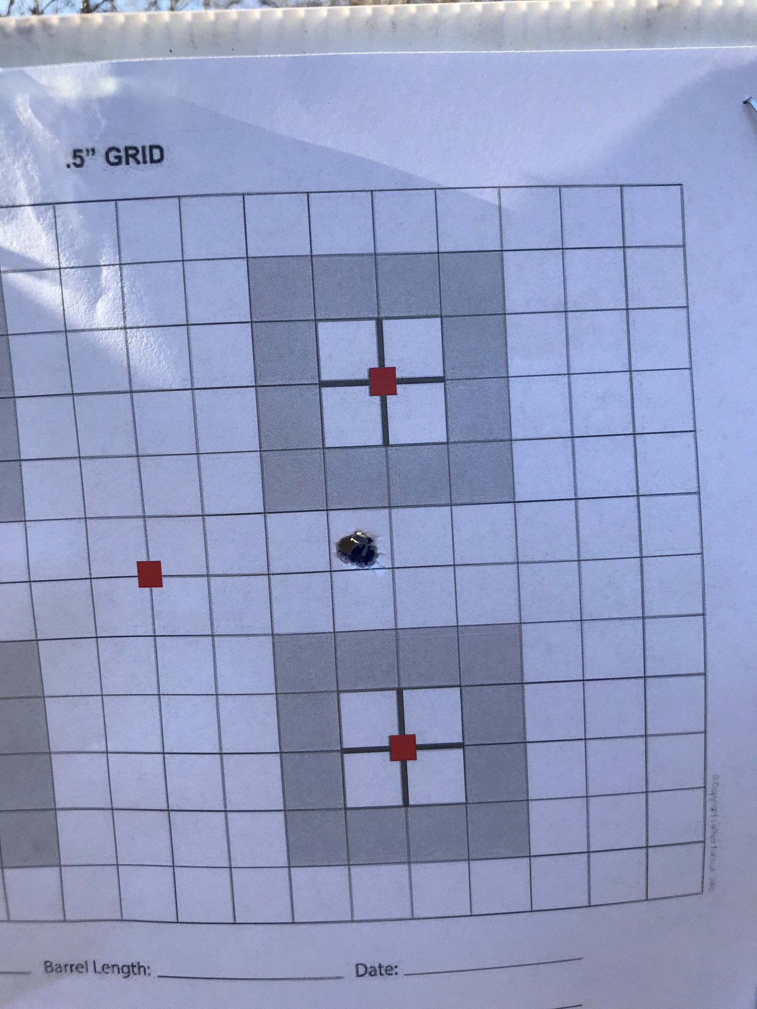

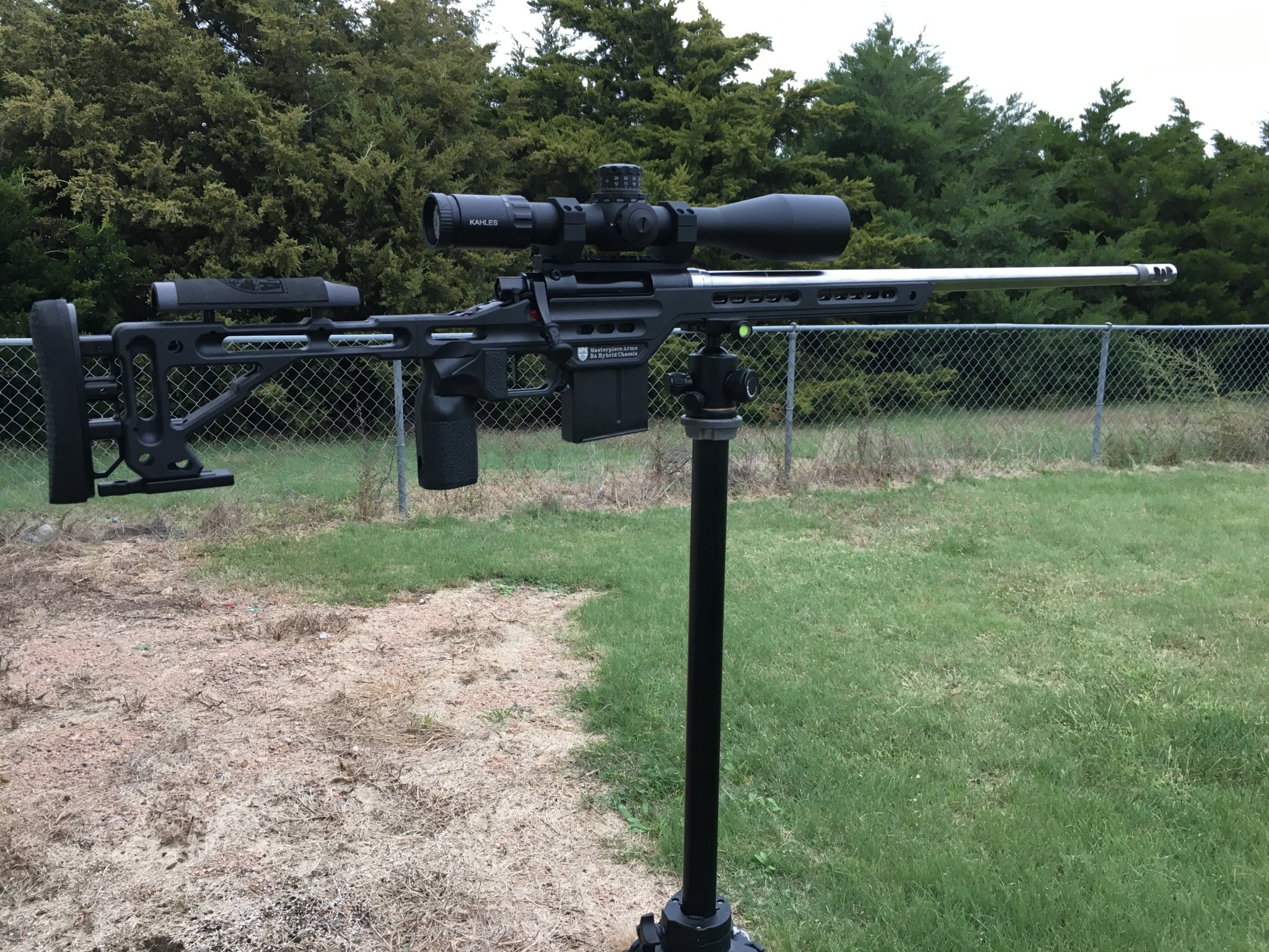

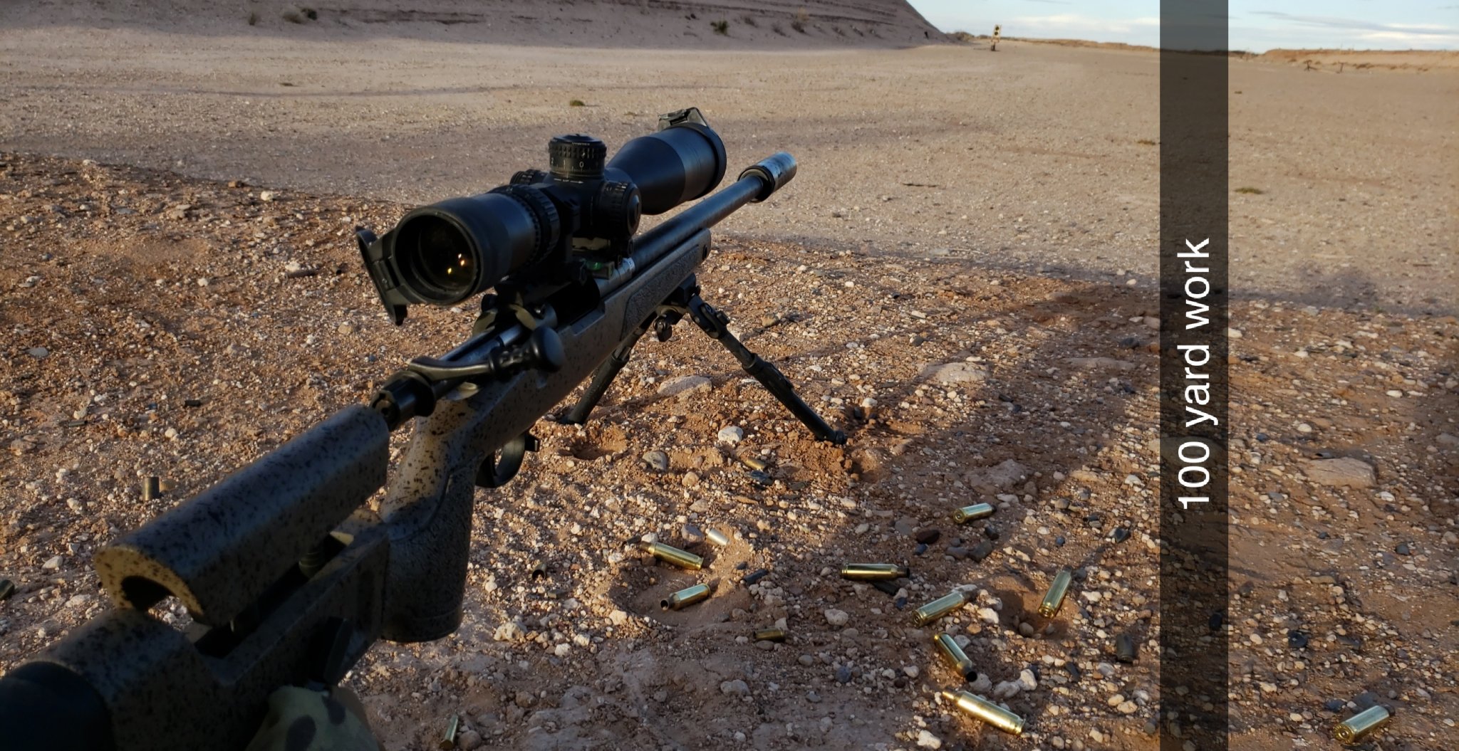

Only shot it 100 rounds but so far my impressions of my Nucleus are very, very good. I have a little of the feeling of cock on close but it actually isn't cock on close, it's the resistance to depress the pin detent that's at the back cocking piece shroud. I've run some practice match stages and I find no disadvantage to this bolt feel, the bolt runs fast and smooth.
The rifle is very accurate, I only shot a group to sight in but it's easily around a 1/2 minute of accuracy. The barrel is a little slower than my two other 6.5 CM rifles which have 24" Bartlein barrels. Avg velocity from this new barrel with my handloads (41.8 grains of IMR 4451, CCI BR2, Hornady 140 ELDM, Hornady cases) was 2660 fps, whereas that load averages around 2705 in my Bartlein barrels.

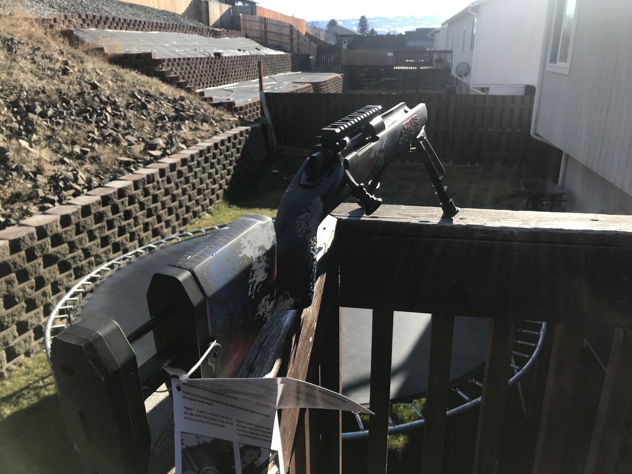

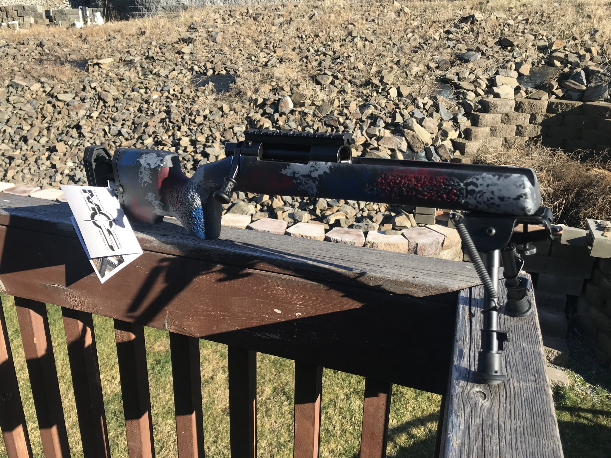

Rifle:
Nucleus w/Barloc barrelled action from PVA
24" 6.5 CM Rock Creek button rifled barrel from PVA w/PVA Jetblast brake
Manners T2AGAP stock in Americana flat color with MCS_DBM mini chassis Gen 2, 12" Area 419 rail mounted to the forend
Vortex AMG scope mounted in Vortex PMR (Seekins) rings
Rifle:
Manners T2AGAP stock in Americana flat color with 12" Area 419 rail mounted to the forend

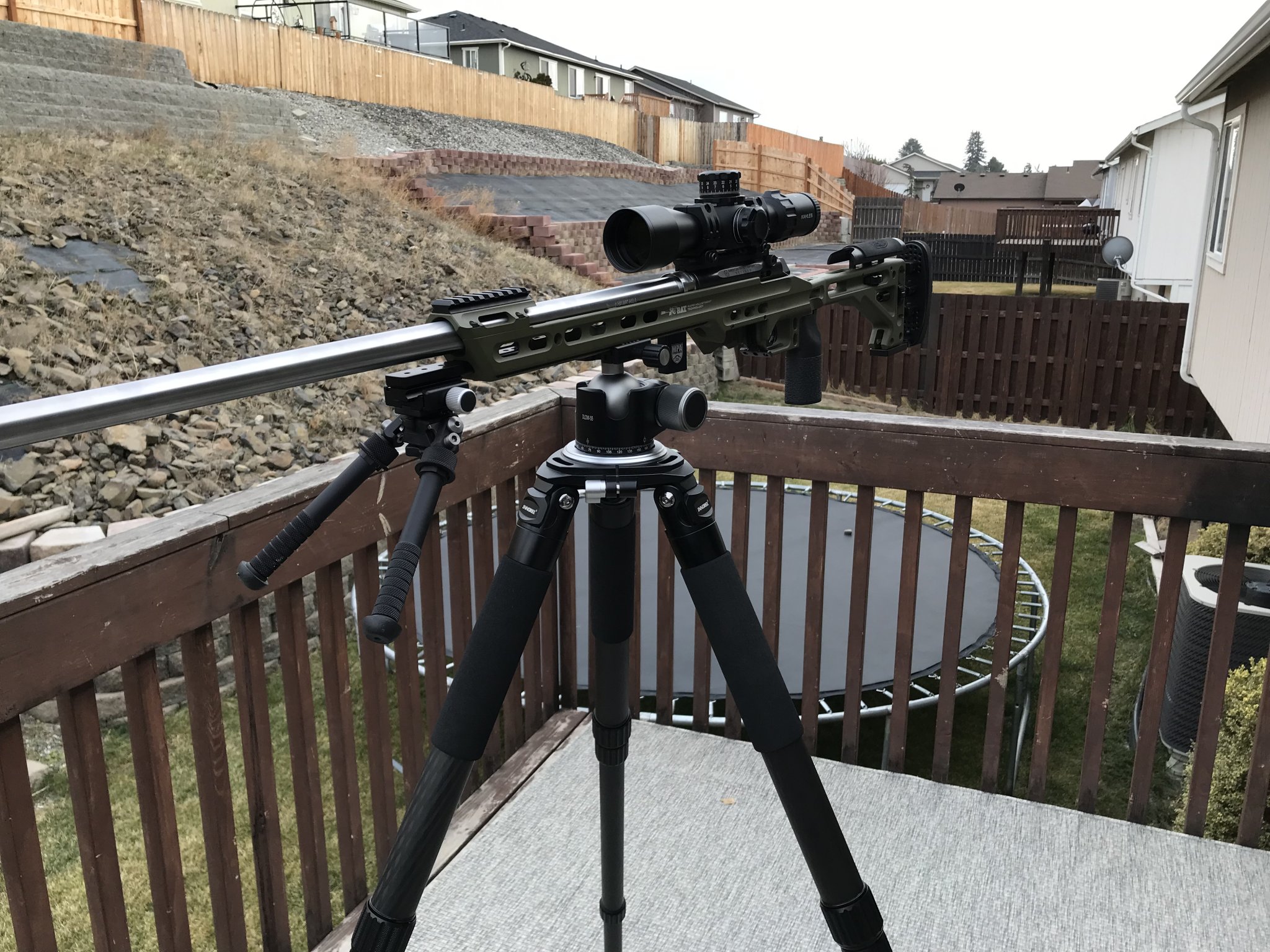

Any pictures of it outside?
I’m using a barrel nut style barloc on my nucleus in a bravo and mpa hybrid with no issues I took it out of the mpa yesterday after seeing your post and can’t find that it’s contacting anywhere my barloc is the same or smaller diameter than the shank of a shouldered barrel would be I changed barrels without removing the action from the bravo so definetly no interference there will have to try the same in the hybrid next
My barrel nut was out of round, I had three barloc nuts and setups at the time and the other two I tried and they worked perfectly. I spent quite a bit of time on the phone with MPA and a little time with ARC, not going to get into all that but bottom line is it works in the hybrid and even though I never tried to put it in the KRG bravo, it most likely works in the KRG also. I ended up selling (yes he knew it was jacked and paid appropriately) that nut to a gent that is wanting to use it on a savage and is a machinist so he can play with it. I still have a Nucleus with Barloc setup on my sons hunting rifle and its a fantastic product, I did go back to left handed actions and went Bighorn TL3 for comp guns (which also fit the hybrid perfectly lol).

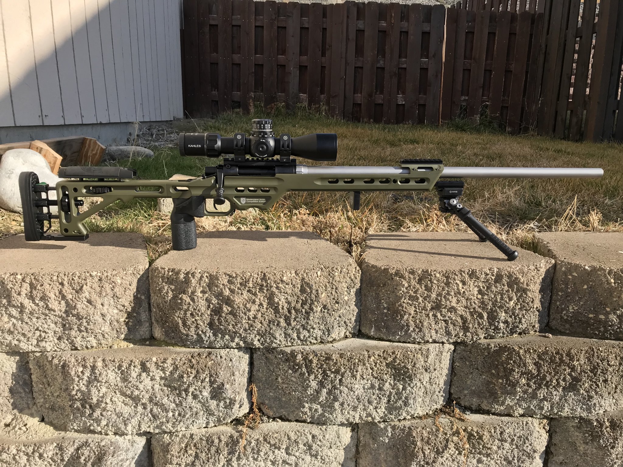

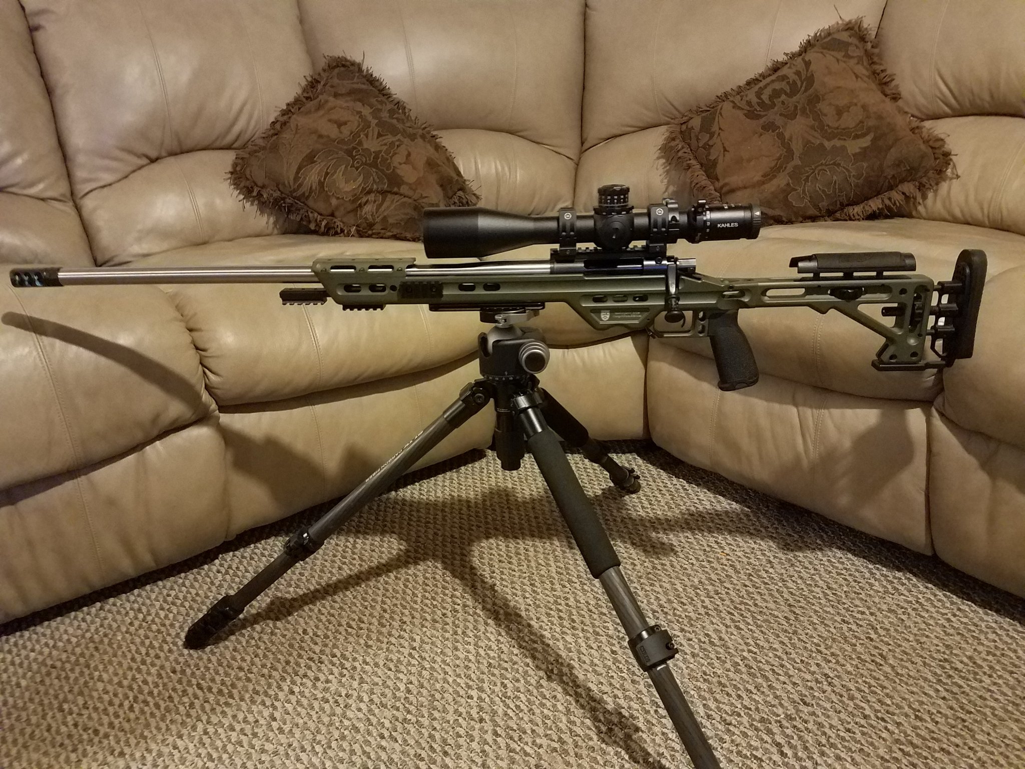

Lefty, ARC Nucleus
26" Bartlien 7twist 6.5x47
Timney Calvin elite trigger
MPA comp. Chassis
PVA jet blast Brake
Kahles 624i
ACR Rings

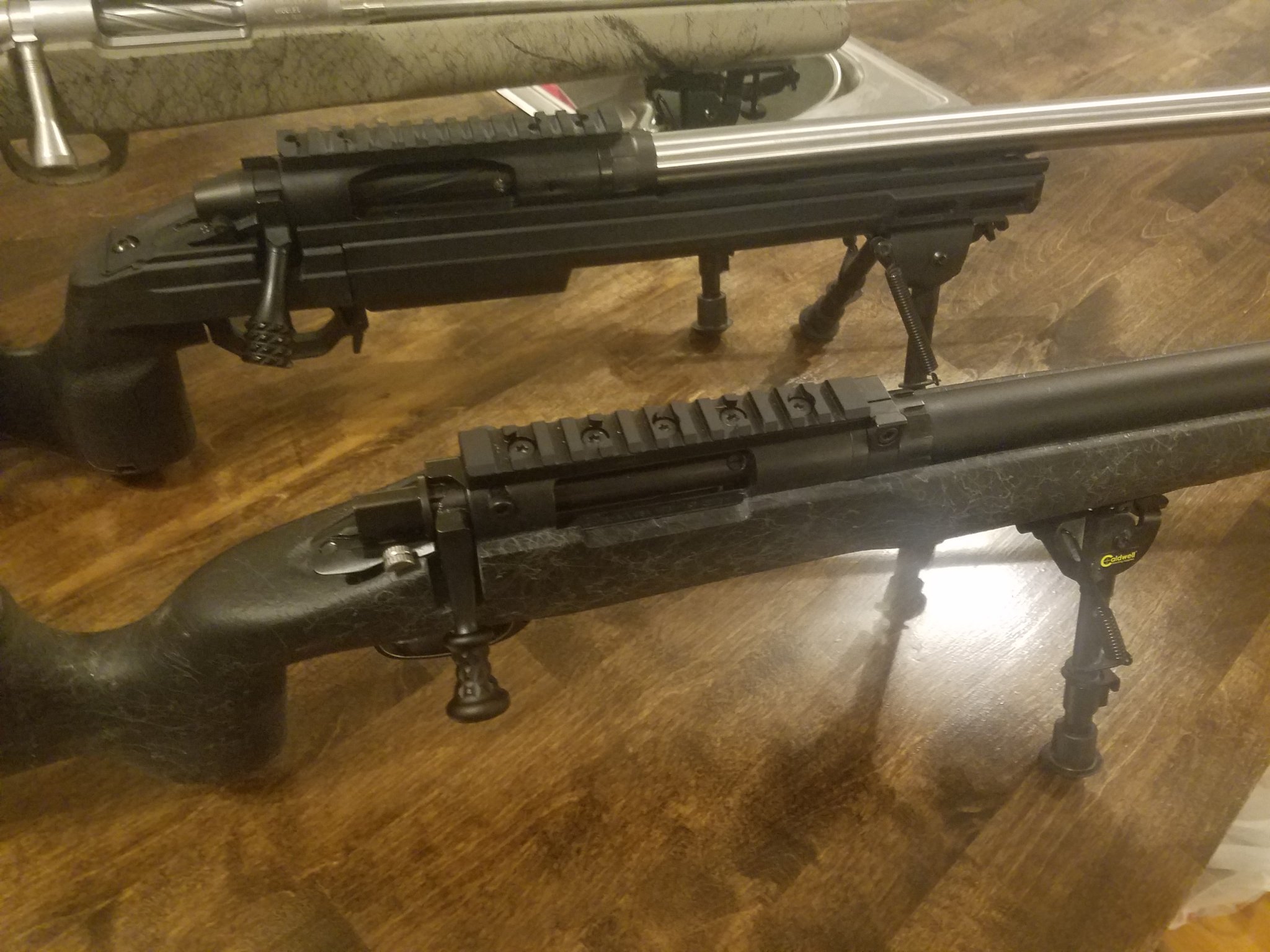

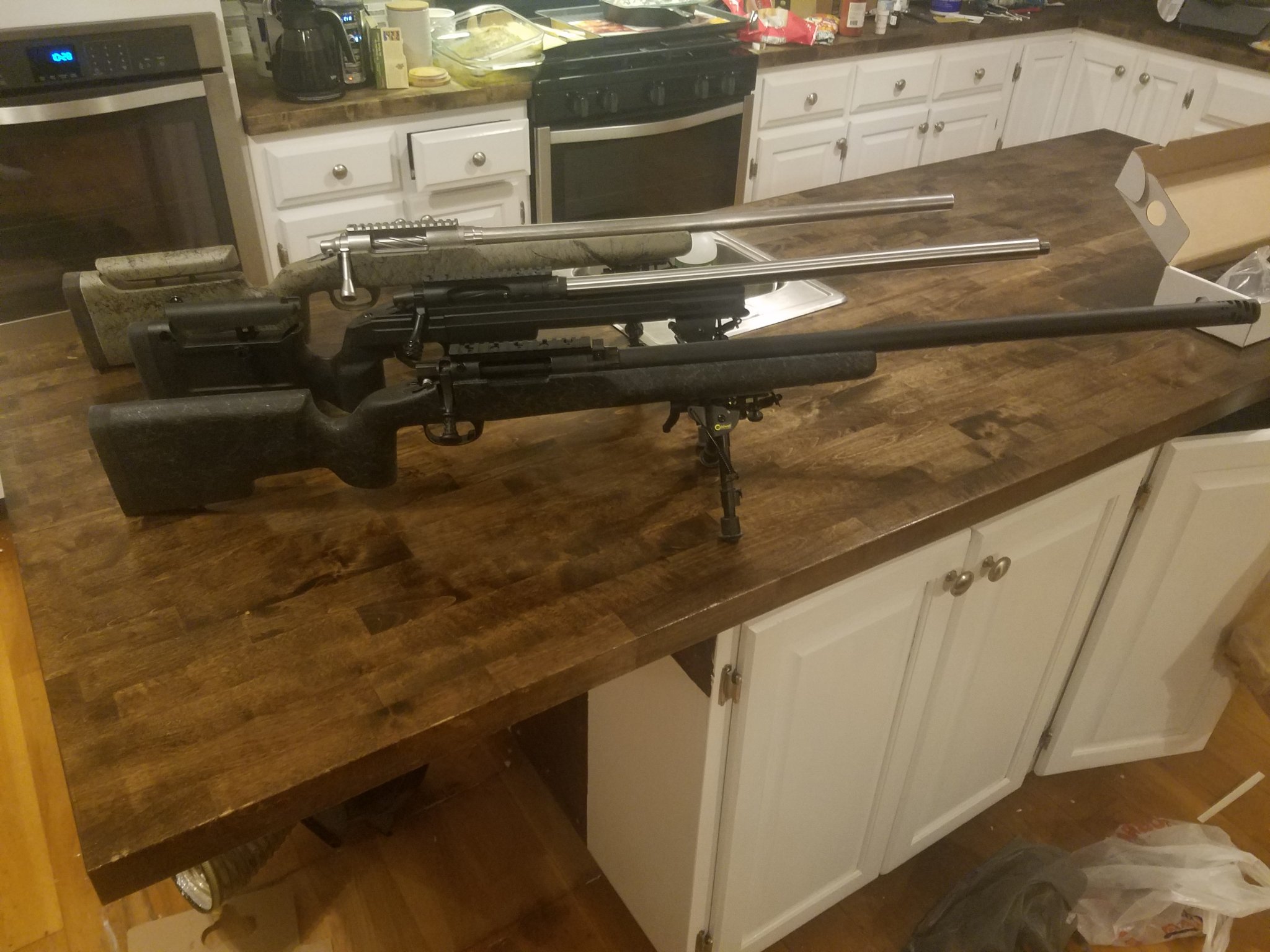

I pre ordered in the beginning of January 2017 and I waited 9 months for the Action, Received it September 2017, well worth the wait.

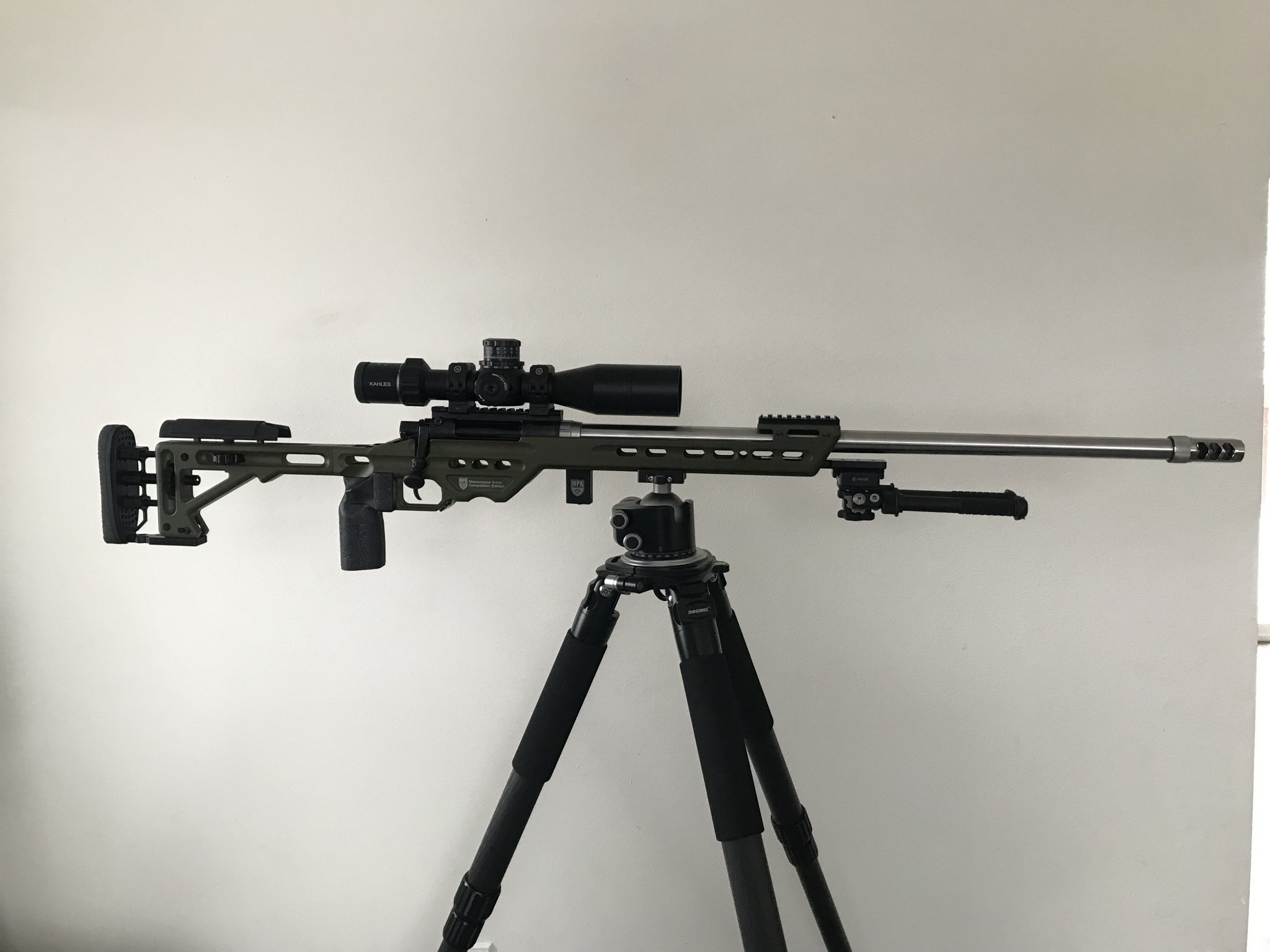

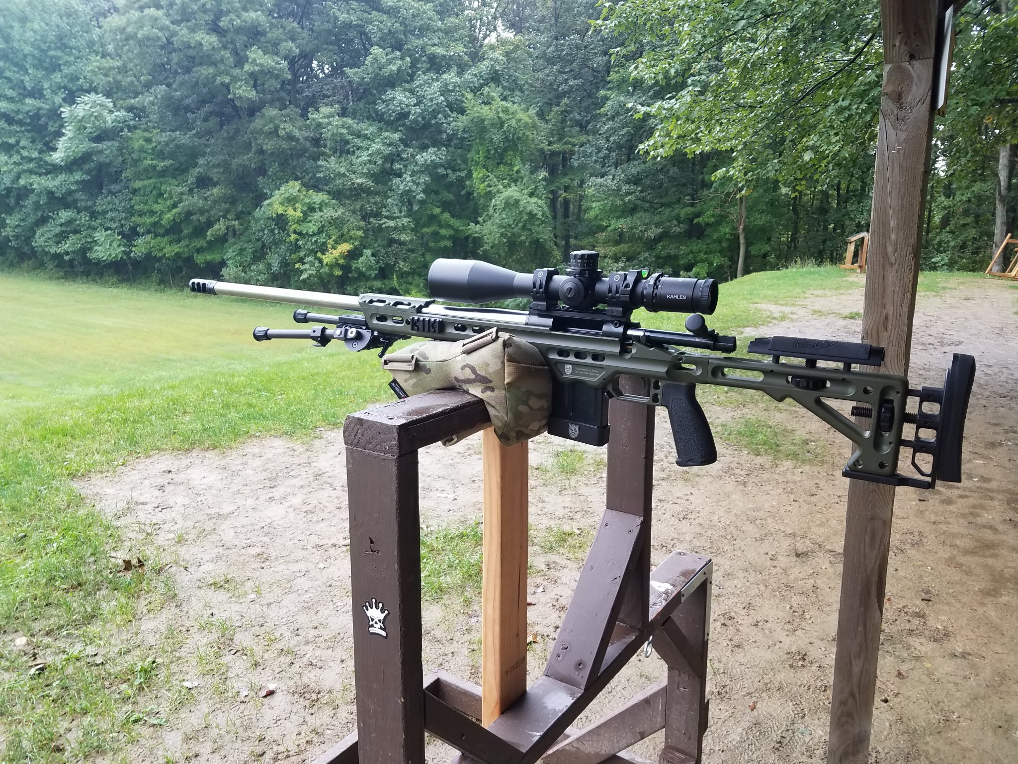

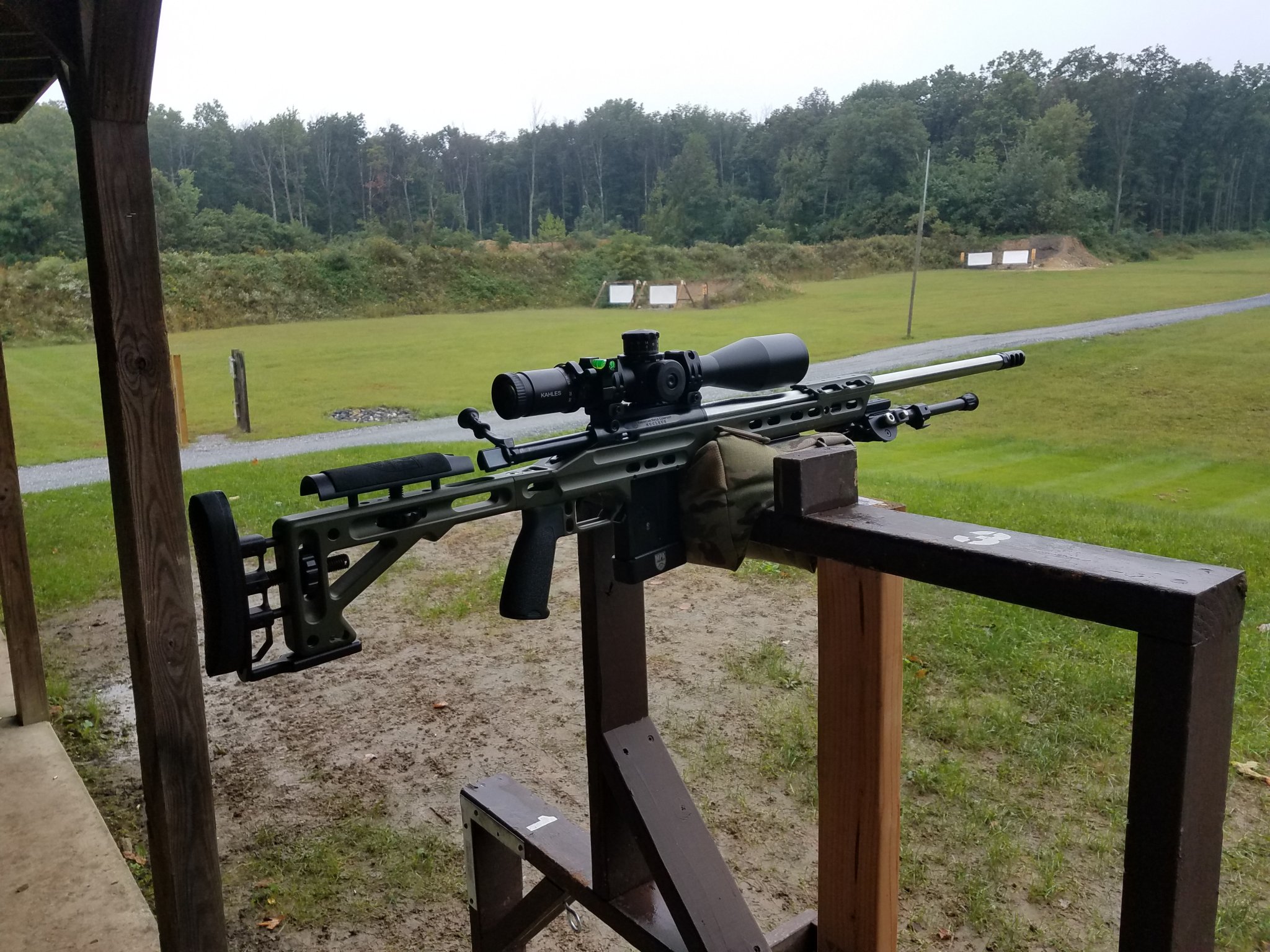

Another lefty ARC Nucleus
6.5cm
Barrel: Shilen select match varmint 26”
Trigger: Bix n andy tacsport 2 stage
Chassis: MPA comp chassis
My first control round fed action and am really liking it. Especially if shooting at a range prone or sitting I just place a pouch right next to action and have all the brass just drop right into it. Good times
Chad
How do you like the B n A? I'm thinking of getting a tacsport pro for mine. I like the idea of being able to change the top sear instead of filing on the cocking piece.
I like it a lot. Just purchased another for my origin build. I did get the lower sear in anticipation for the origin since they recommend it for the tl3 action. I didn’t go pro version since I wouldn’t want my trigger to go that low in pull weight, but that is me.
Chad
I'm going to order the low sear with the trigger. The few nuke measurements I've seen are right around 4mm which is in the low sear range. If memory serves me correctly, the pro goes up to 2lbs 3oz. That will give me plenty of adjustment. Also, from what I've seen, you almost never get the lowest advertised weight.

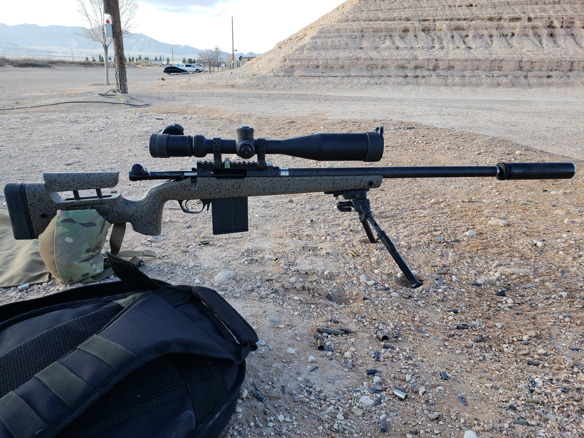

Finally set mine up today and couldn't get the extractor claw to snap over the rim of the .284 headspace gage when inserted into the chamber first, and no, I didn't try to force it.
With the bolt open, slide the gage across the bolt face and under the extractor claw, it will hold the gage in place and you can ease it into the chamber. There was a little "bump" or "catch" that needed to be overcome, or the bolt pushed ahead a hair more, to reliably close the bolt and not get a false feeling with the GO/NO GO gages.
Following the directions and spinning the barrel down on the GO gage will get you almost perfect headspace on the first try, though.

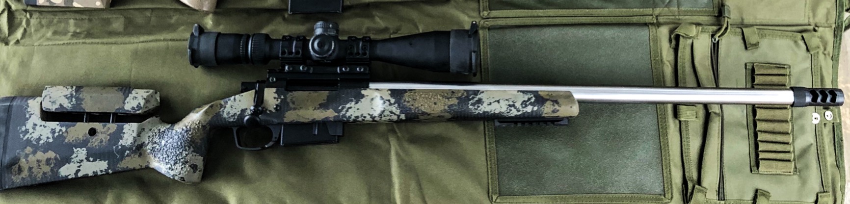

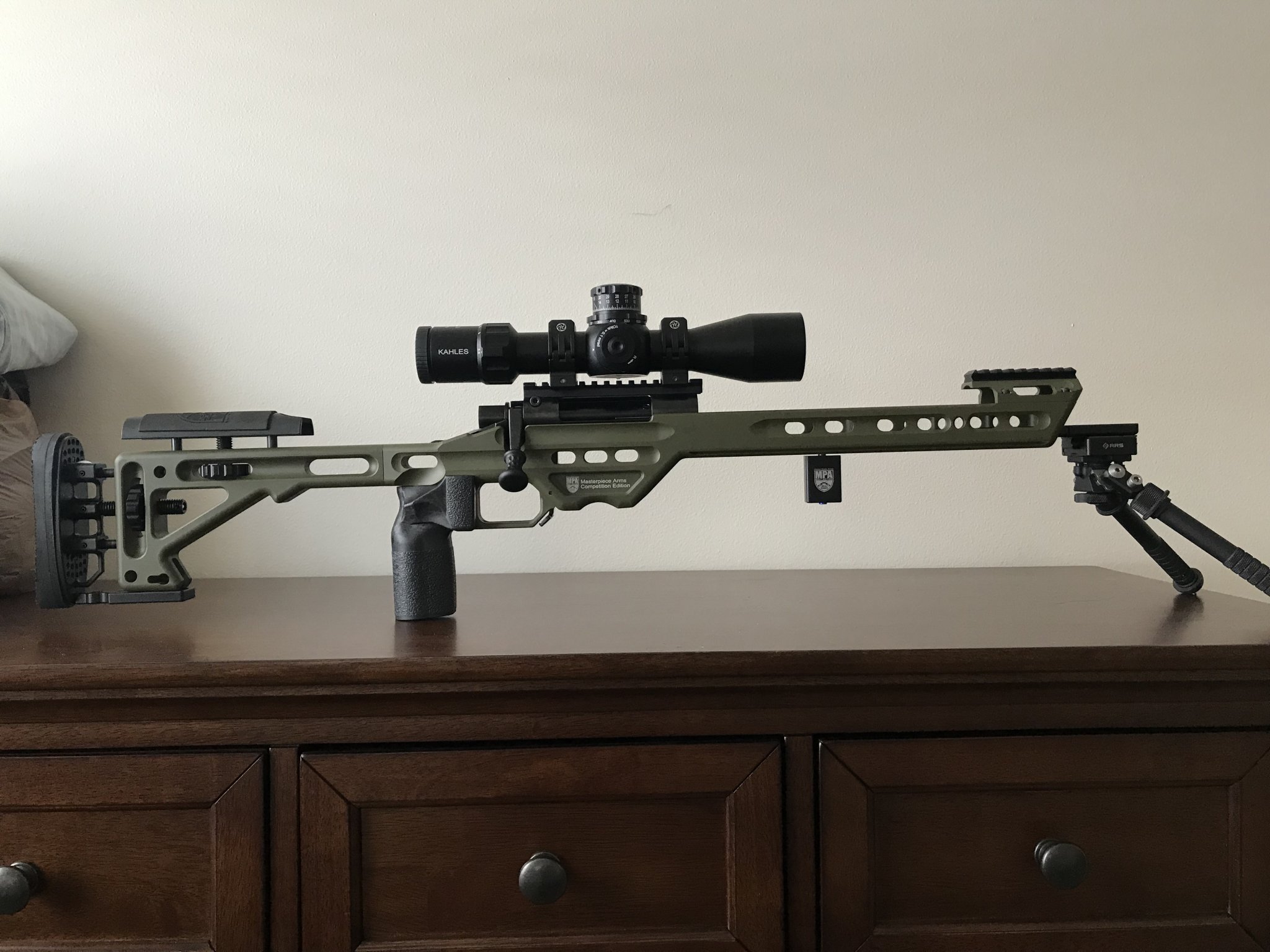

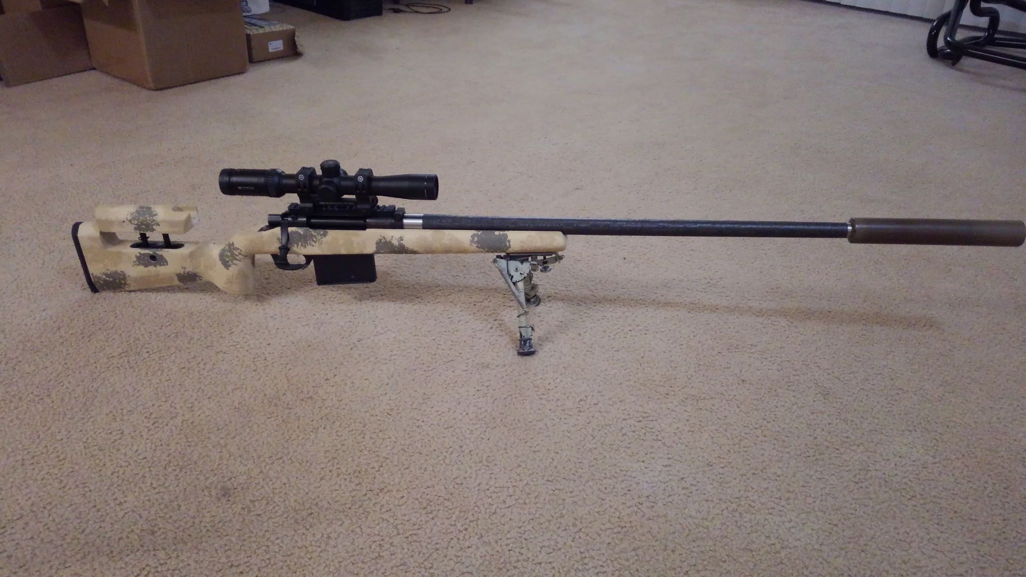

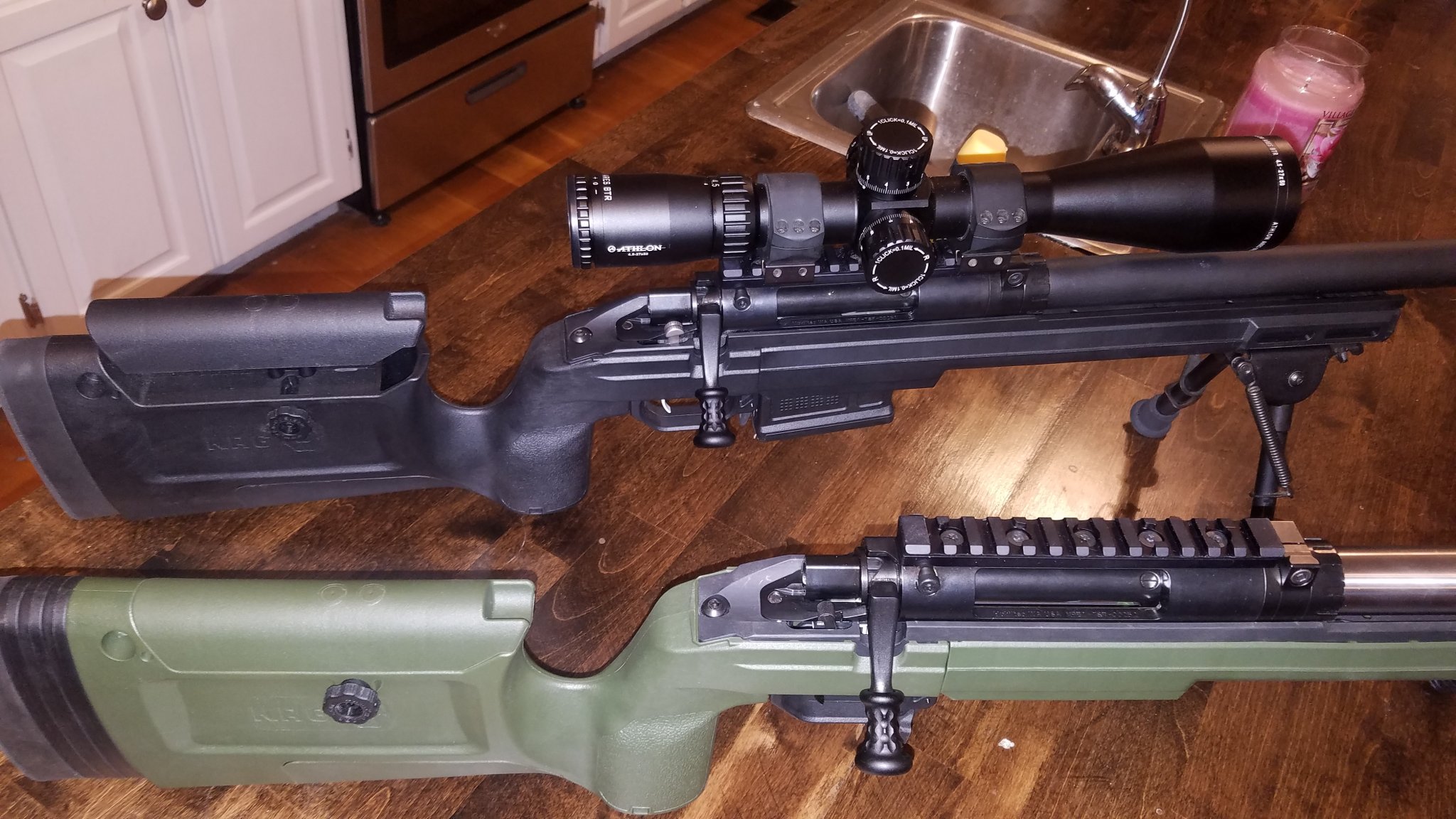

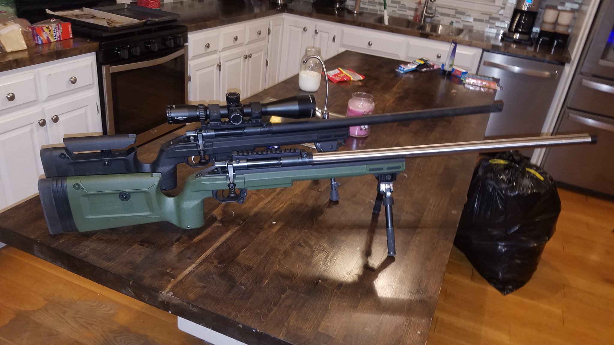

This is my first iteration on my son's Nucleus 6mm Creedmoor build (the one in front in black grayboe renegade). Have used it at a couple competition's (small shooting club benchrest) and it has done extremely well with factory hornady match ammo, haven't had time to do any load testing on it. Using Apache Gun Works 6mm Creedmoor barrel off X-caliber blank. The stock has been swapped with the origin though (so my nucleus would match his, both are in bravos now). Using TT diamonds in both of the nucleus builds. Also topped off with athlon ares on both. Might get them out and do the finishing touches on my 7SAUM Nucleus based build tomorrow.
For those that are interested:
The middle rifle is an origin build is a 6.5 SAUM (in the bravo in the pics), in the renegade/ptg bottom bottom metal that the nucleus is in in the attached pics, bix-n-andy tacsport, X-caliber 6.5 blank
The back build is the FDE w/ black webbing stock is based off a tenacity. Bix-n-andy tacsport, Grayboe renegade (3d printed and built the adjustable cheekpiece riser myself), PTG battle worn bottom metal (don't like it that much but was on sale for like $50 about a year ago so had bought 4 or 5 of them), and NSS Criterion 6XC remage barrel.
