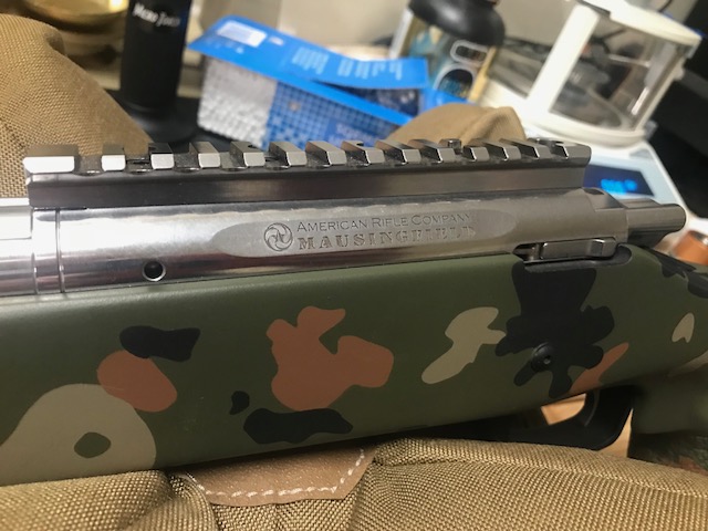

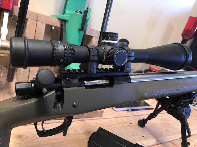

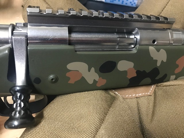

I picked up two Nuclei earlier in the week and had the time to set one up and try it out this weekend. I also received two Barlocs that I haven't had a chance to put to use yet, but was impressed by. What a simple and ingenious way of locking down a pre-fit barrel.
I put a Trigger Tech special on the action, spun on a Bartlein barrel that I already had for one of my Mausingfields (which head spaced beautifully) and then dropped it into a Manners T4A mini-chassis. I put one of my often ignored NF NXS scopes (if someone could figure out a way to retrofit these to FFP, they could make a small fortune) on there just to get the chance to shoot the new action. I was pretty impressed with all aspects of the action. With the TT, the bolt cycled smoothly and without any hitches that have been described by some. I only fired 5o rounds, but I didn't have any light primer strikes and accuracy from a bench was sub 1/4", indicating uniform and sufficient ignition. I have most of the custom actions that people talk about on here, including another three lug action (M2013) and I really found nothing to find fault with when comparing the Nucleus to my other actions. When the price point is taken into consideration; it becomes even more impressive.
My other Nucleus is a left hand .380 for my son, and I only recently realized that none of my extras (with the exception of barrels) will work on this action, due to everything else I own being right handed. His birthday isn't until March though, so I have some time to piece it all together.
Overall, I'm impressed and definitely pleased with the Nucleus. I think Ted and company hit it out of the park. My only regret is not having ordered the extra 223 bolt head for my action when the pre-order was going on!
Added a couple of less than stellar pics because I recently realized how easy it is on the new site. Way to go Frank!
