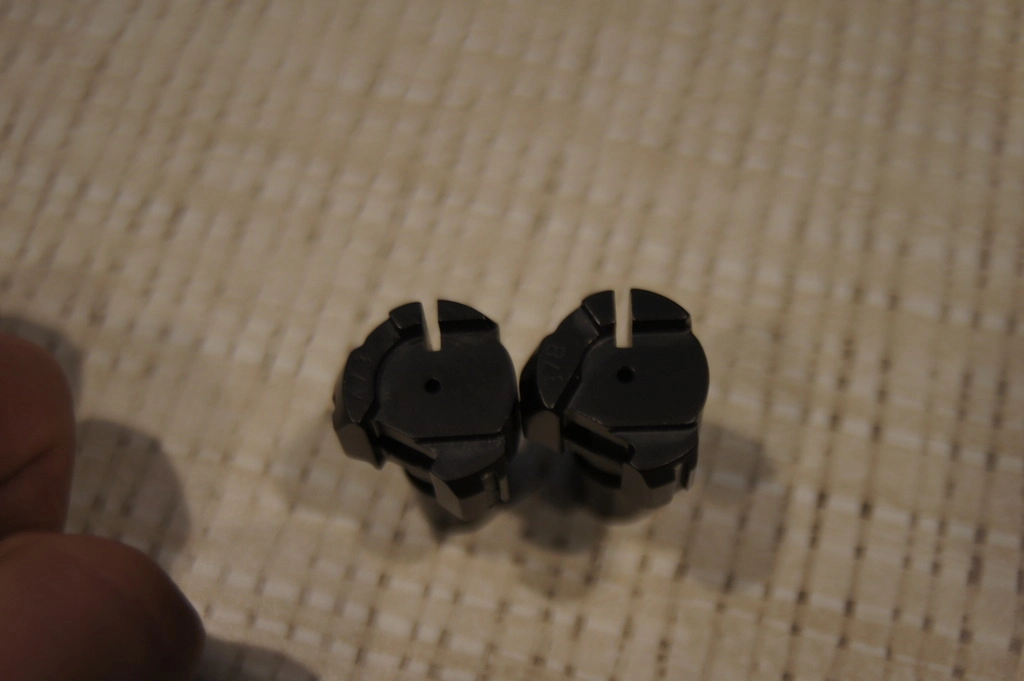

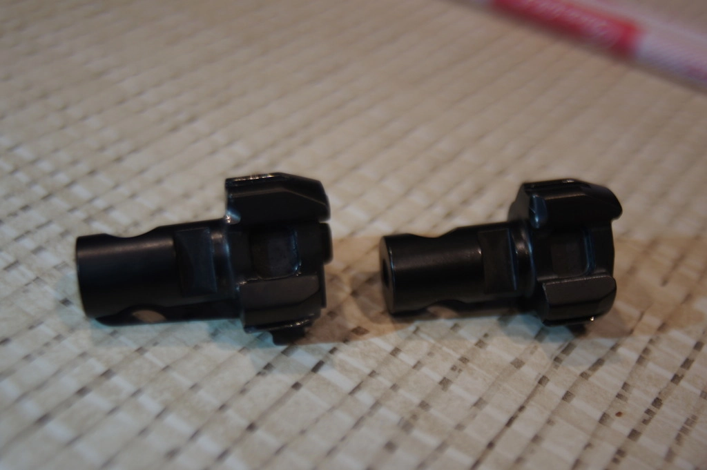

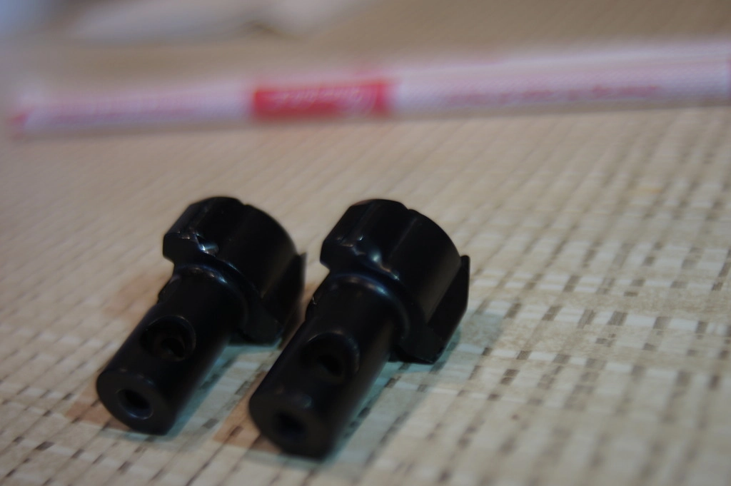

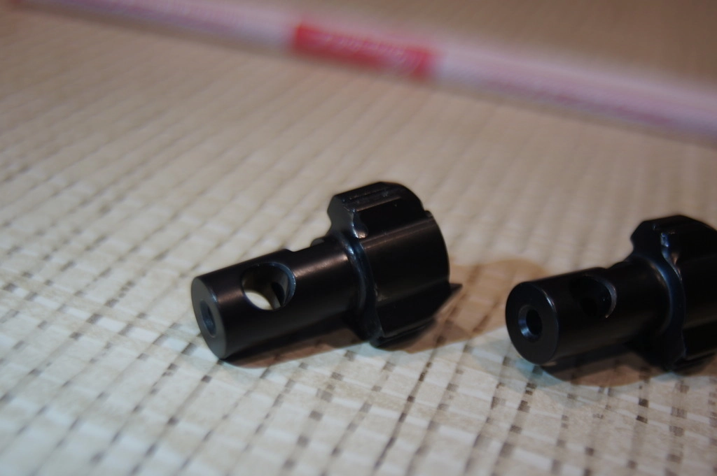

So when I got my action back from ARC, my .380 (.378) bolt head was not with it. I called them and they said that they had found some sort of defect in the .380 bolt heads, one that nobody but them had noticed yet. They said that they would send me one from a new batch once they got some made. The guy I talked to said they would try to keep up with the fact that they needed to send me one, but I might have to call and remind them.
I haven't been able to shoot in a while, so I only got around to calling to remind them last week, and they quickly sent it to me. I just got it in the mail and found that the lug cams have been redesigned!!!
I swapped bolt heads and, man - the difference is huge! The redesigned lug cams make the action cycle so much more smoothly! As I've discussed before, with my other bolt head (old design lug cams), when the lugs make contact there is an abrupt catch that takes 8.5 lbs of force to overcome. With this one, you can still feel when the lugs make contact if you are paying attention; however it only takes 3.25 lbs of force to close and it feels like a smooth transition rather than a catch.
ARC did a great job on this redesign, and I appreciate that they listened to my feedback and decided to try something new. Virtual high-five, Ted! I only wish both of my bolt heads had the new lugs!
The redesigned bolt heads with altered ramp geometry to help with the smoothness on bolt close were mentioned in the PVA JHR thread last week. Supposedly once ARC has sufficient spare bolt head inventory to support it they're going to start offering bolt head exchanges under warranty, and all actions from here on out will ship with the revised bolt heads.
Pics of the new bolt head, please.

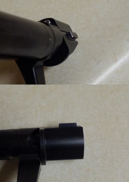

I just took maybe .010-.015 off of the surface on my sear and it does improve things tremendously if you have an annoying cock-on-close hitch. YMMV, do so yourself at your own risk, etc...
That said, this condition is vastly preferable to that on another rifle (not a nucleus), where the sear surfaces are too far apart by default. The bolt basically works to close itself, but lifting the bolt handle on a cocked bolt I run into a hitch 3/4 the way up. Non-issue if I fire the rifle because there is no more sear engagement, but an annoyance nonetheless. As near as I can tell, I'd have to build up a small weld, then reshape the part and work my way back down with files. I'm less keen to perform that operation.
you got any before and after photos?? sounds interesting
Just so everyone knows I’m sure this isn’t a modification that ARC approves or anything like that I did so at my own risk but I have a new Unmodified piece and my current modified piece I can get some pics of when I get a chance
I just shortened the sear surface a few thou at a time while being careful to maintain the shape of the original engagement surface checking feel and measuring each time I also left some overlap
No before, but here's a couple after.
I'll second what Anderson_A said, again. I'm sure Ted doesn't approve, and you'll get appropriately charged if you need a replacement, void warranty, and if there's any safety issues that develop it's all on you.
